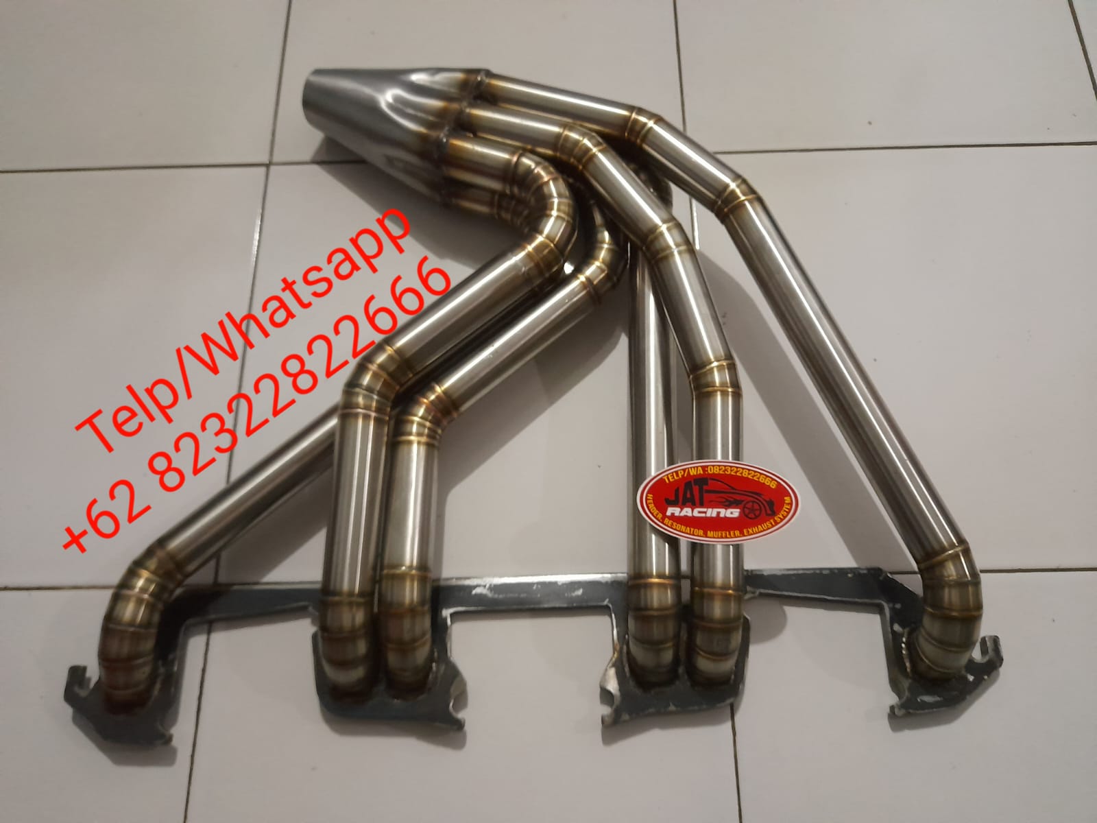

I saw this ad on Facebook.
Do any of you have experience with this header?
I just chatted with the seller via WhatsApp.
The price including shipping is actually okay, but I'm just concerned about the quality.
I definitely don't want to buy junk.

That's a lot welding on those tubes - hope they were good welders. The end of the 6 into 1 opening would have been nicer if it had a least an inch of straight to work with.
I made custom stepped washers to work with the different thickness at the studs. Intake is like 1/4 and the header is like a half inch.
I know it gets cold in Germany, so I would add a liquid heat riser (under the intake, I made mine) and a manual choke

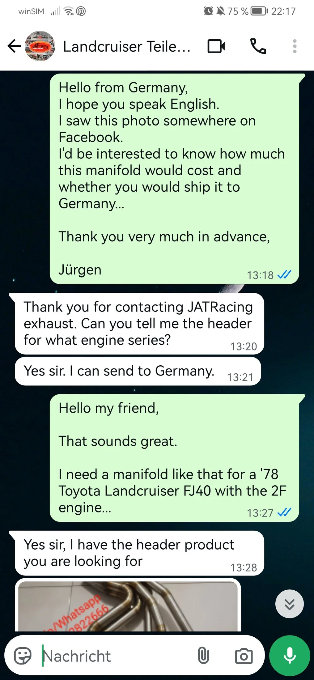

I think it's fake because... I think his replies on WhatsApp came way too quickly.
And... how did he know so quickly what shipping costs to Germany would be???🤔🤔
I absolutely don't want to be fooled, so this header is out of the question for me.
I'm enclosing a few screenshots of the WhatsApp conversation. I think then you'll understand my concerns.

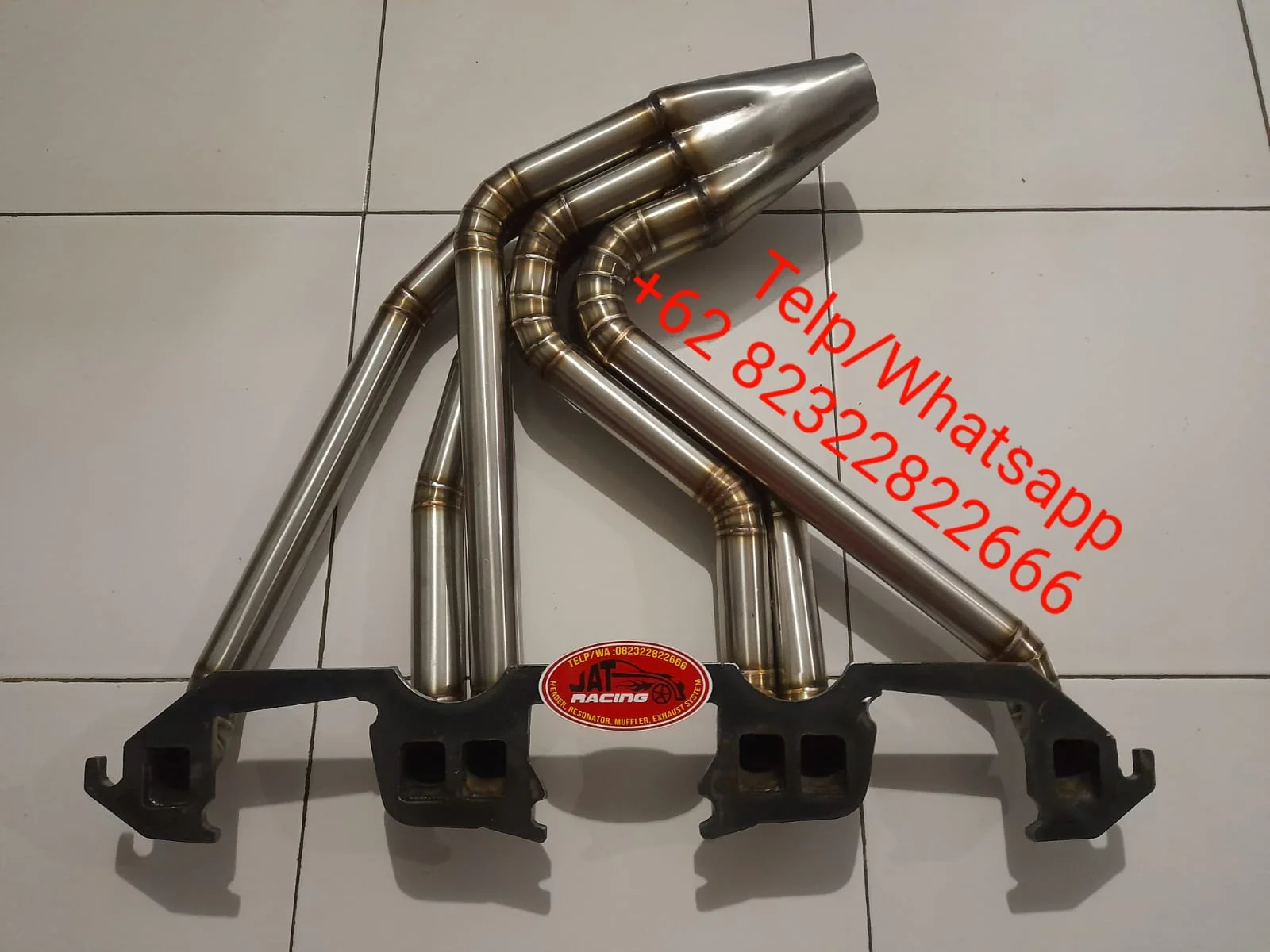

That manifold in pic has ALOT of welds, not good, those welds are not TIG'd and I would be curious to see what the inside of tube looks like ?
That's a very good point, I agree. 👍
But it doesn't really matter now anyway, because I definitely won't be using it.
But you're right, it would be interesting to see what all the welds look like from the inside...🤔🫣
