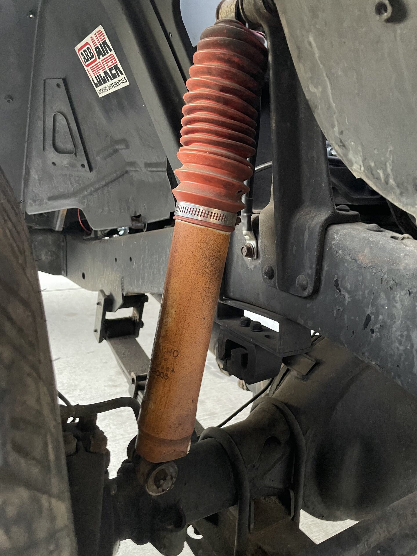

So I found out looking under my truck that the previous owner actually already installed reverse shackles and i had no idea because the ride was still so friggen rough. Granted i need all new rubber and shocks whcih im shopping for literlly as we speak, im just trying to see if I should get the Bilstein 5125 or 5100 - as I read about them it seems the only difference is the customization of size. If someone put 33's with an old school rancho lift - what size should i get of bilstein shick? i measure my current racho's from center to center of rings at 17.5'

Flex out the cruiser until the axle hits the bump stop with shocks removed. Measure from shock stud stud to shock mount stud. Take that measurement and subtract like 1/2" or 3/4". That is your needed compressed shock length. You will never get the rancho springs to ride nice. You will have to get some better leaf springs for that.

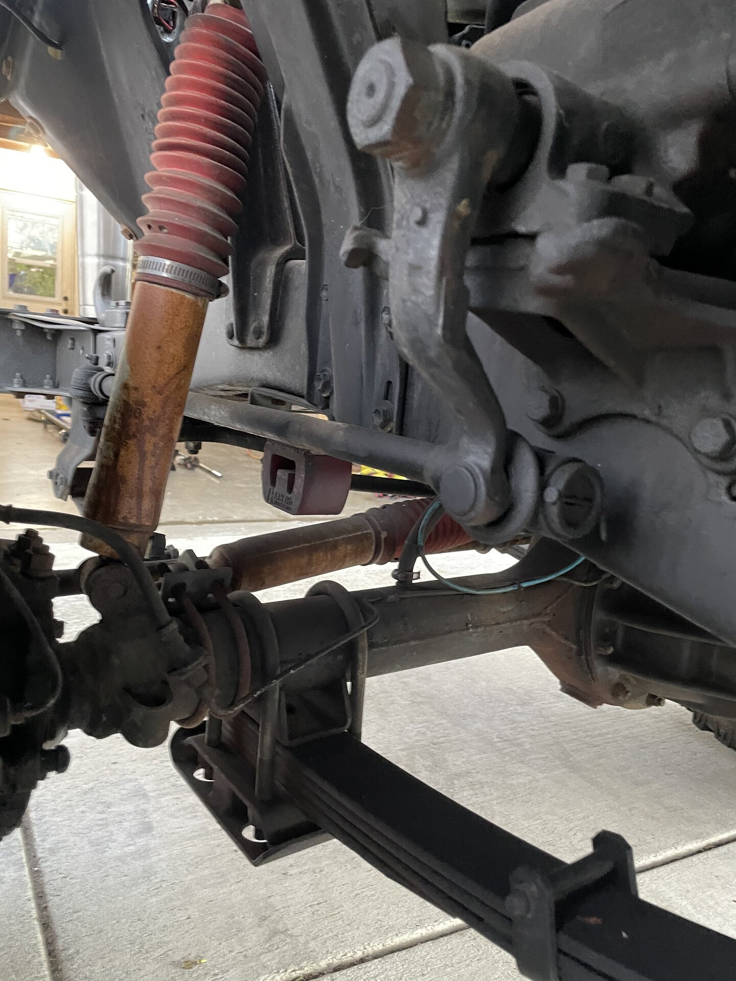

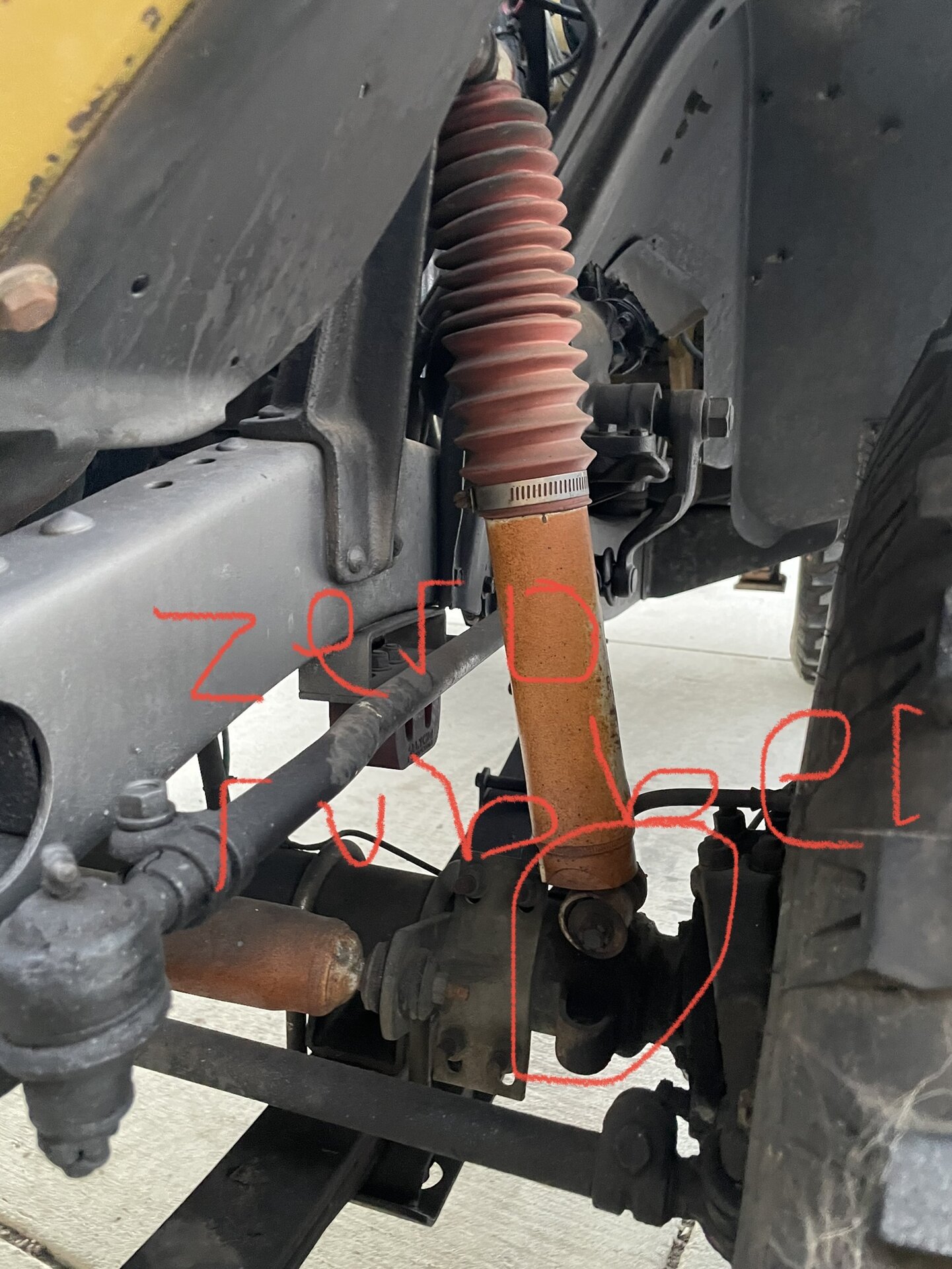

heres a pic of current setup - which absolutely needs a change...the rancho's are completely shot...theres literally no rubber btw the eye holes- lol
and im making a decision on this tonight...Oh and I need all new tires so its like what elese should i do while im down there type of deal...

You will need some 2"-2.5" or so lift leaf springs up front, and for the rear either some 2" leaf springs with long shackles or 4" leaf springs with stock shackles if you want new leafs for the shackle reverse setup. The shackle reverse gives 2" lift up front by itself. Unless you wanted to go taller then you could go with 4" springs up front and rear with long shackles in the rear and you could probably run 35" tires then.

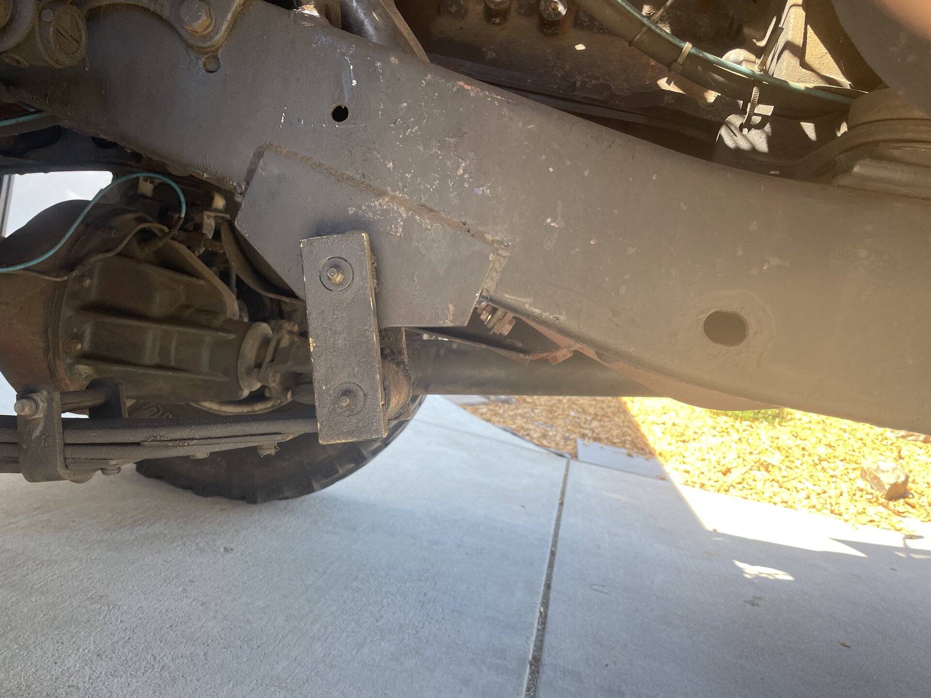

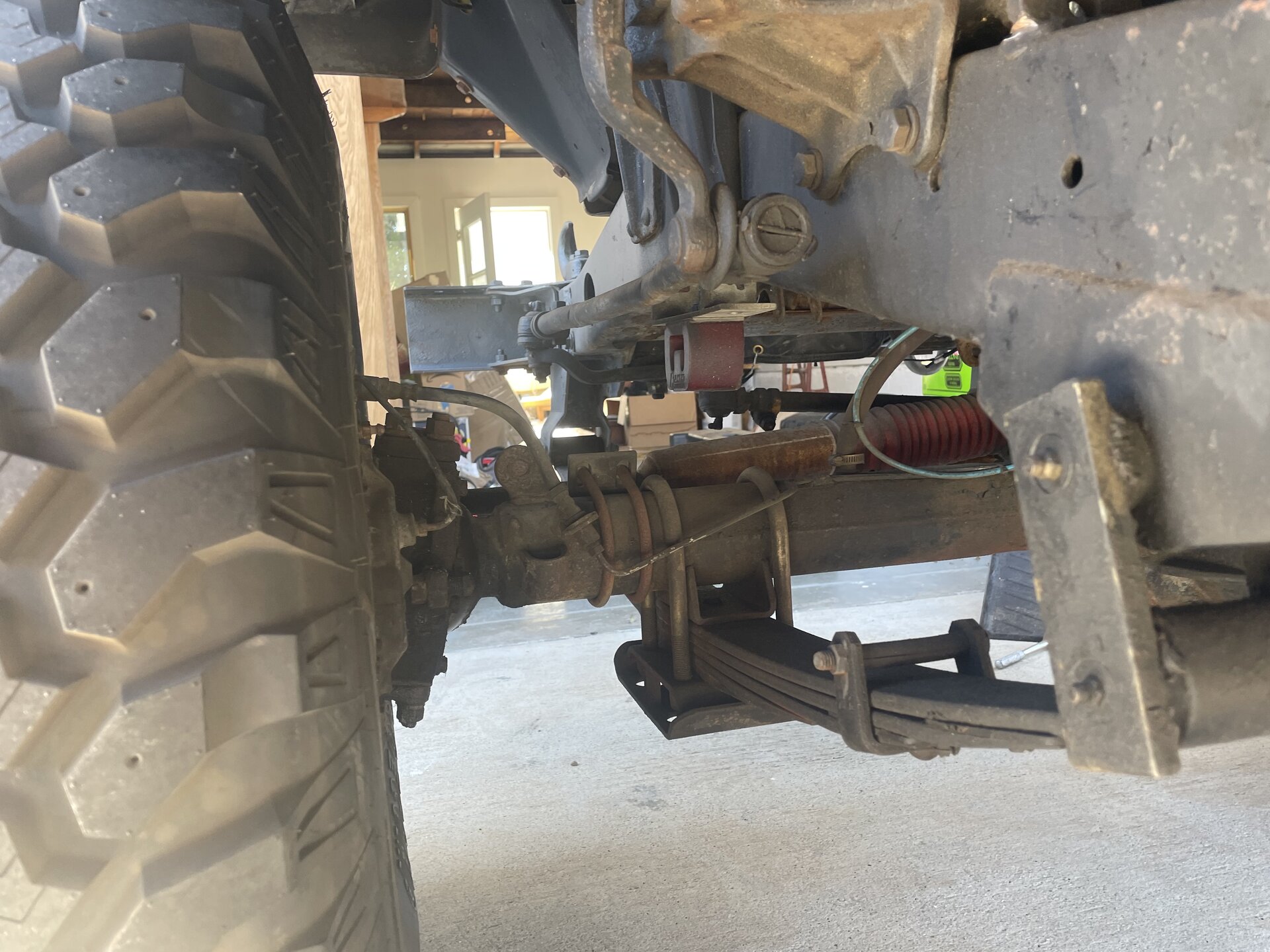

Ok so upon inspection my PO already put on reverse shackes - lol i know i just didnt check...but look my PO past away and his son sold me the car "knowing nothing about it" so ive been reverse engineering the car with my eyes.
you can kinda see it in the pics actually as well...
so thats embarrassing - but to behonest theres still a couple things im figuring out about this car and what the PO did - what i did find recently is big fat receipt to "custom cruisers - gilroy" so i have a call into Gary to say hey you completed this car a while back in the early 2000's i need it looked over and i need to know what i have here.
