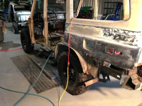

I'm enjoying seeing how it's done, to say the least, continually wishing I had the skills to achieve similar results.
Very early on, Britt and I discussed his budget to get it to a primed, ready to paint stage, and we've exceeded. I'm speculating it to be three times the original amount discussed.
A learning experience....

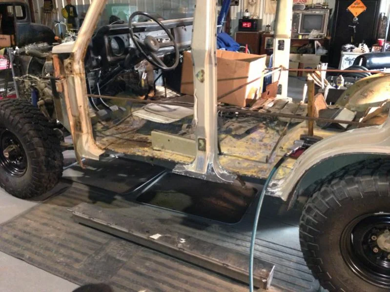

Continually thinking about the next phase, which I believe pulling the body off should be, and furthering rust and sound abatement, as well readying the interior, all while the little bits and pieces are chromed, plated, painted.
While the body is off, removing drive train and dealing with the frame prep and coating, along with axles, leafs, brakes.
Pretty much, the goal being to have primed body sitting on the completely finished rolling chassis, with the interior lined and painted, before beginning the F, TC, tranny rebuild.
Don't know if this is the most efficient means to complete, so open to suggestions.

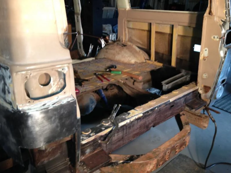

A question I have, regarding frame and process.
Had always intended on having frame checked and straightened, which Britt suggested should be done with the body on, before pulling it for undercoating, since any movement should relay to the body mounts.
Sound right?
The body mounts appear to have some slop and having seen Don's straightening methods, it appears to be a better operation performed on just the frame itself.

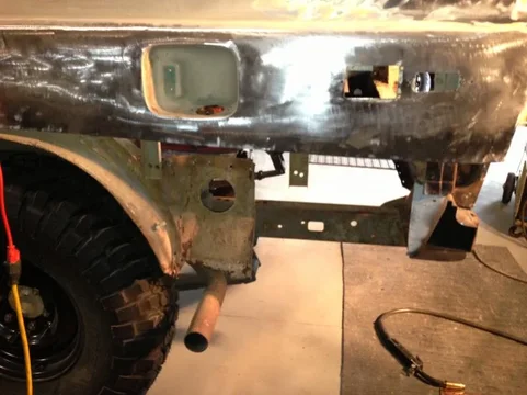

Britt claims the progression is the only way to bend. I don't discount as I haven't studied it yet, but the 5/16" bend is going to be impossible, as far as I know right now, even on CNC break, following.
The 71s isn't worth cutting out, either, so Britt wants to form.

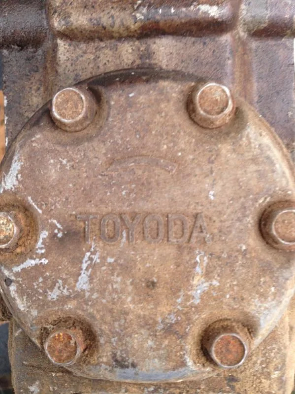

A side project related, to attend to in the next year....

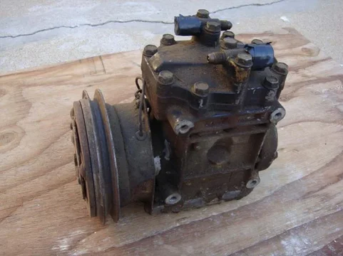

Gonna have OE, period correct AC, regardless of inefficiency.
This will be stored for the time being, but hopefully can figure out a plan to mechanically restore, if not update as well.
The old school Toyoda is too cool.
Stoked about, but, for lack of a "how to" video, I'm concerned about rebuilding and whatever needs to be don't to modernize.
Going to tackle the easier '76 first to gain familiarity with the older systems....even though I know nothing about newer ones anyway.
Very cool score considering it is period correct and all evidence points to this '72 having had AC at some point in it's past.
I like originality, but I'd ditch the old York compressor for a Sanden unit.
You can get an adaptor bracket and compressor for cheap.
http://www.ebay.com/itm/SANDEN-STYL...Parts_Accessories&hash=item5d34e270f2&vxp=mtr
I did this on my '77 Porsche 911 and it made a large difference in smoothness and the amount of poser the compressor sapped. The York would almost kill the engine at idle when it kicked on. I can barely tell with the Sanden.
Problem with that is, the Sanden's don't say
That said, the goal is to modernize, so it may be an issue of keeping the case and replacing the internals with similar components. I can't say yet, as I have no clue, but the OE aspect trumps functionality, on this Pig.
I know that sounds ludicrous, but what really IS ludicrous is the investment in this restoration, as a whole. Odds are, she'll be a perfect sunny Sunday driver the rest of her life.
