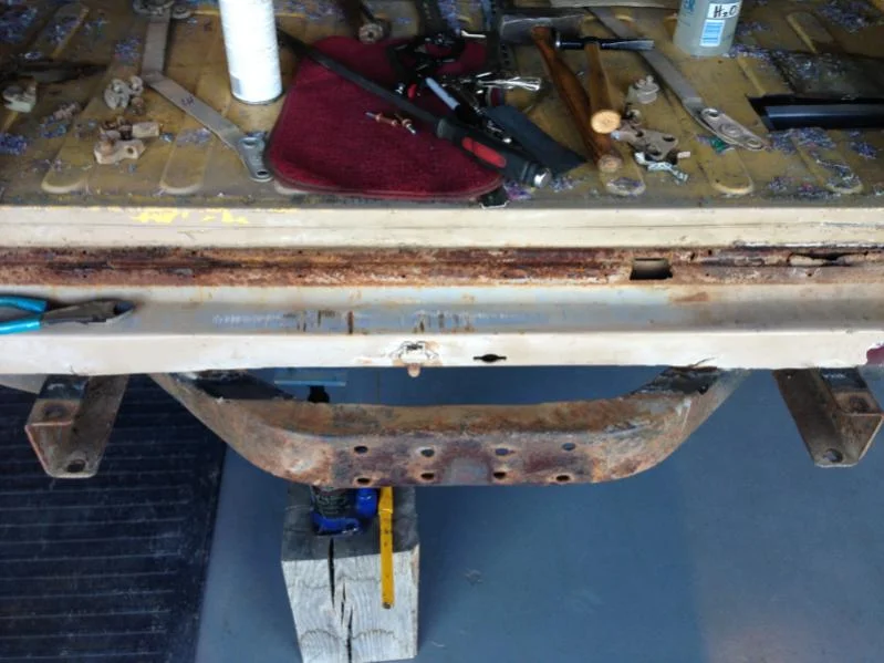

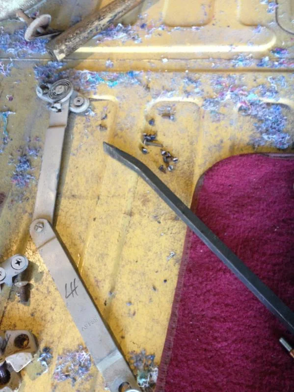

Latest. Not moving very fast as a few other projects are in process too.
Having to rebuild this section as the 71s isn't in good enough shape to use, either.
Maybe a future bobm part.

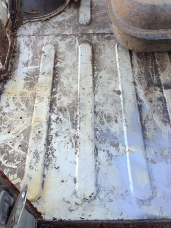

The cargo floor panels are also being sectioned in, because the 71 and 72 have a different embossing pattern on the ends of the ribs.
71
72
I realize that's very, very, very petty, but it is what it is and the choice was made to cut out parts of the 71 floor to section into the 72.

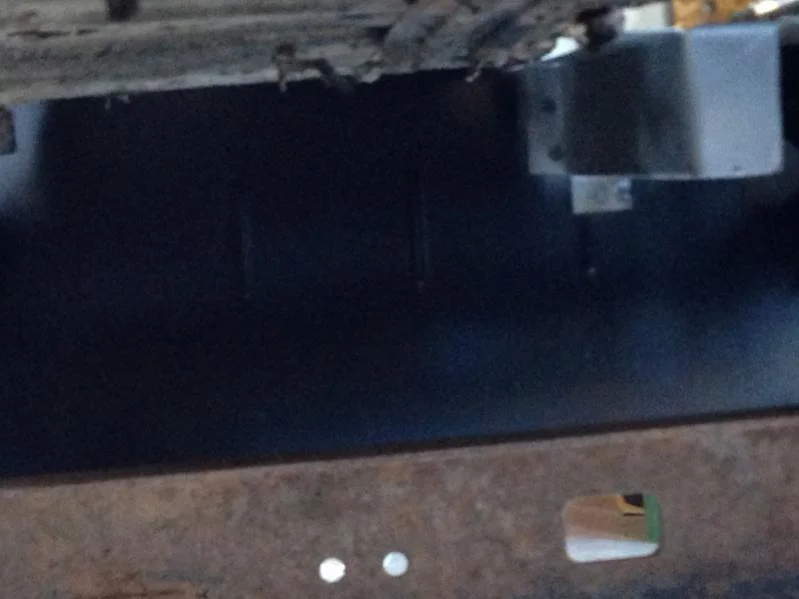

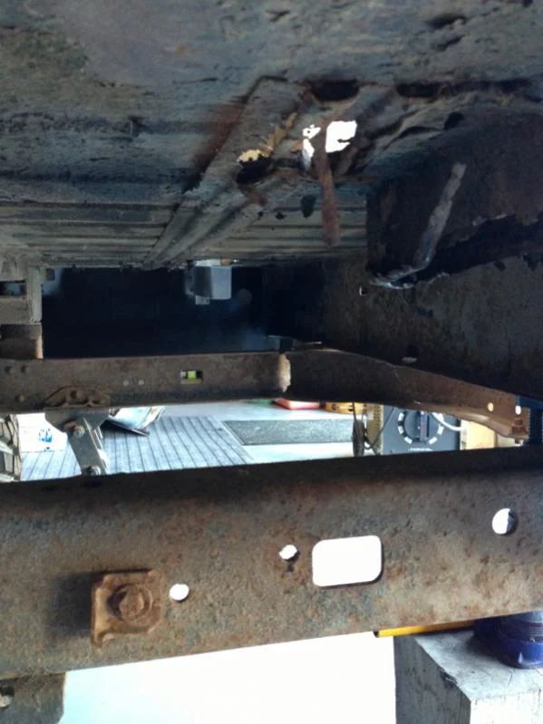

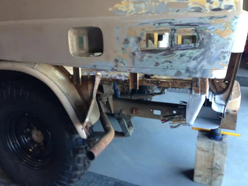

Hard to see in pic, but bobm's inner fender panel.
There are some tricky radiuses to form inside of the lower pillars and all had to be redone from a previous impact.
Pretty much, the outer skin is removed to reveal inner that needs to remove too, so outer is braced, inner replaced, then back to outer.
Won't call it a learning curve for the body man, but more a vehicle specific curve. At least, teeth have been cut on the most difficult shell anyone on their right mind would've scrapped, setting the stage for more efficient future shell repairs.

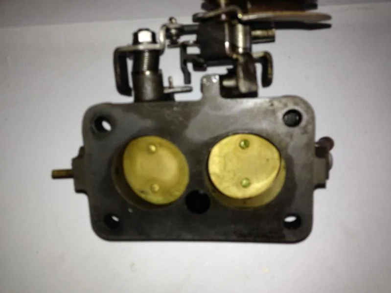

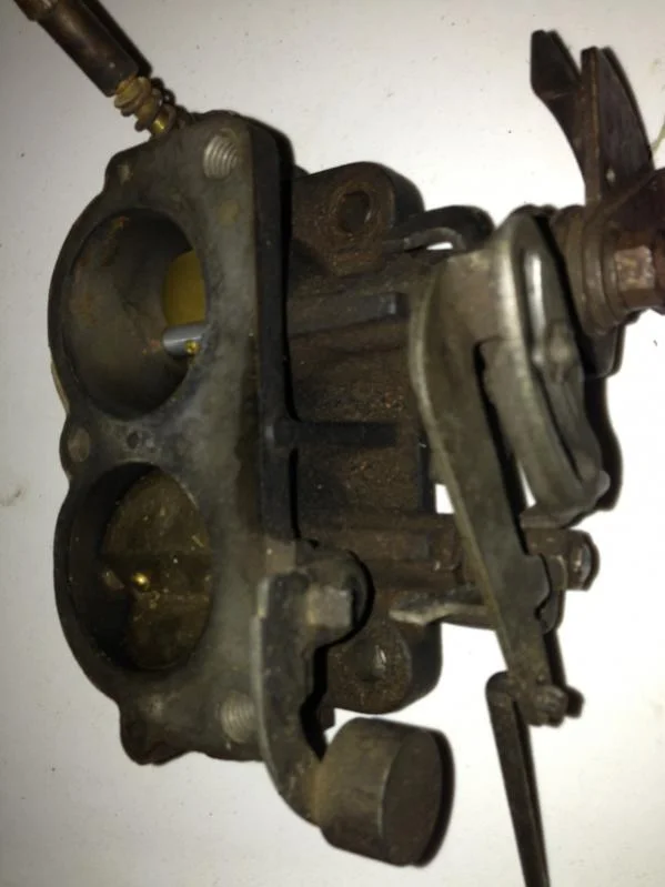

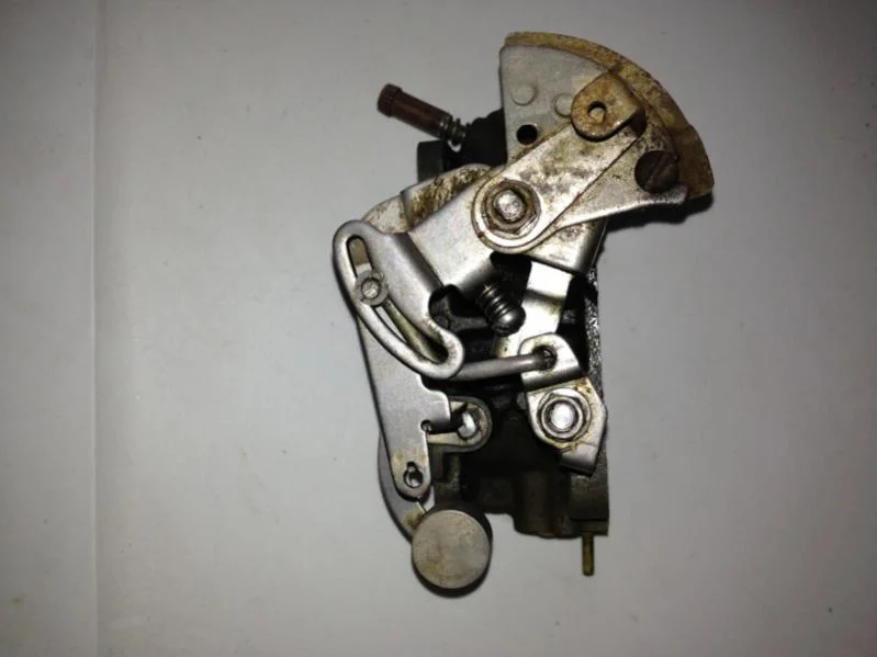

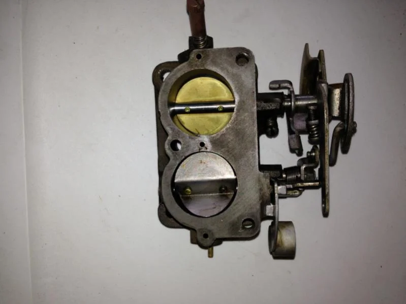

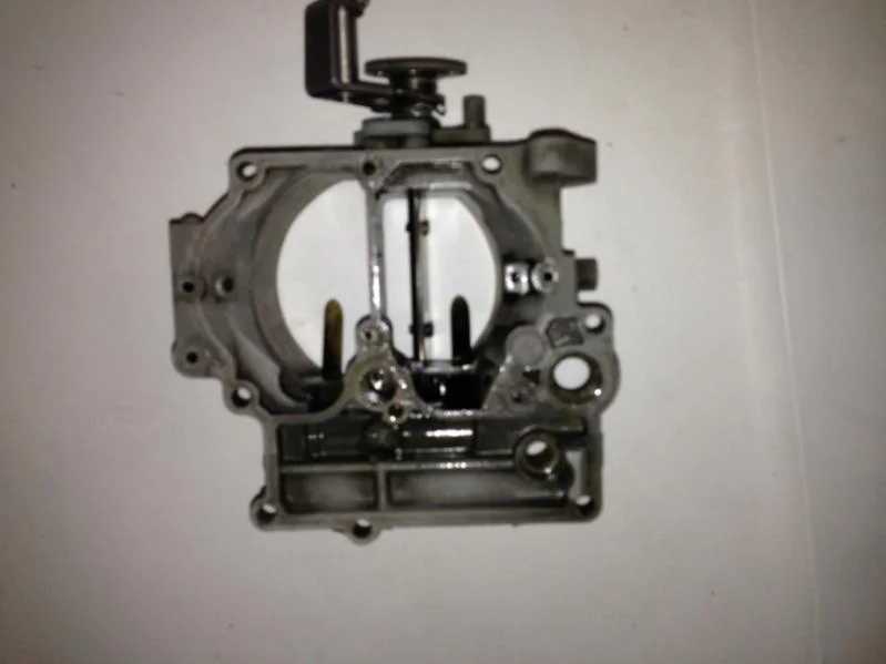

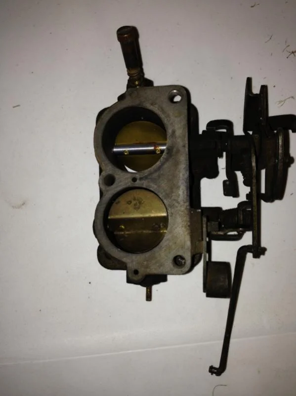

Second dip:
Have 72 hours on this piece and still needs a little work.
Before
After
Not really worried about anything but the carb body, since most will blast before plating, anyway, but this gunk is caked on.
This pic is pointless.
