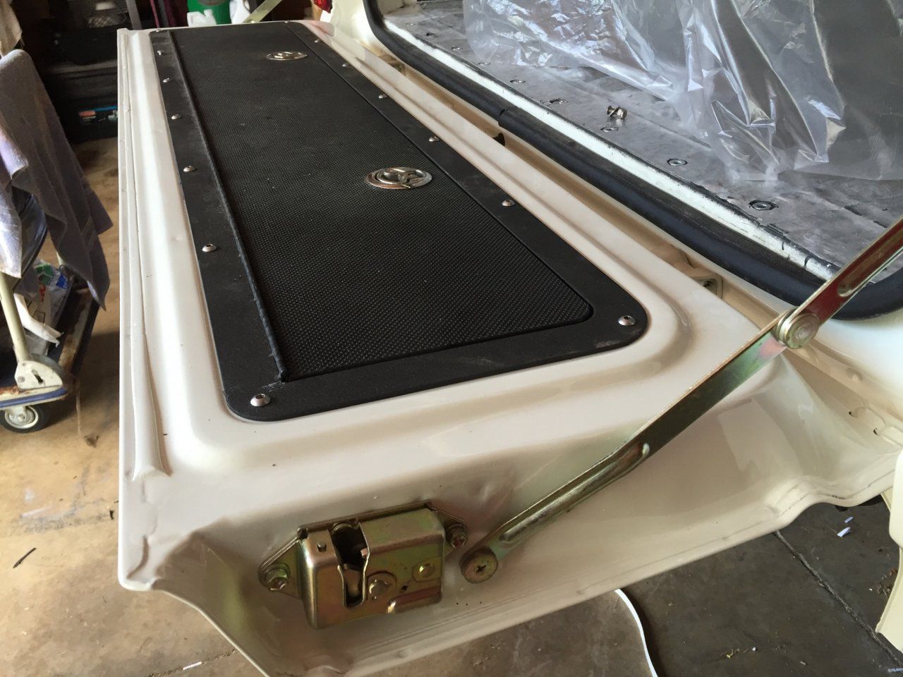

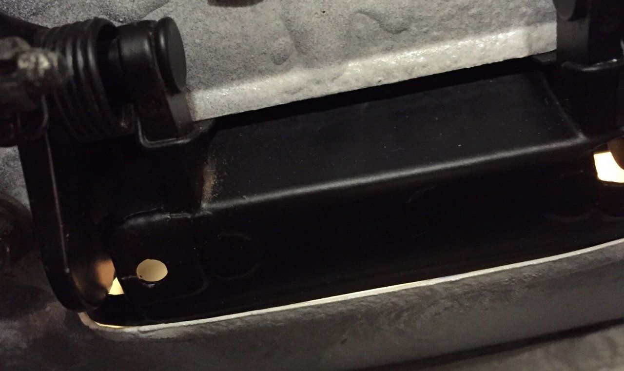

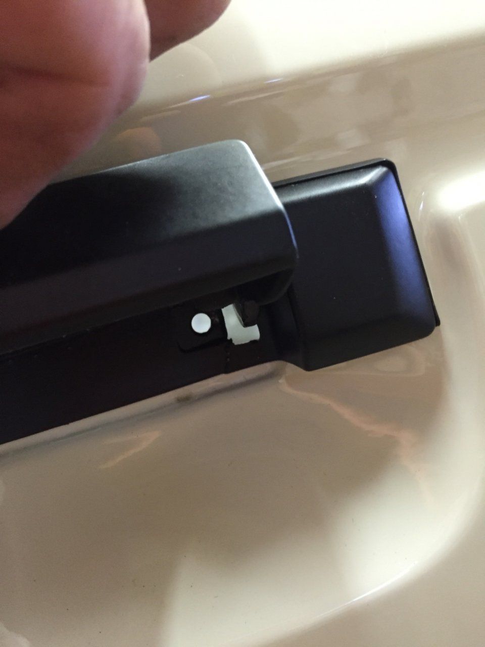

On the door handles, there are two small holes on either side of the handle, sorta hidden on the under side. Any pics of what goes in these?
Outside handle
Inside handle.
Yup, i need those little bumpers as well. Please post what and where you find them if you can.
Gonna look at the hardware store for the door handle bumpers. I found the rear tailgate and hatch bumpers at Ace. They fit perfect. I'll get the info on those when when I find the handle bumpers.

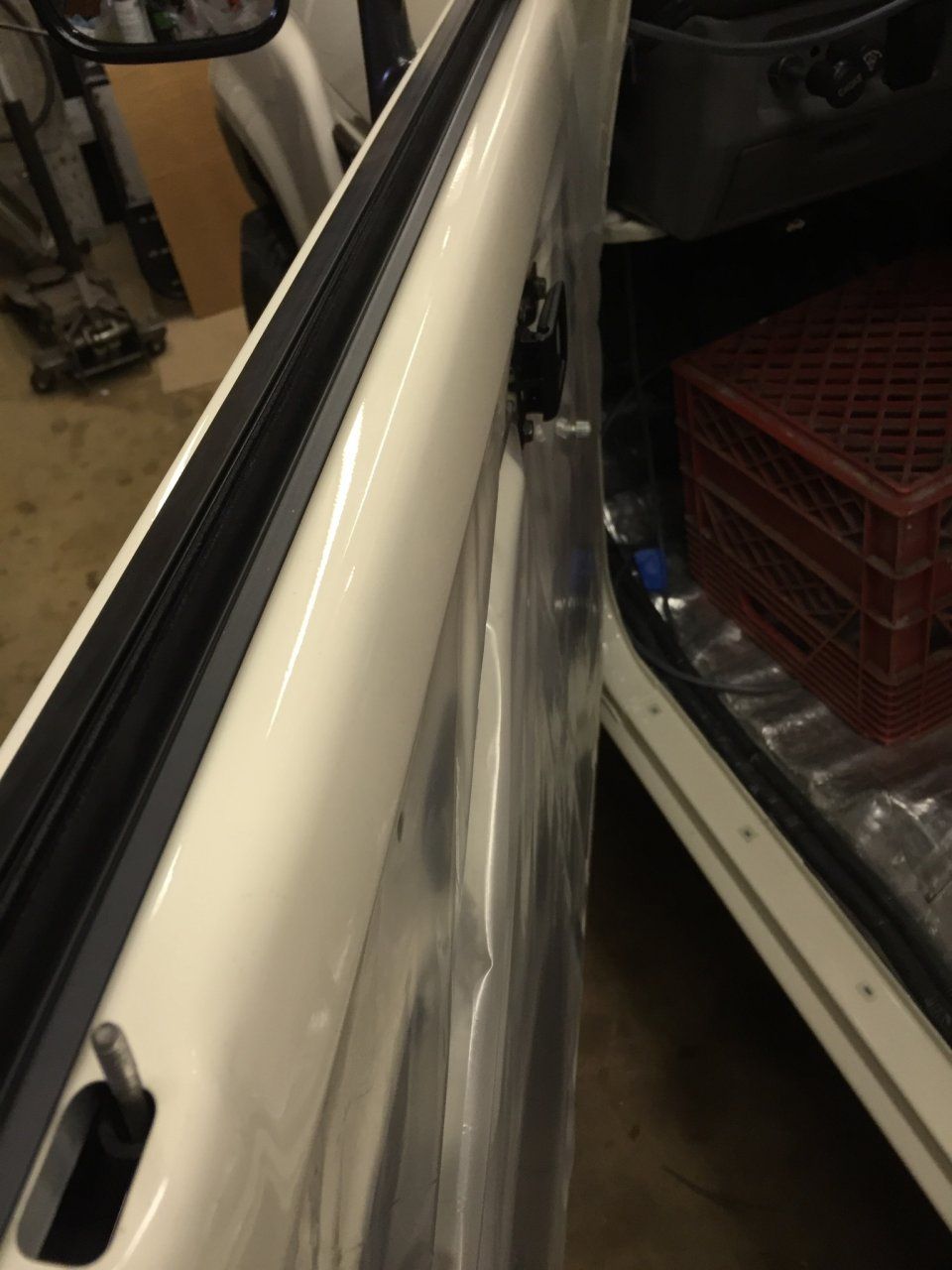

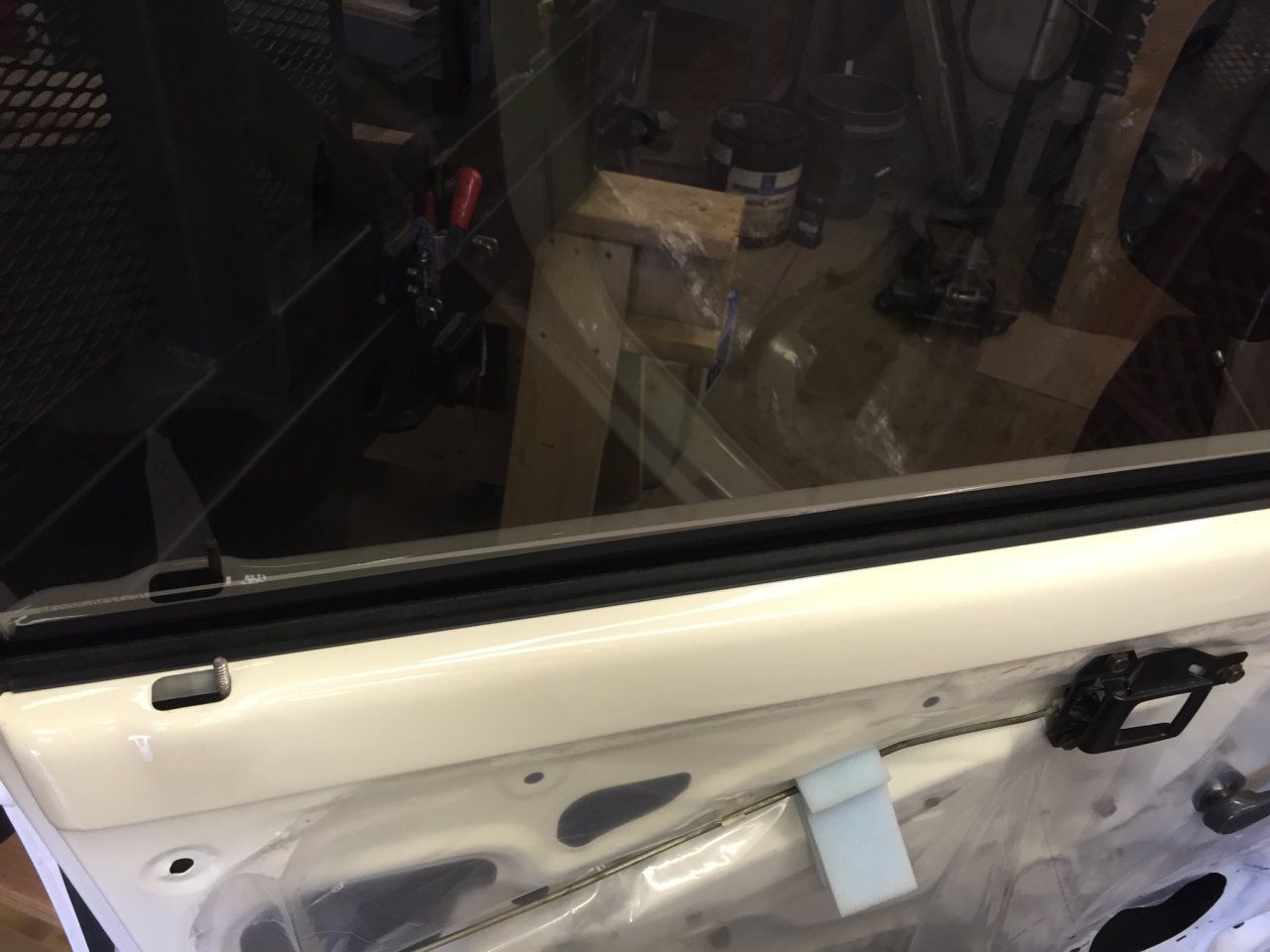

Did some door work today. I've decided to go exposed paint above the door cards. Gonna be a little interior design work on the panels but will be worth it. The inner weatherstripping isn't available w/o chrome so i did spittle painting. Here is how the doors look with weatherstripping installed.

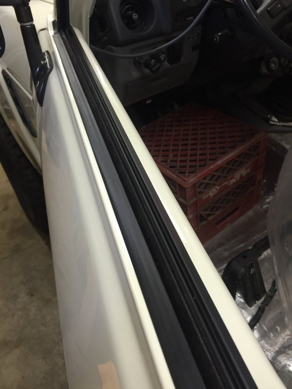

And with the glass installed
Funny how the first door took many hours, and the next door took about 30 mins.
I used "3M Scotchpermanent double sided tape" on the 4 mill plastic barrier and it works plastic peels up and lays back down when needed. I did screw up and put into too early.
What I learned putting the door weatherstripping and glass in..... I add this because up to this point, the door assembly has been the most tricky part of the build. Particularly the the rear door glass and tracks.
On the inner weatherstripping that I painted and going with exposed paint, I had to adjust the tabs a bit to fit in and bend properly into the holes in the door. Took a small die grinder and sanding disk and barely buzzed the tabs on the edges so they are straight, not flaired. Forgot to take a picture of this. Will get one on the next door and add it back to this reply window.
On the front driver door, the inner weatherstripping has to be installed first. Then the front triangle, and rear run channel and front run channel. I put in the glass, the installed the outer weatherstripping last.
On the rear door, I had to get the glass into the door BEFORE installing anything. the fixed window and then brace/track support. i just let the glass sit in the door, but not in the regulator. Then I put in the fixed window brace. Next was the inner weatherstripping , and last the outer weather stripping.

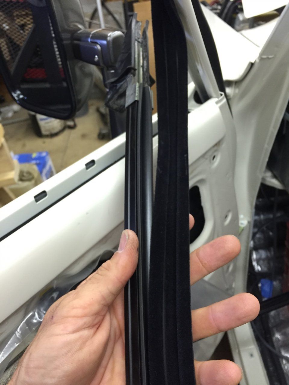

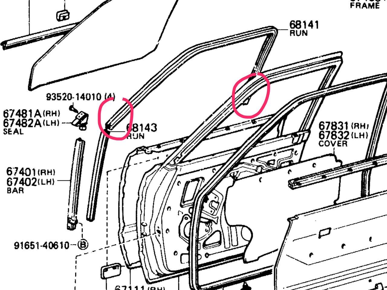

Need an answer on the window run from above. Are the pieces that I have circled designed to be "cut to fit" ? I can't figure out how both the pieces are to fit into the front track for the run weatherstripping, unless I do some cutting. Let me know if you have installed these two pieces before and know the best way to do this.
These two pieces overlap in the channel. Any ideas?

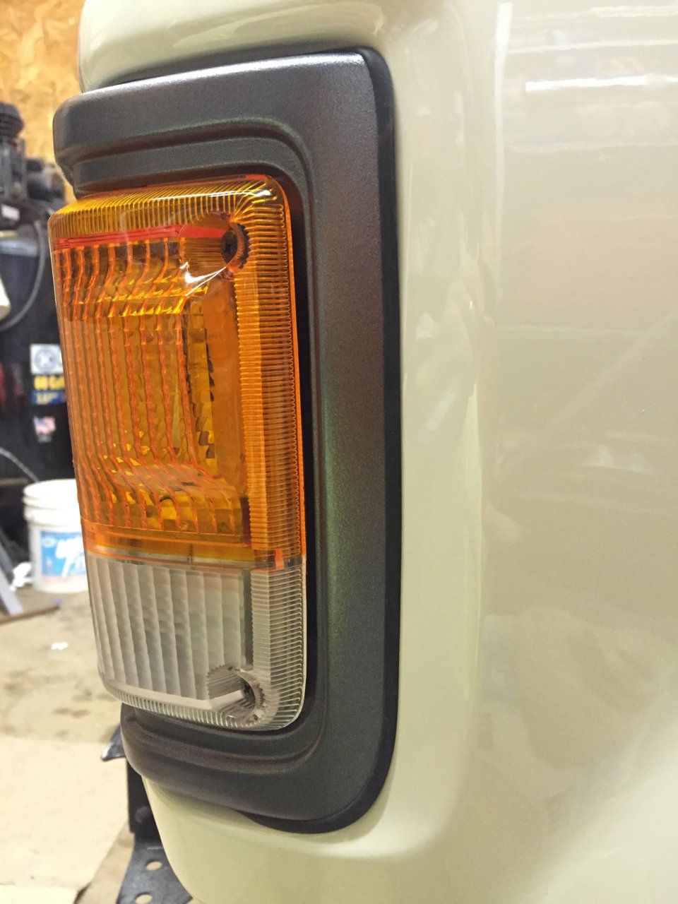

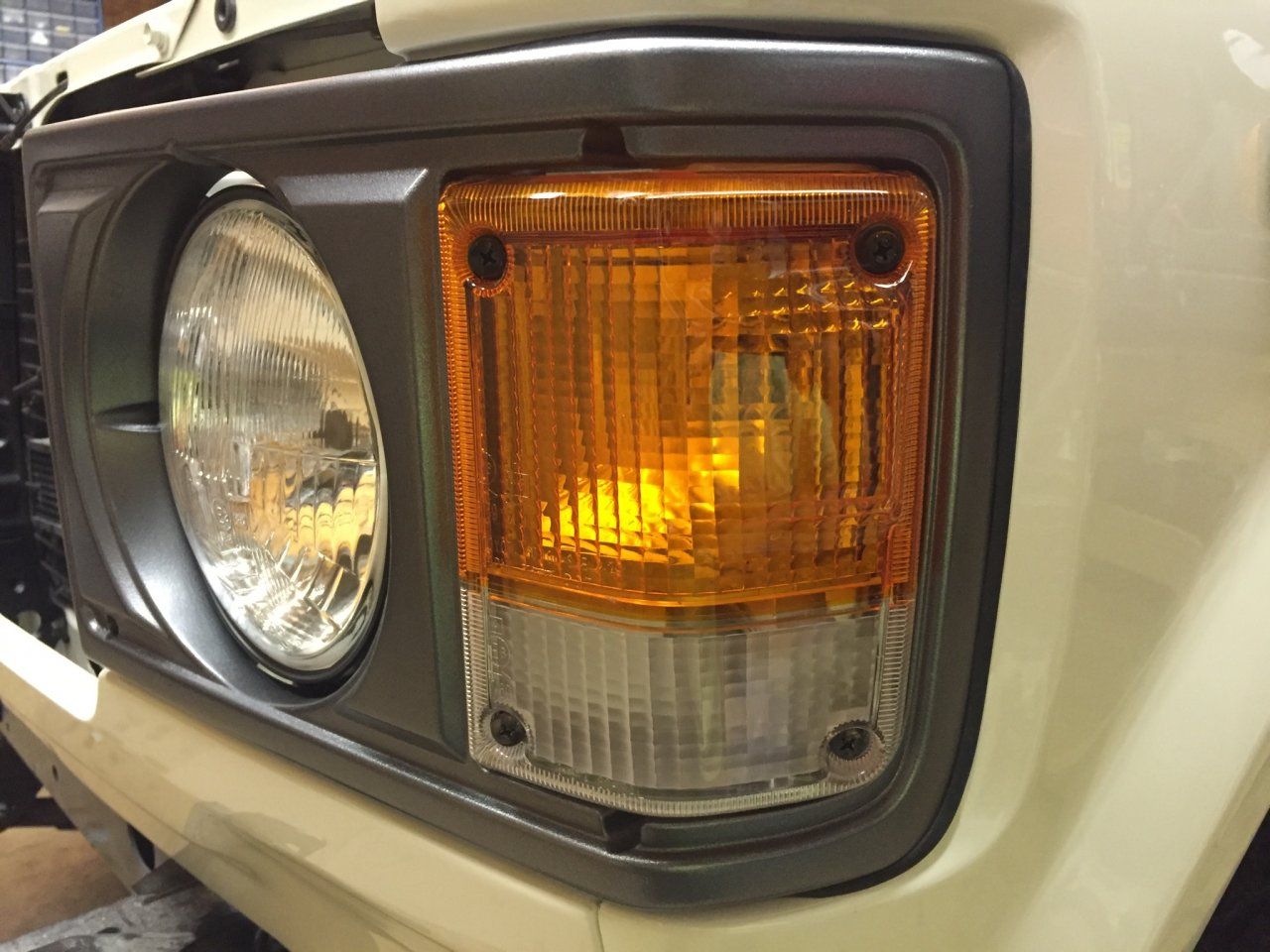

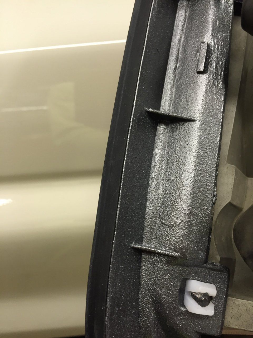

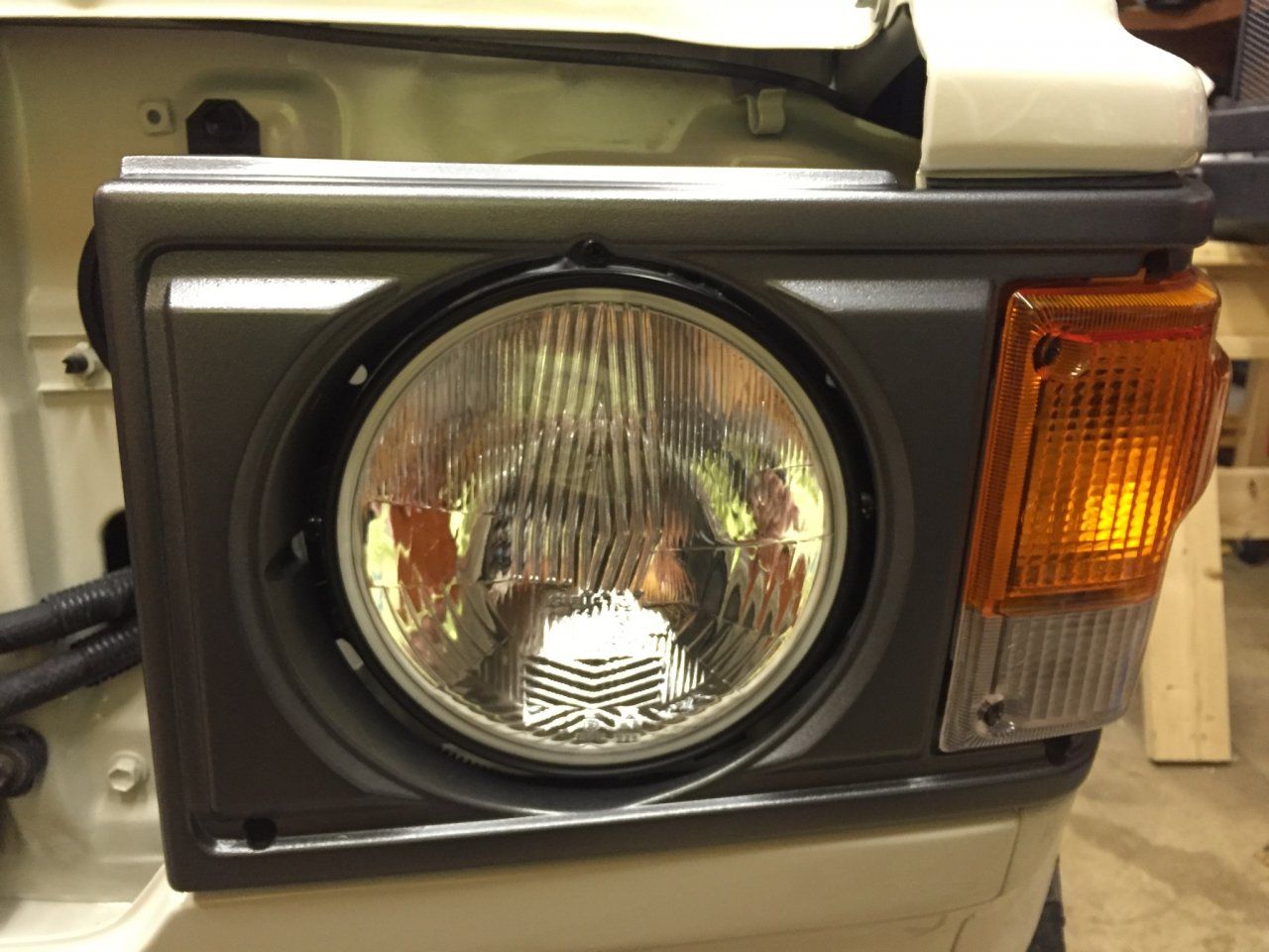

Started on headlight surrounds. When I disassembled them I realized there was a rubber gasket on the outer edge to keep the plastic from rubbing the paint. Nearby impossible to keep as new and remove to repaint. Did some scouring around and found a part that is Toyota and works almost perfect. The rubber piece shown is from an FJ Cruiser: the piece of rubber on the front end of the hood. Got it through Beno to try, and works awesome.Mir I remember right, it was pretty inexpensive too.
Powdercoated all the parts holding in the headlights. Upgraded to H4 bulbs and new headlight housing lenses. New signal lenses, bolts, and retainers. Paint is a rattle can from O'Reilly.

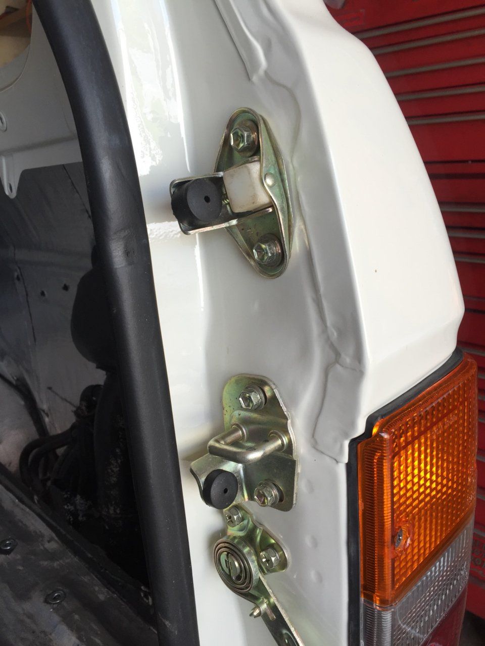

The rubber bumpers on the tailgate and hatch are no longer available. Found these at the local Ace Hardware. In the miscellaneous parts section. (Lowes did not carry these). Hillman is the brand on the boxes and these are the numbers for the two types. The third is the bumper that is perfect for the door handles. Chevy bumper on the tailgate and Ford bumper on the hatch

This is a great piece of tech! FJ62's have the same looking little rubber around the headlight doors and I was wondering if a replacement was possible. I might have to give this a try. Was it just the one part number for both sides?
It is one part number that you order and one piece or rubber that you get. They does both sides. It has a couple sharp elbows in it and I cut it just after the elbow. It only goes on one way to the headlight surrounds. With the piece in-hand, it will make sense. It has a peel off stick-em side. My wife is gone with the FJC so I can run out and take a pic. Will look for one.

Need some advice. Trying to make some progress. New regulators came in so I'm trying to nail down the driver door before moving on around the truck. Got some new clips and retainers and bolts too.
The upper window run goes down into the front track. It is felt-like. The front track has a piece of weatherstripping and it is rubber. Need an answer on the window runs in the breakdown. Are the pieces that I have circled designed to be "cut to fit" ? I can't figure out how both the pieces are to fit into the front track for the window run weatherstripping, unless I do some cutting. Let me know if you have installed these two pieces before and know the best way to do this. Would be very unlike Toyota to require any cutting. Advice please.
The part 68141 doesn't go to the bottom of the front track, but 68143 fits the front track perfectly. It's 68141 that I'm asking about the cutting.
Jeff,
Mine were both two pieces.
Long run stops just below the wedge piece and then the short straight piece starts.
Jason
Thanks Jason. That's what I was looking for. The upper run piece I have will need to be cut off, maybe 8" or so.
