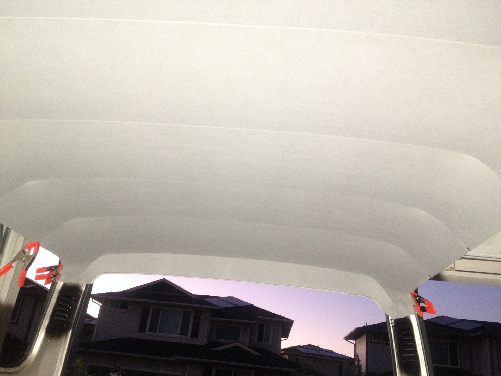

Did some headliner work yesterday. Probably the most frustrating work I have done in a long time. Still not perfect and I'm hoping these wrinkles will "shrink" out when it heats up some. Advice if I had to do it again.... only do 4" in the center of far back and get the pillars lined up first. Those are not negotiable. Used standard contact cement. Installed the grab handles.

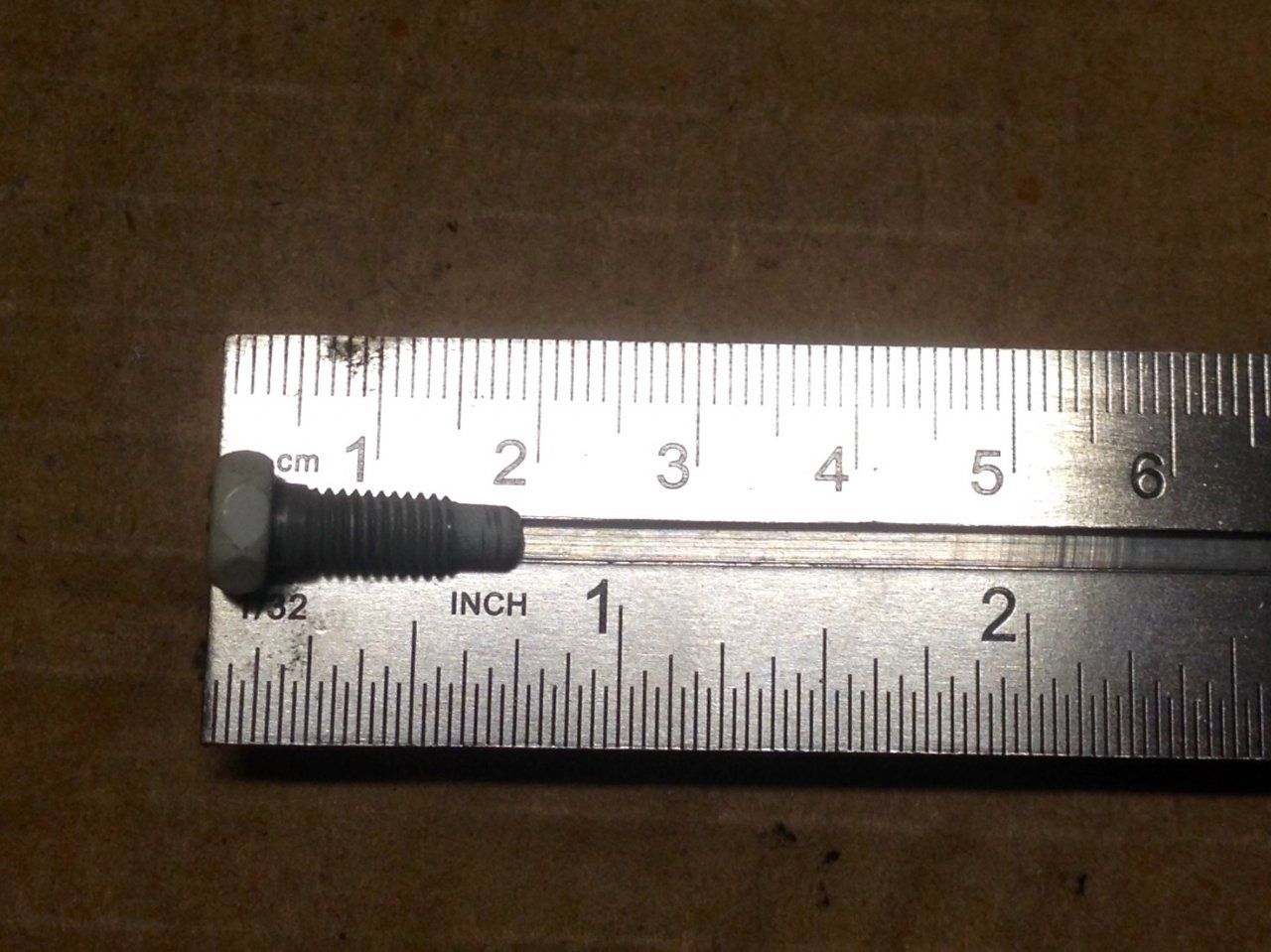

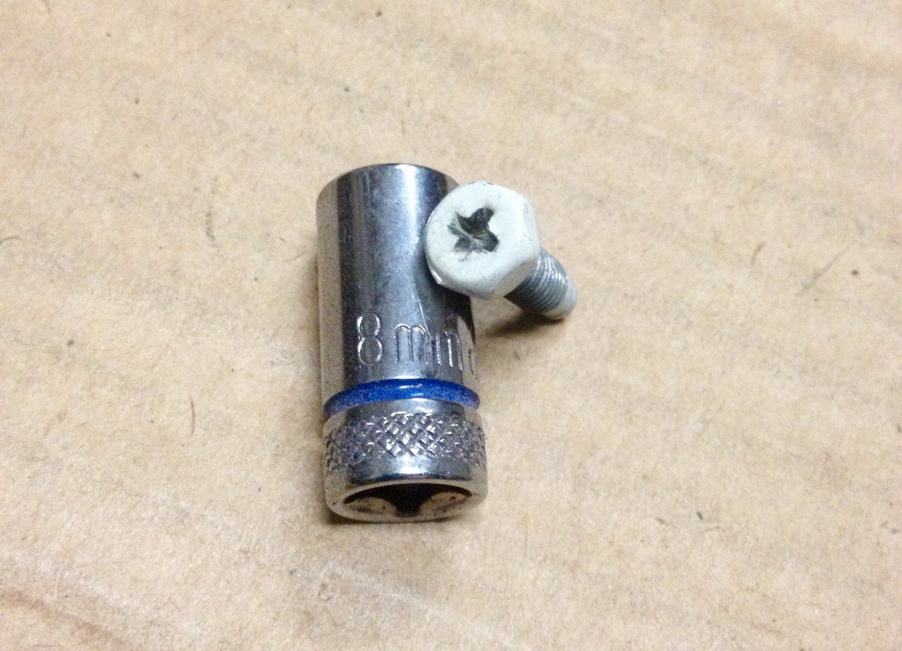

Need some help on the screws or bolts that mount the sun visors, rear view mirror, and both dome lights. After 2.5 years of parts strewn all over, I can't find the mounting screws to know I've got the right ones. Any help on these would be appreciated.

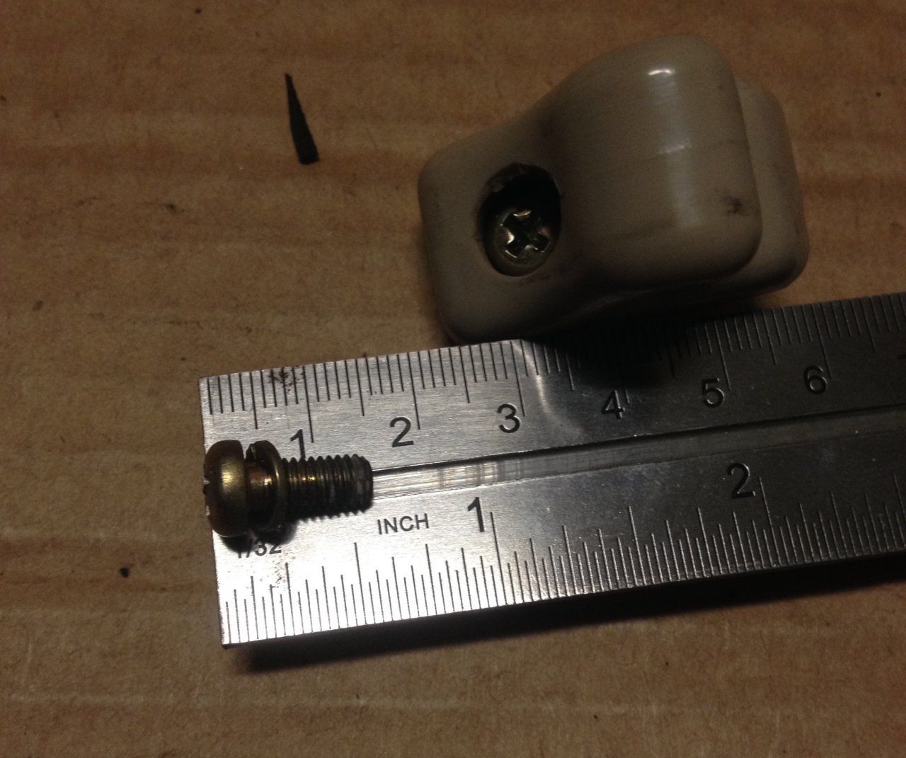

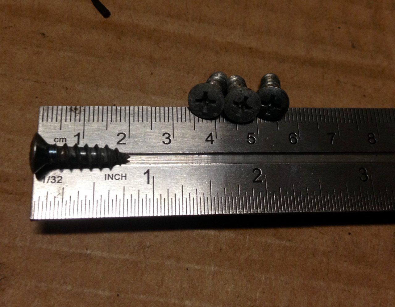

Have mine apart and out right now. Here is what mine look like and their sizes for the rear view mirror and visors.
The mirror has two 8mm bolts with a Philips top:
The visors mounts have four Philips head screws/ two on each side:
And the little tabs that the visor connects to has one small Phillips head bolt each:
Sorry if the terminology is all butchered for the hardware and parts, but it's probably pretty self explanatory from the photos. Also, don't know if it changed over the years, mine is an '85 HJ60. Hope that helps.

Headliner question. Will these wrinkles minimize with summer heat? Or the help of a heat gun, at a distance of course. Or and I stuck with headliner wrinkles forever. That was not an easy task. For future reference of the SOR headliner, get the pillars center and glued first and stretch from there.

Is it vinyl or cloth. If vinyl it will probably sag more over time due to heat and weight. Cloth will stay about the same. Need to tighten it up more. Are you using adhesive and the clips?
J
It's vinyl. Used adhesive and clips. It's all glued in and windows mounted. I can take the windows back out. The contact cement isn't too fun to get the edges off and re-glued.
Ok. Wait until is warms up and you can pull/stretch the HL more. Not what you want to hear, I know.. but it will make all the difference in the world when the material is warm and more pliable.
Start at one point and pull in a radius/arch motion away from the wrinkle. Work in small sections and clip more frequently. That area is a PITA due to the intersection of multiple pieces and widths of material.
I only recover w/vinyl in the warmer seasons or if I cover them inside the house.
