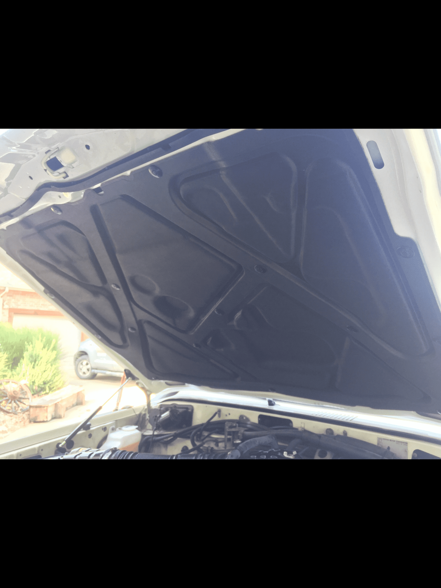

After many years of storing this OEM beauty, finally took the time to install after the seam sealer was put on the hood braces.

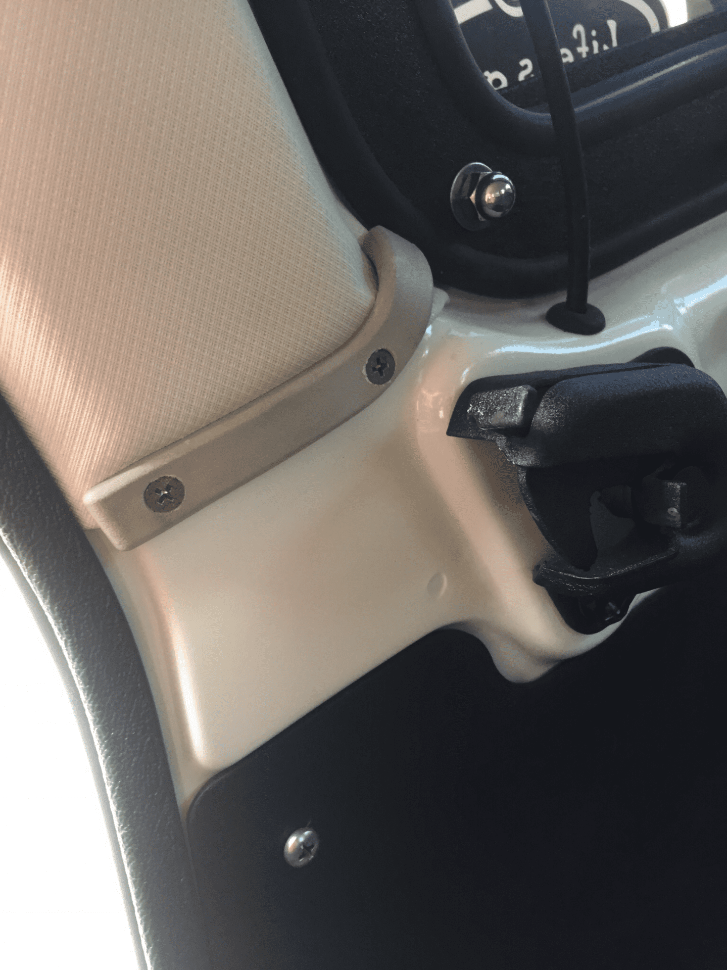

And finally found a set of these!! Headliner to metal transition on the C pillar
To clarify, the pieces are not metal but plastic. The metal is the body of the truck, without the plastic trim under the windows that is stock on US 60s. These small trim pieces are from a JDM 60. Tricky to find. I wish I had a 3D printer.
To clarify, the pieces are not metal but plastic. The. Teal is the body of the truck, without the plastic trim that is stock. These small trim pieces are from a JDM 60. Tricky to find. I wish I had a 3D printer.
Oops my bad. Re read that. Not metal. :slap: Very cool though!
