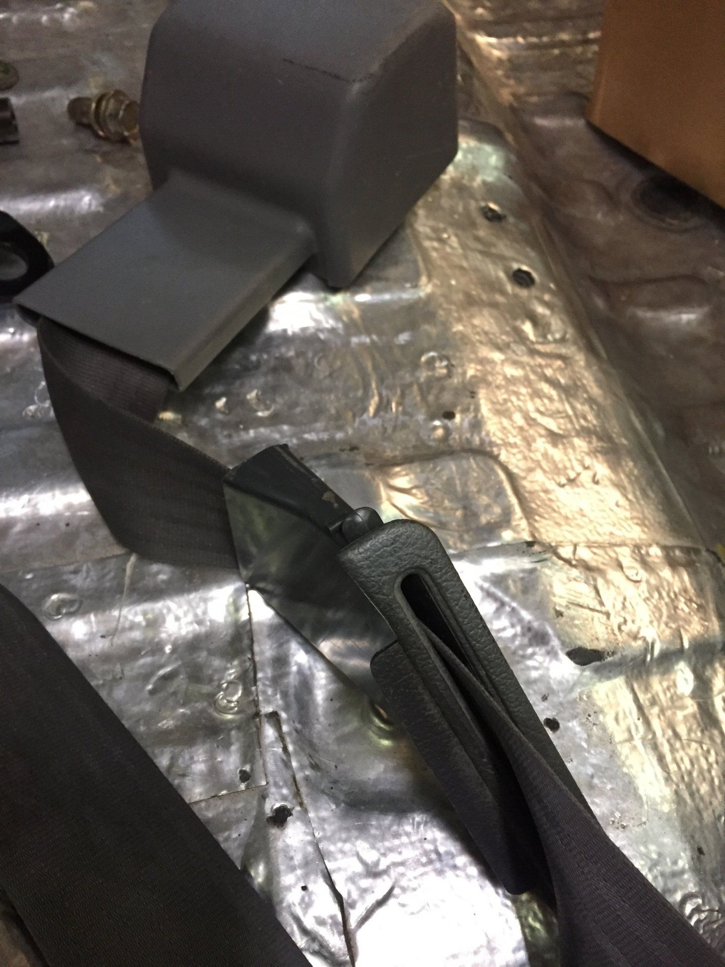

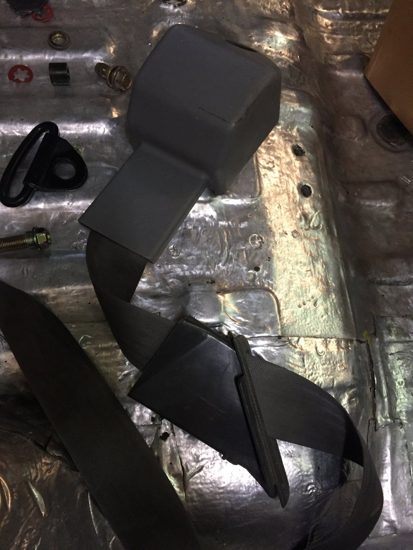

here are some seat belts I bought off mud to use in the back. didn't do much research much before I purchased. They don't work. the release ball never releases and they stay locked up all the time....so I'm working on getting some new OE rear should belts in rear, and all new in the front. I figured if everything inside the cab looked new except the belts, they would look even worse. so they are getting replaced.
But until I get the new ones.....anybody know what this angled piece on the belt is an where it mounts? looks like it might come through between the seats to keep the belt from rubbing the seat directly. but the way the belt sets are put together and marked R and L, I can't figure out how this whole business mounts. thought I bought 62 rear shoulder belts, but I have looked through the window at a local 62 and the recoil portion of the belt is behind the panel tucked into the hole. these look like they mount on the outside.

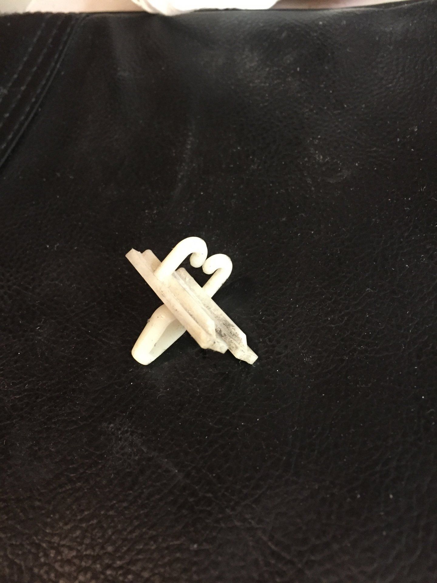

also, does anyone know where this mounts and what mounts to it?
That little plastic clip looks exactly like the ones that hold the "snake blinders" , the rocker panel chrome strip, in place.
that's probably right. I don't have those on the truck anymore and this was in my bag of parts. just trying to sort through pieces. thanks

The retractors have a weight that makes them lock up unless they are in a completely vertical position. This is by design to keep the belts locked in the event of a roll over. Unless they are held at just the right angle they won't unlock.
They don't appear to be from a 62. They look like possibly 70 series? Not sure about that.

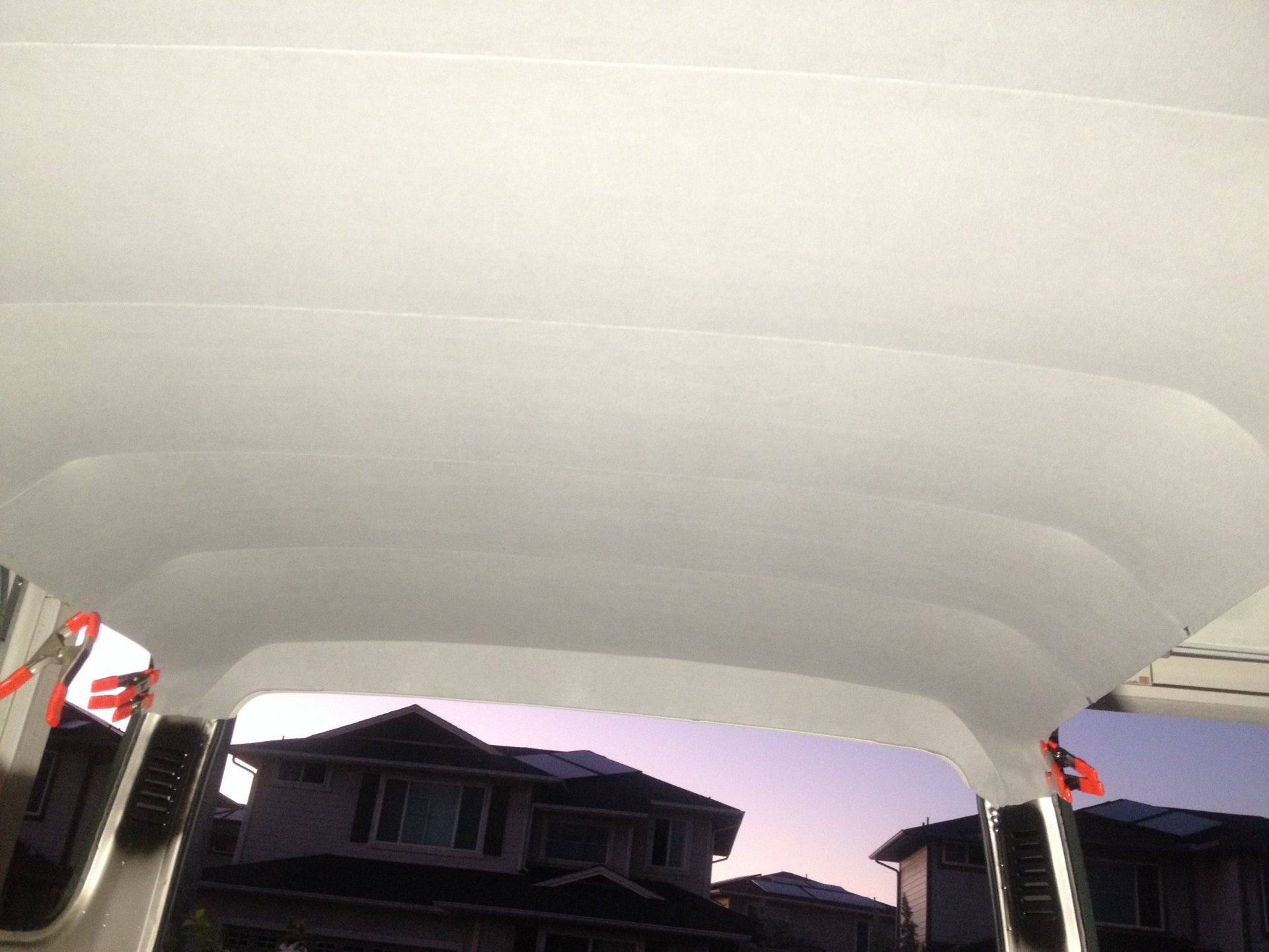

My husband has been installing the SOR grey felt headliner in my HJ60 for the last 3 days. I tried to help, but he was crazy obsessing about getting it perfect, so I couldn't hang. But it is near perfect, looks as good as the factory in my opinion:
He had never done anything like that before, and said it was difficult, but said he could do it in half the time if he were to do it again. I was going to do a little write up about it since I could find very little install info before hand to help him out.
Can I fly your husband up to Seattle for a weekend? :) This came out perfect.
