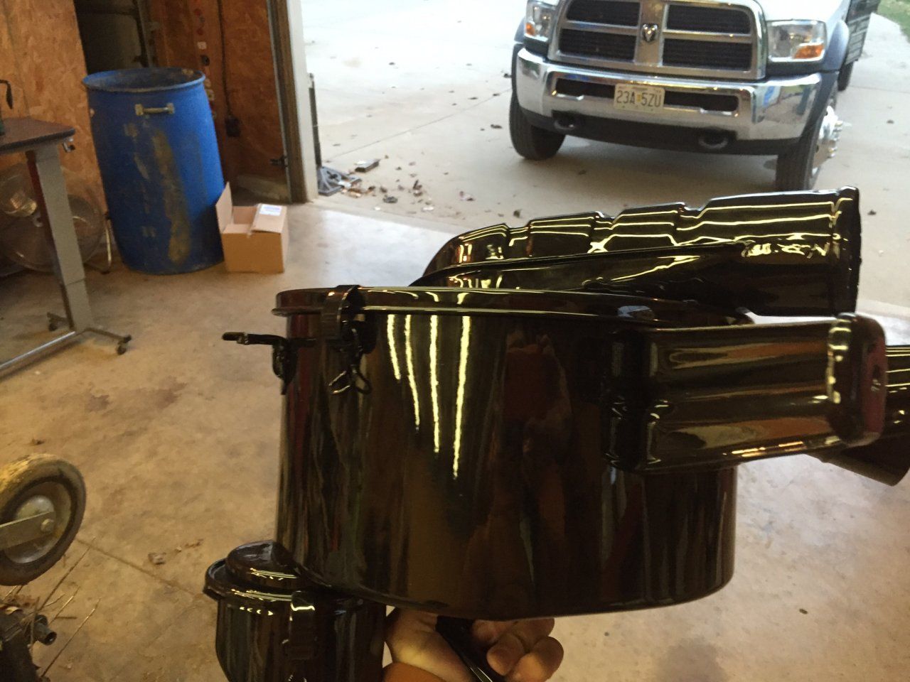

HJ setup I bought from "landcruiserjunky" here on mud. I think he had several. PM him and see. I had it blasted and powder coated. Already had the snorkel. Bolts right to the factory nuts already in the body. And snorkel hose hooks right up. Easy deal. Move the wiring and AC lines over. 3 bolts and its in. Got a washable OEM filter from Beno. The carb cap or horn came with the HJ setup, along with the hose. There is also a cool side can on the housing where dirt can fall down away from the filter. It sits right beside the charcoal canister. Had to piece two hoses together to get over to the valve cover vent hole off the top of the carb. Not ideal, but couldn't find the perfect hose.

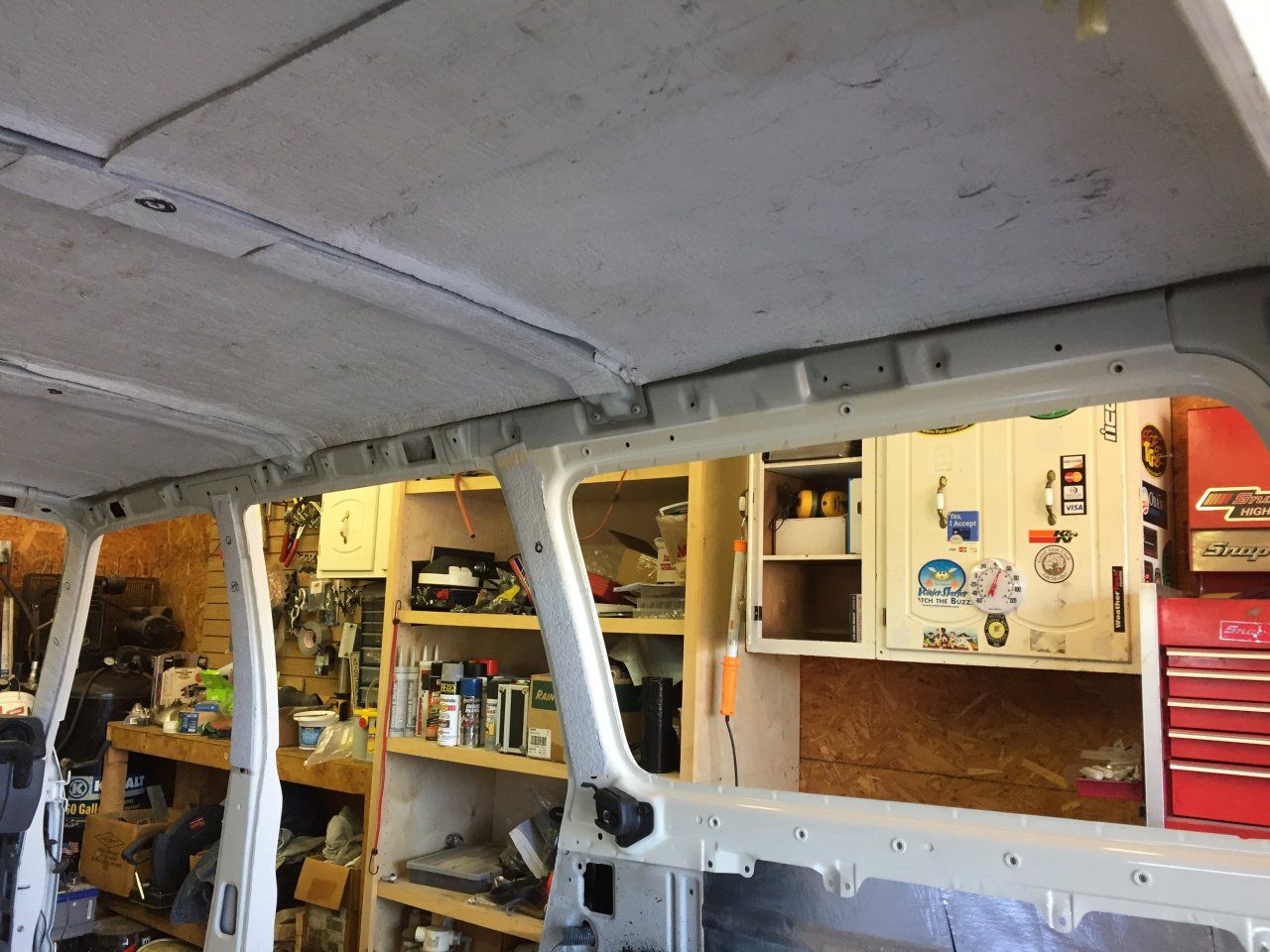

It was recommend to me by the guy that sells QuietCrap to not put the QuietCrap on the roof because of its weight. Would have been an easy sell and another full roll, but he shot me straight and told me to not do it. I think in the heat of summer, I could see how it my let loose alittle, then it's heavy enough to fall off I guess. It doesn't really glue on. It's just a sticky stuff that holds. Sides and floor it's great. On the roof, I scraped as much of the OEM wool off as I could. That 30 year old glue is tricky. It didn't come super clean. It doesn't go all the way to the edge anyway. I glued up some 1/4" closed cell foam like is used in pole barns. On the edges of the roof, there is a gap. I put the foam down in the gap as well as what you can see here. It's easy to work with. Next step: gluing up some jute wool like the factory stuff, then the headliner goes up. Got one from SOR. I had the foam on the floor for years, 2 layers thick, it never did anything to the roof. It always sounded like my windows were cracked alittle, so that's why I'm getting it into the side edges really well, and the wool will cover all the way down as far as possible without messing up the look of the vinyl headliner.

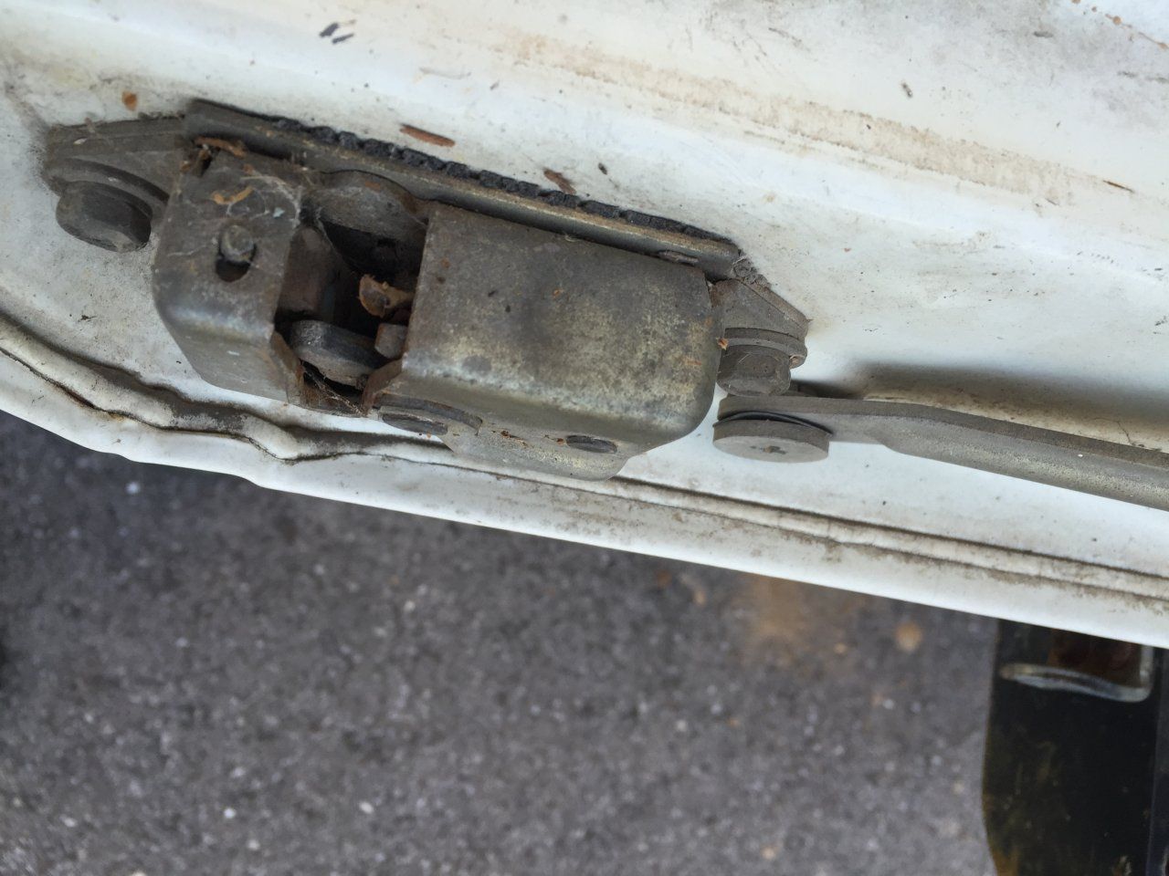

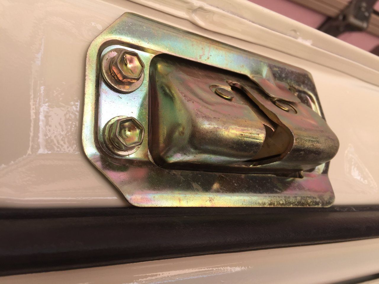

Any help on where these go? Somewhere on the rear gate or hatch latch assemblies. Can't remember. The 3 holed latch goes on the floor for the rear seat latch I think. But not sure on the flat pieces. Thanks
Is there a gasket between these assemblies on the sides of the tailgate and upper hatch latch assembly?

I've had a 60 in pieces, but never seen the flat pieces above, but could look like something between door latches maybe.

I can't remember any gasket on the tailgate assembly, I think they're straight against the paint.
I've adjusted them a few times, and haven't seen gaskets.

What part number is that washable air filter from beno? Looks great!

17801-61030

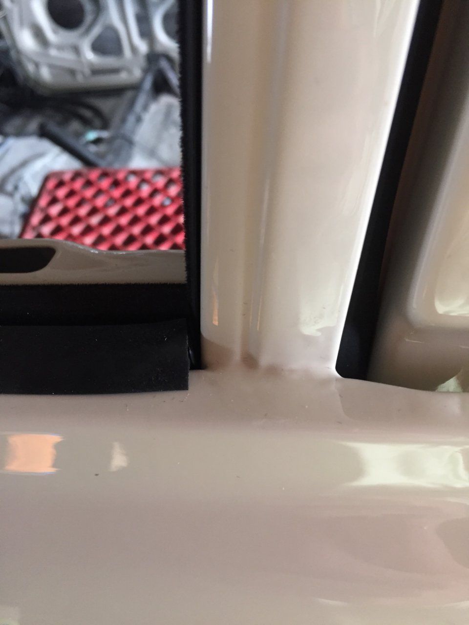

I'm going with the outer weatherstripping with no chrome. These don't extend past the ends of the channel like the chrome style does. So will these small openings be a problem down the road for water getting inside the door?
I've got the same openings with original new weatherstrips, without chrome as well.
Been bugging me to have that big of an opening, but haven't sorted it out. I just keep drain holes in doors in good clean condition en park it inside if possible (s***ty way of dealing with it, I know :D)
The strip will relax when it gets in the sun. Work the strip outwards a little and it should cover the full gap. For some reason it doesn't... apply a little dab of black urethane sealer to the edges. It blends nicely and keeps the elements out.
You can use silicone (I don't recommend them) but most silicone sealers contain acids that will break down clear coats and single stage paints. They don't last very long either. Be cautious of the one you get if you go the silicone route.

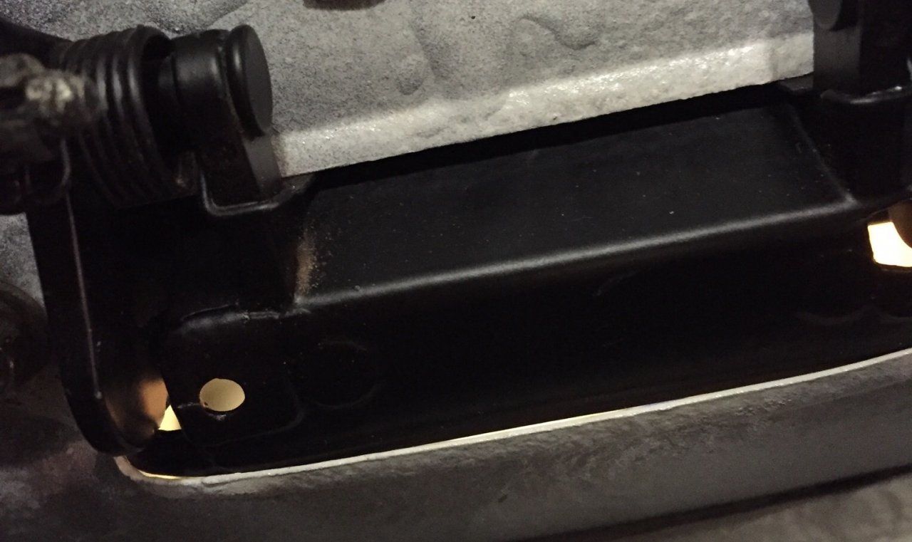

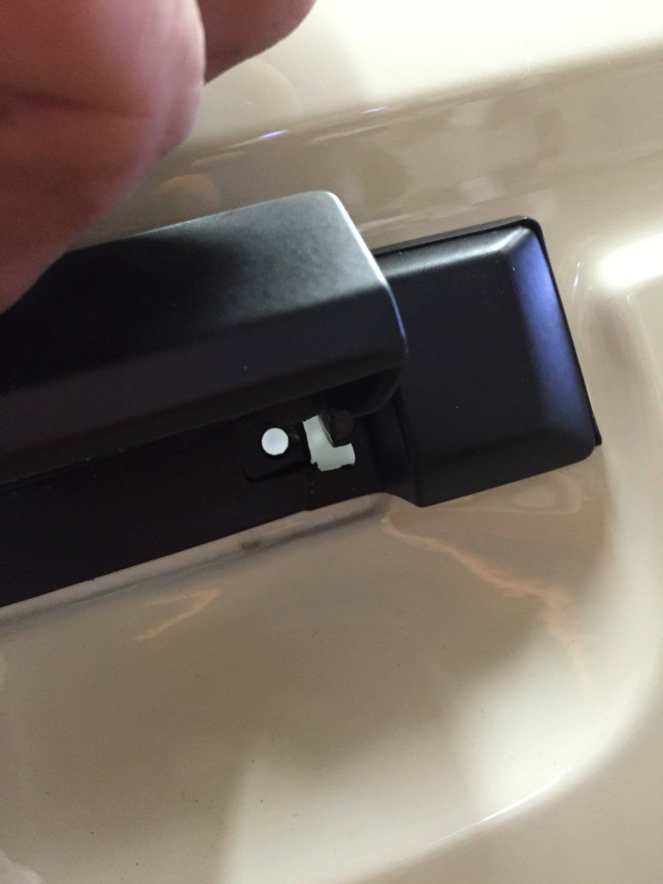

On the door handles, there are two small holes on either side of the handle, sorta hidden on the under side. Any pics of what goes in these?
Outside handle
Inside handle.
The holes should contain small rubber bumpers that quiet the door handle coming back down when you let go of it.
