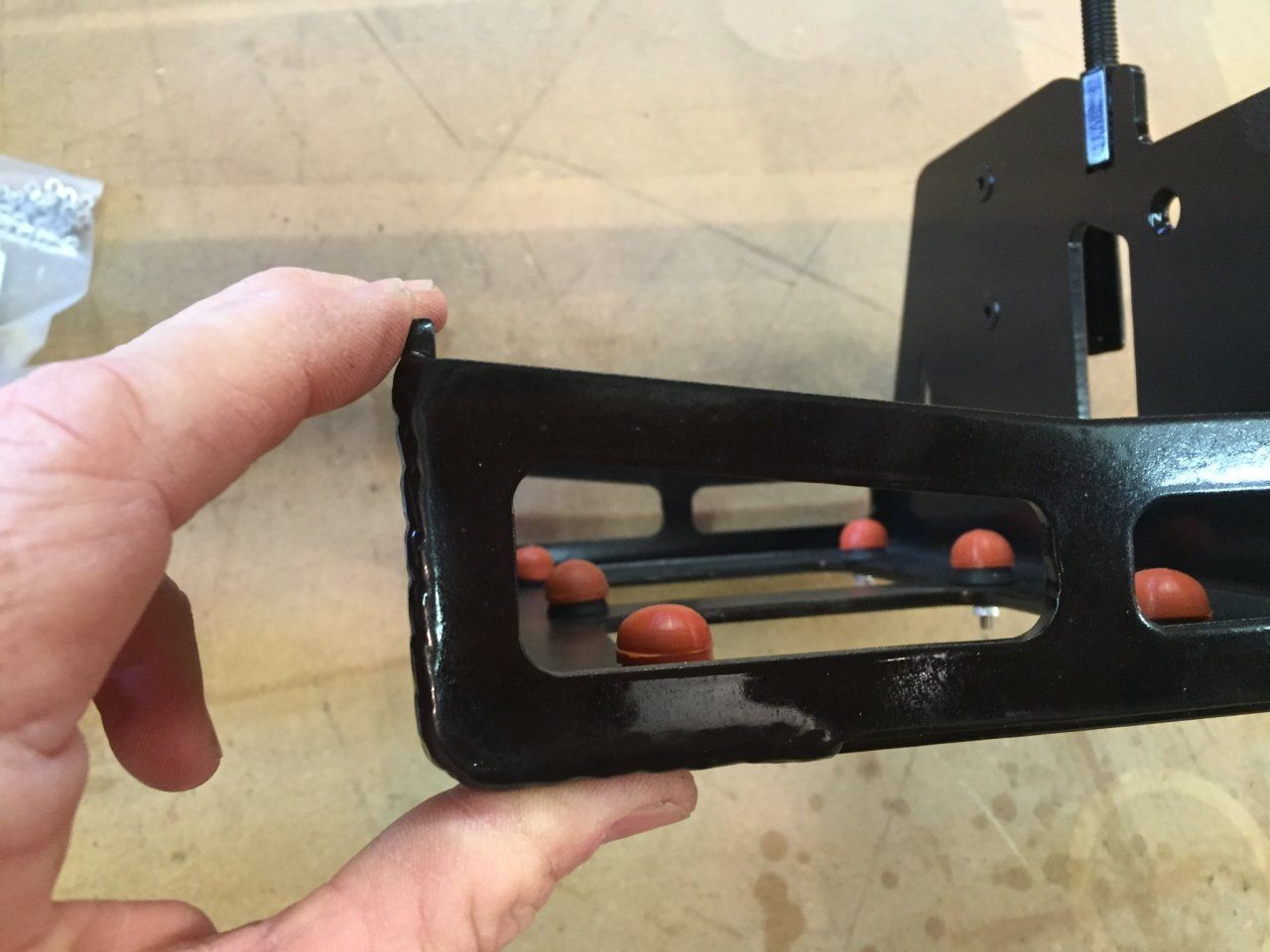

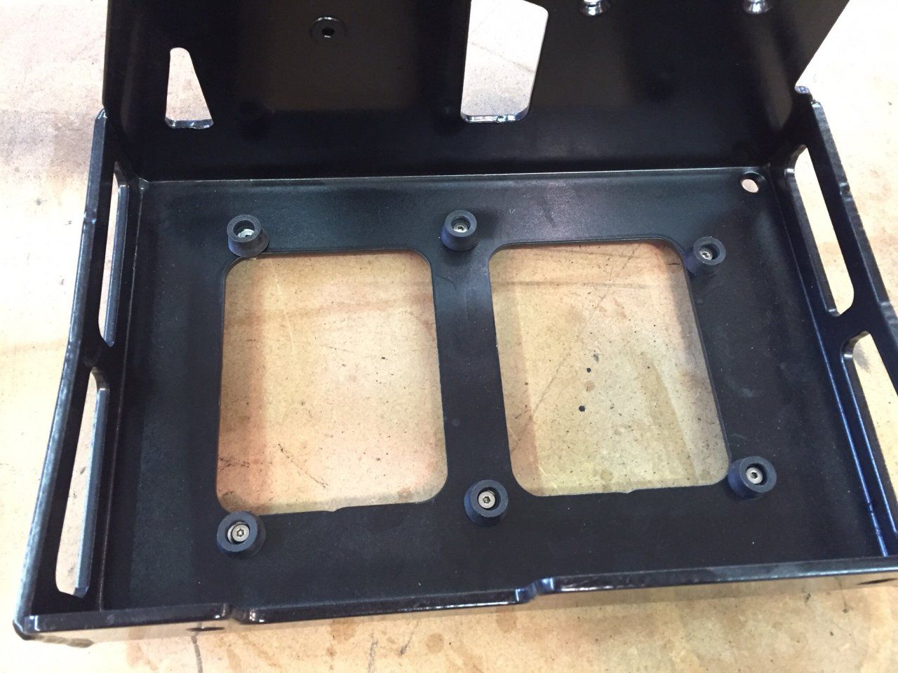

Added a small detail today. I've always been bugged how when the battery is removed, the bottom of the battery tray looks bad from the weight and vibration of the battery ruining the paint, eventually rusting pretty good. And I didn't want my new powder coating ruined. So I added some rubber feet so the battery will sit off the bottom of the tray. The top right one is intentionally off line so the bolt doesn't hit the fender below . McMaster Carr stuff. Low profile Allen head bolts, rubber feet with washers inside the bushing, and added covers so the holes can't get crude down inside the foot. The tray is a Man a Fre tray for the drivers side. OEM passenger side tray will get the same thing.

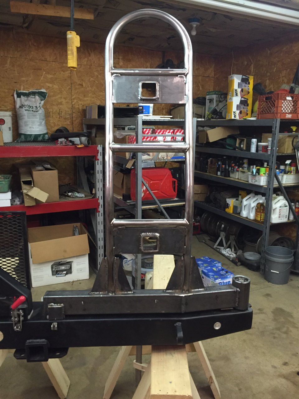

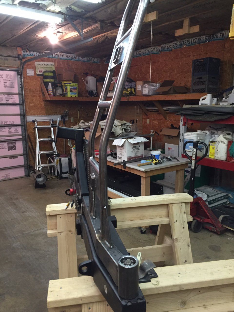

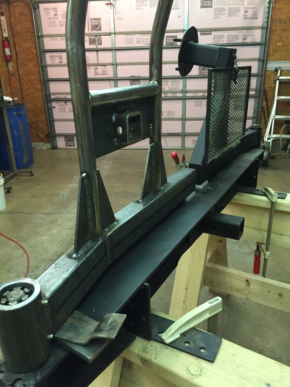

Here is a rear bumper sneak peak. Added a new passenger side swing arm. DIY ladder from #reevesci and fabled up the rest. New swing arm is supposed to come back from the powder coater today.

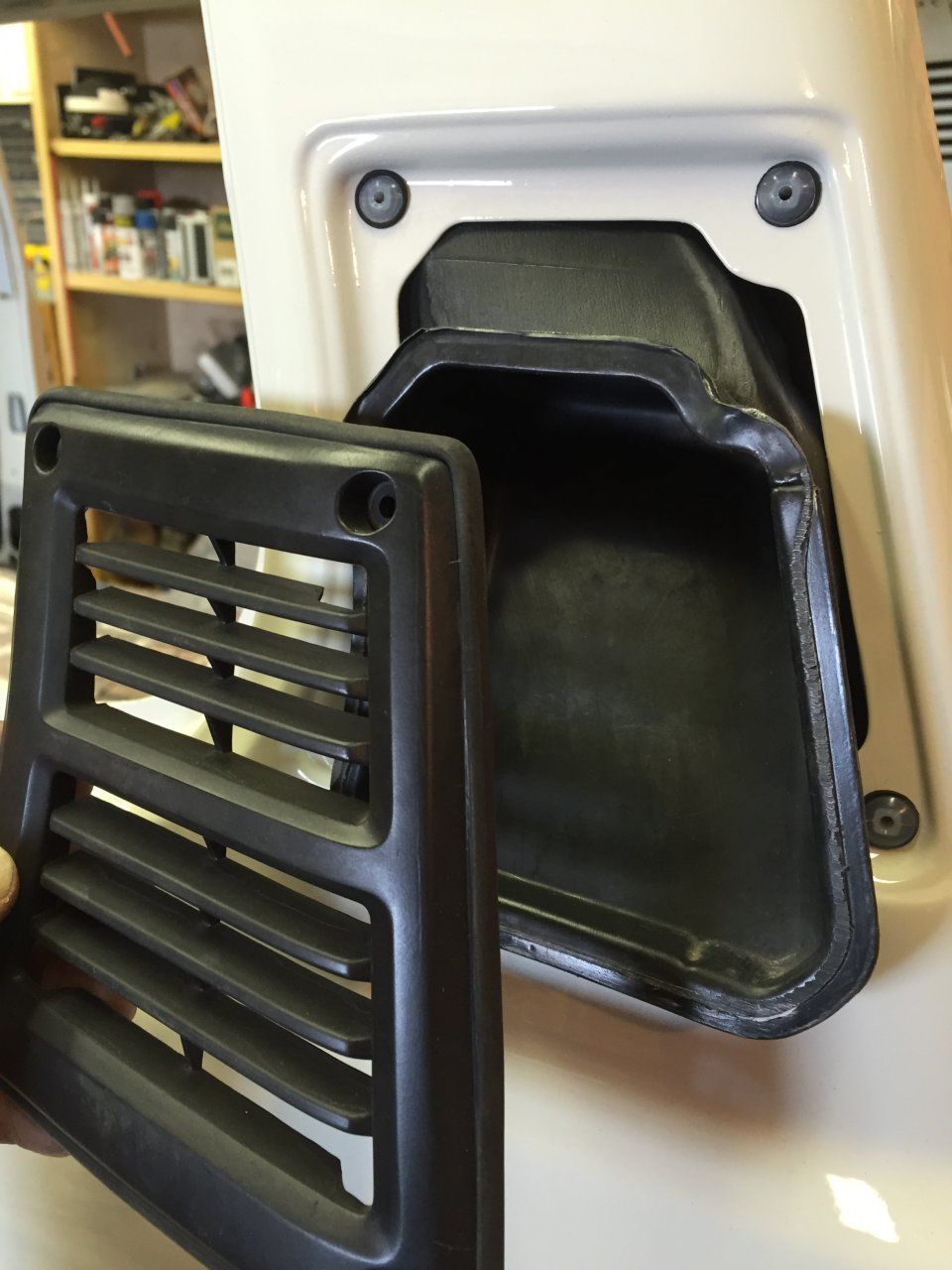

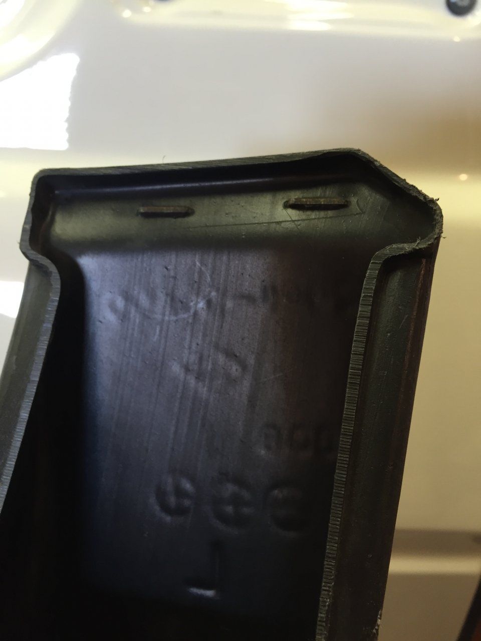

Got a question. Inside the rear vents on the back pillars, there are 2 staples on these vent tubes. Can anybody give me details as to exactly what was here attached to these staples? And was it on the side facing the inside or outside? I'm thinking some kind of flap but I would like to see it if possible
And is there anything between the two pieces shown. I remember a brittle cracked flap piece somewhere along the way in disassembly.

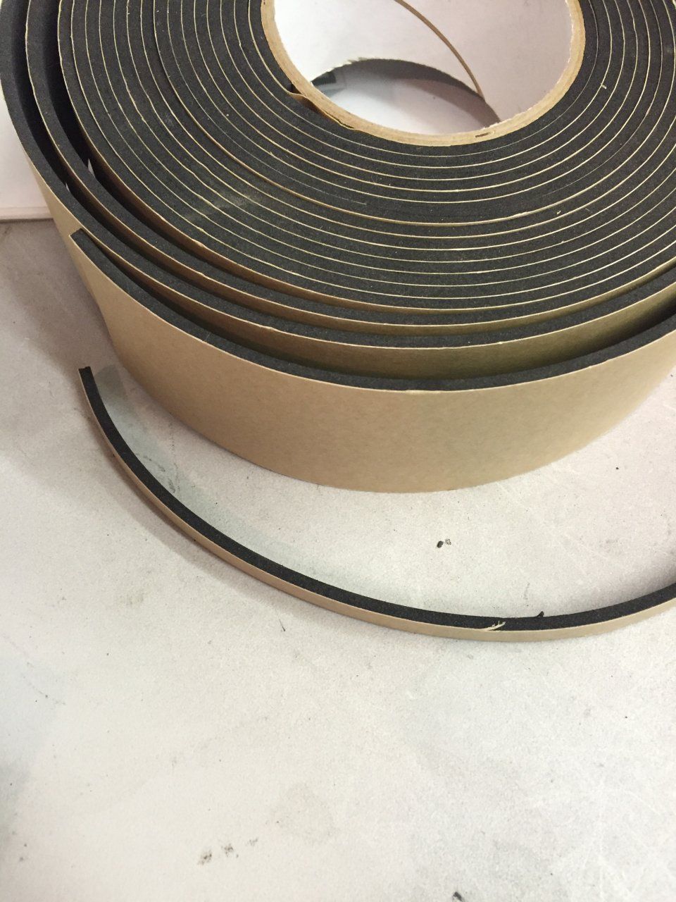

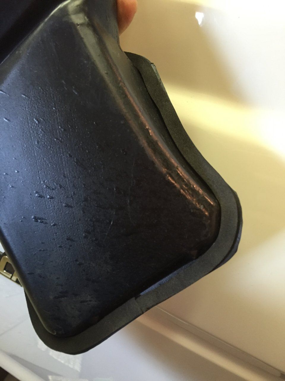

The foam gasket was ok but I wanted it new, but unavailable. So made my own out of some foam tape strips.
BTW, the outer vent has a gasket around it that is highly brittle. I would recommend not trying to remove it to clean under it. Almost guaranteed to break and they are NLA from Toyota.

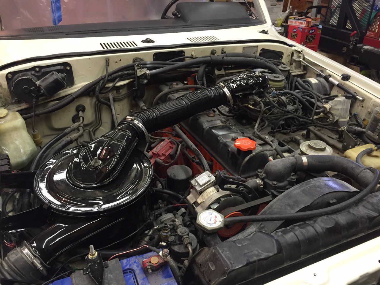

Got battery trays and batteries installed. HJ air filter housing and carb cap mounted. Still need to run the hose from the valve cover to the carb. Had to just search the wall at the auto parts store to find would would work. Also hooked up the headlight relay wiring kit from ARB to have brighter headlights, along with new headlights.
It's really bugging me how dirty the engine is compared to the new paint. They had the hood off in the body shop for 6 months. May have to give this thing a bath so the pics shine alittle better. But, after the hood and OEM Hood insulator is installed, then the dirt and dust will be covered by shiny paint).

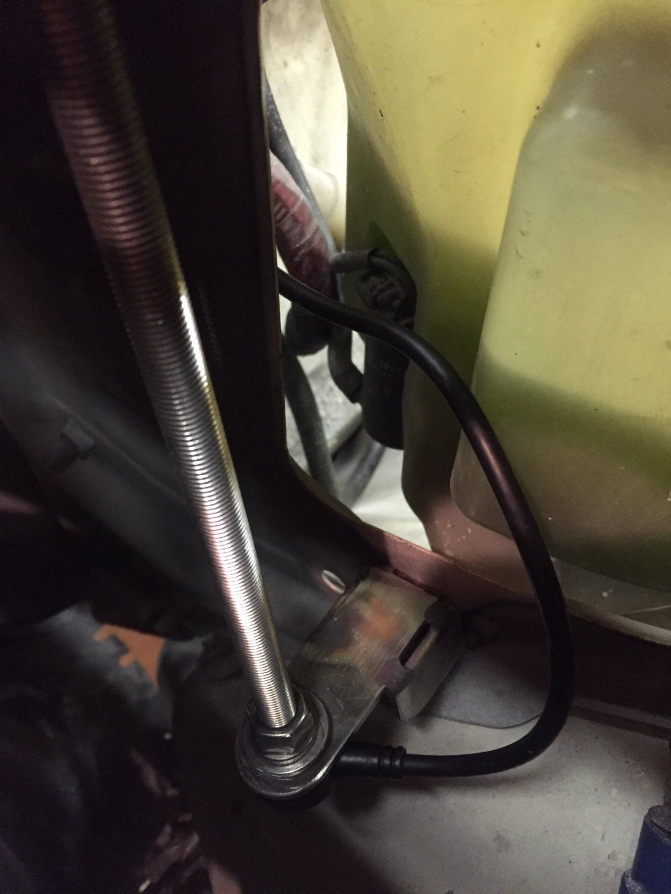

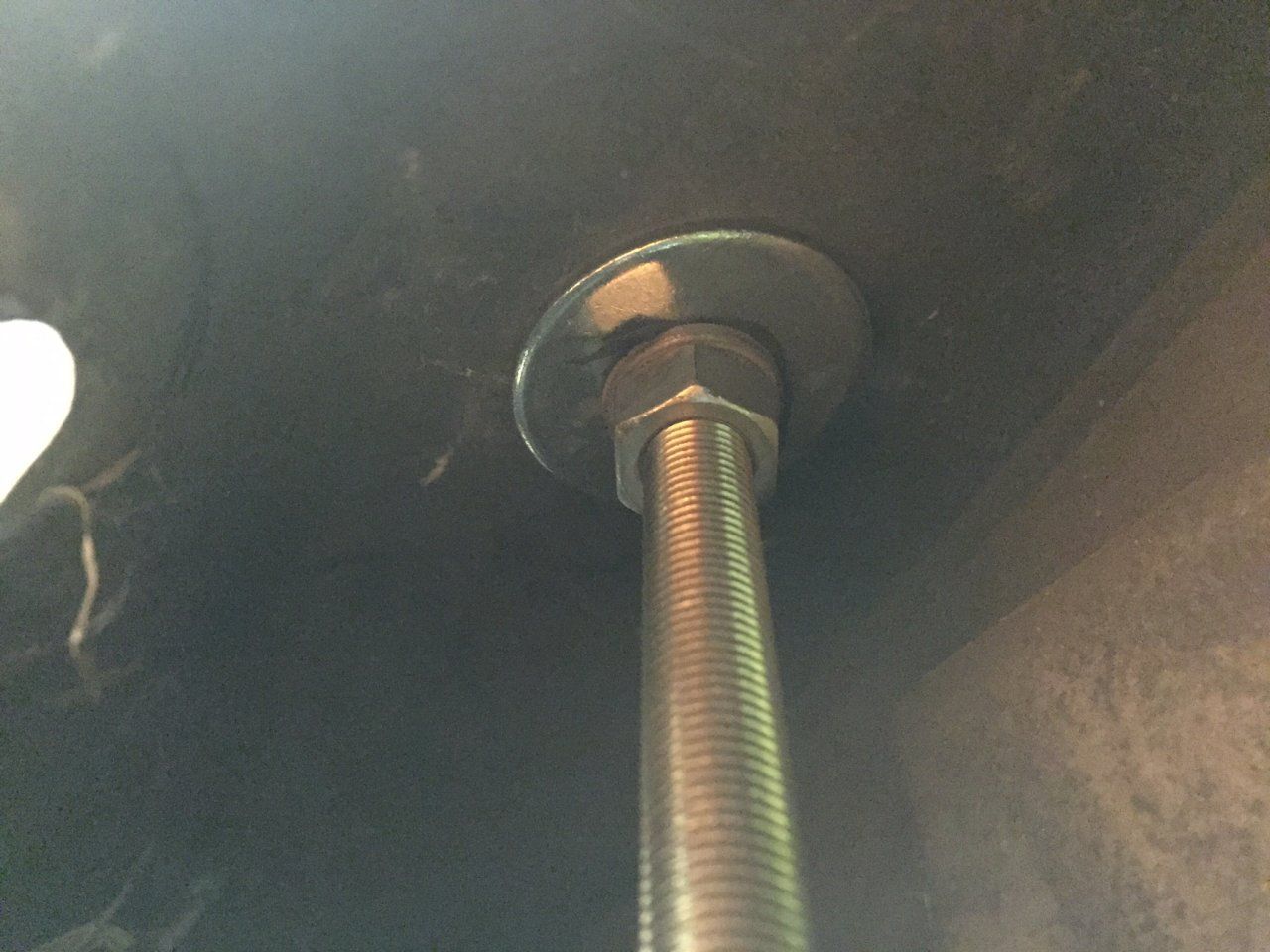

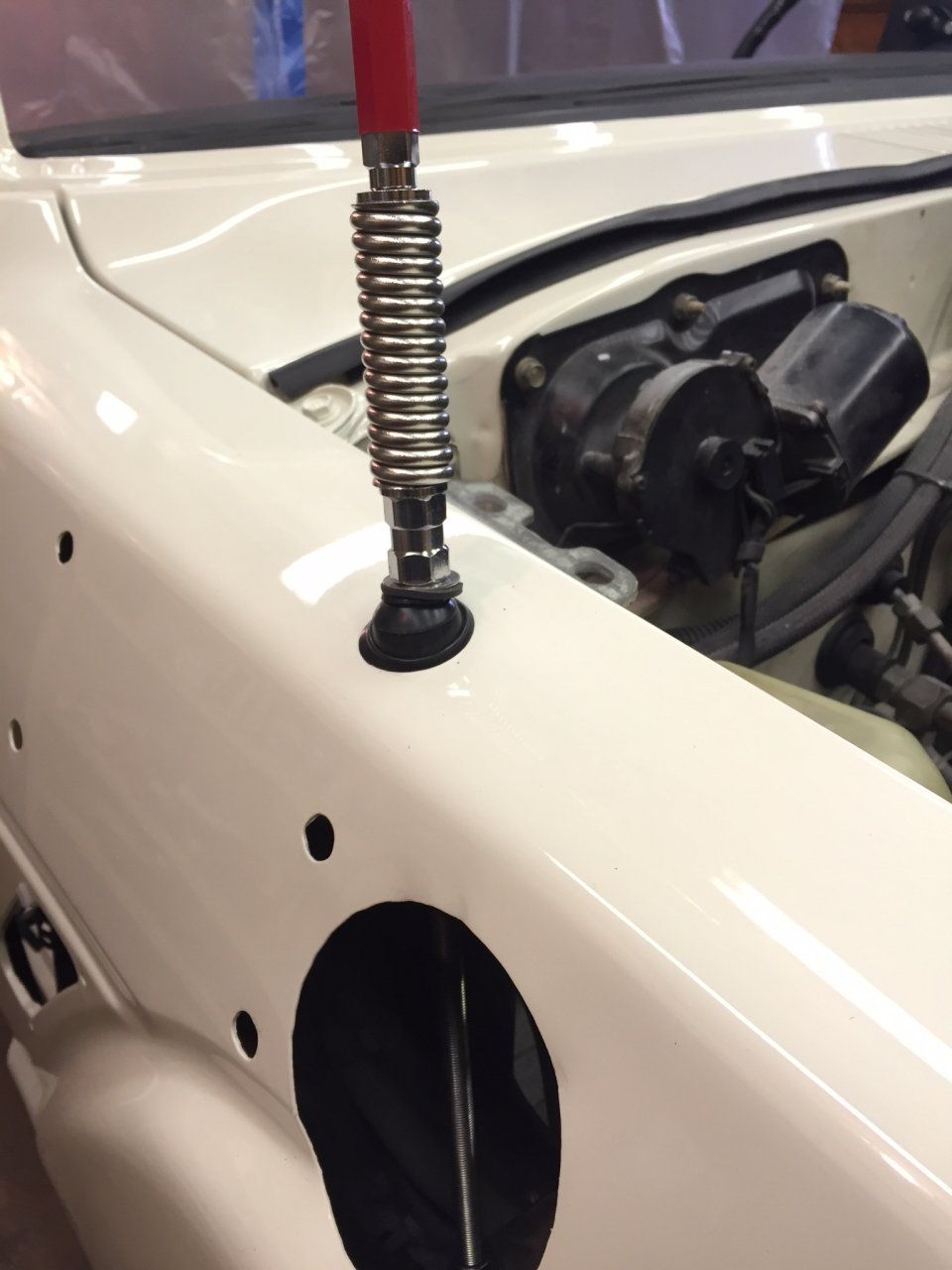

Got the Wagongear design dual antenna mount all set up. (Thanks to Reevesci for this one.) On the antenna mount, I added an additional nut and fender washer on the inside just under the top where it goes through the fender. I didn't like how the fender sheet metal started to flex with the mount tightened.

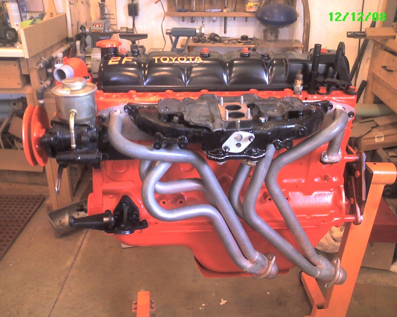

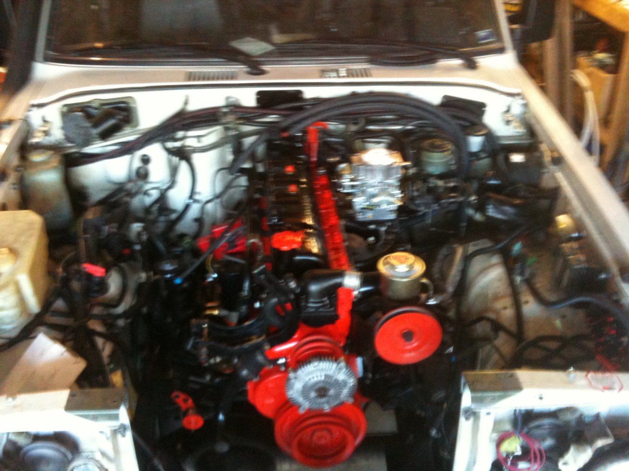

Here is the engine when it went in after rebuild. This was several years ago, but still part of the build. Still wish it looked this shiny. I can say this. No matter what, if you have your engine out, get the engine bay professionally painted. I didn't and regret it. Rattle can just hasn't held up well.

So wait... you are using an HJ air cleaner with a long tube and cap for the carb? Any detailed pics and info on this?
