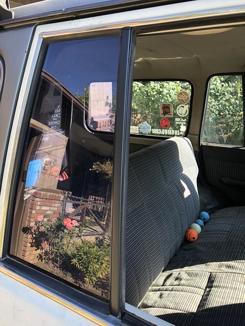

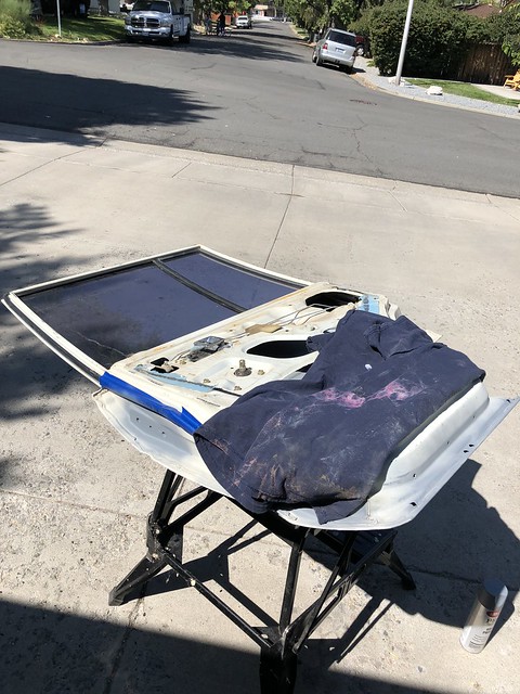

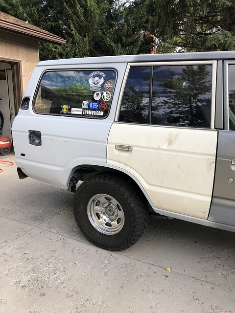

Well as many of you saw, this weekend I tackled some more body work and rust. Took care of the rear passenger door and replaced with the spare I had from @KWalkerM. Then took care of some rust at the bottom of the front passenger door. Unfortunately, that turned out to be worse than I had anticipated so I did what I could, treated with Rust Converter (Prep & Etch) and then threw some body filler over it. The corners were rusted pretty badly but not completely through the door skin. Eventually that door will need to be replaced too but for now I believe it will be fine. Just one spot I will be sure to keep an eye on over time.
Untitled by Greg Fisicaro, on Flickr
Bottom of the spare door and the hinge locations had some surface rust so I cleaned it up and primed. Fixed couple small spots of rust that I found around the door sill and dog leg. Same thing, take out rust as much as possible to good metal with an abrasive disc, then Prep & Etch until it turns black (converts).

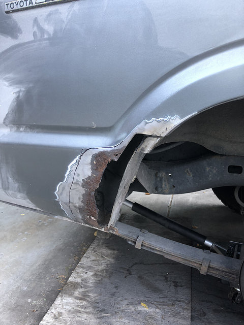

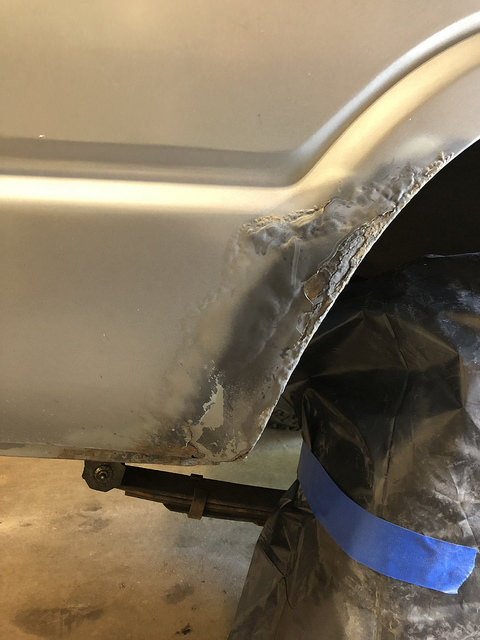

This is the true rust/cancer that will be the final part that needs to be taken care of for body work before I paint.

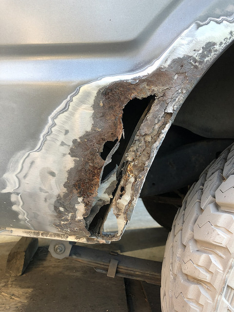

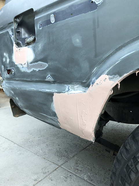

A while back I had gotten down in that fender well, looking around and found probably 3lbs of mud that was used to create that corner by one of the POs. That is NOT going to be a fun fix but as you can see it HAS TO BE DONE! Got metal set aside to replace, I am seriously hoping it is only limited to just that area and has not spread the entire length of the panel. Plan is to take over the garage starting Thursday night and see whats-what. Wish me luck on this one!
Started the "fun" last night and Oh Boy!!
Literally like 3-4lbs of Mud used to make that corner. Bad part is it was just slapped over the rusty metal and into the hole that looks like it started at the very bottom. Probably was fairly small when it first started out but just grew over the years.
Tried to save as much good metal as possible but in the end most of that corner had to come out.

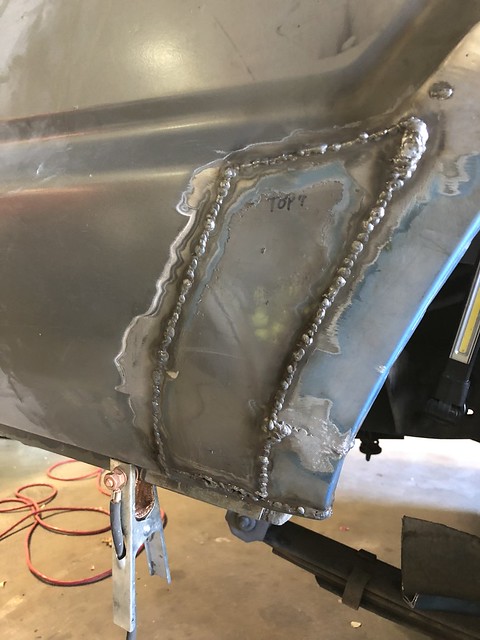

Luckily I had one last section of wheel well/fender from back when helped @RAYJON disassemble a cruiser at his old house. There was enough of the lip left that I was able to fabricate something. Won't be perfect but nothing on this truck is and that is what gives her character!!!
Got to fabbing a piece to fill in the top opening before the body seam but then realized it was getting close to 11pm, had work this morning and I am sure that my cranky ass neighbor loves to hear the grinder going at that time of night. Anyways, will hopefully finish up getting the patch panels in tonight and finish up a majority of the welding so that way I can work the body lines over the weekend and prime.
Oh and what you are looking at is probably about 5-6hrs worth of work. Started right around 5pm yesterday and ended right around 11pm. With small breaks to let welds cool, dinner and chatting with the wife, probably all together a good 4hrs of fab work. Sometimes stuff like this sucks but it is always FUN!
So stoked to be getting this finally finished so that I can paint in the coming week!!!

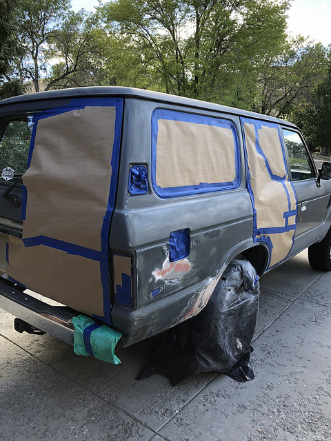

Got in some practice on the drivers side panel last night with the HVLP spray gun. Threw down 4 coats of primer (whatever I had mixed in the cup) to get a feel for the gun and for my compressor. Seems to have gone pretty good, not perfect but didn't expect it to be. This was covering up small bits of primer that were rattle canned on from when I had done the rust repair on that side.
Still got to finish sanding the body filler on the other side then I will paint that panel. But that day will potentially be a bit more involved since there are spots on the hood that need to be knocked down (rock chips that went to metal and now have slight surface rust) and then I will probably hit the entire passenger side since I have done so much work there.
And like I said, pushing to get this done ASAP. Started at about 5pm last night and went until about 7:30ish (when I ran out of light) and by that time temps had already started to dip into the low 70s. This time of year we normally sleep with the backdoor open to the sunroom and dog run and when I got up for work this morning it was 62 in the house. So yea, getting cold quick!

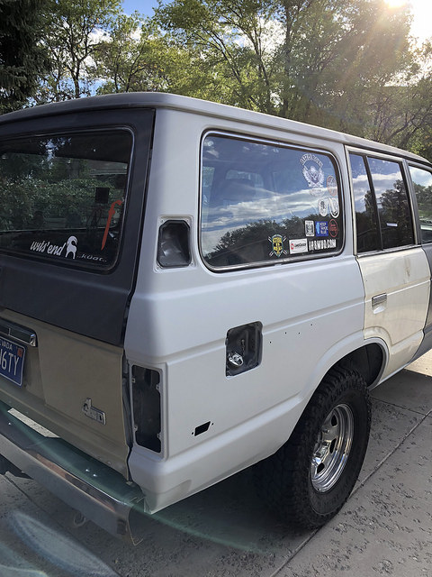

So few updates from yesterday.... ended up taking half the day as a "mental health day" and started working on the truck around 1:30pm. Sucky part was wind started kicking up around 2 which made taping off everything difficult with the butcher paper that I was using. Think I am going to splurge and grab some drop sheets as that will make life much easier (at least in my mind).

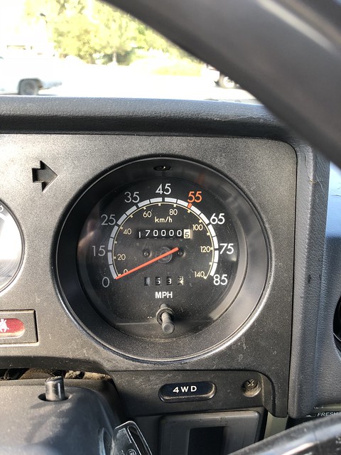

First thing though... BeBe had a bit of a birthday yesterday as she turned over 170k on the odo (not right, closer to 200k) and I have officially owned her for 6yrs now!

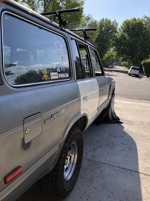

Now paint prep and priming... Think I am going to end up sanding down and priming a majority of the truck. Pretty much every surface has or needs work (small rust pits and surface rust from rock chips, scratches, etc.) so that is my thought process behind priming the entire truck. This weekend we have family stuff so probably tomorrow I will attempt to get the front/rear passenger doors off, primed as well as the body in those locations.
Before
After
