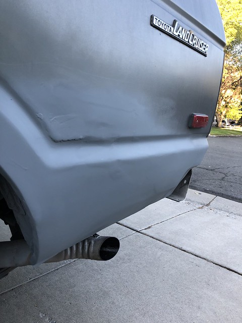

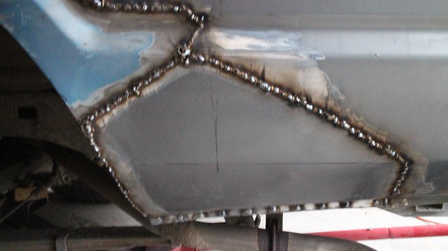

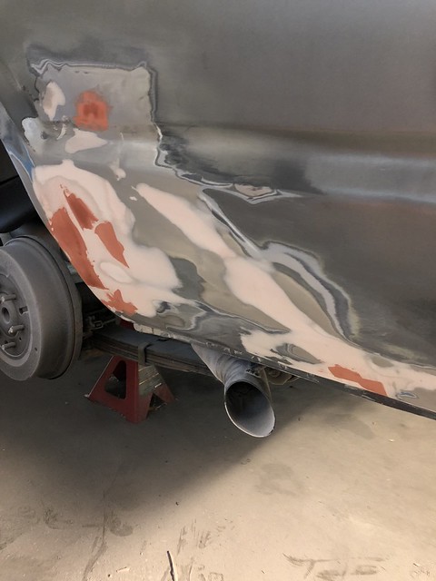

Got some time this weekend to finish working on the drivers side body. Well almost finish, want to work a couple areas down and was somewhat difficult with the limited tools I have (small electric 1/4 sheet orbital sander vs. real da sander).

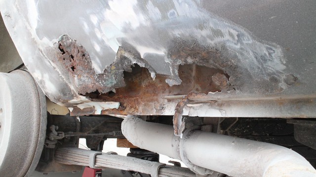

This is what was originally under everything. Lots of frankenstein patching to get things together after replacing pretty much everything from the wheel well to the back corner. This was the last part.

Going to stop by the local paint supply today to hopefully grab a small thing of 2k primer and finish out that entire panel this week. This weekend will be dedicated to the other side and replacing that wheel well with new steel and then doing some other touch-ups here and there.
