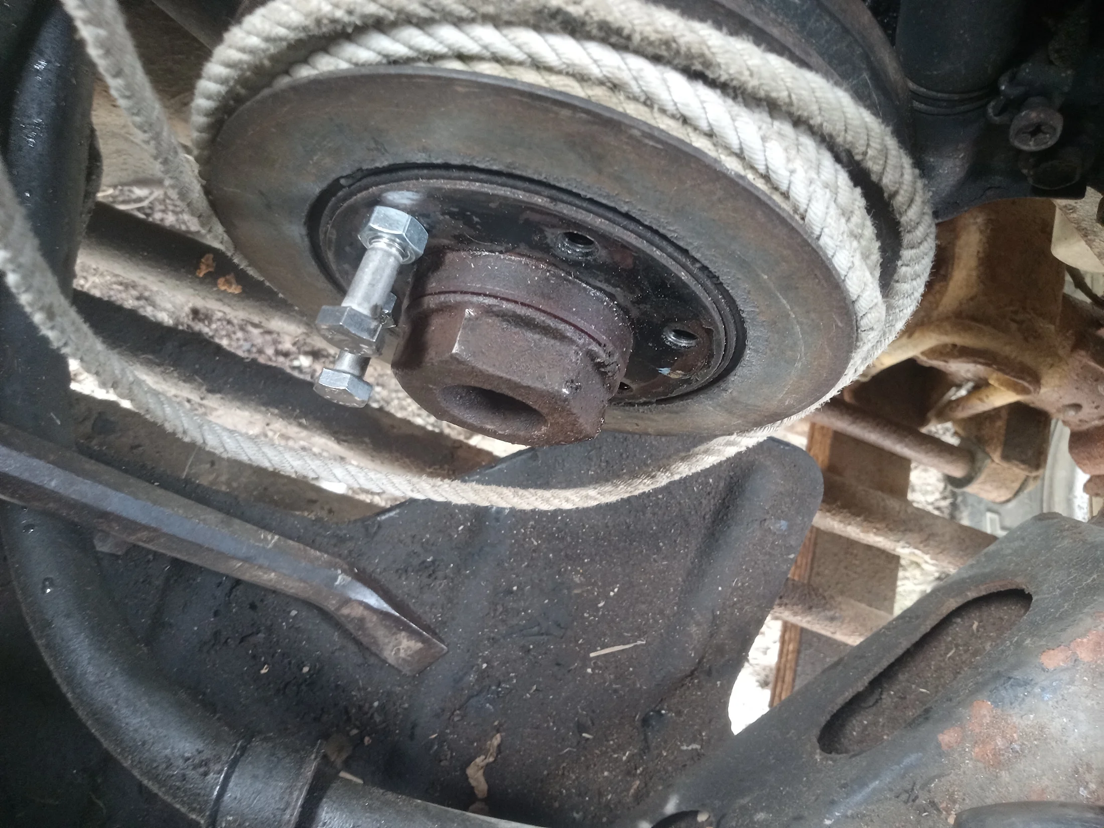

I'm working on pulling the crank pulley so I can take the front cover off. The bolt is being an absolute bastard to try to get loose. I've tried the starter trick. Nothing. I've got rope wrapped around the pulley, with bolts screwed in the power steering pulley bolt holes, with a bar jammed between them, all to keep it from turning. And giving it all I've got with a two foot wrench, I can't break it free.
Anyone got any advice?
Also, why is it hollow? I kinda worry about snapping it off. Is it actually a nut? The service manual calls it a bolt, but I can't make out in the illustration.

Damn, you sure do have your hands full with that beast. I've never done that job, but was watching a You tube video where a guy finally got the crank bolt loose on 80 series with a high voltage impact wrench.
Yeah, I'm starting to understand a big rattle gun is the preferred method. Shame I don't have one of those :P
