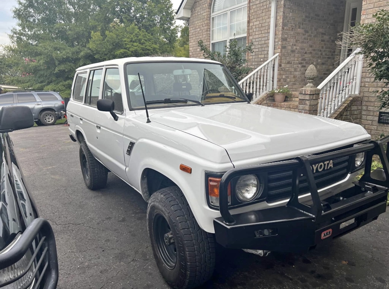

After selling my white 1983 FJ60 in 2015, I again purchased a 1983 white FJ60 (in worse shape and for way more money than a decade ago) but I just missed it too much not to get another.
The good:
Frame is rust free
Most of the bondo work actually looks half decent
Runs good most of the time
Interior is mint
Barely broken in with 265k
The not so good (and what’s been fixed)
Overheating in stop and go (coolant flush 3x, water pump replacement, fan clutch, new belts, new T stat seems to have fixed)
Massive exhaust leak (remflex gasket seems to have been a decent solution. Used some copper crush washers to account for tri-mil header vs intake size, didn’t work initially so added the washers and some JBweld steel stick around the gasket (don’t judge me until you try it)
Running seriously rich now that the intake gasket isn’t sucking in an extra 500cfm of air into a Weber 38/38 (Fuji carb is in, waiting on the isolator for install)
Nice little shimmy and shake at highway speed (not sure on this one, bearings seemed fine, road force balanced the tires, and removed the front drive shaft (a little wobbly at the double cardan, rebuilding now) and shake still persists. You know those magic hands at the old motels that you’d pop a quarter in? It’s a bit like that, some might say dangerous, I’d say free massage)
So far, I’m loving it again (or will be when it’s not running so rich it’ll foul the plugs in 1 hour flat)
I’ll keep updating as I work through the little issues
Excited to be back on the forum trying to fix things myself with no knowledge, a slight buzz, and a great attitude.
