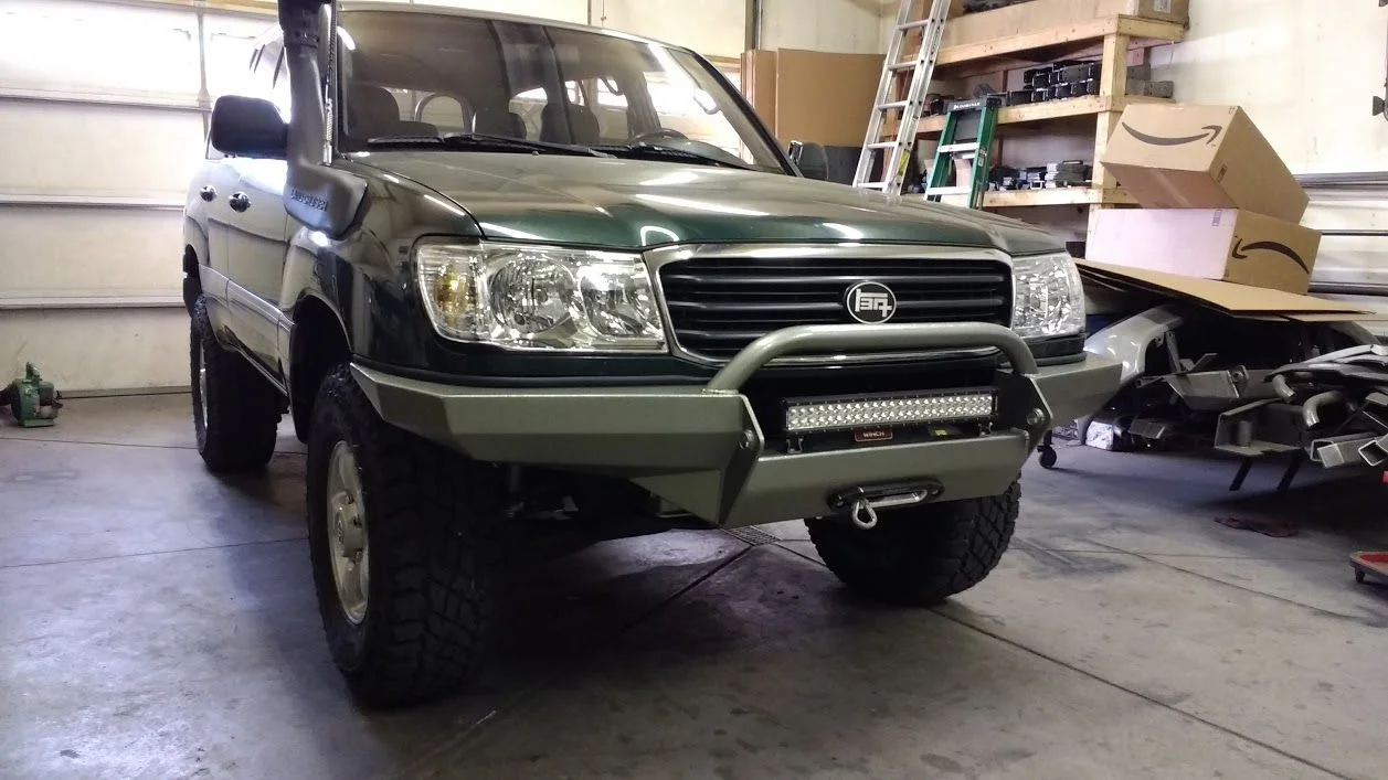

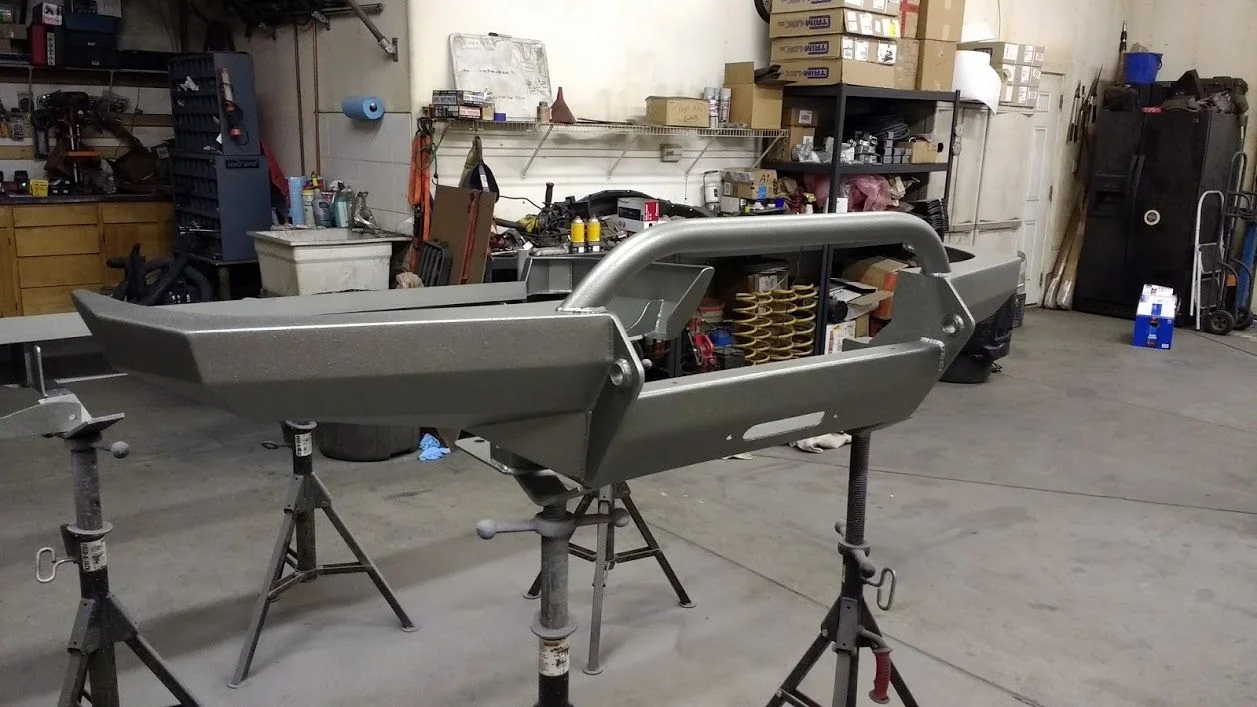

Damn nice work on the bumpers! Good info on the foam. I haven't played around much with the Gatorstep, but if it's that wimpy no thanks! I just got back from the hospital after having a surgery, so it will be a short while until I can get around. But I'll scratch it up and report back!
Thanks for the compliment on the bumpers.

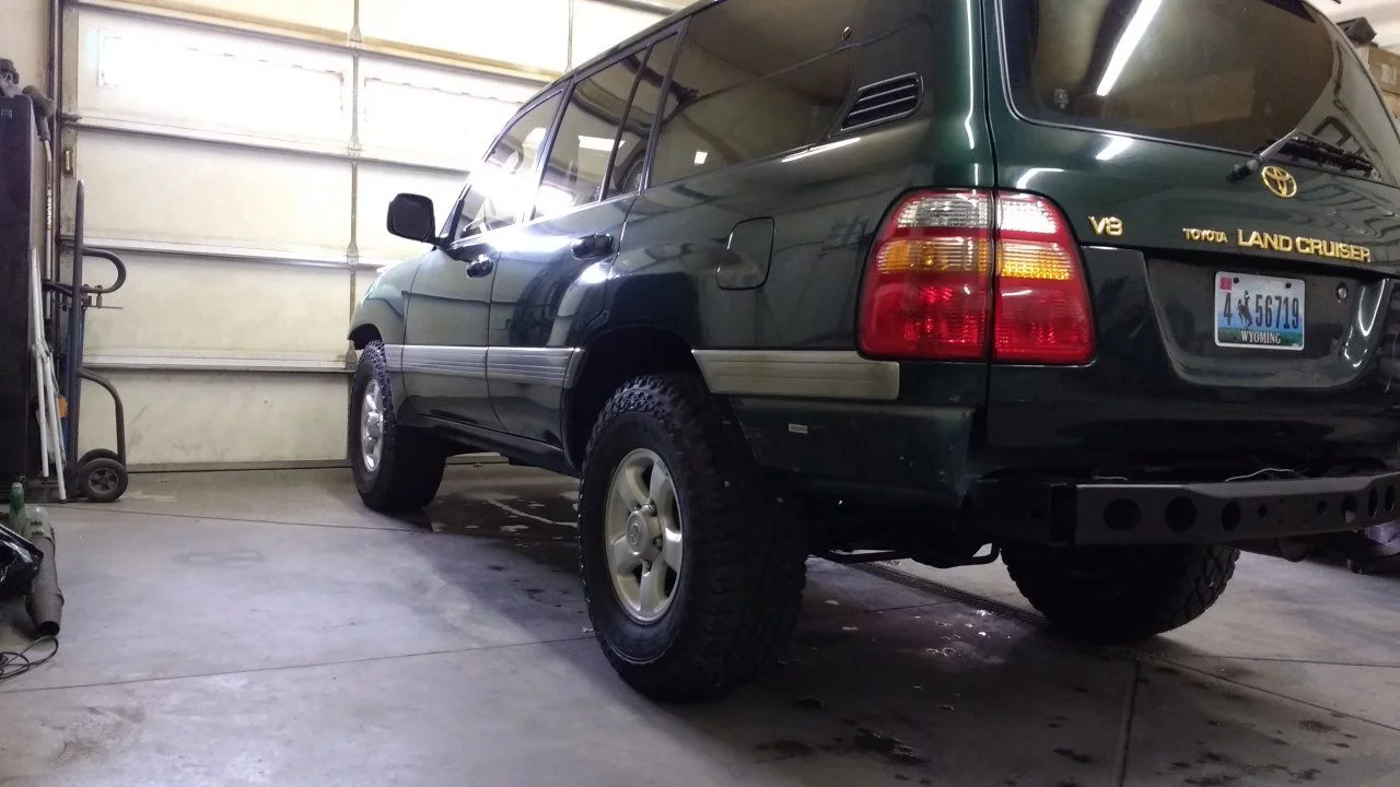

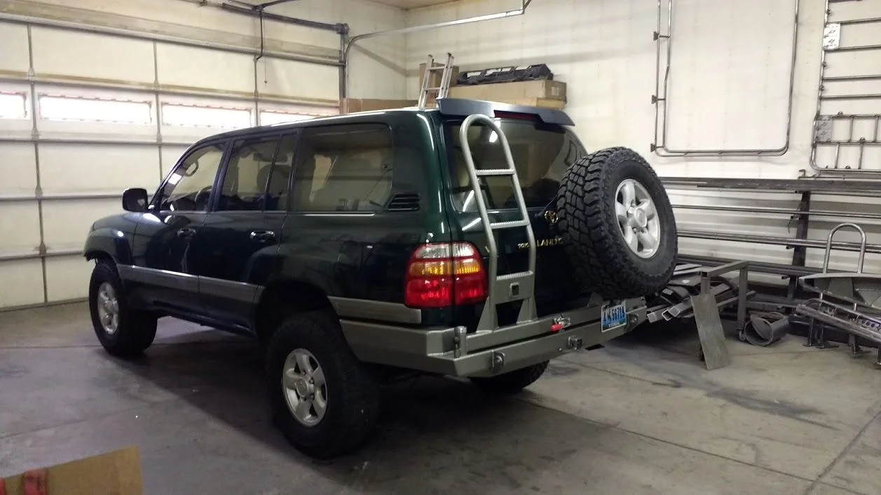

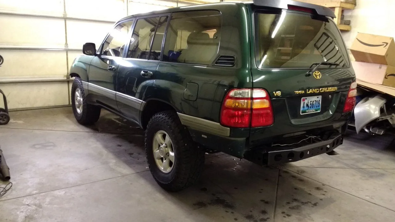

Rear bumper installed w/ 75mm TourFlex and approx 120# in cargo area (tomorrow I'll try and get to the front)
F-DS 19.5
F-PS 19.5
R-DS 24.0"
R-PS 24.0"
I'm still 340# shy of my rated spring design. I have the roof rack (75#), RTT (120#) and loaded drawers (250#) still to add ( then remove about 70# from the test rear.... In my estimation the rear will end up at 23.0-23.5" fully loaded and hope to see the front at the 21.5/22.0" mark.

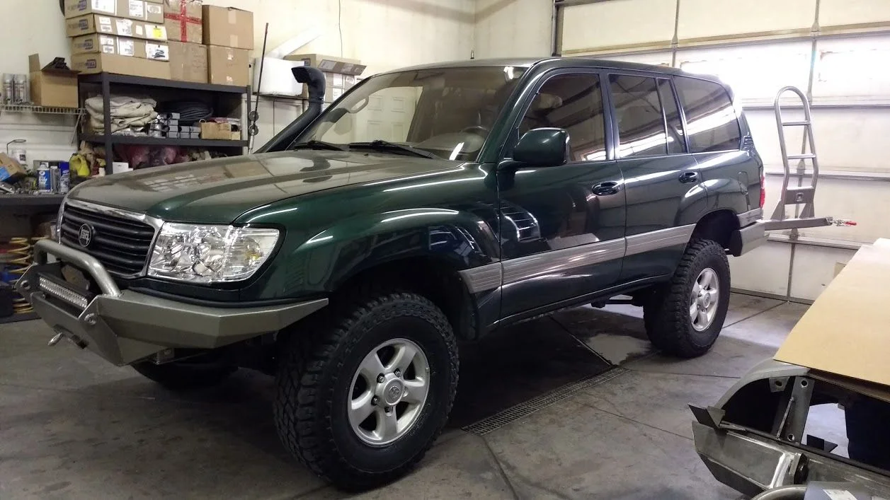

Stock and TourFlex

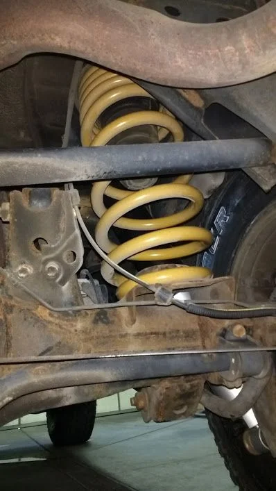

TourFlex rear installed
Dual rate spring stack up
Stance pre-front mods
Front ready for new TD bars, strengthening brackets and 53mm bore shocks. ( Front bumper and 12.5 winch as well)

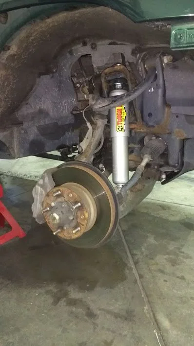

I broke a brake line during the install. So I will splice the break with a SS SwageLok coupler until the new OEM full line is delivered. I was a little aggressive.. my fault, but glad the weak link showed itself now instead of on the road somewhere else......

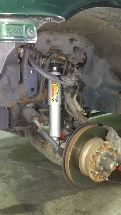

The OEM shocks I pulled off were completely shot (I'd say they are the originals with 183K on them). No pressure at all remaining. Just the weight of the shock and they would start extending.
The TD 45mm adjustables are a twin tube, 9 stage foam cell design.
Front TB and shock bolts are soaking in Kroil and will try to get the front installed tomorrow along with the front bumper and winch.

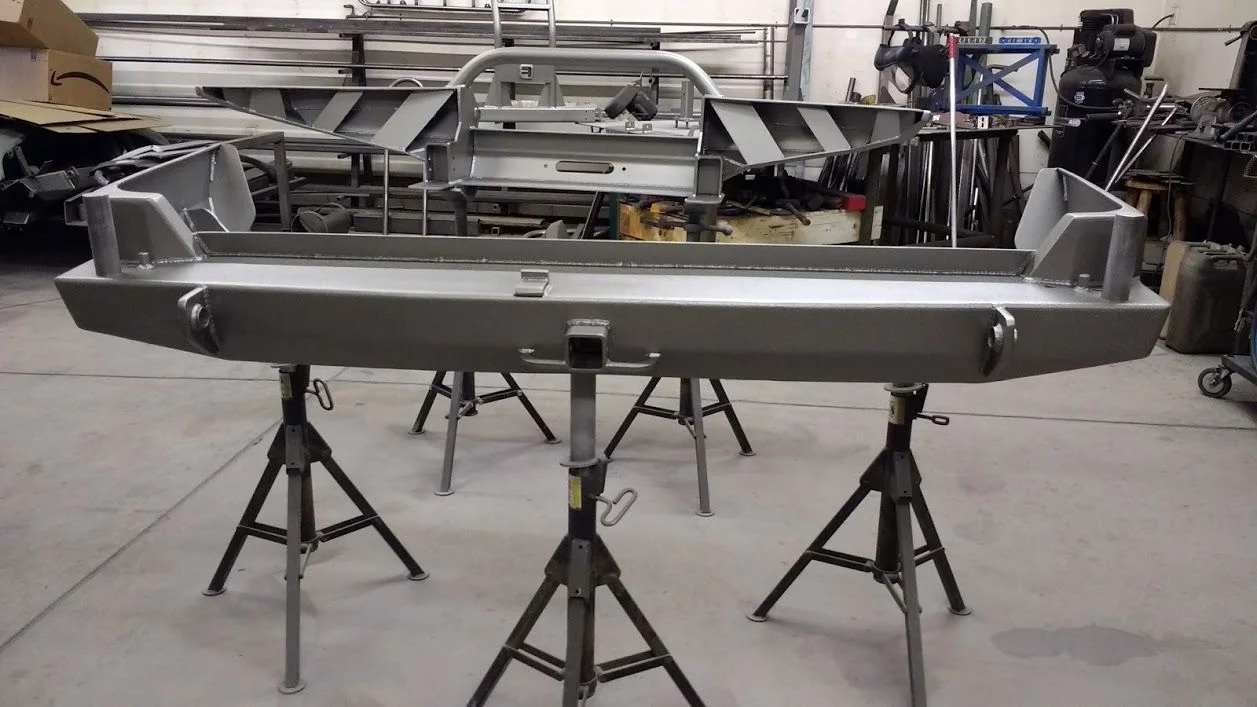

I think you should use this philosophy to make me one of your rear bumpers!
Im already a loyal customer with a tailgate storage lid on its way ... c'mon you know I'm good for it! :D

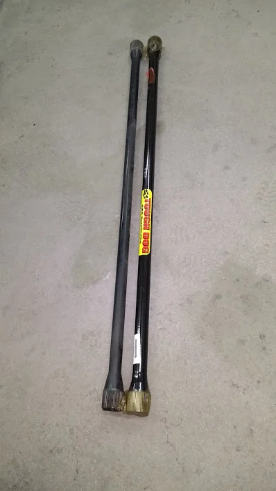

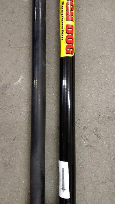

Tough Dog HD torsions vs OEM
33mm vs 29.5mm

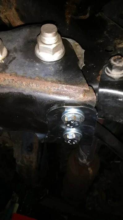

Strengthening brackets installed. I asked about these when they added them to my kit. TD has noticed a considerable failure rate without these brackets. Basically a nice little insurance policy, if you will.

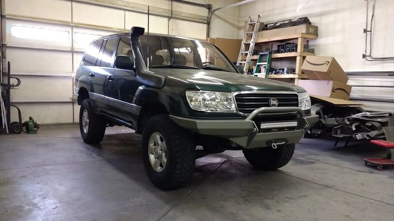

I wanted to see how high I could crank these without re-indexing and still get the required 60mm droop recommended by TD... 24.375" center of hub to fender and right at 60mm droop.
I ran them back down and currently I'm sitting at 21.875" center hub to fender, loaded with bumper and winch and have a 70mm droop. I still need to run the suspension and adjust if needed. (brake line still needs to be repaired.....)
So the current stance with the HD TourFlex rear suspension is Front 21.875" and Rear 23.75" (I still need to add the final accessories/weight to see how the rate/design specs work out)
