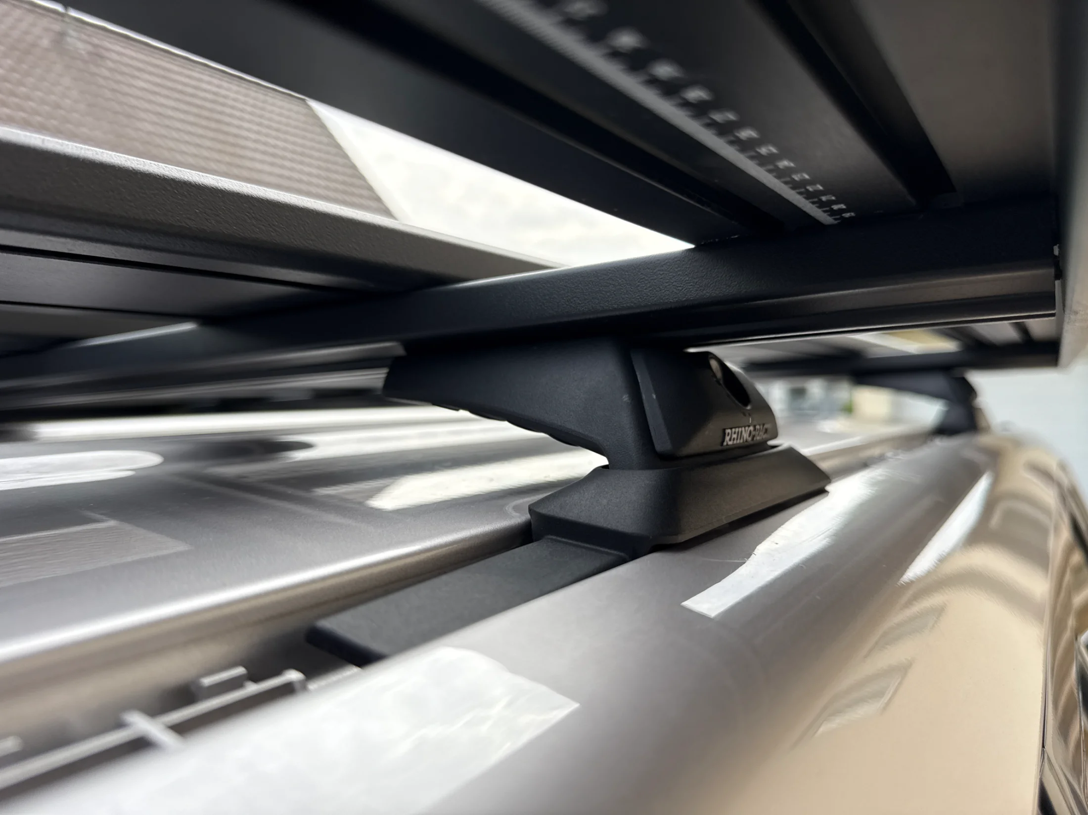

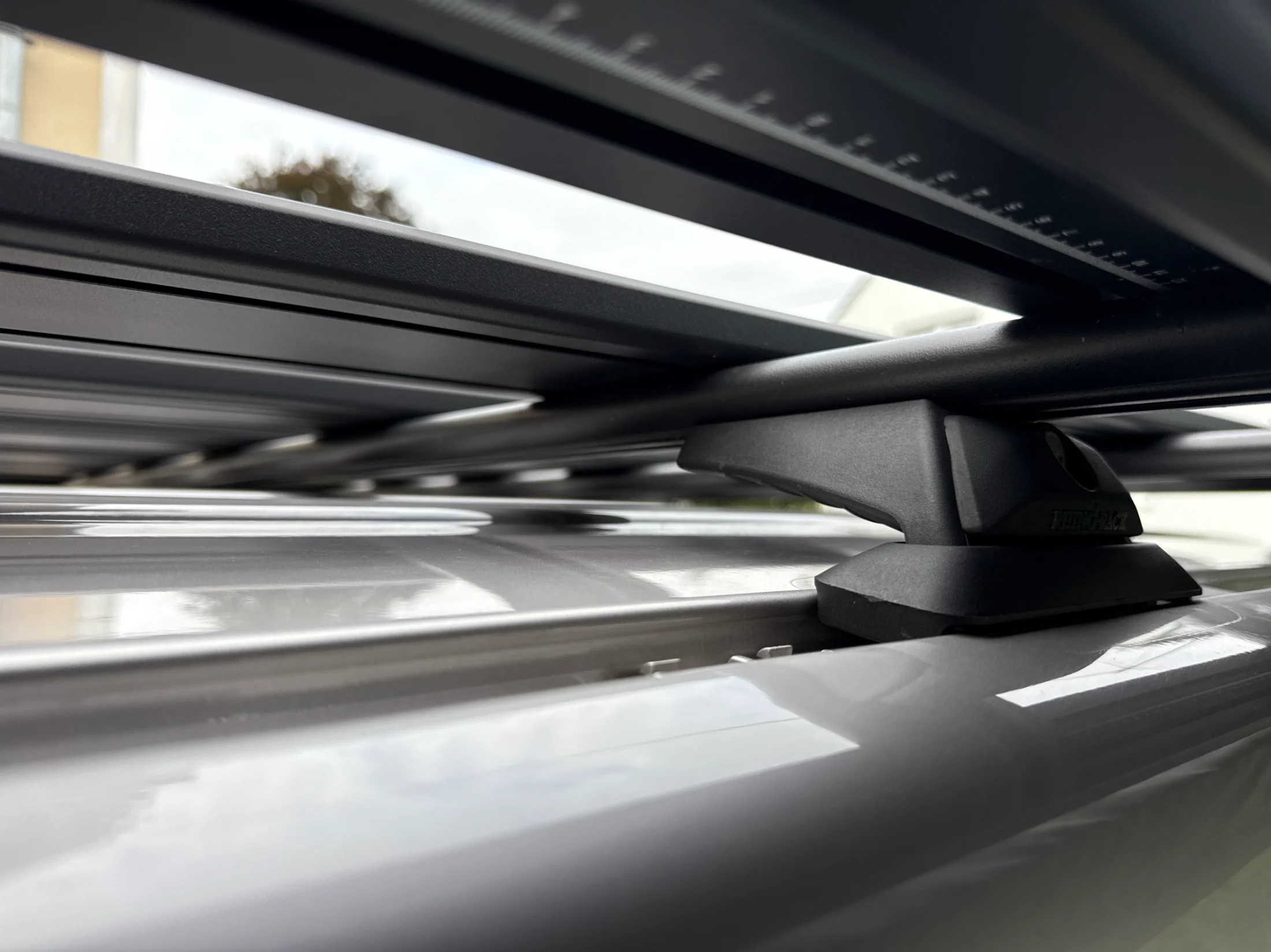

The best solution I got and thanks to this forum here is with the Rhino Rack and using the LOW feet. The rack is I would say not higher than original.
I do have an Alu Cab 270 awning mounted and my LC is in AHC position low 207cm high in total. This is great solution.
Haven't found anything lower.
Choosing the right rack is really individual based on your priorities. I also mount my SUP on top using straps. With the new Rhino Rack generation this is easy to install using the "O" screws.
It's the Rhino Rack RCL legs I use together with the Rack Gen with Zwiflock.

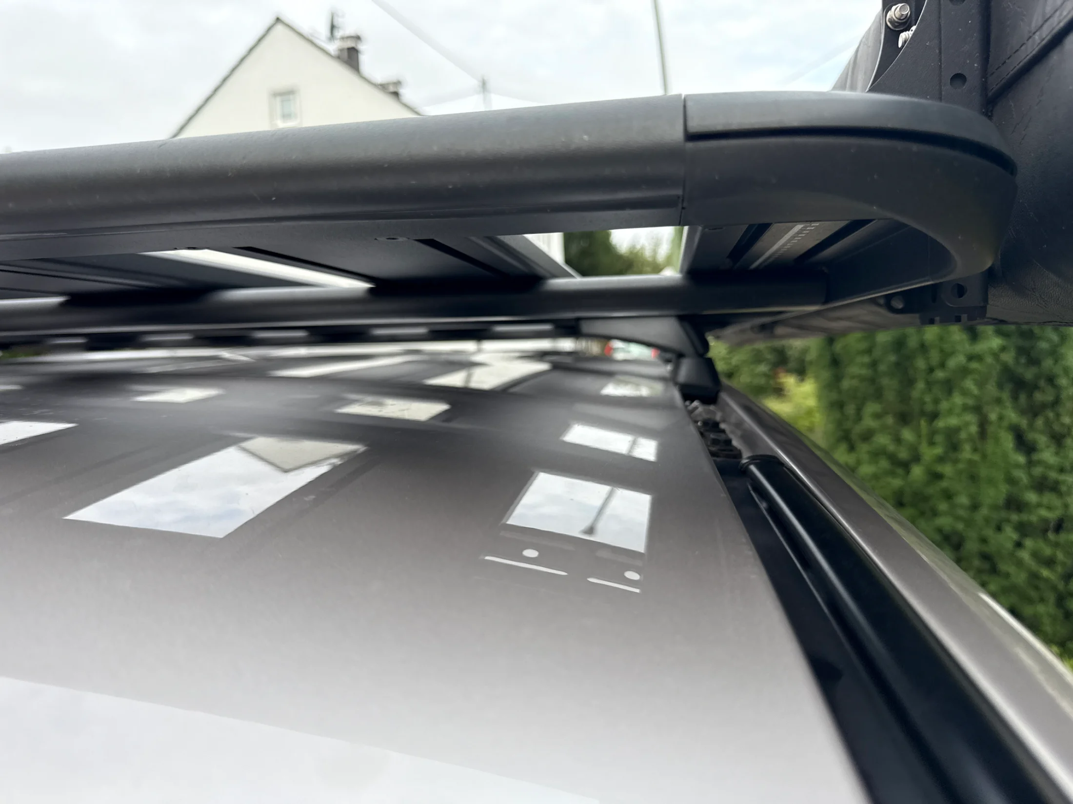

No worries, it's most likely because of the different leg positioning between LC100 and Lexus 470. In fact my rack is mounted onto the LX470 position, as the LC100 position which is more in the front is not certified for roof racks 2m in length. Don't ask why...
I purchased:
Rhino Rack Pioneer 6 Gepäckplattform 62104, 2100 x 1430 mm, schwarz
Set Rhino Rack Fußkit RCL6 37mm (abschließbar)
Set Rhino Rack Basiskit RCP02-BK für Toyota LC 100

I wouldn't call it noise, it's of course louder than w/o a rack, but the new generation is doing well I would say. If you have stuff mounted on top, then it's naturally louder. Also when having just the awning mounted like me, you have air turbulences and yes you hear it. But again, when you have just the rack, it's absolutely fine. I start recognizing it when driving faster than 100kmh but no issue having a discussion with passengers. Altogether I could be far worse, Rhino has done a good job.
I am using 6 legs. Two mounted at the back fitting, two in the middle and the other two mounted into the LX470 holes. Rhino delivers all the meterial required to do the job properly. One thing I do strongly recommend is, go and purchase a "silicone" (don't know the English word for it). I used SIKAFLEX 522. This you squeeze it into your mounting holes upfront before putting the screw into it. With this magic SIKAFLEX, it's gonna completely sealed against water or similar from the outside.
Don't use the Vortex bars from Rhino, not required. These are just lifting your rack and additionally it weighs more. You just need the three things I linked you above. That's it.
I bought the dimensions linked above because it's the most common one and I don't regret it. You should definitely NOT go for a tighter one! The lengths you can choose but do not go tighter because then the leg option would n ot longer work and you have to choose the Vortex bars.

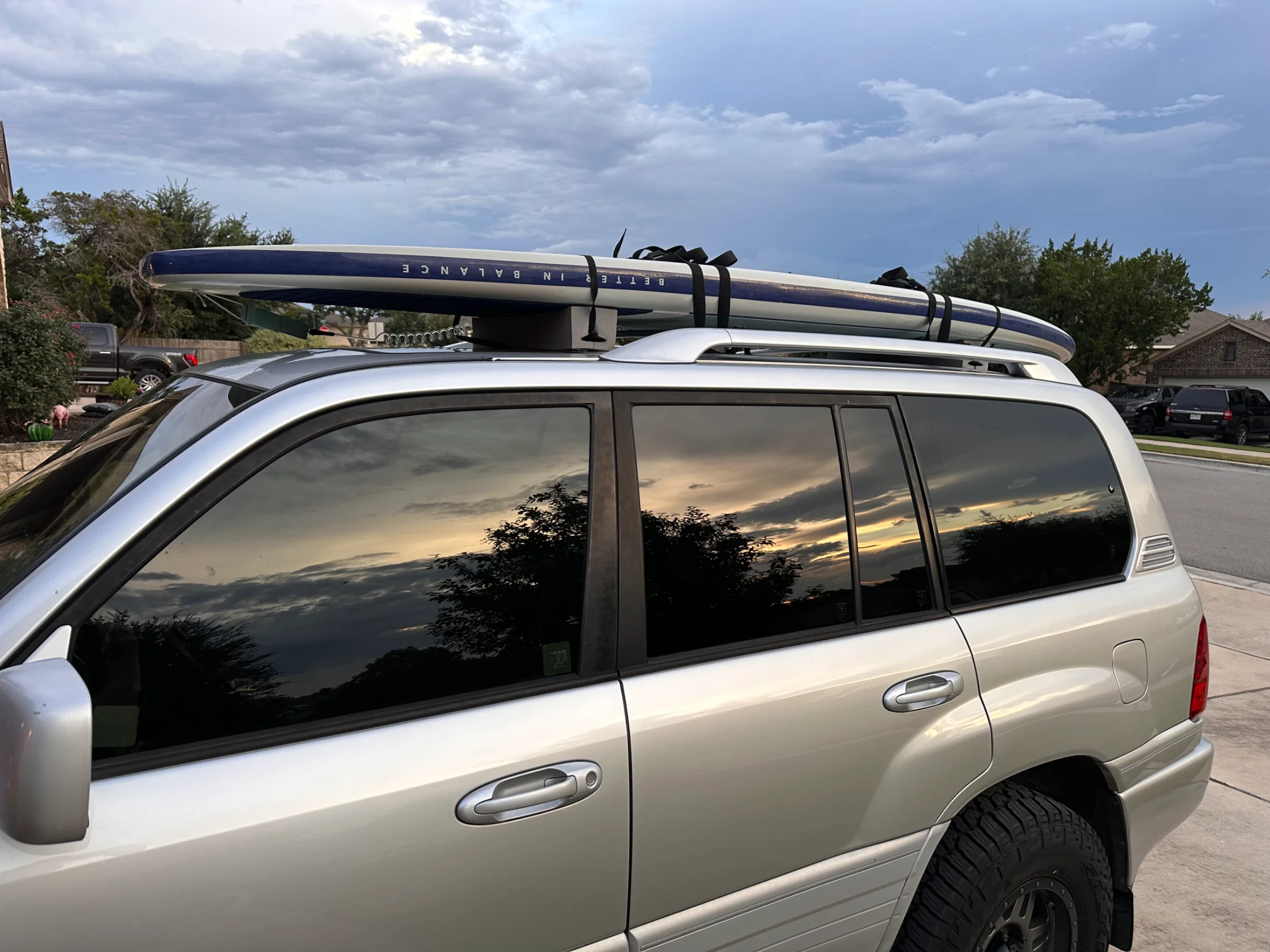

I’m not too sure what I was concerned about with the paddle board. Stock rack did great. Now with a kayak… idk might be a different story
This was at 40ish. Yes its an LC, but I followed in my LX. Drove 75+ on the freeway with em. No fks givin.
The rack/mounts will be fine. If your kayak mount/straps can hold on that is another story.
