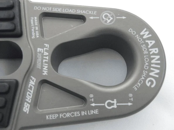

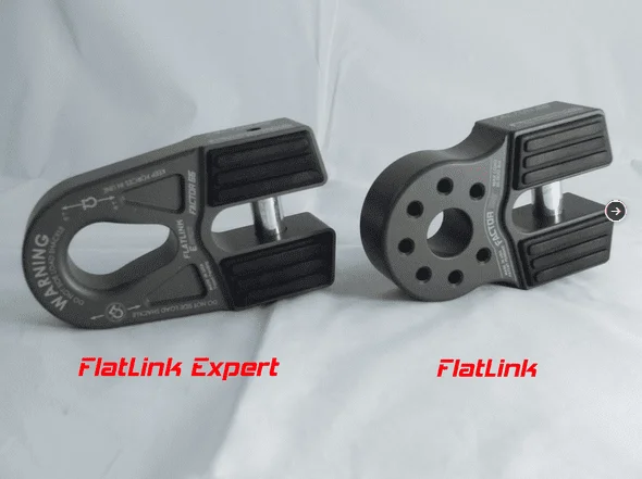

Ordered a Factor 55 Flatlink Expert from @RDC76 (Rich is the MUD-- Factor 55 guy) to use with my ComeUp 12.5rs
If you haven't used the Factor 55 accessories, I highly recommend trying them out.

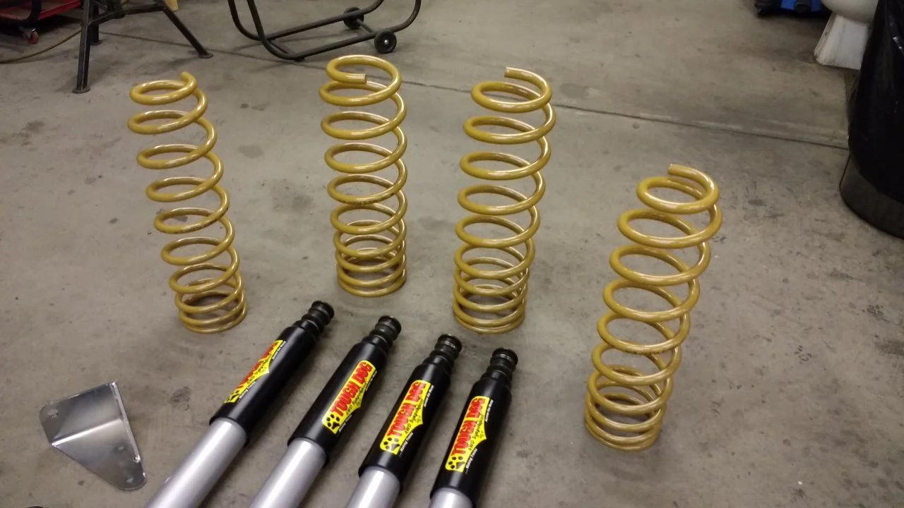

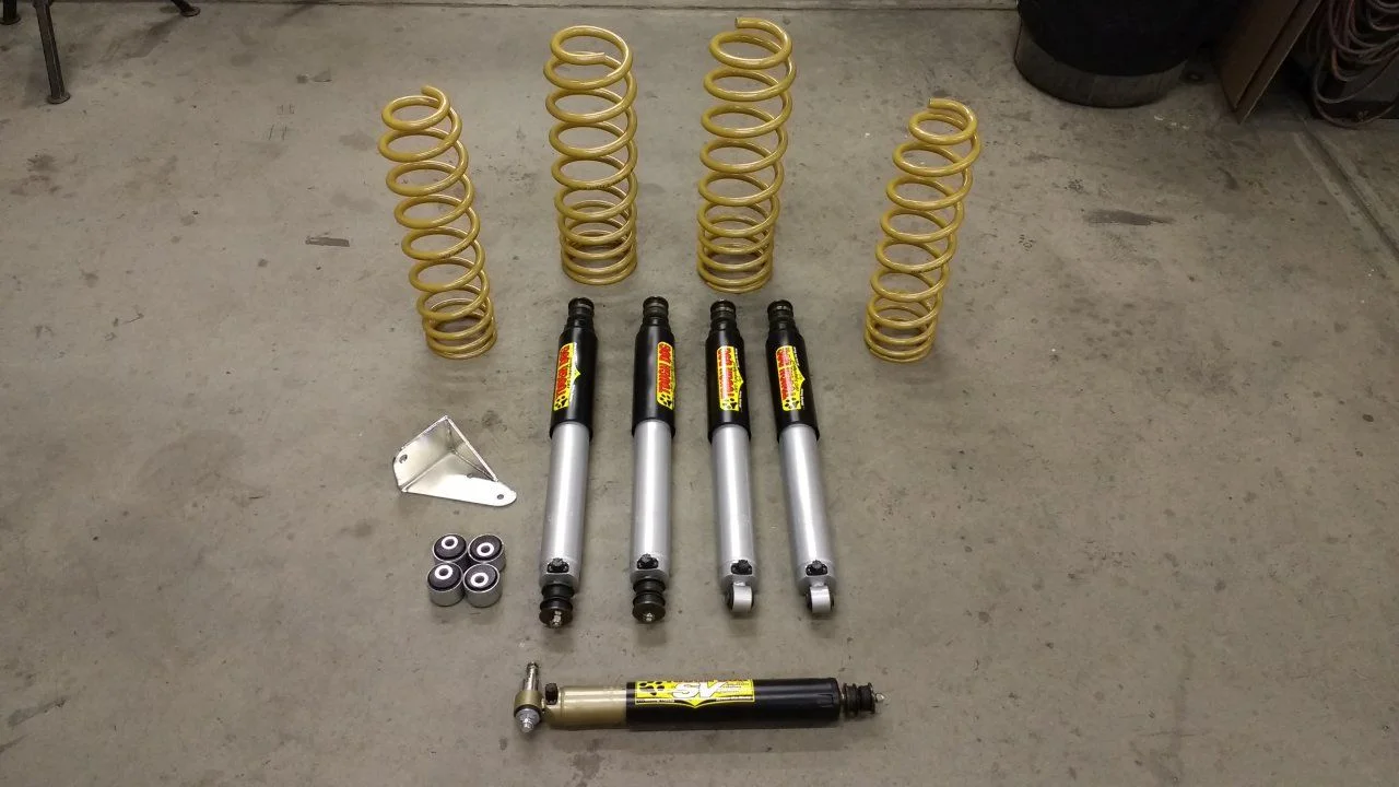

Well guys the R&D extended travel aka TOUR FLEX springs set up has arrived.
SPRINGS- 75mm lift are made with XK5 German spring steel, fronts- 17mm and rears- 19mm wire diameter.
Fronts are 545-535mm with a rate of 180-270LB/"
Rears are 555-545mm with a rate of 180-320LB/"
SHOCKS- are a 45mm (1.77") bore FOAM CELL TWIN TUBE design with a 70mm (2.75") casings and 9 stage adjustable to boot as a standard option with this kit. This means 800% adjustability on all four corners and per corner, not to mention an adjustable steering stabilizer.
STEERING STABILIZER- has a 35mm (1.38") bore and adjustable as well. Tune your steering to your liking and your needs in seconds.
CASTER CORRECTION- TD offers 2-6 degree correction in bushing and plate designs options.

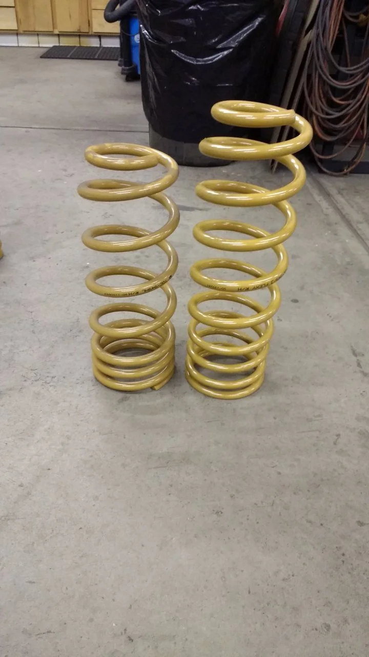

REAR 100 spring comparison Left is a 100- 300kg+ vs Right is a new TOUR FLEX
Looks beefy! Interested to hear your thoughts before and after on the 100 series
And I am guessing that these are a true progressive coil and not a dual rate like the similar extended travel icon and slinky rear coils? Also, do the shocks have an extended length like the OME L's and the Icons? Do you know the compressed and extended lengths?
The TourFlex spring is a dual rate not a progressive. Soft rate on the coil pictured is 180 and a firm rate of 320.
A progressive spring will have 3 or more variable coil pitches and be offered with a rate break out, as say 320, 305, 240, 215, 160 or simply VARIABLE.... A 3 coil spring will have 5 rates due to each transition coil needing to be rated as well. Progressive springs are notorious for having different installed heights and loosing upwards of 30-40% of their lift capacity in a very short time. They are extremely hard to design and manufacture properly. Hence the main reason for their bad reputation. You will notice only two pitches on the TourFlex, one for the soft rate and one for the firm rate with only one transition coil.
The adjustable shocks above were matched by TD for these springs. Mount to Mount is 19.25" and 28.5". A 50mm bore, remote reservoir, externally adjusted shock will be released in the next few months (looking like Jan/Feb)

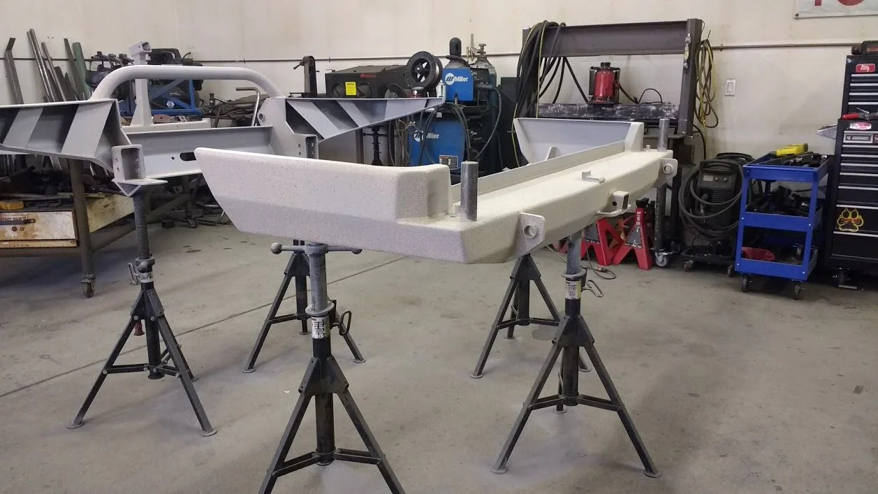

Finally got the bumpers and sliders ready for prime and paint.
Tough Dog suspension will go on next week.

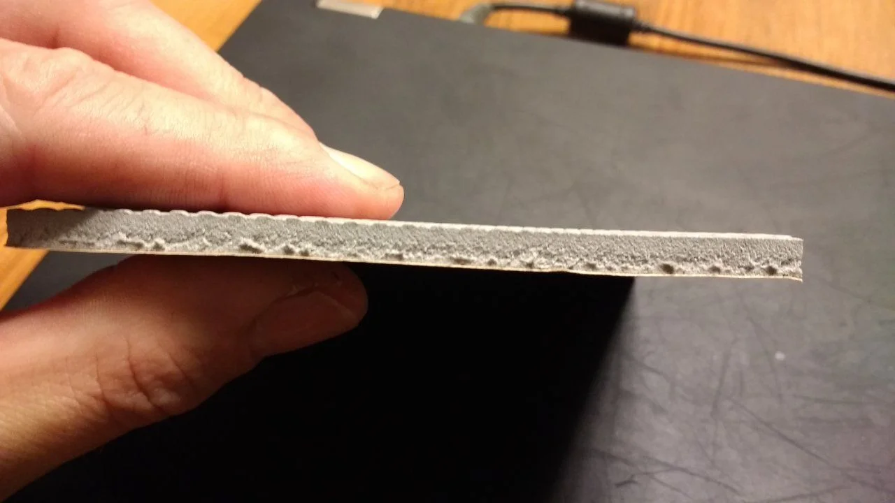

Appears to be identical to Seadek. FWIW I could easily scuff the Seadek material by rubbing my finger nail across it ... hard to imagine it holds up to its intended purpose of boat flooring material :meh:
