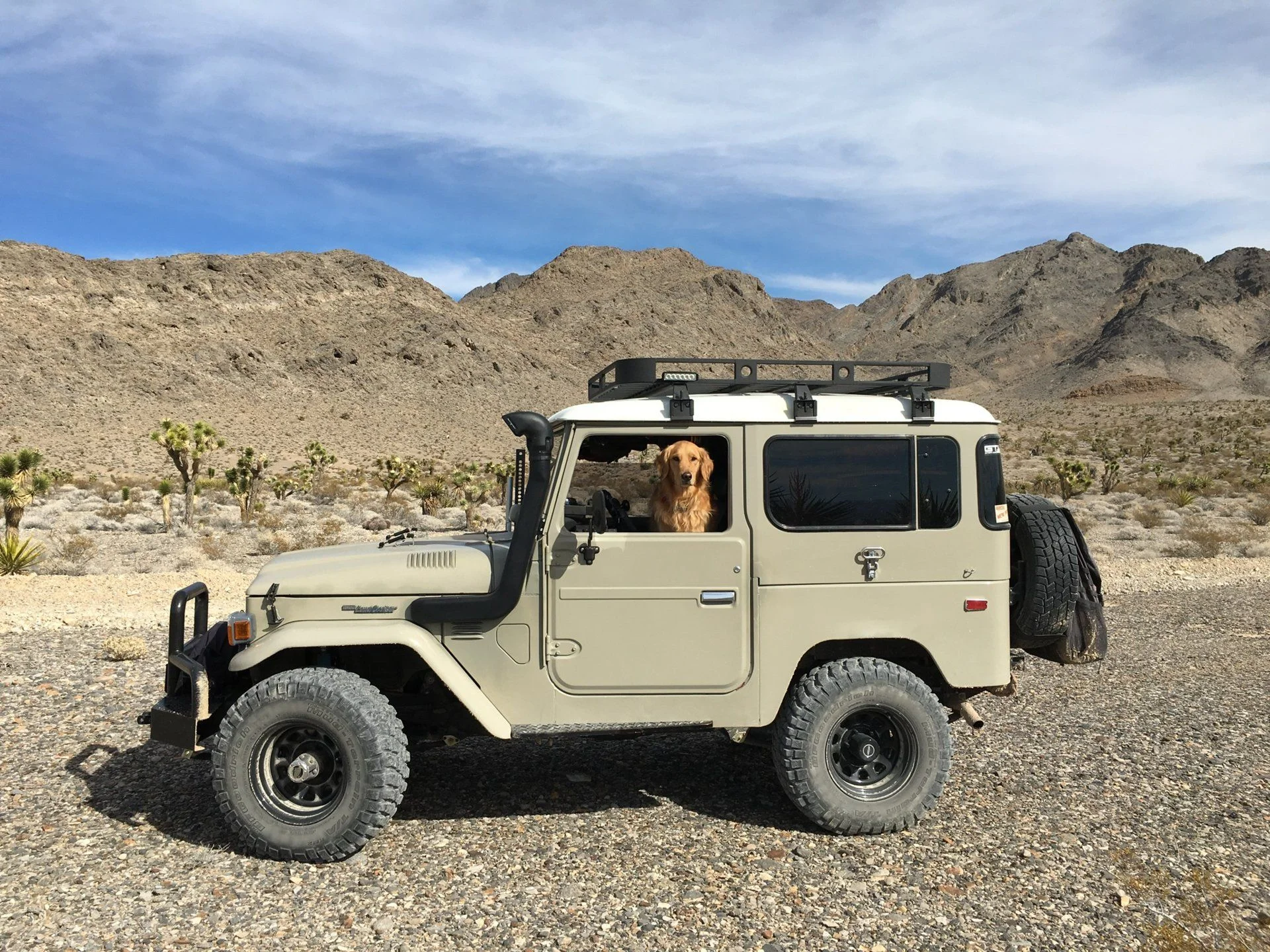

Here’s 44 in her natural environment... sure sexy with that snorkel!!
