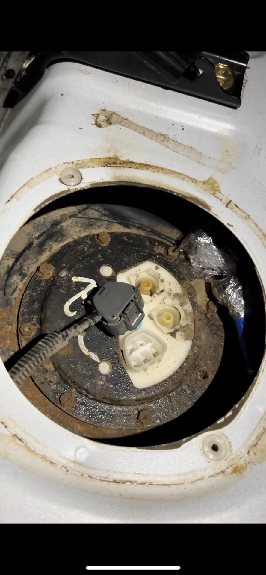

Testing the Fuel System:
In an effort to determine if the problem is the fuel pump circuit or just the actual fuel pump, I did the following:

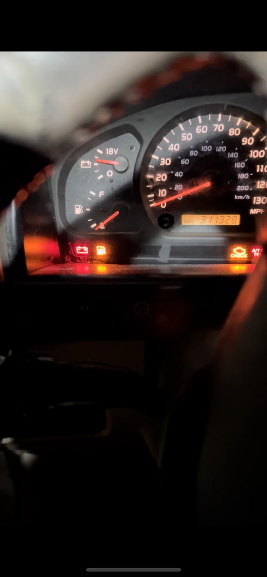

1. Disconnect both fuel lines and the sender gauge connector (pic below)
2. Turn key to On position --> result: Gas gauge at Empty and Gas light on (makes sense) (pic below)
3. Reconnect the sender gauge connector, while leaving fuel lines disconnected (pic below)
4. Turn key to On position --> result: Gas gauge at ~½ full and Gas light off (seems to make sense) (pic below)
My question: Can I interpret this as "the fuel pump circuit is OK, therefore the actual fuel pump is the cause of the problem"? Is there a way to test this?

I rarely test further than about crank, no fuel. But doing one more test, is only takes a few minutes. Now that you've the carpet up and tank exposed.
Most likely circuit okay, fuel pump failing or dead. If fuel pump fail during next test. Then there's 98% likelihood, circuit okay.

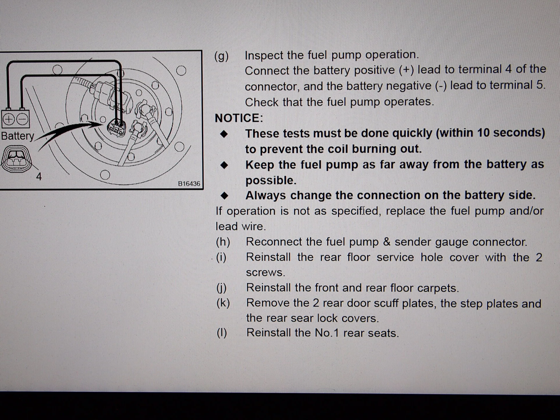

Best to reconnect fuel lines to fuel pump, as seen in picture below. Attach leads to fuel pump first. Then connect leads to 12v battery,. Battery must be place away from gasoline/tank/pump out side vehicle. One spark could be deadly. With your catch hose running to catch can, from fuel filter. See if pump runs and fills catch can.
Note I have seen fuel work intermittently.
If fails: Replace fuel pump, tank seal, fuel filter & green clip

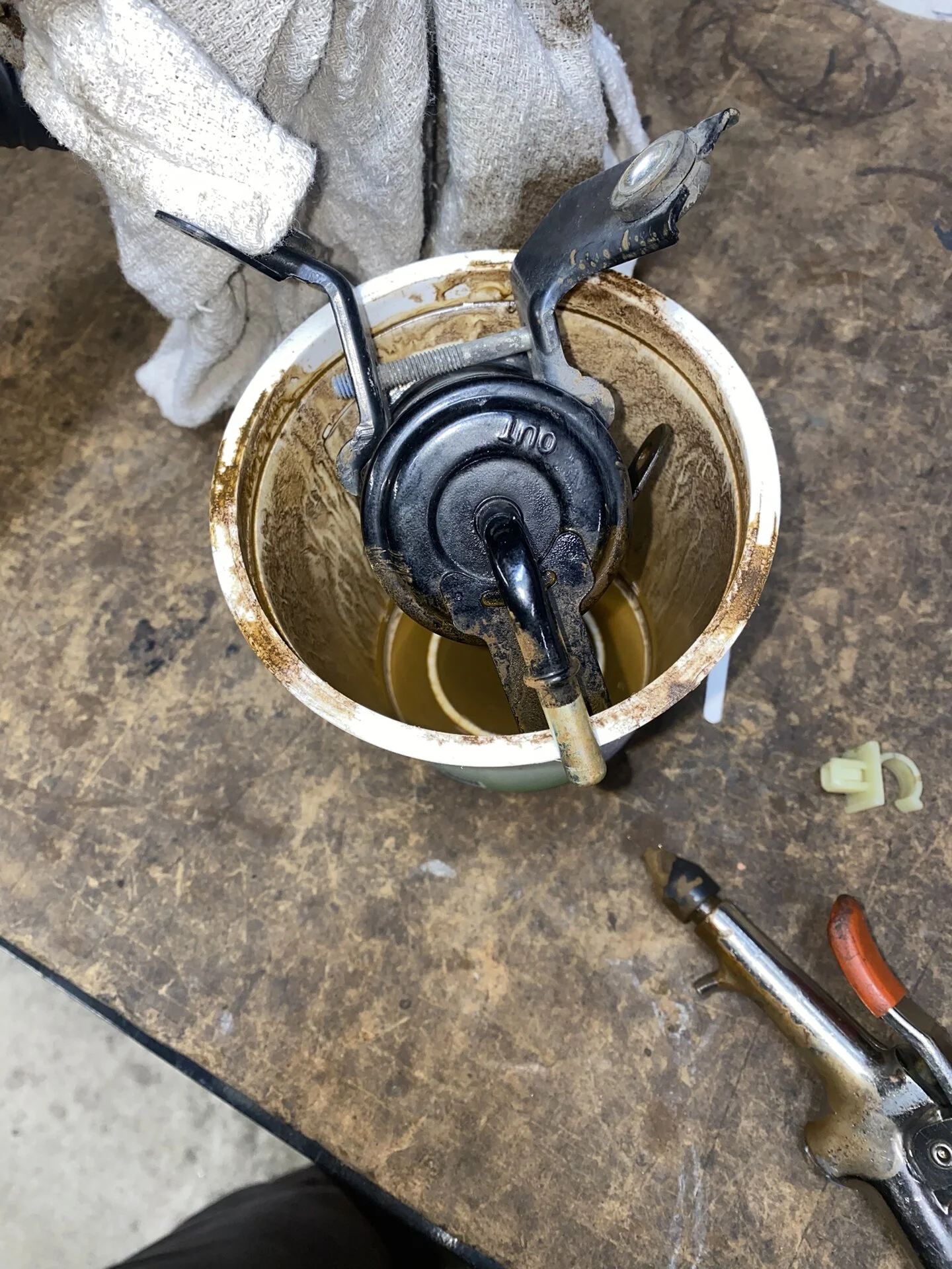

before remove screws, to remove pump. I like to power wash top of tank. While all fuel line and wire attached. To reduce chance of contaminating.
If sediment in tank, vacuum it out. I use a very large syringe.

Attached the battery to the pump directly and nothing happened - so that seems to point to fuel pump.

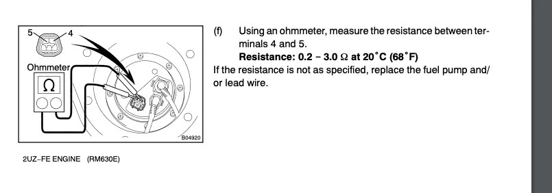

That said, how precise of a multimeter does one need to measure the resistance in this picture? I have this multimeter and when I measure I was getting 0, regardless of the setting
I got zero ohms resistance on newish (working) Toyota pump, so that measurement in the FSM wasn't meaningful to me. My pump was fine. At my last fule pump adventure, the problem was the wiring beneath the rear door: Fuel pump wiring failure - and the fix - https://forum.ih8mud.com/threads/fuel-pump-wiring-failure-and-the-fix.1325429/

OP: Jumping with 12V directly on the pump, is acid test for pump. But even those can fool us from time to time. As the pump may work intermittently. But when taken with symptoms, other test and age. It's a good bet, fuel pump replace resolves.
OP disconnect at pump, which resulted in dead gas gauge. Interesting test! But not sure (doubt) it's, a fool proof test of circuit.
