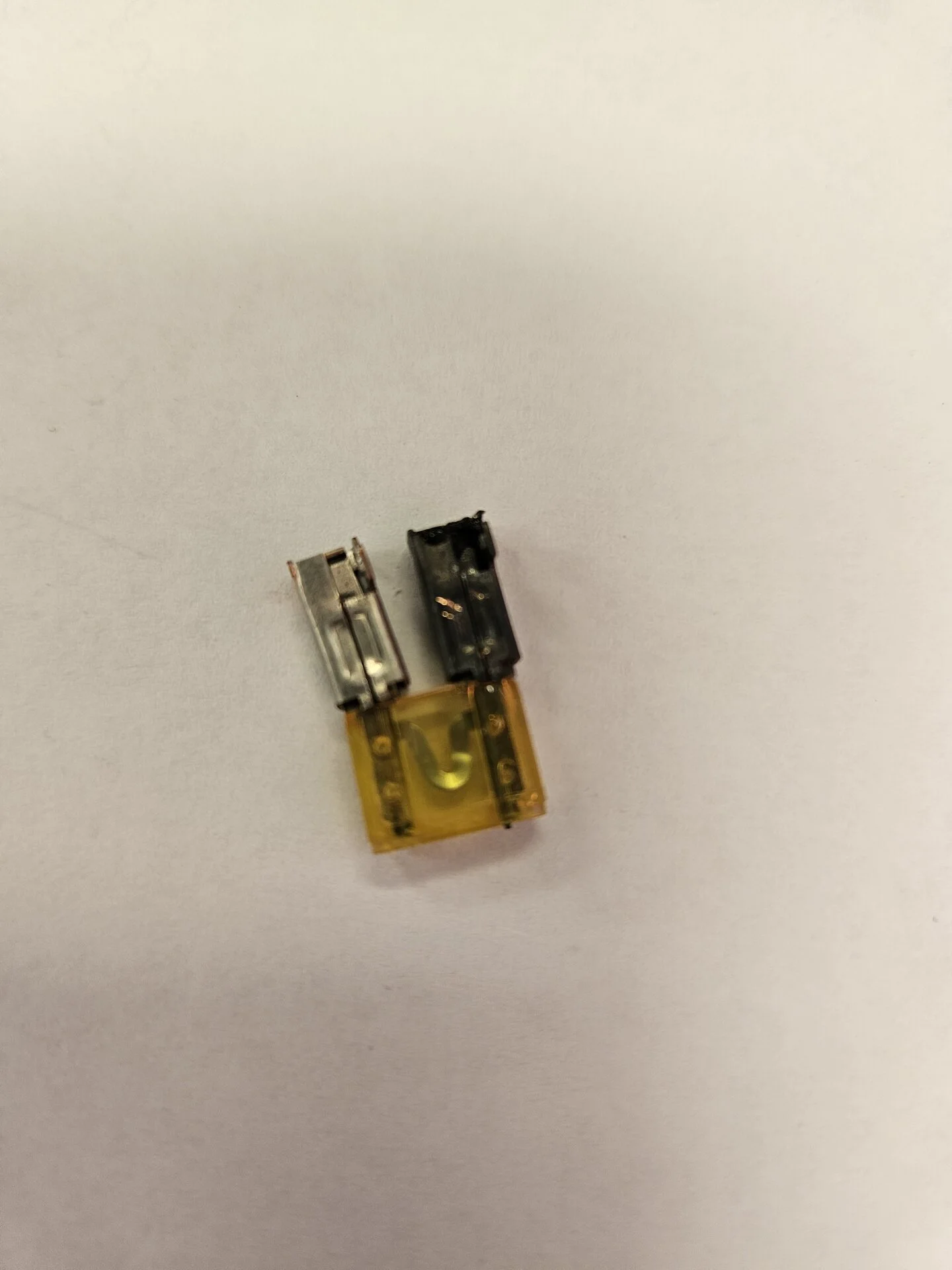

Well, couple days ago I posted about my issue, today I figured out the problem. I have a 1998 Lexus LX470, 197k miles, the seller I got it from said it needed a new fuel pump and the symptoms it was having made it seem like he was correct. Then after reading up more on it, I saw there was other things it could be so I started with those.
After replacing my APPS, TPS, fuel pump, fuel filter, checking my EFI relay and the fuses next to it, checking my spark plugs, coils and injectors, nothing was fixing the problem. Then today, I went to look at the fuse diagram again to make sure I didn't miss any fuel related fuses. Thanks to @Malleus for replying where to find the FSM.
That's where I noticed the IGN fuse in the driver side kick panel helps run the Multiport Fuel injection system.. So I went in and pulled it out (its a 10amp). The fuse was completely cooked! I replaced it, and the car is back to life.
Now to figure out the high idle. It's around 1600.. if anyone has tips for that, let me know.

I wonder why the fuse was burnt up.
Good chance it will burn again , the holder in the block is overheated and damaged , loosing contact ,high resistance .. there is a lot of info on this on how to make a lasting repair .. Also applies to gx470 ..
High idle never fixed itself. I ended up having to replace the Throttle Position Sensor to fix It
Isis just the fuse box wearing that is the problem or is there an underlying electrical problem that causes the overheating ?
Been chasing this issue with my LX. It would die if I drove over a bump or slammed the hood. Replaced all the EFI/ECD/Fuel injection relays but problem remained. Then it died when I slammed the driver's door and found this thread.
10A EFI fuse cooked. The 7.5A idle-up fuse also looked cooked so I replaced it too. Will have to look into the permanent fix and probably should just replace all the fuses and clean all the contacts in the whole truck.
