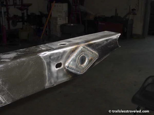

Here is an example of the start of grafting two FJ55 frames together:
I don't have the rest of the work handy. But he plug welded a scab plate inside of that on the outer frame rail. I have NO concerns over the strength of the resulting longer frame.
OTOH, the welds are beyond clean.
I your case the vertical seams is a non issue as the seams were staggered.
The fish plate is only icing on the cake.

You are in good shape but that is not a finished job in my opinion. I am NOT a professional welder but I would apply a gusset to that part of the frame.
Don't get too down. It is repairable. I would 100% recommend scab plating at least the inside to ensure the strength of that area.

I think it would be best to apply a fishplate to the exterior of the frame and a smaller gusset to the interior after grinding down the welds in there.
