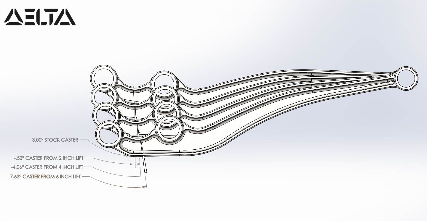

Didn’t Slee do some diagram of what happens to the caster as you lift the truck more and more?
Like this?
Theoretical geometry is the easy part. How that geometry interacts with all of our rigs is a different story.
