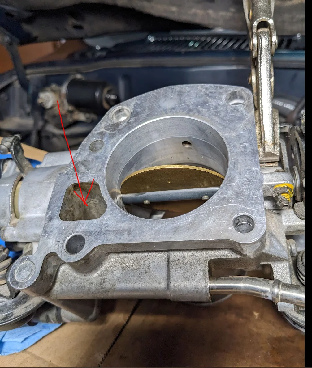

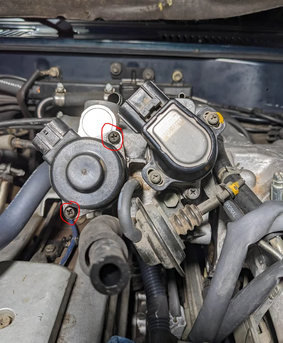

Sounds like you have a 93/94 FZJ80 and based on the TOYOBD1 readouts it sounds like the IAC is functional. I would still recommend pulling the IAC and cleaning the passage in case its clogged up.
It's a lot easier to remove the IAC when the throttle body is off, and then you can clean it at the same time. The screws can be really tight so it takes some effort so they don't strip. Try tightening them first then loosing to break them free. I also used some penetrating oil.
IAC passage
