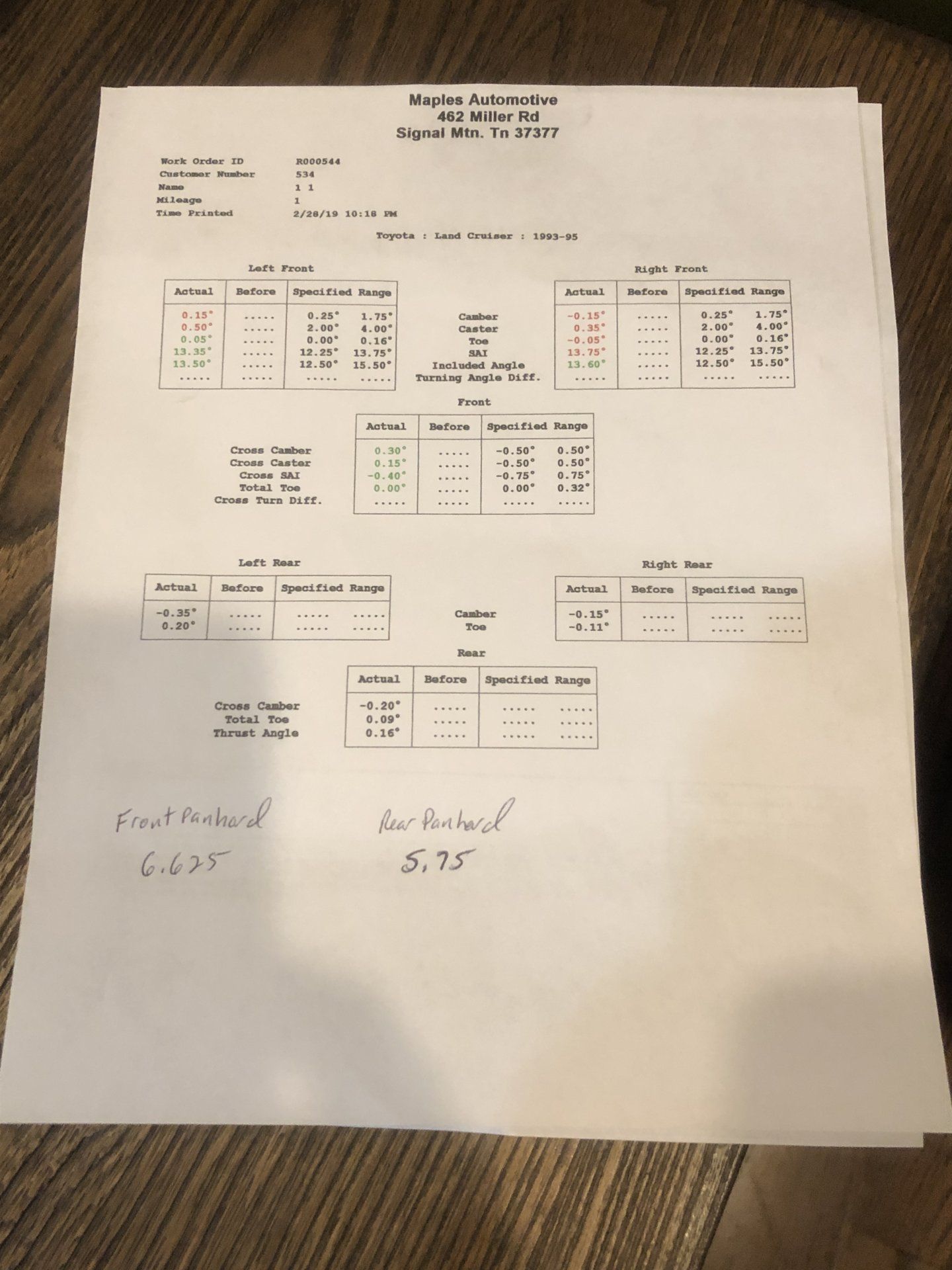

I'll dig through my file from LTS and get my somewhat recent alignment data and the measurements you want.
I may also have data from right before and right after the panhard bracket install if that's something you'd like. By "may" I mean I'm horrible at keeping paperwork and hopefully LTS keeps it on file...
