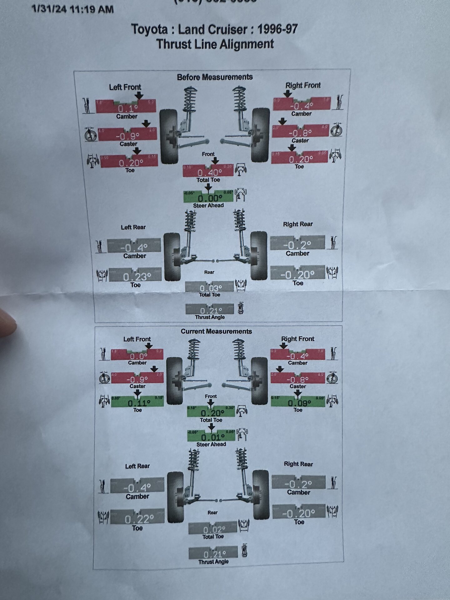

I’ve replaced my mystery OME springs (1.75-2”?) with heavy load linear Robinson springs (3”), this netted me about 1.5” lift.
After doing the alignment, my caster is a -1 degree. However, I DO have the OME caster correction kits installed when OME lift was installed by previous owner. From what I understand, those are +2 degree correction. I don’t know how those are clocked exactly, but they “appear” to be correct.
Here’s the question, if I replace those with +2.5” dobinson bushings, that will not be enough right? Just math wise. So the other option is to go with caster plates, which will net me +5 degrees and put me at +2 degrees.
Something seems a bit off here, input would be great.

Most recent alignment:
Previous alignment:
Previous alignment to that before bumper and winch:
Nice work on actually getting an alignment reading to see where you stand.
Caster correction bushings are trash.
Skip the plates. Go with proper arms.

delta arms got me to 4 degrees on a 2.25" lift. caster plates got me to around 2, same lift. 4 is at the upper end of factory recommended caster spec on stock suspension.
mine feels great at 4. straight and true with minimal steering input required at all speeds. this is what the extra $ gets you, plus u don't have to modify the factory axle.

3.5" Lift will require about 6⁰ of caster correction.
Varies with every truck, and this is AFTER correction bushings are out.
Land tank has 2 or 3 versions of correction plates. Can't remember
Better than trying to tweak with correction bushes, and still coming up short.
And a lot cheaper than arms

But does my alignment justify this? I don’t want to get it just to get it
The only thing adjustable with your alignment is toe. Castor can be corrected via bushings, plates or custom arms !!
