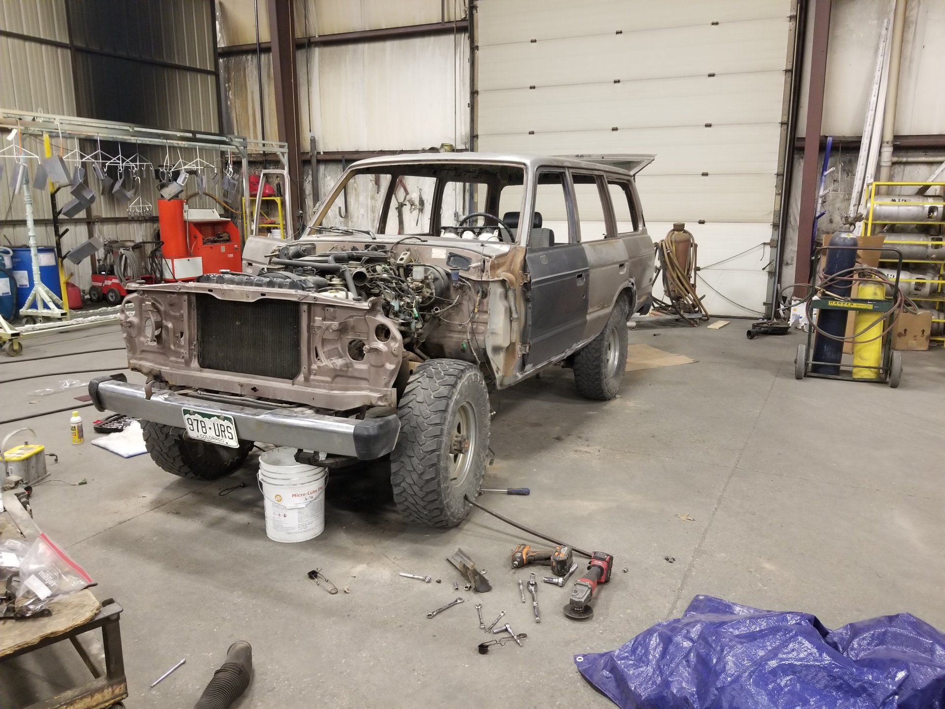

Rocker mostly welded. More clean up and touch up to do, bit close.
I didn't feel like sitting on the floor and welding last night so I started unbolting stuff
Made good headway, then more today..

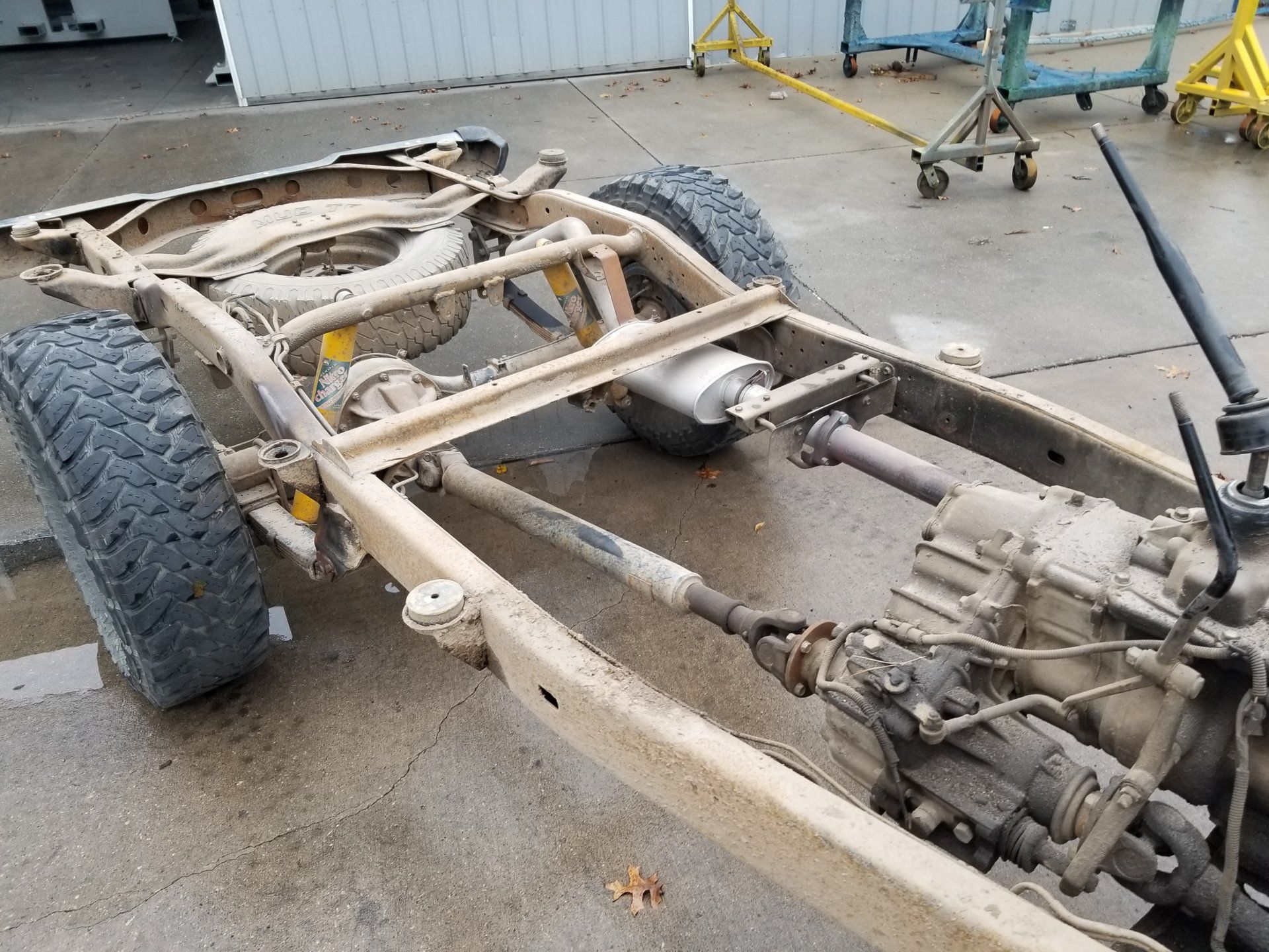

Lots to take apart still but at least we have separation. The body os on a cart I use to powder coat items on. Not a great fit but works temporarily. The frame looks great. Time to keep tearing it down and start powder coating stuff.
Lots of items I thought I would have to remove for the body off but did not. Gas tank (just unhook the lines), exhaust, spare tire (didn't have the crank handle at the shop!), lines weee super simple. Jist a few heater hoses. The steering shaft was kind of a pain. Body mounts werent bad with a little heat wrench torching on a couple so as not to break them.
Thanks to side shift on the fork lift I didn't even have to pull the shifters. I just used pine boards in the door jambs between the forks and body to soften the interface and even the load. Worked nice.
Jealous of those forks - 6’?
Nice work, and that frame looks really good. I see a bit of funny business in the rear bumper cross support, but the rest looks good.
What’s with the extra brackets on the shock tube?
