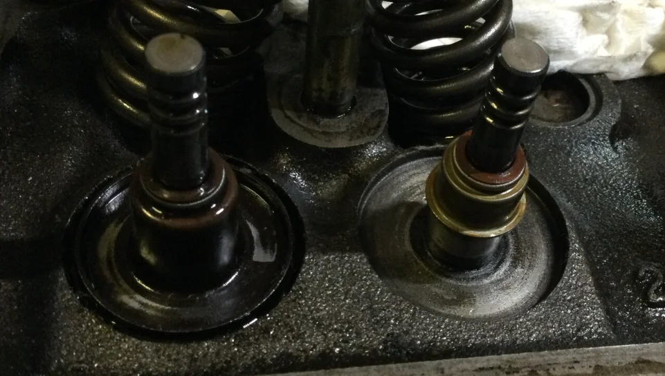

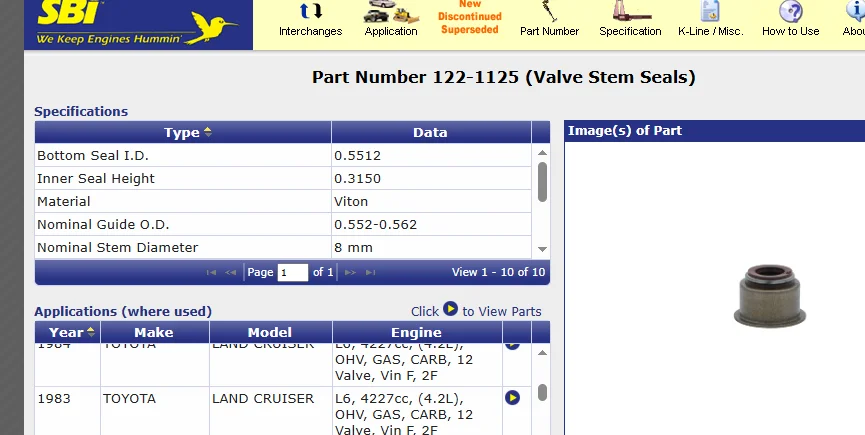

Rebuilding my rebuilt head. Relapping all valves. I was given 12 sombrero style seals left over from my engine rebuild. The builder abandoned the Tieken brand and ordered SBI seals. A bargain at $1.91 each. A couple have already cracked and torn at 1000 miles with some installed cock-eyed.

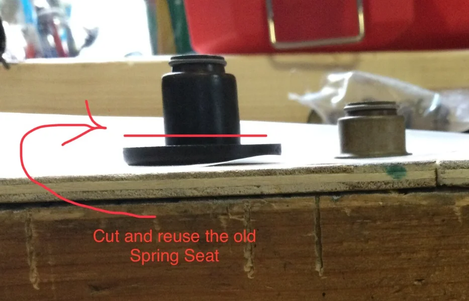

I am going to go oem, but my per a 40-55-series seal thread, some people cut off and use the bottom of the sombrero for spring seat, and go with oem on top.
Is a thing?

I have seen threads where people cut and use the 'seat' though I've never personally seen or done it.
