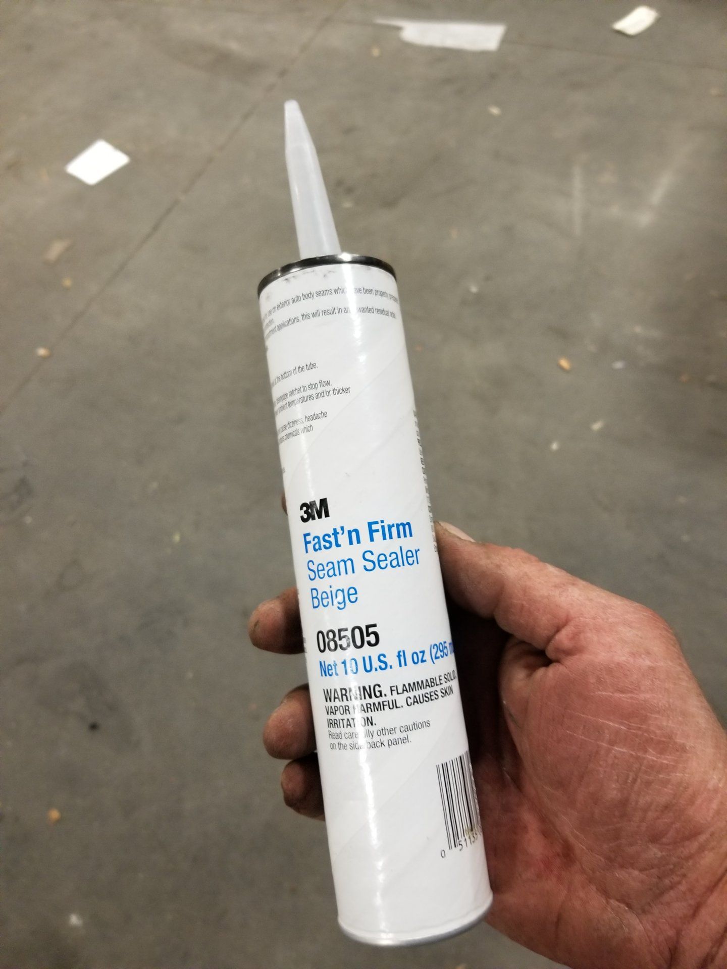

So @CenTXFJ60 Jim, I just bought some of this. I believe it is the right stuff for seams. What I used to use anyway. I think that's what you used on your 60 (?).
thats it Pat. I only used it cause my paint supply guy recommended it. Seems to have worked well. did my rear quarter on my blue truck a few years ago and it's still holding well.
