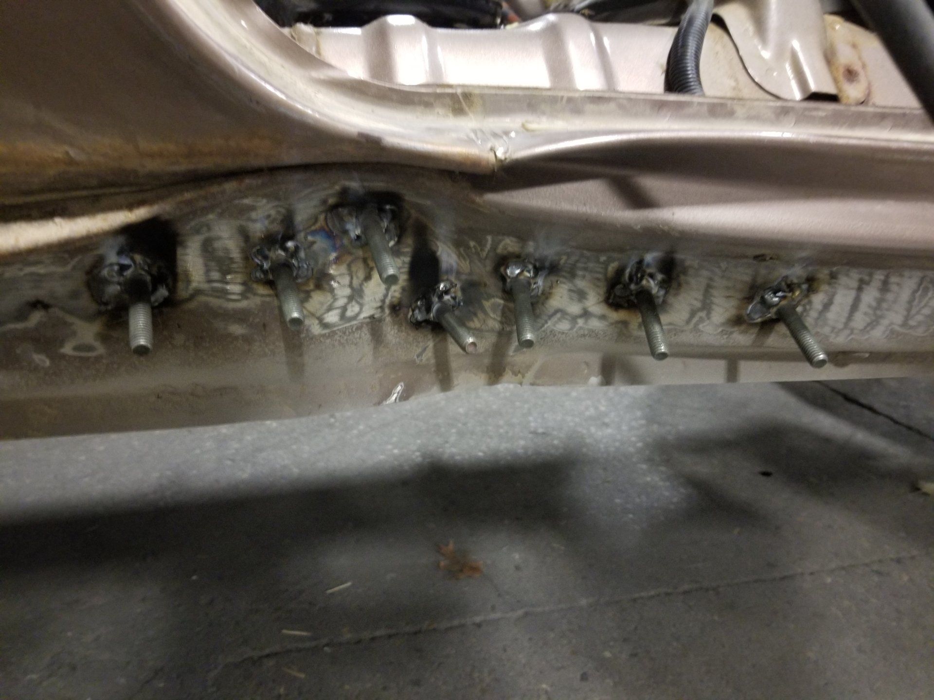

I started working on Chunk at my shop this afternoon. Since I don't own a stud welder/dent puller (yet) I improvised. I went after the rocker panel dent to get it out close to proper so I could then replace the face of it with the new piece that came with Chunk. I used my welder to buzz on some 5/16" bolts, then made a puller head with a nut and washer. I used one of the forklifts to pull on the studs and worked the dent out. I tore the rocker up pretty good but that's all good because I just needed it all dimensionally nice to replace the face part. Good progress.
Also got a little "inspection hole" cutting done. Might blast those tomorrow and see where to go from there. Not bad really.
