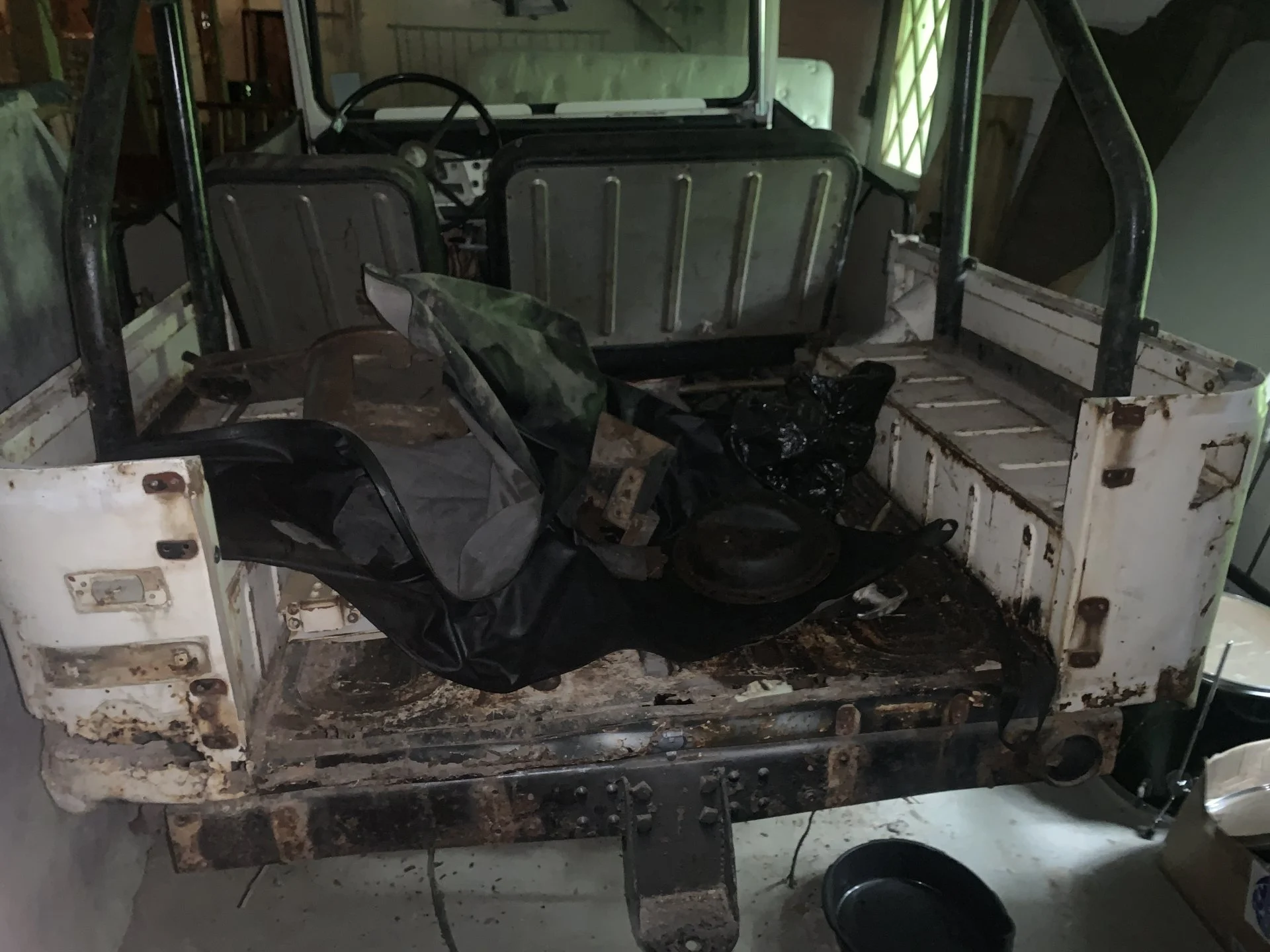

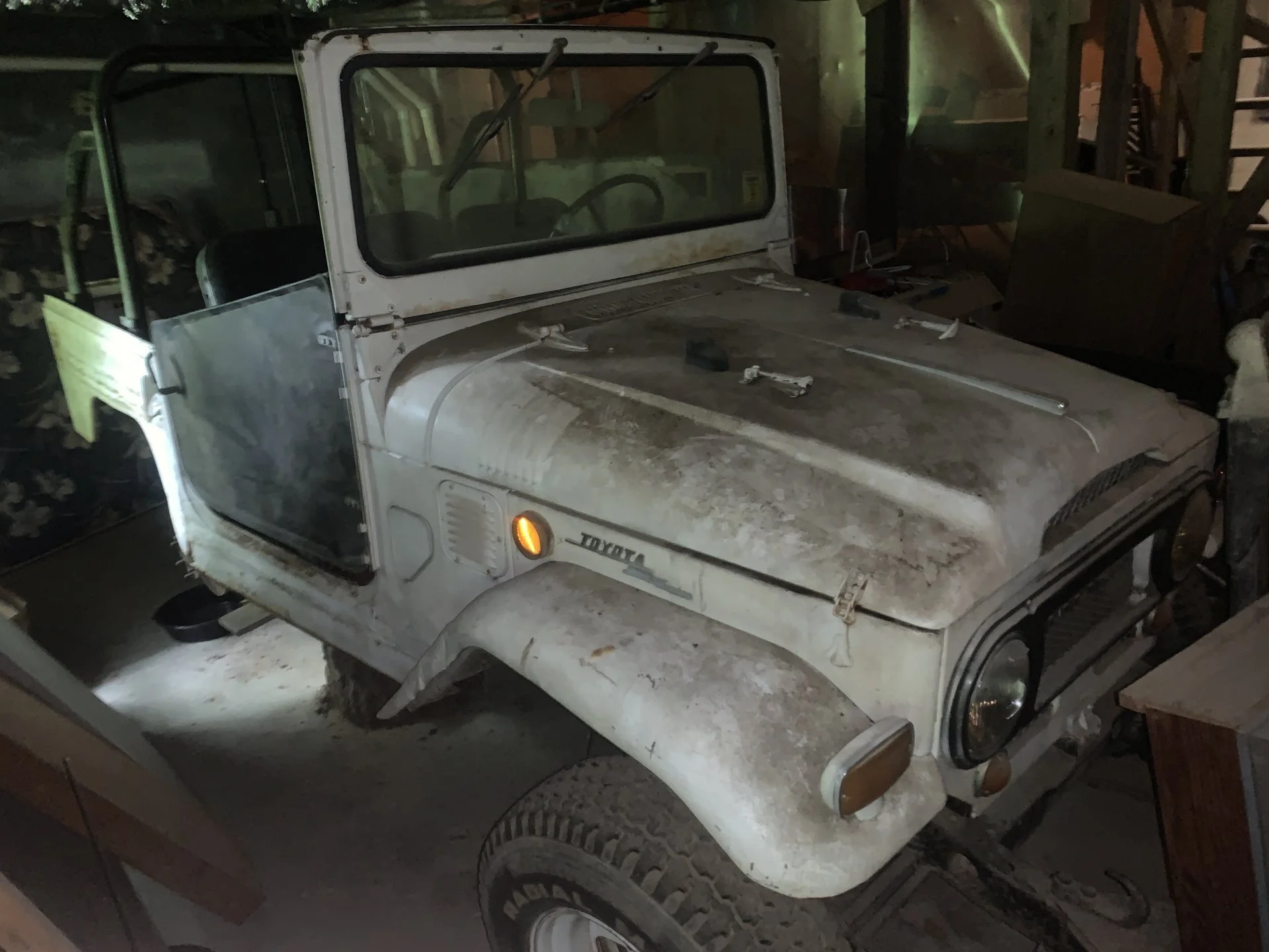

So the house I'm living in for at least the next year and a half has this fj40 in the garage. It hasn't been registered since 03 so it's been sitting for nearly 20 years, and it's got a pretty good amount of rust. I might be able to get it for free from the owner if I'm willing to put in the work to get it back in decent condition. So my question is, what would it take to get this thing back on the road? Obviously I can't get an exact answer through just pictures but if y'all had to guess does it even look like it's worth the work? I'm not a mechanic at all but I do enjoy working on my 80 and I've always wanted to have a project vehicle that I can take my time fixing up, so I'd be willing to learn whatever I need to. I'll attach pictures and thanks for the input!

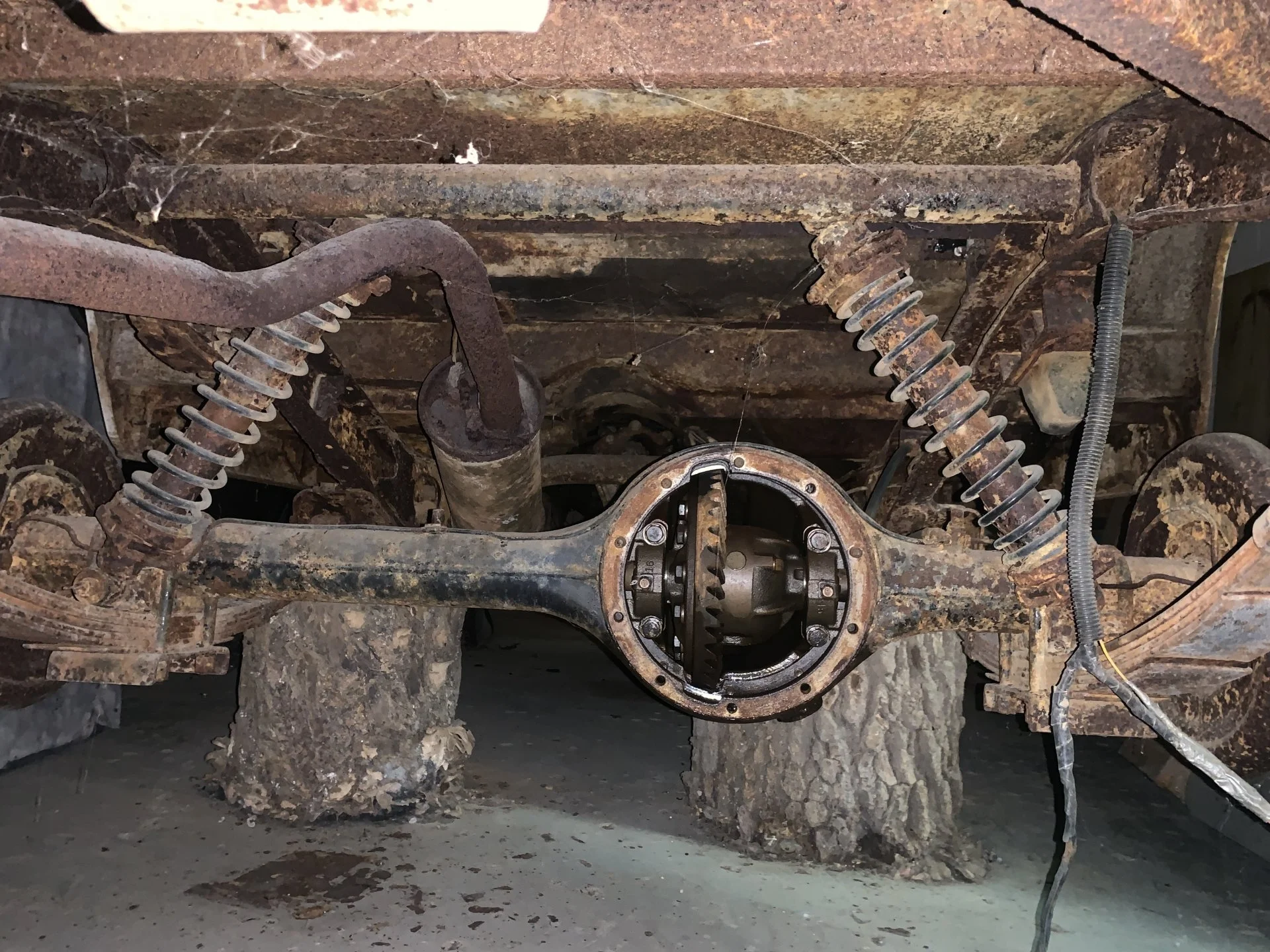

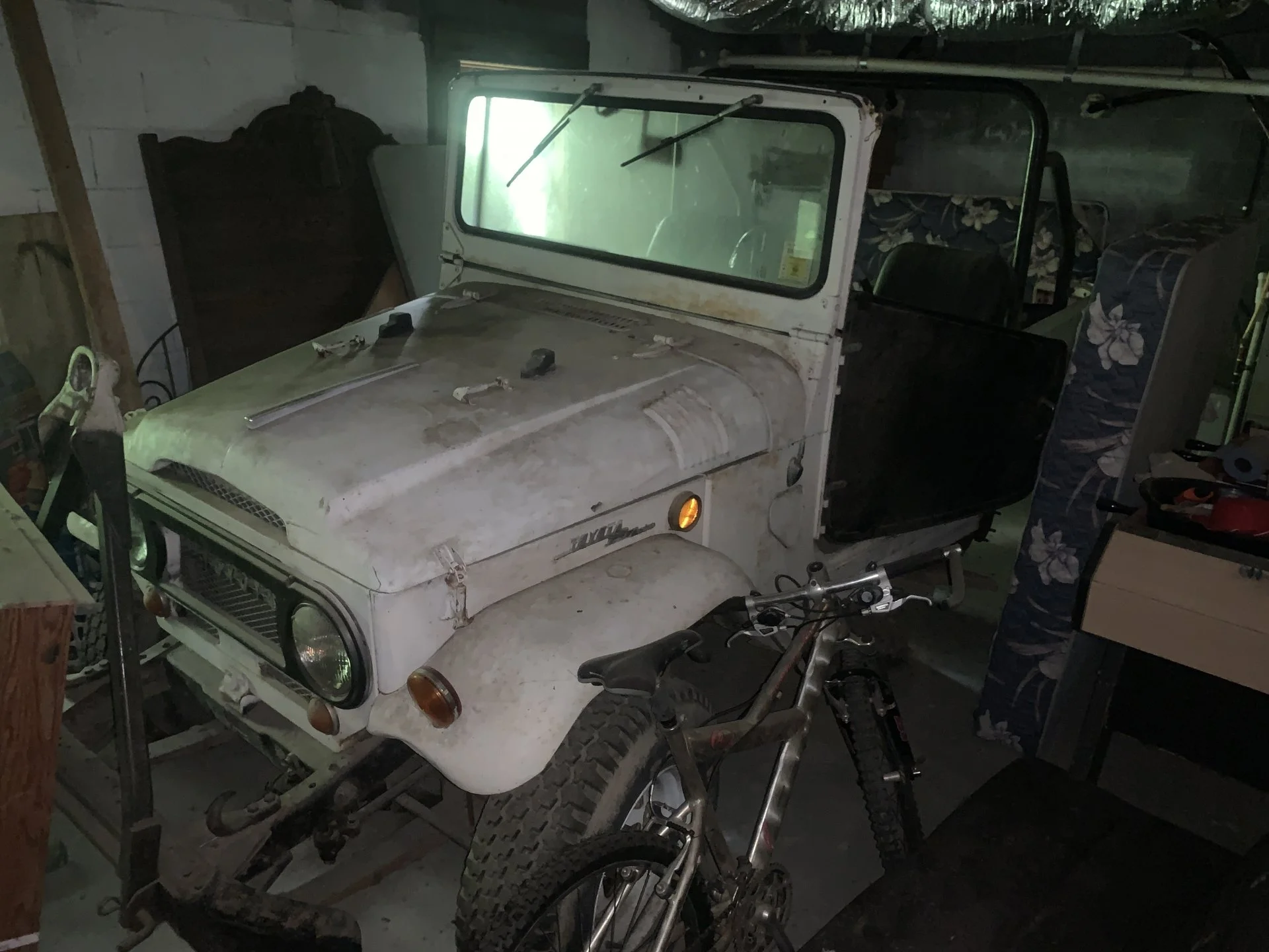

Doesn't look too bad to me, especially if you're just looking to get it back on the road...pretty sure that's better than what I started with body and frame wise. 🙃 The F engines are pretty simple as long as it's not locked up. Gonna need that rest of that rear axle though... 😆 I do appreciate the older models with the hood spear and the three on the tree...neat rig.
All depends on what you're aiming for...I bit off a full frame-off, and I'm looking like I'll end up having about 1000 hours into mine when I'm done, but that's a 100% soup to nuts project all done at home (frame, body, sandblasting, painting, engine rebuild, interior, etc). In this case, there's no hardtop and doors, and that was a fair amount of hours in itself for mine. I could almost see pulling the body to clean up the frame/drivetrain (it's pretty easy to get off the frame), but then leaning more toward a patina rig for the body with some tub patching.

They are remarkably easy to work on until something needs to be replaced rather than just adjusted or cleaned up. Replacing parts costs significantly more than you might expect and some parts on some years simply aren't available anymore. If you run into one of those issues, the options are to spend a LOT of money to buy the part from ebay or to find a part from another application that is or can be made to be compatable. That can sometimes require considerable skill or considerable money. There is no vehicle that is too far gone to be recovered if the owner has enough money, skill, and time. So, yes, you can save this 40. Whether or not it's a good idea is a question that probably won't be answered as easily.

You probably will need a new tub. No way 4-5k will be enough. I say this needs at least double that, and hundreds of hours to be in semi presentable shape. Parts are extremely expensive, and bills rack up fast. I would suggest only doing this if you have a lot of free weekends at your disposal. This is a big project.

If you can do the work yourself, and the motor seems like it has good compression and will run with some work, I would say you could get it running and driving for that amount. Depends if the frame is still safe or if too much is rusted out.

Yea, most of the time, these have a lot of hidden corrosion, and hidden issues that you don’t discover until you start tearing it apart. It could be a fun project, but just make sure you will be able to finish if you start
