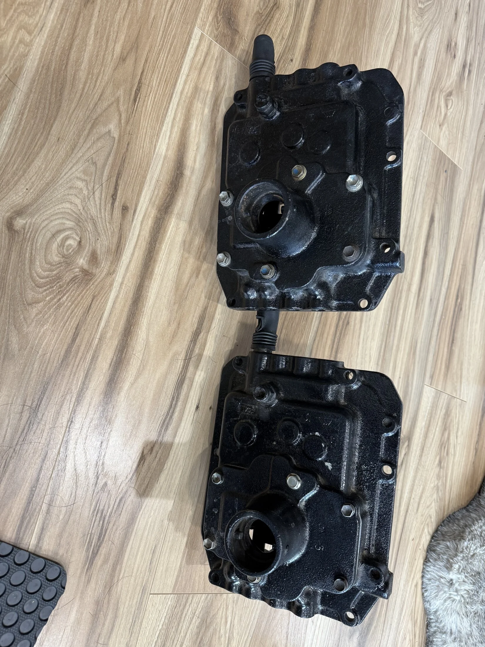

Any interest in this style of H55 40 series trans top cover?
If anyone wants one of the 5 speed covers, it would probably end up about $1200 shipped to your door in the USA. A little less depending on how many other parts coming in to share the shipping costs to get them over to me. I'll have one in hand in a few weeks and I'm told my contact can get 4 or 5 more for sure.

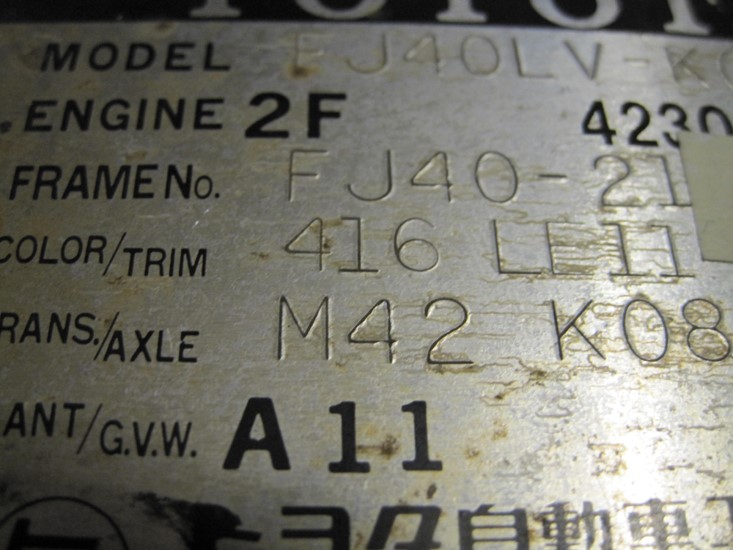

@OGBeno do you have listings for a H55F back to 1976? I have never heard of a listing before 10/82. If it was a proto I could under stand. I have a 76 that I'm convinced was a proto type (not with a H55F) with a M42 transmission installed. But I sure you will not find a listing for that transmission/transfer case setup.
The three pictures in the first post the center one looks like a four speed. No extension and the tailshaft is too short for an H55F. Other two pictures look the bolt on shift tower looks like they been modified. Hard to tell with so much glossy black paint but appears them have new welds on them.
I think this data plate has come up before in past H55F discussions.

@Living in the Past as mentioned earlier, the pics I posted are the ( what I believe to be OEM Toyota, could be Bandeirante ) cast iron top cover ( which I own ) bolted to an H55F ( 3-year old unit we bought new from Toyota ) with the 19-spline output shaft.
I purchased this cover in the Middle East a couple of years ago. The covers mentioned by the OP are also located in that general area. That makes me doubt their Bandeirantes since it’s a long way from Brazil.
I bolted that cover on strictly as proof-of-concept.
There is no safety provision to keep the operator from shifting from R to 5th or vise-versa other than common sense.

I am really interested if these covers were produced by Toyota and installed at the factory. Wouldn't rule out Bandeirante. No H55F transmissions were installed in the Land Cruisers shipped to US by Toyota. Look how many have made their way to the US. I Have no idea how many 40 series top covers are now in the US but obviously the numbers are continuing to grow. To convert a four speed cover to the five version would not be that, especially if you not concerned about the reverse safety.

The aluminum cover has a lock that requires moving the shift cane in neutral between third and four gear before going into reverse. You can't just slide it straight down outt of fifth gear and into reverse. Cast iron cover allows this according to Georg.
Doubt you could get the shifter into reverse coming out of fifth gear just a bunch of grinding.
Shift pattern is goofy.
On the plus side height is the same as four speed. 1/79+ would just need to move the hand brake the axle.
Four speed shift cane would work no need for the five speed cane.
Shifter says in the correct location for the 40 series which was a must for me.
