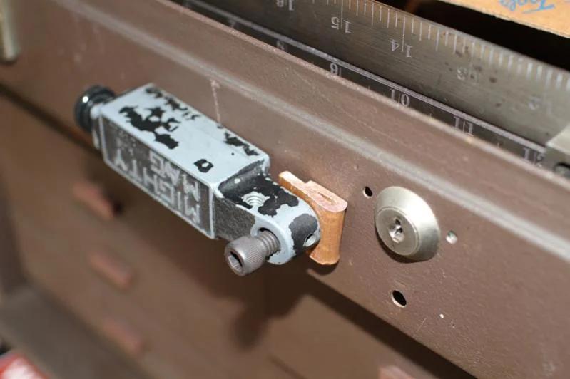

Home made plug welding - welder helper tool:
Look back at the small, in process patched area on the door in post #159 – this thing is down inside the door, holding a small ¼” 18 GA disc behind the 1/8” hole on the right - ready for weld. Also made up a copper attachment (see below). More “long-winded” :grinpimp: details if you want them at:
http://www.fj40toolbox.com/?q=content/home-grown

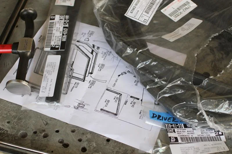

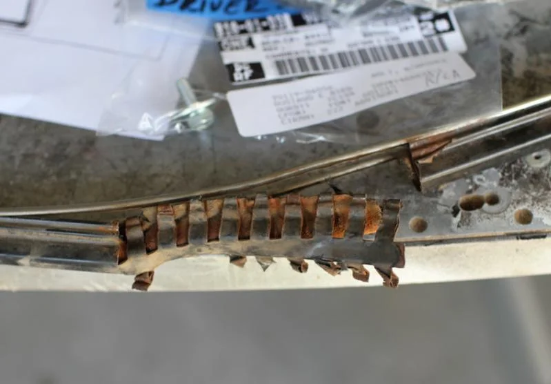

Trying to bang my driver's side door back into shape. Hoping to get close enough to not need plastic. Haven't decided if I want/need to pull the doors off the truck yet. Might want to get some lower areas blasted.
Also trying to get replacement door parts together (OEM). Most of the window guides are toast - the lower glass guides just turned to dust when I tried to remove them intact. The upper piece (chrome trim) is toast. Got the main door weather strip rubber and a few lower glass guides - still waiting to see if the proper upper chrome/glass guide comes in. Guess I'll need to replace the smashed lock at some point too.
To do it right, I'll no doubt need the same stuff for the other door, even though it's in a lot better shape. That should probably get done before when/if I decide to paint the whole truck at some point.
