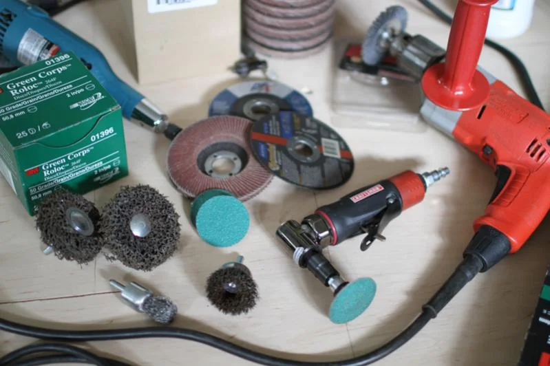

Decided in my usual, irrational, unorthodox (backward?) way to weld up all the nooks and crannies in my bed in place of patching. Some burning old paint spattering out of the pot holes as they're welded up and a good amount of cleanup grinding involved. Tried to chemical strip as much old paint first but I’d still like to find a better abrasive since blasting is not an available alternative right now. None of the abrasive discs, etc. I’m using really seem to get in the small areas that well. May need to just wait until I can get light sandblast here and there to really make sure the rust is out. I’m looking at Scotch-Brite™ Roloc™ Bristle Disc, 2 inch, Coarse grade, 07524 from 3M never used them before.
Disc is a molded, abrasive filled bristle disc instead of wire brushes for automotive use on aluminum and metal. Use for deburring, blending, finishing, polishing, cleaning and for coating, defect, scratch and rust removal. Use 3M holder #7500 for ea

I've used those before. Works great on large flat areas!
If you use it anywhere with sharp edges etc. it will dramatically decrease the life of the disc ($$$).
I also get the 3" rolocs for those areas where a better reach helps. I also use the backside of the 3" at times too, for really hard to reach areas.
Rolocs rule! In 2", I use the ultrafine (grey) for aluminum polishing, fine (blue) for gasket removal on aluminum, med (burgundy) for general steel, and coarse (brown) for hard grinding.
I have their radial bristle brush - 6" on my bench grinder in medium/yellow and coarse/brown in lieu of wire wheels. They work great.
I even have the radial bristle brush in 3/4" in all grades that I got from a jewelry supply for the dremel. Works incredibly.

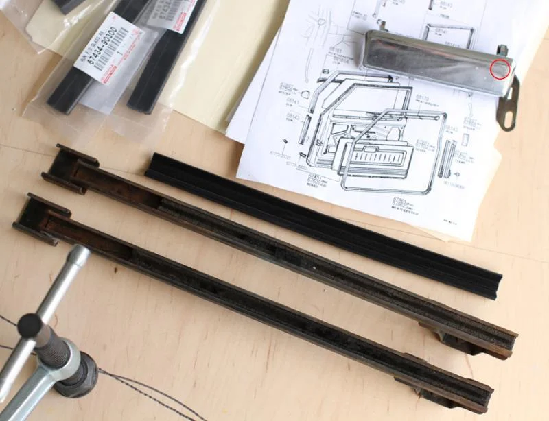

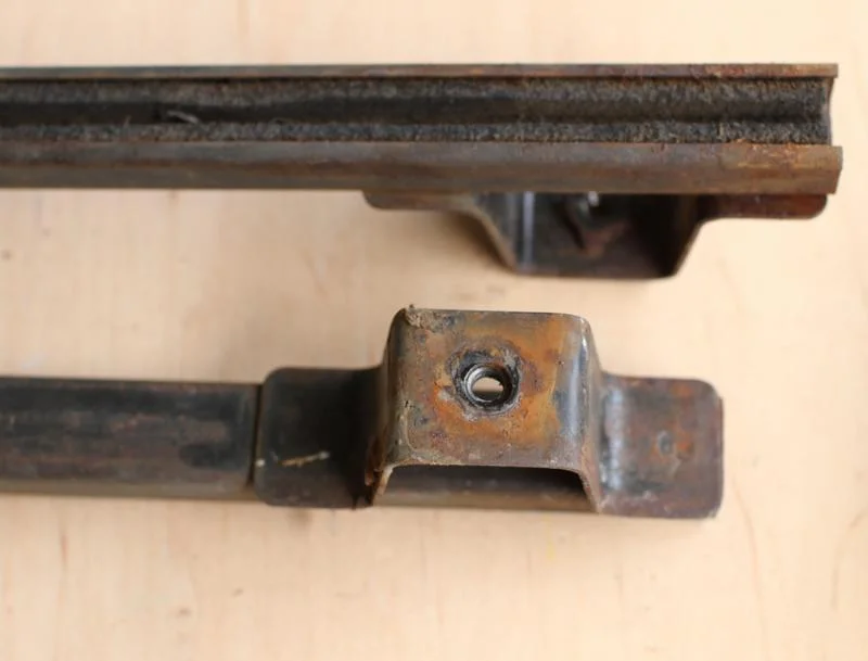

Finally found a set of door lower window guide channels ebay (needed one for the driver-side door). Nobody seemed to have them, Toyota, SOR, etc. These are from a 76 and seem like they will work for my 78. Toyota lists 2 part numbers (67407r/67408l) for these (discontinued) parts, but passenger/driver seem identical in this set. The new replacement liner “felt” (Toyota) seems more rubber-like than the old stuff. Lower bolt is 90119-06056. The rubber/felt run has an old number 68143 and the new stuff I received from Toyota was 67434-90300 - seems to fit the channel really well.
Also picked up a used driver’s-side door handle but it has a small stress crack in the same place as my original (red circle in picture). :frown: This must be a pressure area that cracks on a lot of old handles.

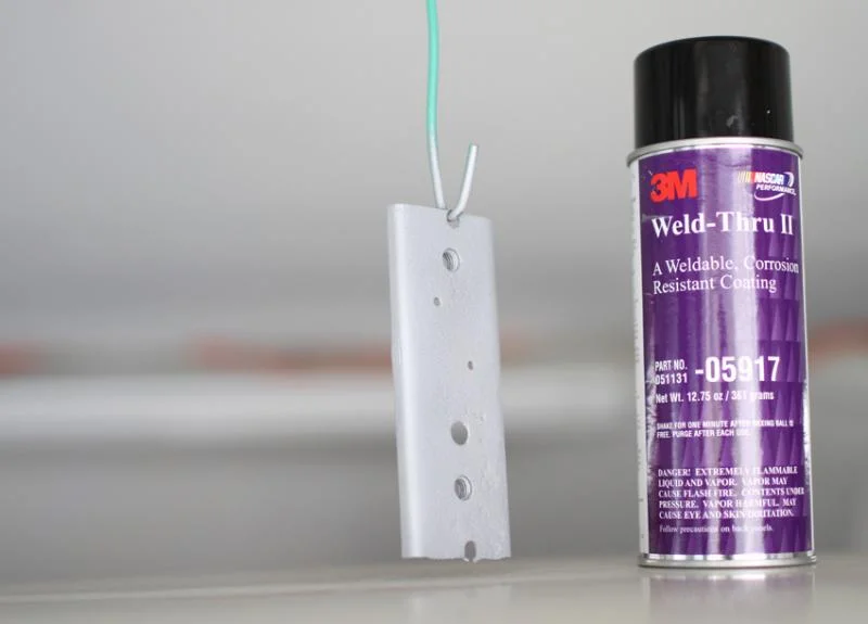

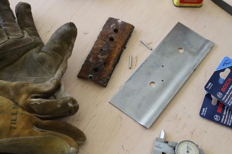

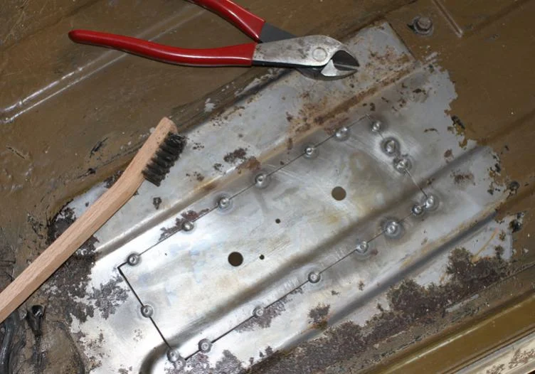

Another day - another patch - working my way around the truck. This is the driver’s seat front support area, window side. First found this crack when I bought the truck and did a temporary quick cleanup/POR15 of the floor. Didn't have a welder at that point. This part of the floor must get worked a bit from the movement/weight of the driver.
It also has the standard FJ40 “rust creator” support plate that was eating the floor from underneath. I’ll try to clean up the plate and weld it back on when the patch is in place.
Cool idea using the roll pins for alignment. If you've shown that before I never noticed or it went over my head....
The dowel pins are kind of a machine shop thing - they’re also 1/8” so a Cleco clamp could be stuck in any of the holes if needed. It’s really helped me get parts like the wheel-well brackets, support plates, etc. back in the original location for welding. They get drilled/reamed first before anything comes apart. Hows the TIG?
photo 1 - Patch tacked in. I need to get a small brake (minimum) so so I can get my bends a little straighter :D

Cleaned-up support plate.

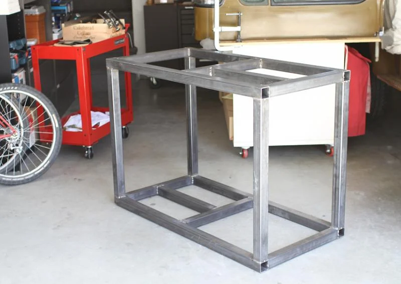

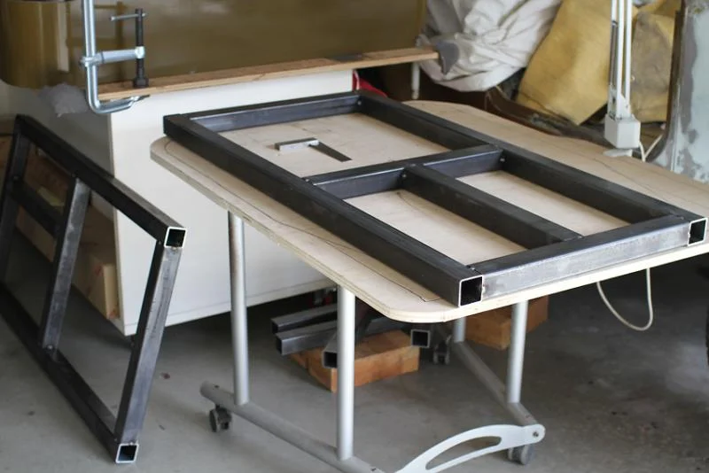

Putting together a universal work-station/bench with heavy-duty casters so I can move it around the garage. I don’t have lots of space and anything with wheels always seems to work out well. The idea is that I’ll be able to use it for a number things - weld table/work station - steel top/wood top - mount a vise/small brake, etc. etc.
Anyone know of a captivated-nut/insert system that would work well for getting some good threads (3/8-16, flush) in the steel tubing (1/8 inch) walls with no access?
The "tank" :grinpimp:
Size is 24" x 48" by 34" tall (before casters) kind of around a larger Snap-on box. A bit on the high side for my old tall (and heavy) chin-chin vise :hhmm:
Goobered-up the welds, never welded 1/8" tube before. Put .030 wire in the machine and cranked it up so I think they are strong - just not very pretty (more grinding). Hard to judge penetration on that dark square tubing with no experience. Probably weld a 1/4" steel top/shelf and attach whatever material, removable tops to that. Still need to weld caster plates to the bottom.
Never mind the photo perspective, top/sides seem square within an 1/8".
