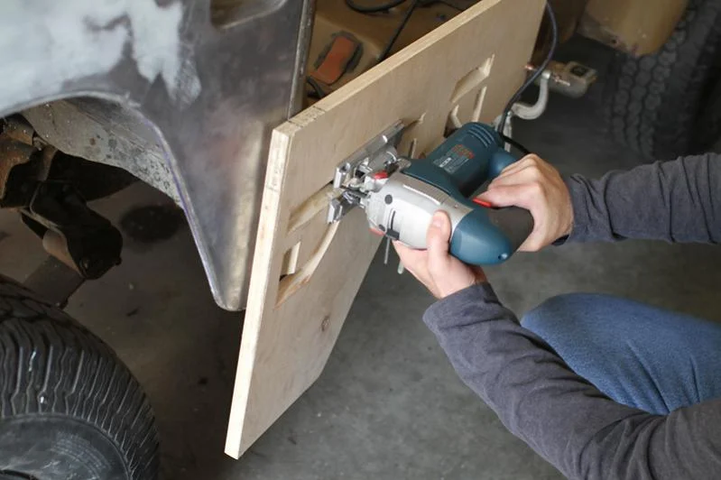

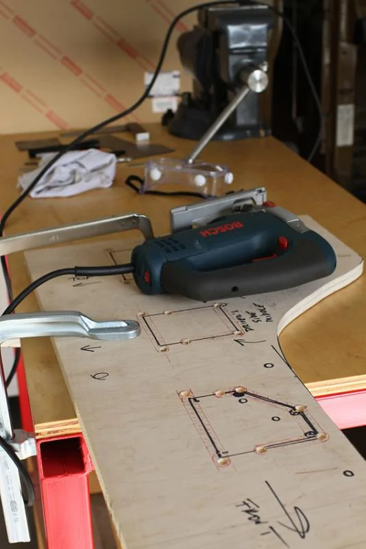

In process on a rough support jig out of plywood for use with the Bosch saw that will just clamp to the rockers. This gives the sheet metal support (cuts down the vibration) and gives the blade the right distance so it's not banging into the inside rocker wall, etc.
Making more and more cuts with this saw and a fine tooth blade for steel these days. Anything to get away from the angle grinder/cut-off disc. Cuts are faster, colder and seem more accurate.

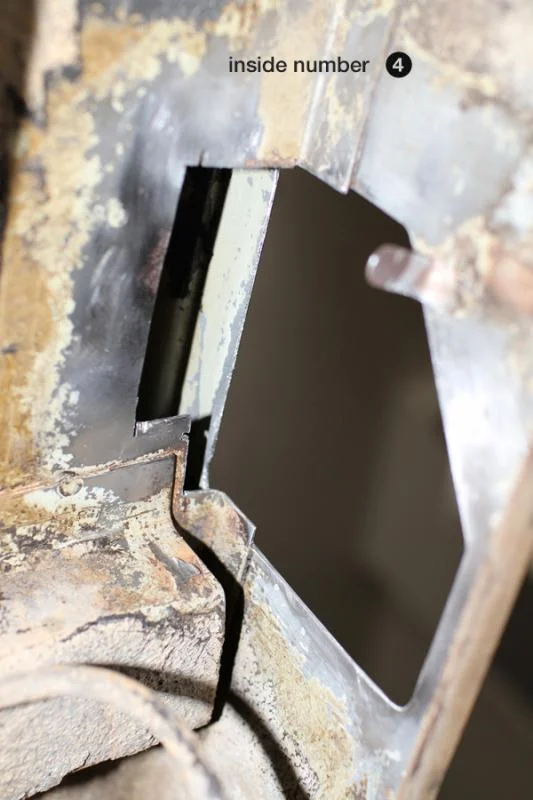

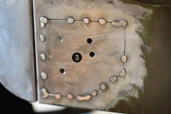

Got some patches made up - now a bit more cleaning up down under/inside and I should be ready to weld the patches. Think the 3 last brackets and inside the welded patches will get a brushed-on coat of EP and time to cure before they get welded back in.

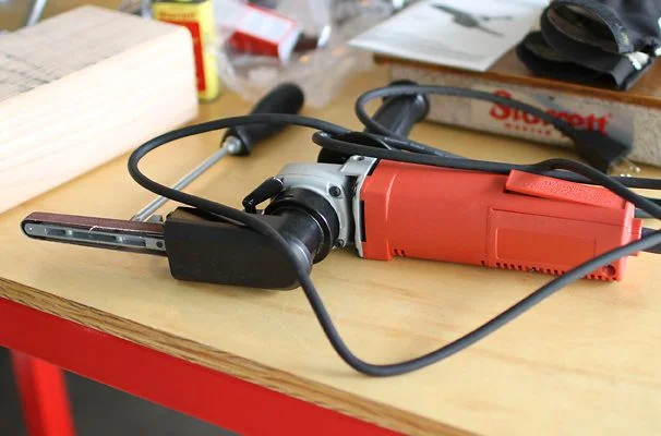

New Bandfile (Milwaukee 6101) I'm going to try and use for grinding welds and getting into tight places. Thought about something like the Dynabrade 40320 that Awl_TEQ is using but it cost twice as much and I'm not sure my toy compressor can handle it. No variable speed on this guy so time will tell how well it works out. Going to check out what 3M sells for belt replacements.

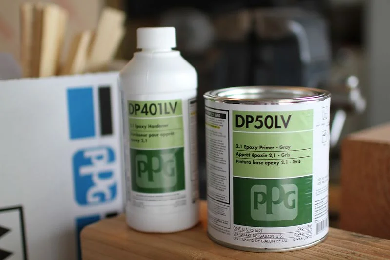

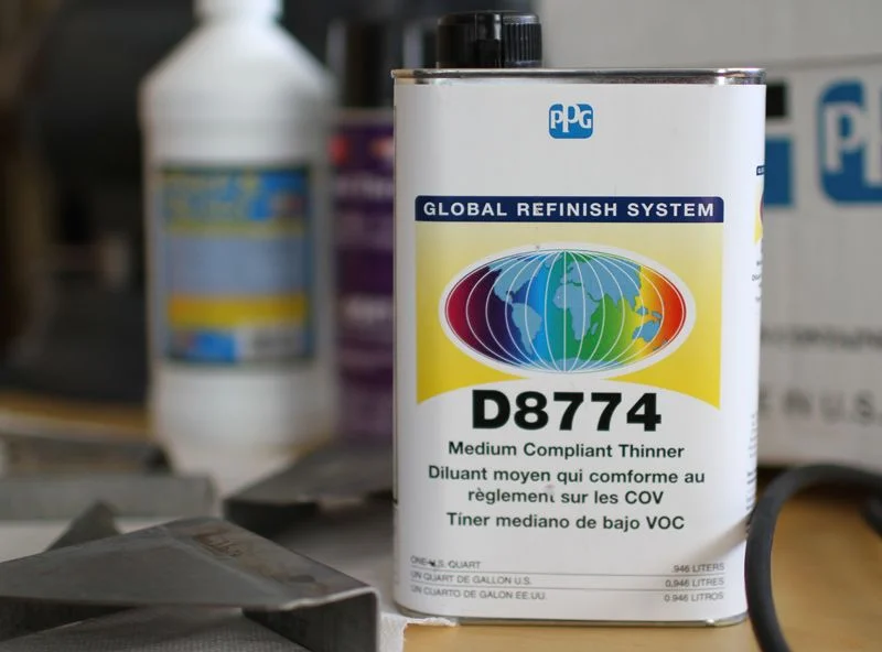

Got a 3M paint mask and picked up some PPG DP50LV epoxy primer and hardener that I'm going to experiment with in some hidden areas where cosmetics are not so important. Thought I would use a brush to begin with, test out some curing/welding issues and work my way toward spraying a little at some point down the road.
This stuff is "2.1" but on the material sheet I noticed they also seem to call out one part reducer (2, 1, 1 D87xx)? The paint guy didn't mention reducer? Does this mean that in all cases a reducer should be used (temperature notwithstanding)? I want to spray from a smaller gun in future so I'm sure the 2.1 would need additional thinning? I also want the brush work to "wick" into some lapped (original factory designed) seams here and there if possible, so I would think thinner would be better for that - even with the brush?
Also looked at one of those plastic tops that seal to the top of the can with a pour spout and mixer built in - will that keep the primer fresh enough over a period of time (instead of just resealing the can)?
Thanks for any feedback!
I'm not an expert, but I thought the '2.1' was the VOC or Volatile Organic Compound emissions the product produces when it is applied according to the manufacturers guidelines. I "think" the 2.1 represents pounds of VOCs per gallon of material. I.e., no more than 2.1 lbs of VOCs will be emmitted in to the air when applying a gallon of the material.
The 2.1 is not an indication of the mixing ratios.
I would definitely use the reducer when spraying. You might try it without the reducer when brushing but I'm not sure how this might effect workable times and dry times. Without the reducer, the product may be applied too thick which could lead to issues down the road like cure times and top coat adhesion.

Be careful with using plastics such as the cap you are referring to with automotive products. Some plastic tools made for laytex and household style paints are not going to stand up to automotive paints and solvents. I've experienced this myself and now only use paint buckets, spouts, etc from an automotive paint supplier that I know will not dissolve over time.

Thanks Mike - This thing was from the auto paint supply guy, so I don't think that's an issue. I think it helps one stir the paint and pour randomly without the mess of opening and resealing the main epoxy can every time - less mess, etc. I was just wondering how well they seal between uses.

Mike,
You, as usual are spot on. I think my ignorance (relating to paint in this case) is quite impressive :grinpimp:
Returned to the paint guy and got some reducer to go with the primer. This primer (DPLV) is apparently the newer politically-correct stuff - the reducer was not like the older stuff on the shelf, which he said would not work with the DPLV. I've heard/read a good number of people knocking these new paints and the protection they offer (compared to the older paint systems) but according to him they've been used in Europe for a good while. Anyway, they still seem pretty nasty as far as safety issues, etc. :)
