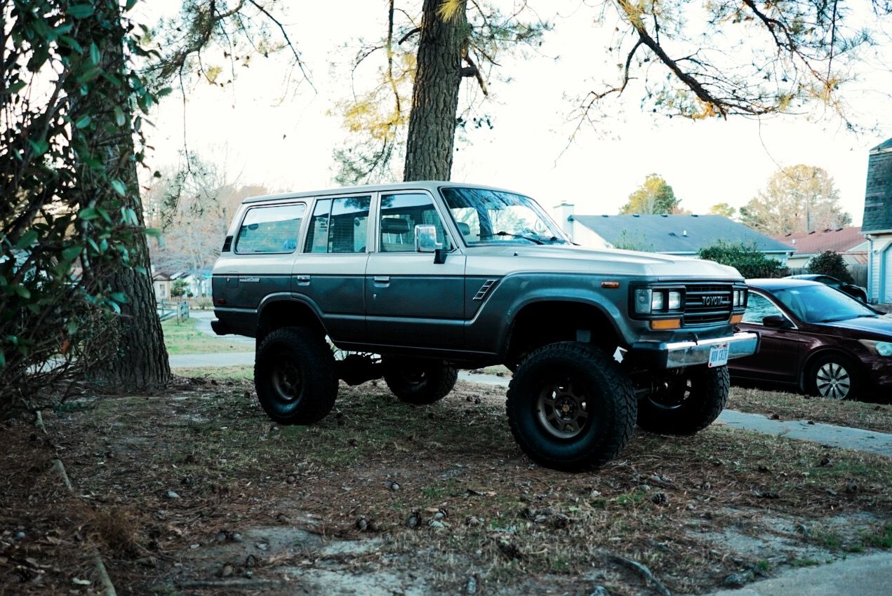

Well the time has come to create my build thread. I've purchased my rig, talked to tons of different people, dreamed about and lost sleep about where I want to go, I've ordered parts, and now it is time to get to work. A few months ago I picked up a 1989 FJ62 Land Cruiser with just over 240,000 miles on her. She lived most of her life out west and then was brought to Georgia by her previous owner. Now she is with me in Virginia Beach getting a refresh at the spa! I am coming from a built 2012 Tacoma that was sitting on 35's; after seeing some of the 60 series that were being built on here, I knew what my dream rig was. So here is the plan:
Phase 1
  • Baseline the vehicle ✅
  • Spring over Axle conversion ✅
  • 80 Series locked rear axle conversion (Locker ended up being faulty) ✅
  • VTX wheels wrapped in Cooper ST/Maxx 315 75r16 (34.5ish" tire) ✅
  • Sliders & possibly bumpers front and rear
  • Lizard Skin interior of the cruiser ✅(partially)
Phase 2 (edit)
  • Vortec Motor Swap 5.3l LM7
  • 4L60E Transmission Swap
  • Holley Terminator X
  • Transfercase Rebuild with twin stick mod
  • Sliders
  • 3-Link front axle using 80 Series Front Axle
  • Fix hole in rear cargo area where previous owner serviced fuel pump
Here is how we are looking now:
(I threw in a picture of the mentioned Tacoma)
edit: As of January 13, 2021: acquired an LM7 out of a 2004 GMC Yukon, V8 Vortec swap is now commencing! Let the parts acquisition begin.

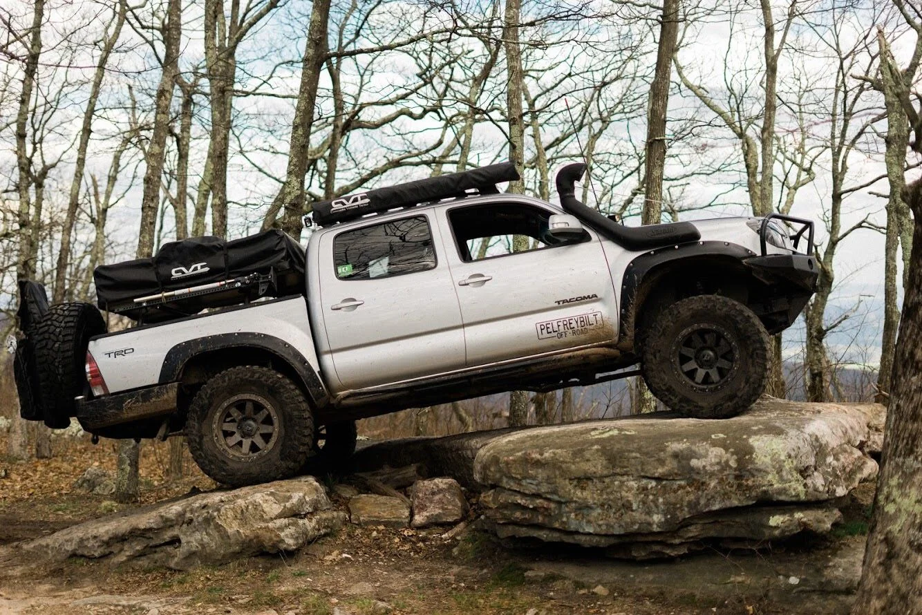

Subscribed. Wheeling in a 60 is going to be sooo much better then that Tacoma. My dad has a 13 and you can’t even see out of it, the top door is at my shoulder height.
With the tent on the back and the bumper up front it was hard to see anything. The scoop on the hood although small didn’t help either. The 60 series has windows everywhere its awesome to be able to see so much!
