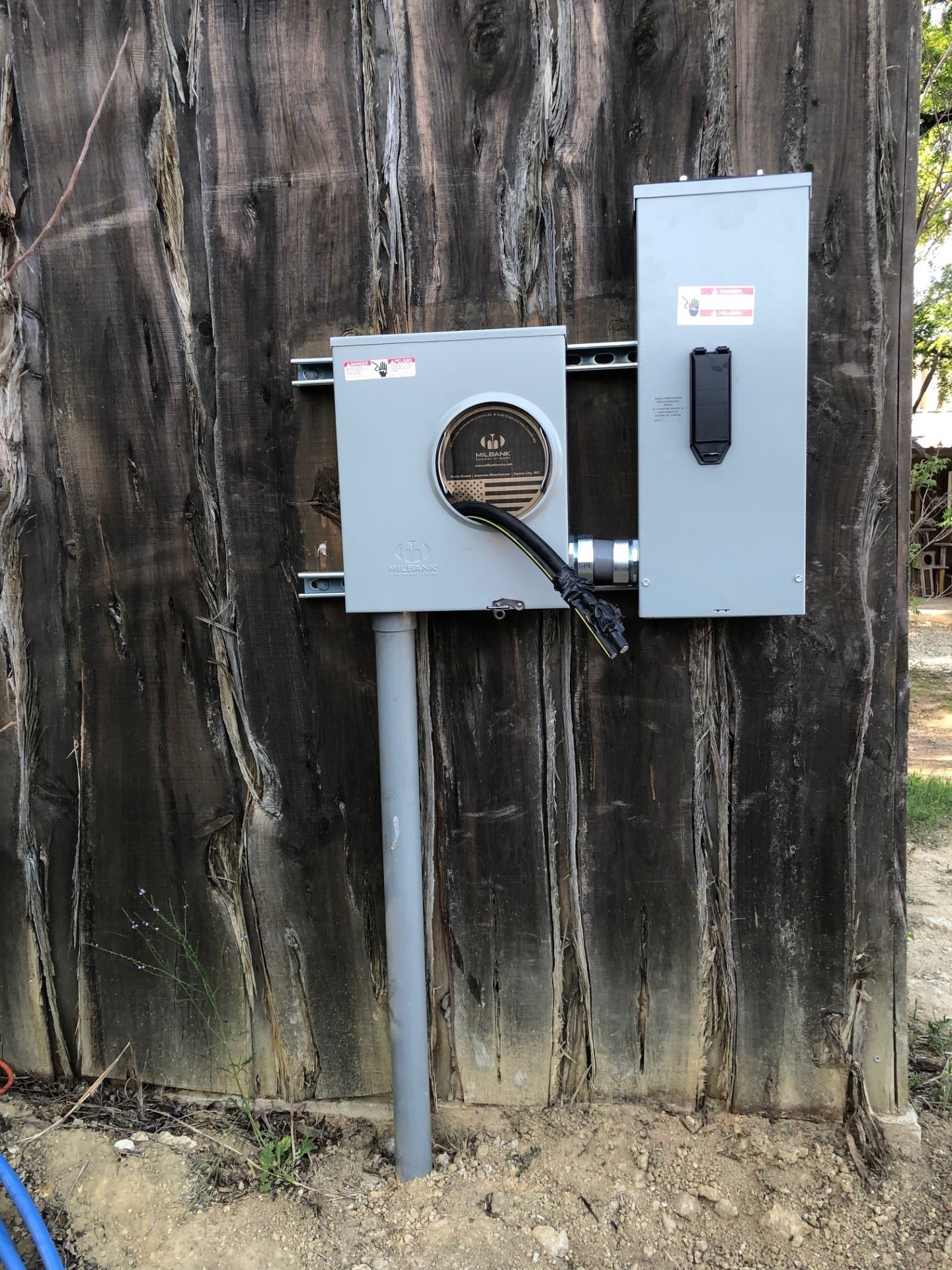

Good work. Next time, find an offset nipple. Works like a dream and the way they can infinitely rotate helps align all sorts of holes, various backspacing, etc., assuming you don’t desire the cans/enclosures to be perfectly aligned bottom/bottom.Latest little bit of progress: I put up the meter base and 200-amp disconnect for the house myself. A simple thing for a lot of you guys I suspect, but it was all new to me. The hardest part was figuring out how to connect the two enclosures with the correct components. The 2" knock-outs in both enclosures do not line up; different manufacturers. I would have thought there might be industry-standard offsets for that sort of thing (including the offsets for the mounting holes) by now, but apparently not. A piece of flexible conduit and some compression fitting hubs made for it were the answer.
The first of many things electrical I'm sure I'll have to learn. Besides the satisfaction of doing it myself, it saves the money from having to pay an electrician to come do every little thing.
The electric co-op that I get my power from had a contractor come out and trench and bury the conduit and line from the power pedestal under the pole with the transformer to my meter base. Waiting for them now to come hook up and set the meter.
The location of the meter base is on the well house, facing the big house, so it will easier (no turns) to run the heavy cable from there, in PVC pipe under the driveway and house, to the main panel in the mechanical room in the middle of the house.
I'm surprised that they didn't require an expansion coupling up to the meter.
