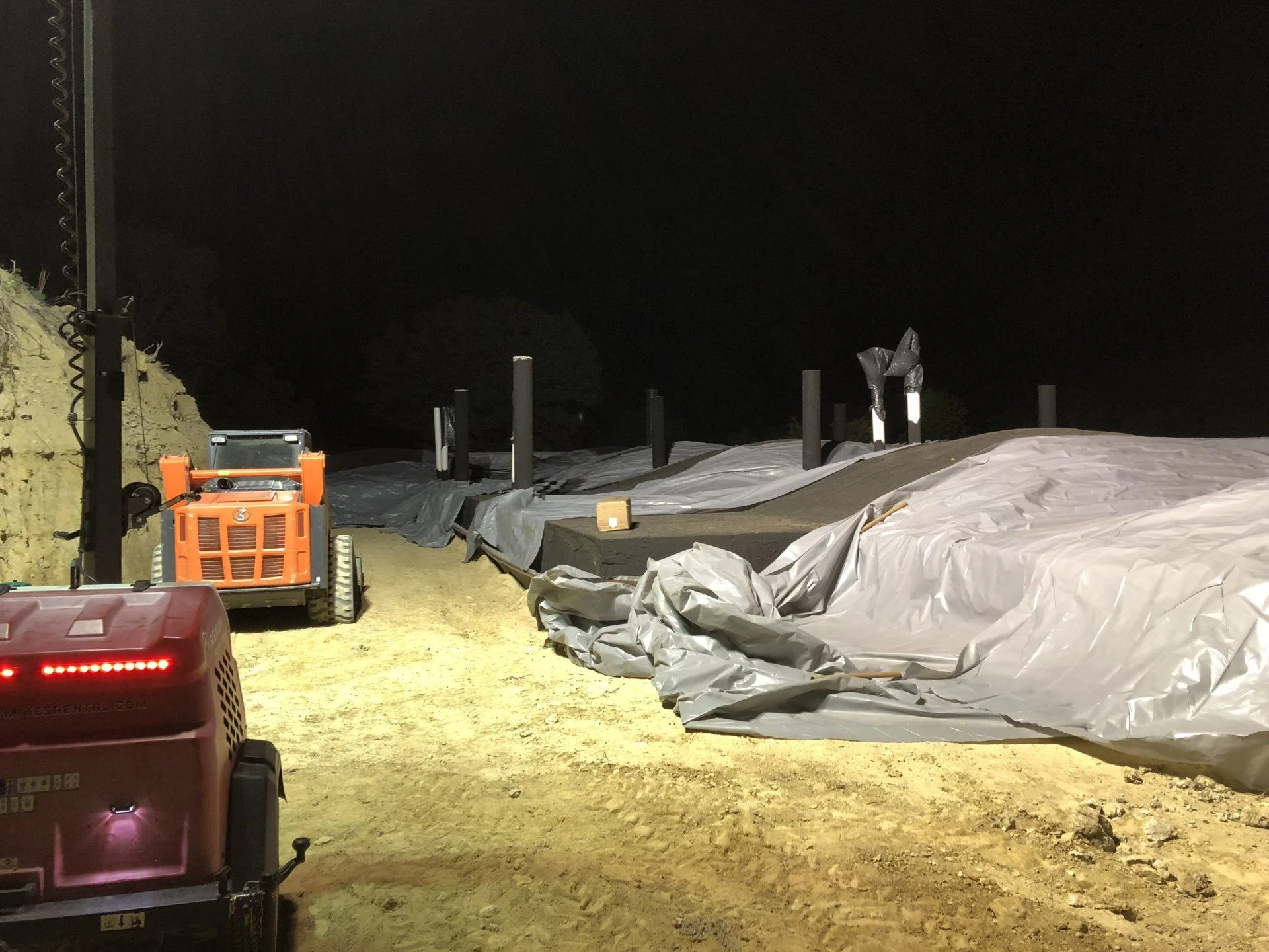

Progress, finally! Tried to lay out the 10-mil plastic sheeting over the top of the house three times this week, each time, the wind was too much (even at only 10-12 mph). This stuff is HEAVY (145 lbs. per roll), and each roll unfolds to a 20' x 100' sheet - but with any kind of breeze, it quickly turns into a 20' x 100' sail. Even if you can get it laid down, the breeze just picks it up again, almost no matter what you weight it with (tried rebar, clay, rocks...). Looking at the weather forecast, some wind was forecast every day this week - except in the wee hours of the morning today. So, up at 1:45 am, out laying plastic by 2:00 am. It was dead calm, and it went down easy. Had to cut holes for the vent stacks and solar panel support pillars. Overlapped like shingles; laid the valleys between the domes first, then all of the parapet wall, then the ridges (domes).
There was no moon to speak of, so we rented a Generac portable light plant.

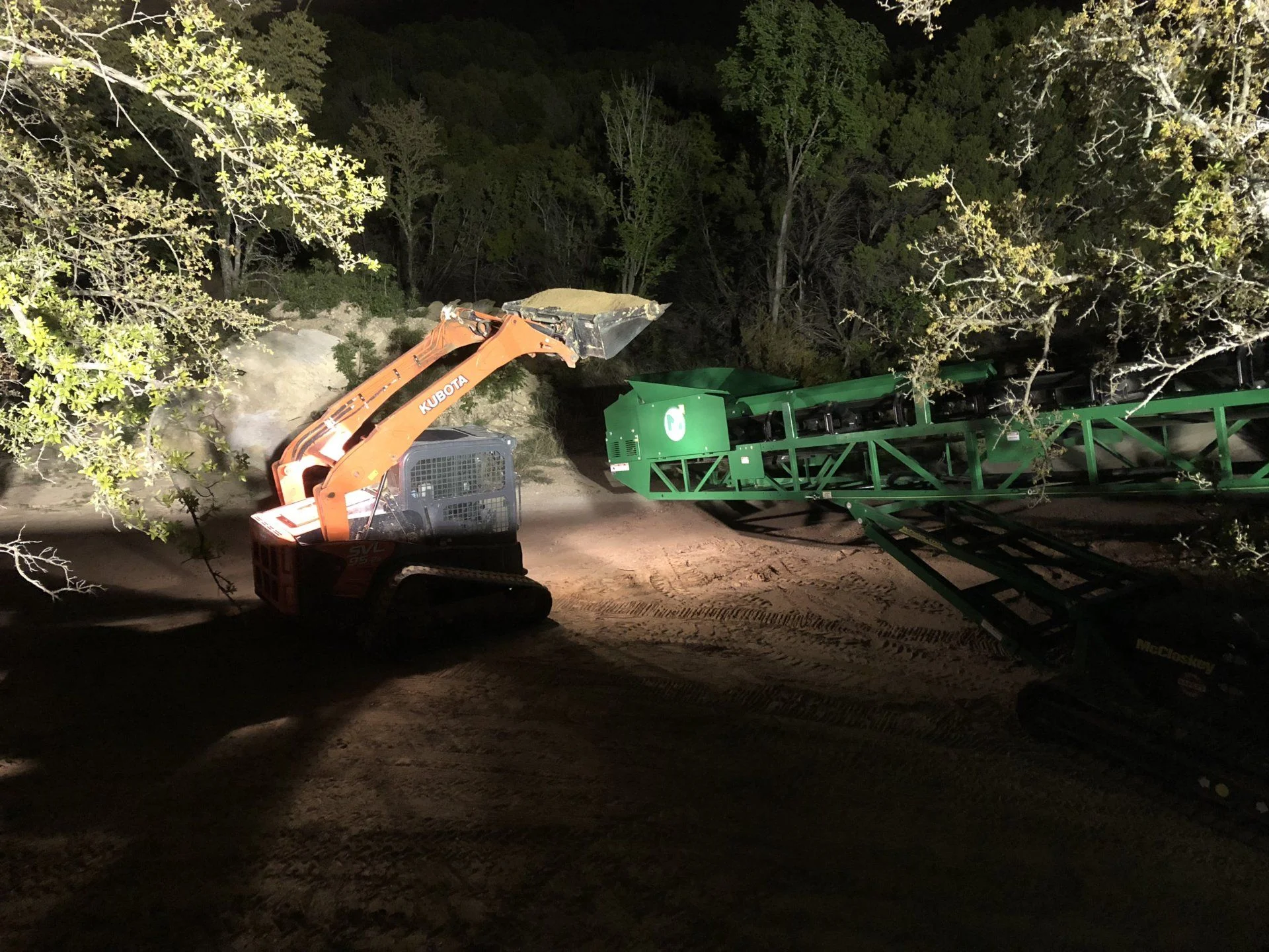

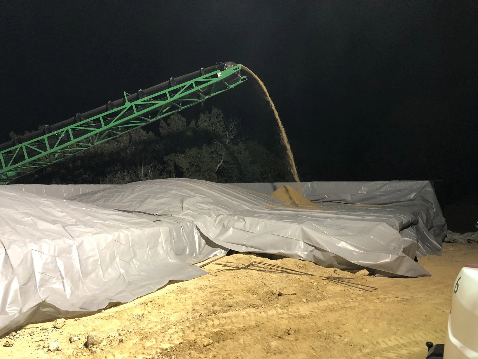

3.5 hours later, it was complete, and we started putting soil on top to hold it down. The dirt contractor rented a cool track-mounted conveyor belt that is self-driving by remote control. Puts soil up on the roof without having to drive equipment up there yet (you don't want to ever drive on the bare concrete - only after a foot or so of dirt has covered it).
You feed the conveyor at the bottom with a track steer or similar:

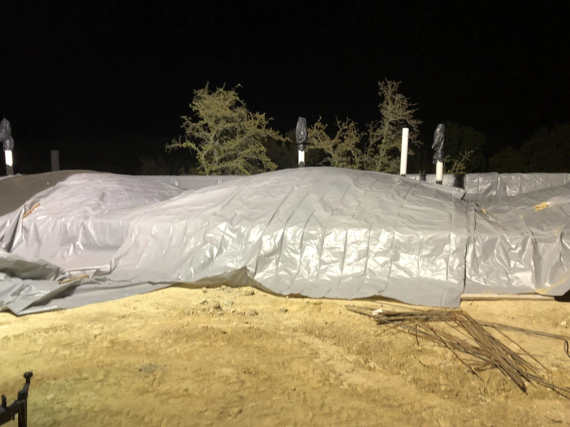

Another 2.5 hours work, and we had enough soil piles on the overlapped seams to keep the sheet plastic in place for the remainder of the back-filling process. A light wind came back after the sun was fully up, but everything is holding so far.
Rain is forecast for tomorrow, that's why I wanted to at least get all the plastic sheeting on by today. Hopefully there won't be enough rain to wash much of the soil away. Less than an inch is forecast, last time I looked. Back-filling will resume again in earnest on Tuesday.
Wow, what a cool story you'll have to tell the grandkids. A lot of work now, but down the road it will be fun to think back about all of it.
Keep at it man!
