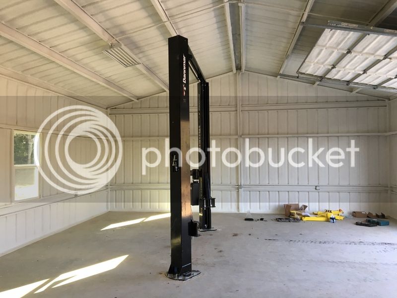

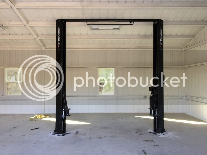

Installing the Dannmar D10/ACX asymmetrical 2-post lift. Track steer makes a great ladder/work platform:
All mechanical/hydraulic components except the arms installed; only needs the electrician to hook it up to 220 volts (built into the ceiling in anticipation of this very thing), hydraulic fluid, and final adjustments. Will install the arms after the floor is epoxy coated next week.

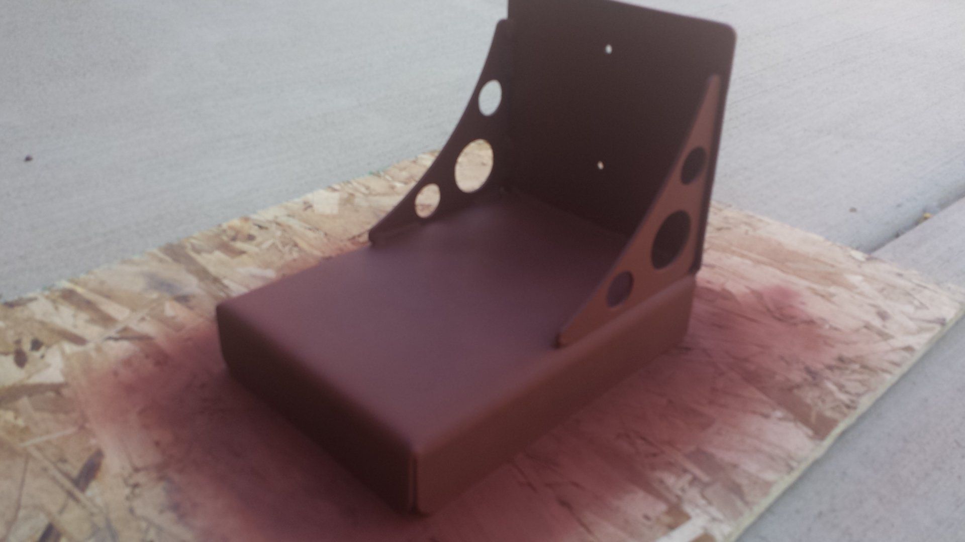

Coming along nicely. I wanted to share an upgrade for your lift that I did to mine. The hydraulic reservoir on newer units are plastic and secured by four small cap screws and are left to float out there. After install,I bumped into the unit and noticed the flex in the now filled reservoir, I always think of the worst case scenario and realized the mess I would have on my hands not to mention the added weight placed on the plastic flange if broken off. I ended up making a shelf for the unit with a 2" lip or of 10ga. The reservoir is now rock steady and has protection. I did place a piece of neoprene between the tank and shelf as well. I hope this helps.

Thanks for the great idea; I was surprised that the tank is plastic and only hangs from the motor/pump, considering that it holds 16 quarts of hydraulic fluid. Once I get all my tools moved in, I will have to make something like that.

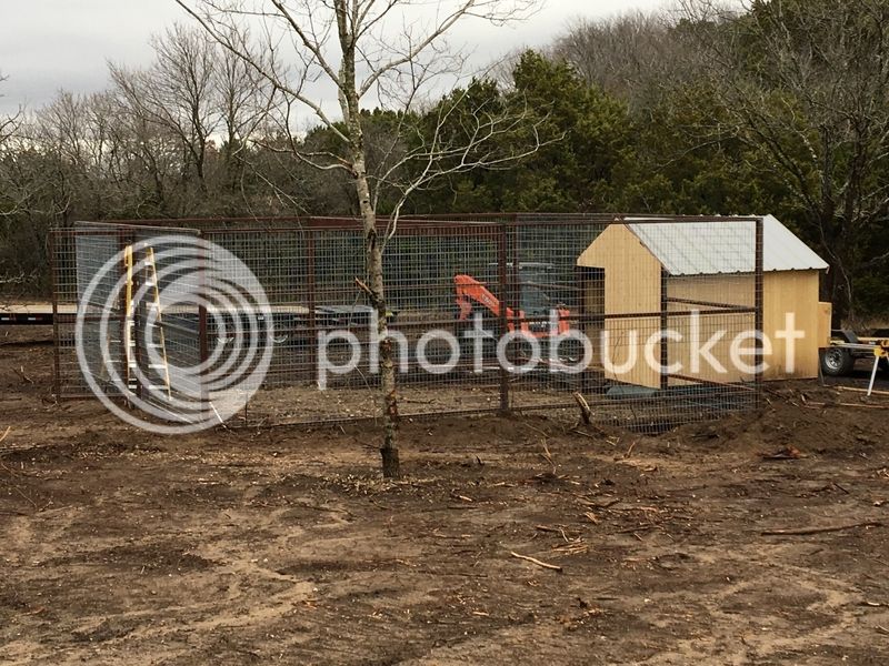

Mrs. 1911's impregnable fortress chicken coop and run, made of 2" square tubing, metal purlins, and welded hog panels. The hog panels on the sides of the run are buried at least 2' deep at the bottom, so that nothing can dig under them. The run is 8' high so even I can walk under it easily, and will be covered on top with a screen shade. Water from the well is plumbed inside the run, so no more hauling water for the chickens. Electricity to the coop and run as well, if ever needed/wanted.

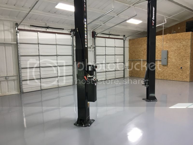

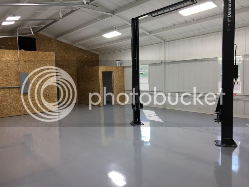

Epoxy coated floor applied to the shop and apartment. Very happy with the way it turned out. Makes it a lot brighter in there, and so easy to keep clean - just run a dust mop over it.
On that last photo, you can see the bathroom in the back corner of the shop. A real luxury for me, not to have to go outside to pee or back to the house with greasy hands and clothes to take a s***. Even put a shower in there, so you can clean up out there when you're finished for the day. Or if you need to flush your eyes or something.
Now I can go ahead and install the arms on the lift. Still waiting for the electrician to hook it up to the 220 v power run overhead for just this purpose.

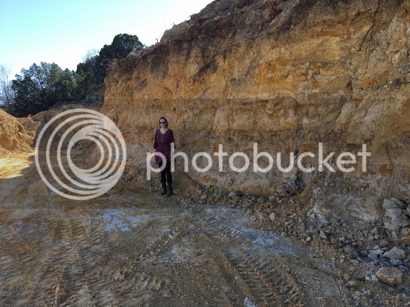

Meanwhile, the excavation for the main house has begun. Daughter for scale:
I think I mentioned before that this will be an earth-sheltered home, dug into the side of a big hill.

Sub'd. What kind of epoxy did you use on the floor?

Mark, I paid a custom floor company to do it, so I don't know the exact brand or type used. They ground the (new) concrete with a diamond grinder for adhesion, then put down three coats of epoxy: a primer coat, the color coat, then a UV-resistant clear top coat. You can tell at the end of the coating just beyond the shop doors that the whole thing is really thick. Lifetime warranty and cost me just under $3/sq. ft. I'm sure I could have saved money doing it myself, but I didn't want to screw something up on my learning curve.

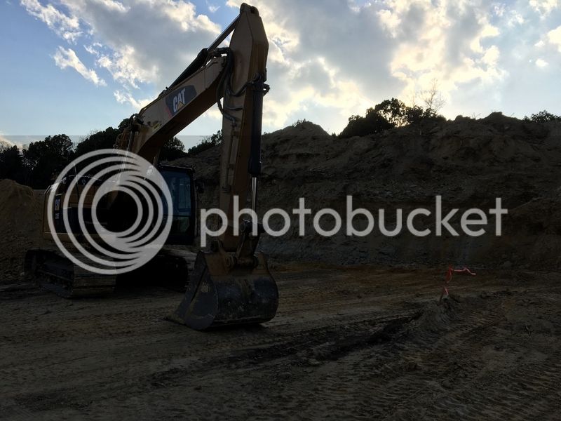

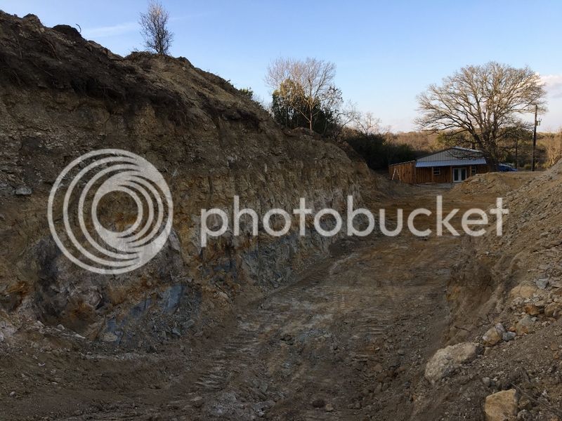

Meanwhile, the excavation is proceeding for the house. I'm disappointed how much clay is in the hill. There are a few beds of sandstone and a few limestone ledges, but most of that whole hill is clay. Hoping that there will be something else underneath the house, but not optimistic. I'm going to pay a geotechnical engineering firm to come drill two or three boreholes where the house is going to sit, and do a complete analysis of what is underneath for a long way.
How slick is the epoxy? That is always my concern with any of the epoxy. Previous owner put some in my current garage and when my feet are slick it becomes painful. But oil cleanup is very nice ;)
If you're in stocking feet, it's pretty slick! The floor guy said that if it gets wet it will be slick. But with any kind of rubber-soled shoes or boots, it is not slick at all.

If you don't mind sharing, what were you hoping to find instead of clay?
More sandstone, limestone, or shale; anything that doesn't swell with moisture and shrink when dry like some clays do. The geotechnical lab will tell me exactly what kinds of clay minerals are there, and how much they swell. It's possible to treat it to abate the swelling, before the concrete footers are poured, but I hope I won't have to. The clay in the hill behind the house also means that it won't drain very well or easily. When I backfill the house and bury it, I'll mix some other material (from elsewhere on my land) with more sand and gravel in it, in with the clay that came out of the hill, so that it will drain better around the house. And put a big french drain all the way around the buried sides of the house. You want to keep water away from the house as much as possible.
