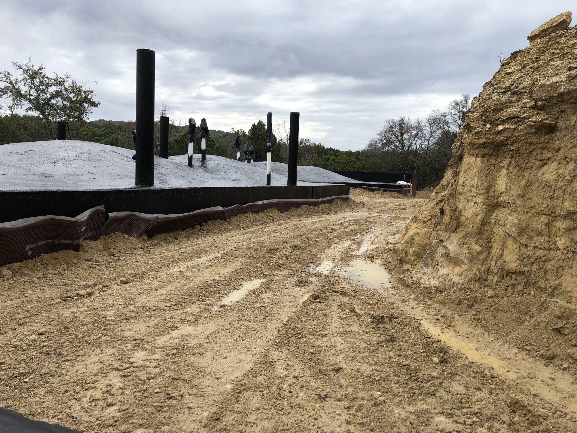

The more compacted, the better, according to the builder. At the very bottom, there was not a ton of room between the vertical excavated hill face and the house. We tried to leave at least 5', just for room to work back there. So the dirt contractor had a 95hp track-steer (the same one in the photo on the hill) back there, running back and forth dumping dirt and compacting it as much as possible. Every few feet of fill, he would water it pretty thoroughly with a sprinkler. At the end of each day when he was done, I would drive my 40 or my FJC back and forth over it to try and compact it some more. Now that the back fill is about 6' high back there, the space at the top is a little wider since the excavated face is not perfectly vertical, it slopes a little bit.
Today it is raining heavily, which should help settle it even more. The good news is, the french drain at the bottom of the back wall is working great - you can see a stream of water coming out the discharge end in the creek. Also a final(?) test of the waterproofing on top of the domes, before we start to move dirt on the top after the holidays.
I'm really glad it's him and not me running the track-steer; it would scare the piss out of me to run it right up to the edge like he does. The hill is taller than it looks in this photo

A view of the back: back filling is 6'+ up the walls. The only reason it is not all the way to the top of the wall is, we want to drape the sheet plastic that will go over the whole top, over the back side before it is filled to the top.

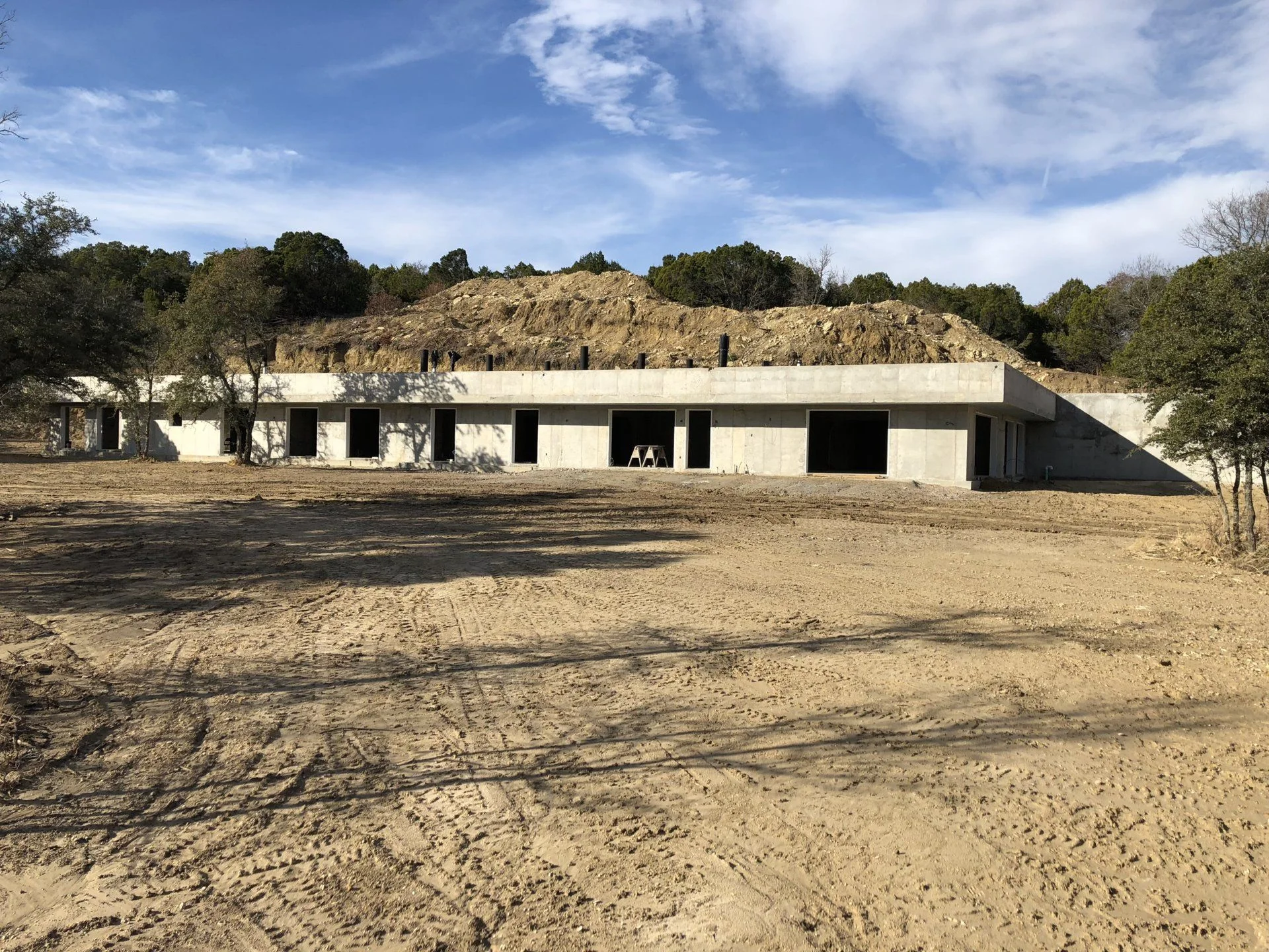

Now that several dirt piles have been moved from the front and sides of the house to the back filling, it is finally almost possible to get a photo of the entire house in one shot, from the front. Because of trees and remaining dirt piles, I still can't quite get the whole house and the retaining walls on each end, but this is close:
Some of what you can see above the house in the photo is the actual hillside, but probably half of what you can see is excavated dirt that will be moved down to help cover the top of the house.
