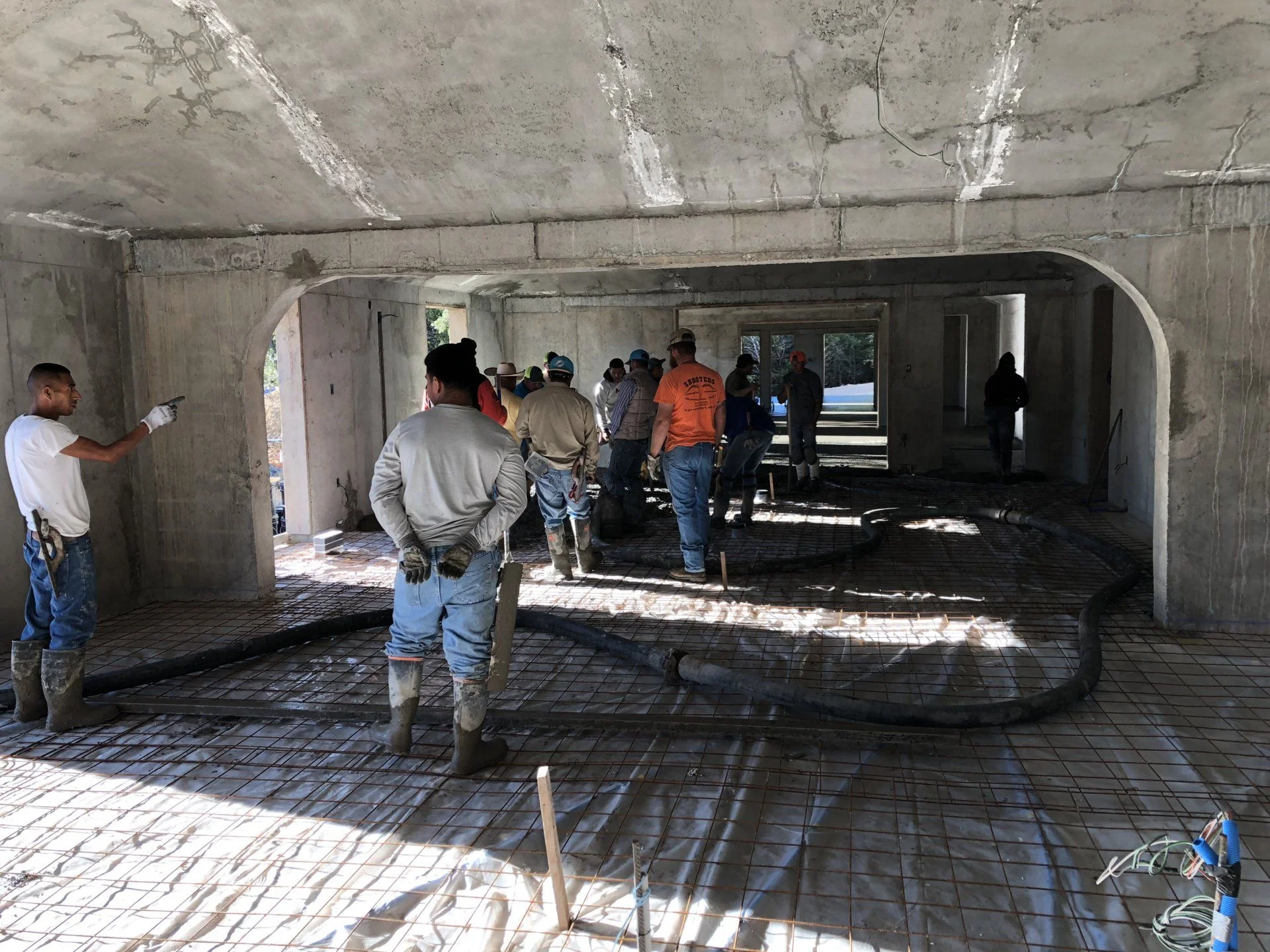

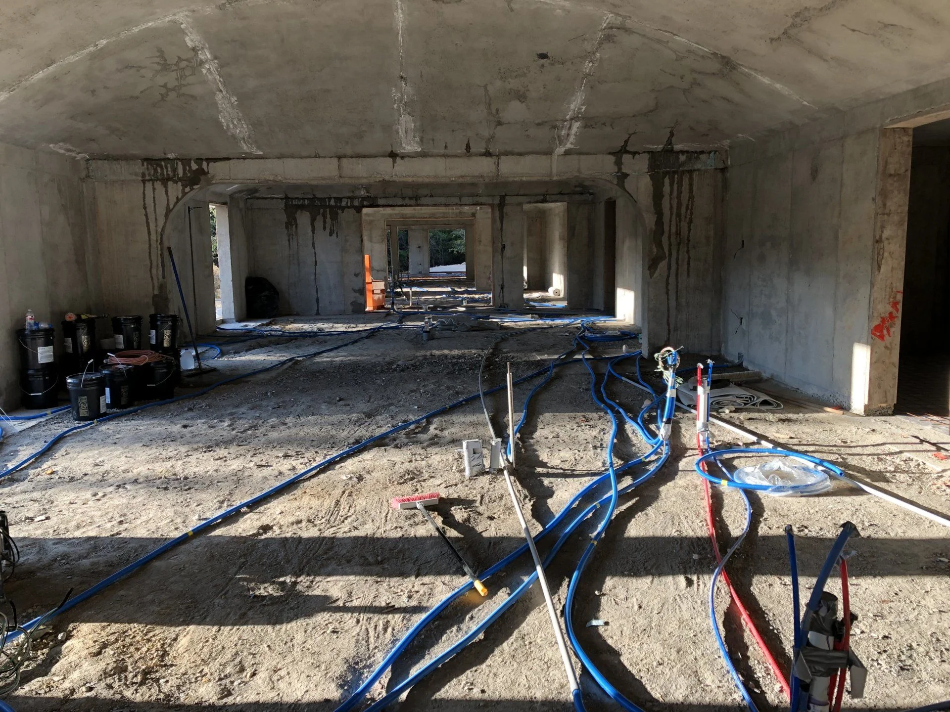

The builders took a couple of weeks off after finishing the exterior shell, but have been back now for a week and are busy laying electrical conduit and wire in the floors before pouring, as well as bringing up all the plumbing, drain, and vent risers:
Floors will be poured next week.

But we did get the floors poured today, and the waterproofing of the exterior moves apace.

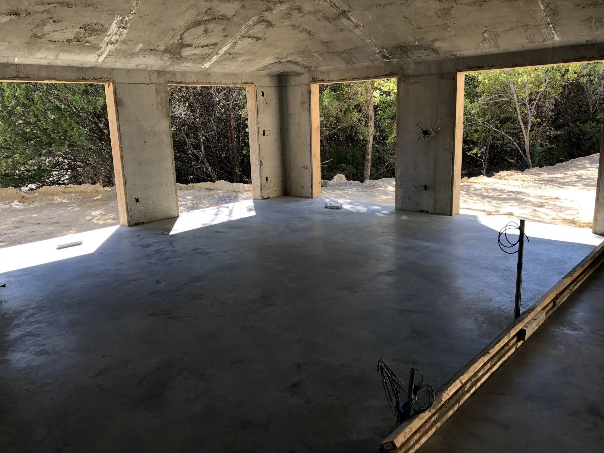

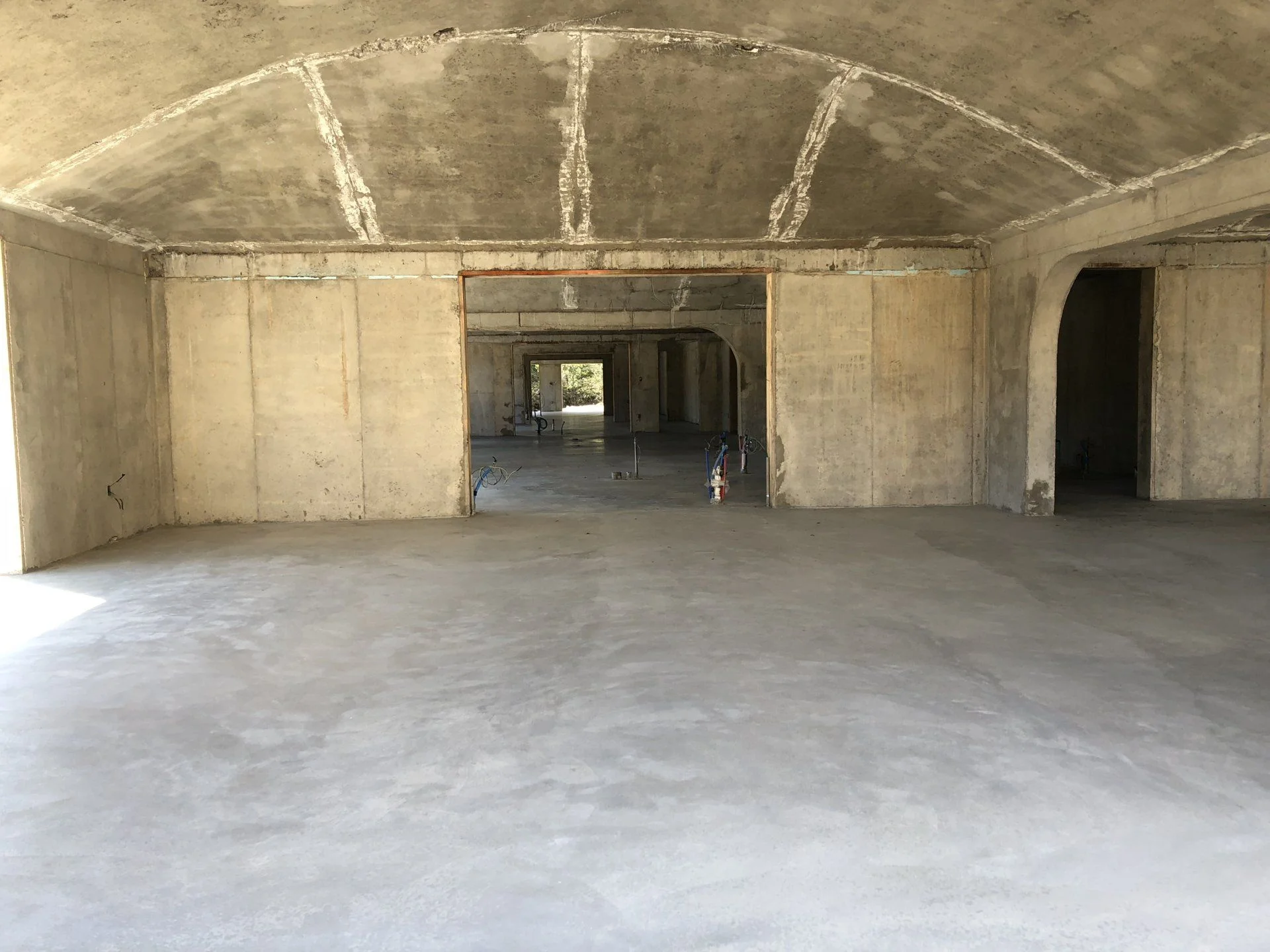

Latest photos, floors all poured in one day last week. 5,000 sq. ft., including the garages. The floor floats on the footers, it is not structurally attached or pinned to the footers or walls. There are drains under/between the footers, if by chance any water gets under the footers and floors somehow. And a vapor barrier between the crushed rock fill between the footers (under the floor) and the floor.

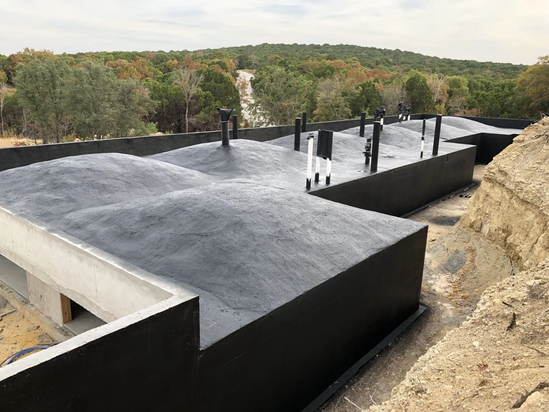

Waterproofing of the exterior is completed; still needs to cure for a day or two and be tested before burial. The builder guarantees that it won't leak. Rain is forecast for day after tomorrow, so that should be a good test.

Not much to report on; the first good waterproofing test (1" of rain) showed a few small leaks in some of the domes. Builder came back and treated those spots additionally, now waiting on another good rain to test again. The builder guarantees it won't leak.
Meanwhile, I have been cleaning up construction trash from around the site and the dirt piles, getting ready to start moving dirt from the piles to the back of the house. The leaks are in the domes, none in the back walls, so we could start backfilling the rear of the house (the working space between the hill and the house) up to the top of the walls, and probably will start that next week.

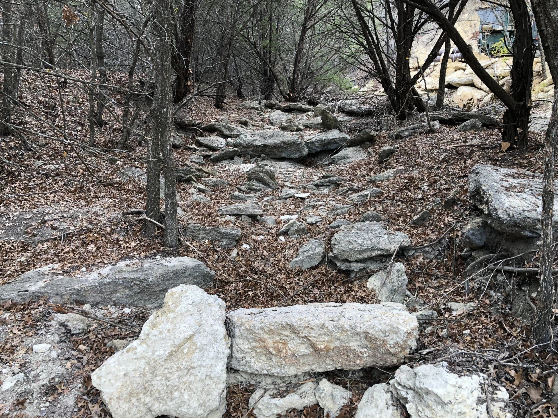

I've also been trimming and cutting trees in the creek next to the south end/master bedroom, to make it a prettier view. It's a lot of work; the junipers/red cedars are pretty overgrown everywhere, and you can't get even a small tractor down in there, so all the limbs and trees have to be hauled out of the creek by hand. I'll take a photo of it next time I'm out there.
rope and chain, and use tractor to pull up the hill?
The problem is, the creek bed is rocky and uneven. I'm afraid pulling the limbs that way, they would catch on every rock. Plus, the road is built up above the creek bed with culverts underneath, so there is only the width of the road to pull with the tractor in that direction. Here is a photo of the creek bed (after I have cleared this part by hand), if that gives you a better idea of how it is. There is no water running in it right now (until the next rain).

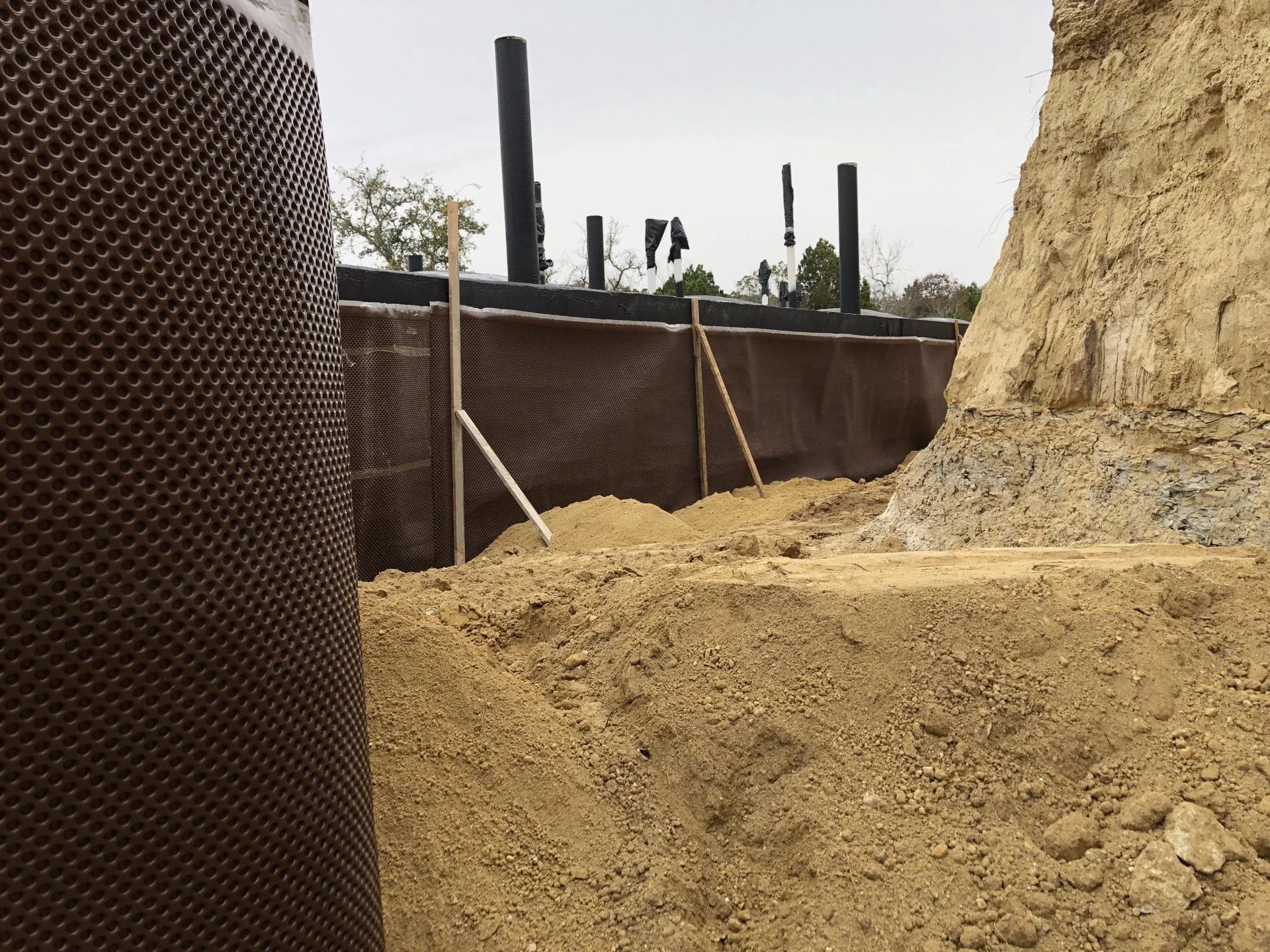

A photo from today; the drain mat is in place along the back walls. This is neat stuff, it conducts water inside, and protects the back wall waterproofing from rocks and etc, and still works even when compressed by the back fill dirt. The idea is that any water that does get to the back wall will be channeled down to the french drain at the bottom of the wall.

That type of drain mat is the only thing that I have used that actually works as claimed. Good stuff.
I appreciate the endorsement; this stuff was recommended to me by the dome contractor, but it was expensive so I am glad to hear that it really works!
