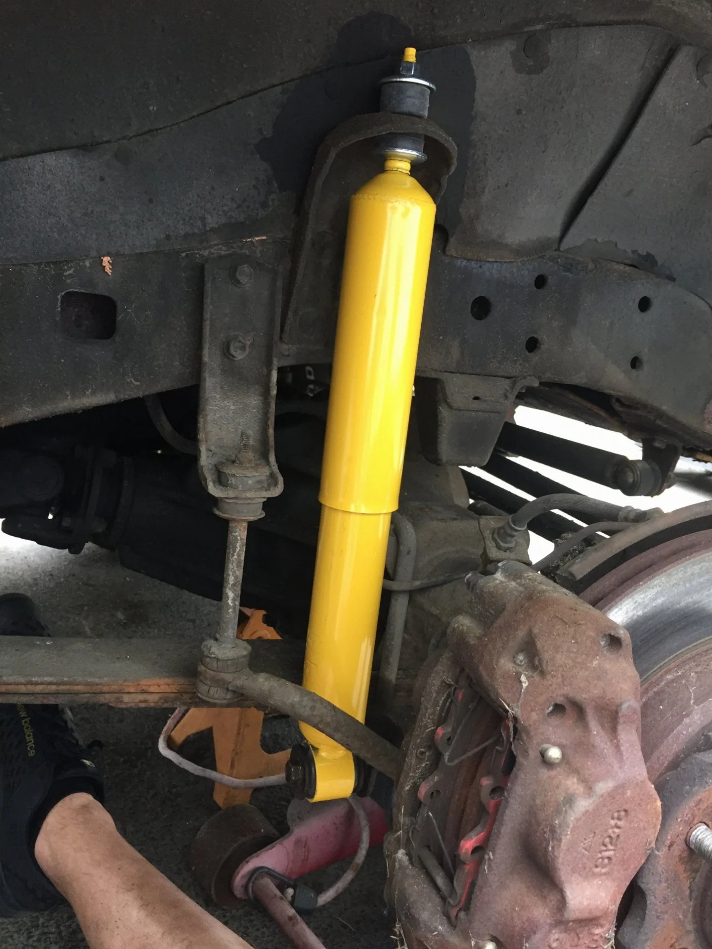

The progress continues on turning the Dirty Bird into a reliable DD. Installed new stock replacement front shocks and new front side marker lights as the old ones were destroyed. Definitely rides much smoother with the new front shocks. I couldn't managed to loosen the top nuts on the old shocks so I just took a cut off wheel to them and skipped the headache. Still need to find time to get the rear ones installed. That will have to waiting until next month since I'm leaving for 2 week motorcycle road trip this weekend.

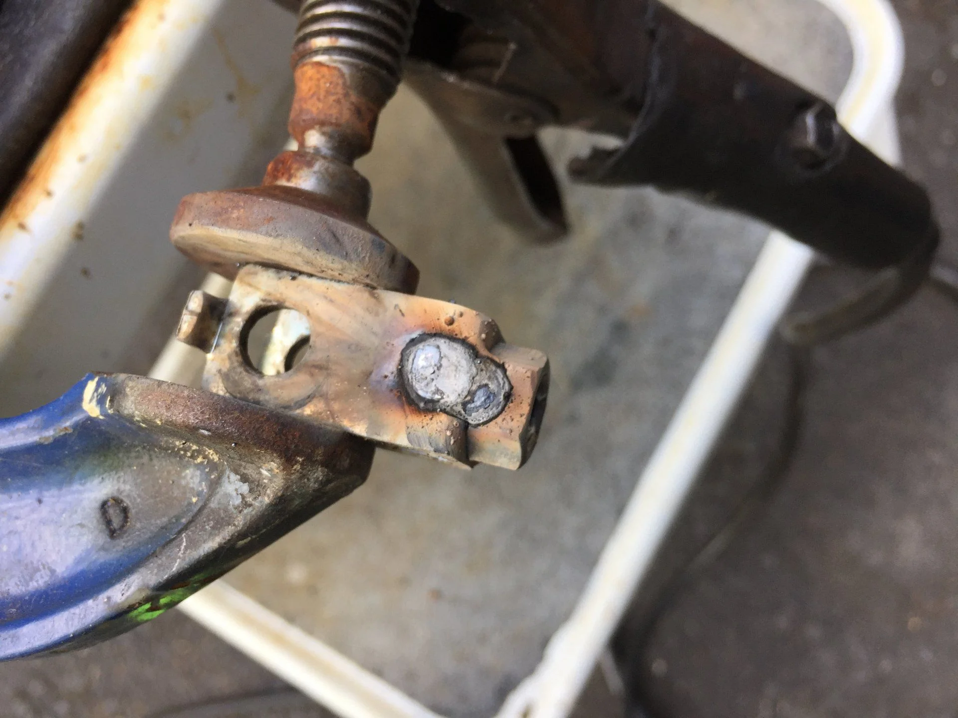

A new noise coming from the clutch pedal started last week, like a kind of grinding with a small bang. Turns out the clutch pedal linkage has broken and there wasn't quite enough room for it to completely fall apart so when I'd step on the pedal it would all jam back together as it slid over the threaded post. A quick touch with the welder and I was able to weld the nut back on and the clutch pedal is good to go again.

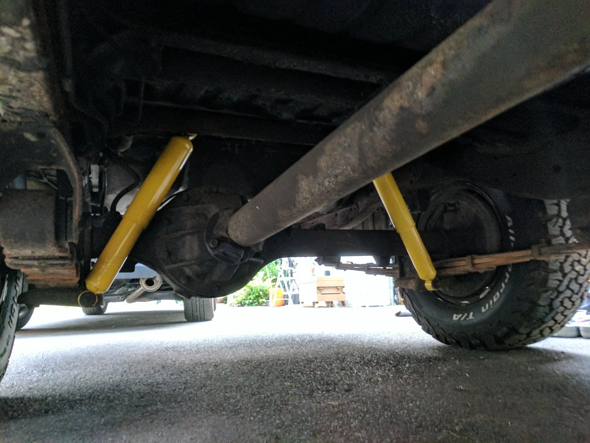

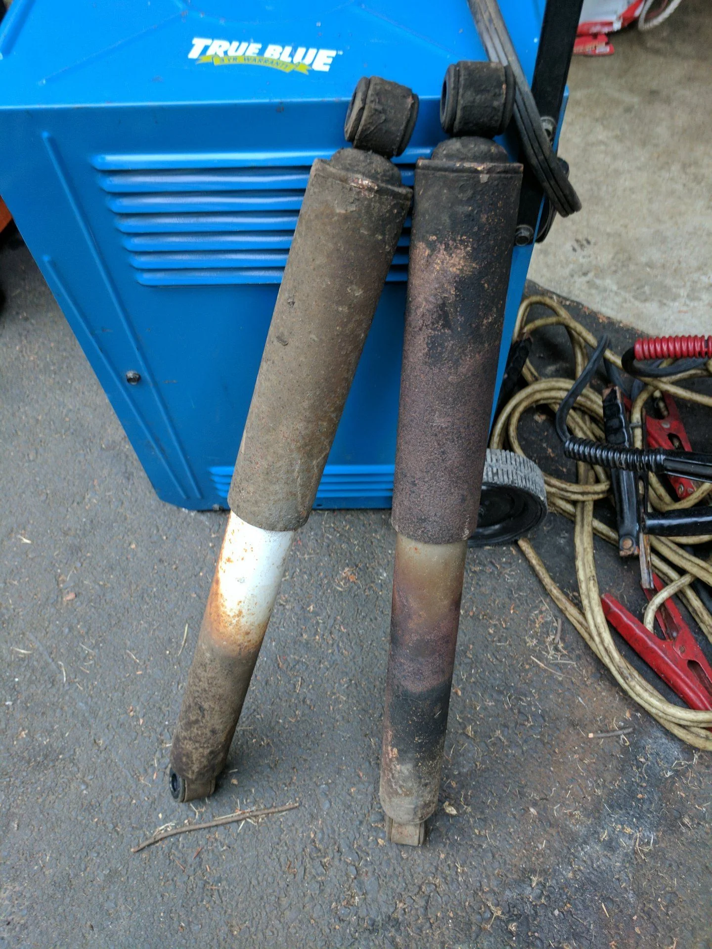

Finally got around to installing my new rear Monroe shocks, had installed the fronts a month or two ago. Also swapped out the stereo for a new bluetooth unit. Pioneer MVH-390BT Now I can avoid the "no touchy cell phone" law in WA.

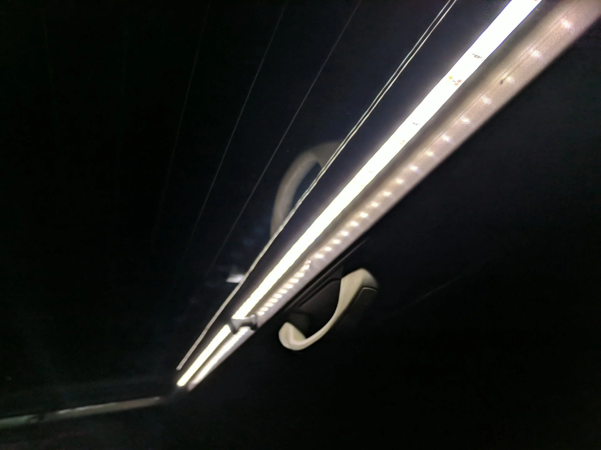

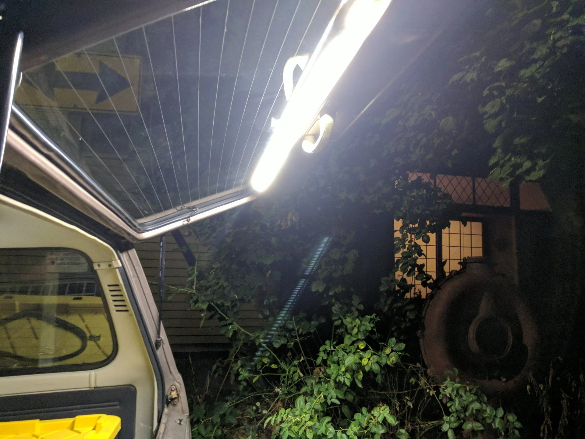

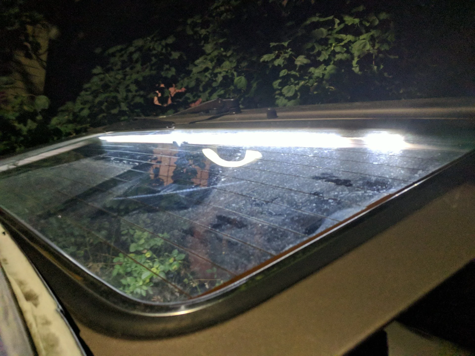

After a little camping a couple weeks ago I decided I wanted to add some additional lighting to the rear gate area. Already had a bright LED in the cargo area but I doesn't make it's way onto the gate much at all. So I had the idea to add some LED strip along the middle of the gate to light it up. Decided to mess around with it last night and ended up adding about 3' of flexible weatherproof LED strip lighting to the bottom rubber of the rear window. Wired it through the hole for the rear glass element and under the head liner to the back of the rear cargo light. For the time being I wired it to the gate activated ground so it always comes on when you open the gate. I play to rewire it so it works with a separate switch than the dome light.
As of now it's bright as hell, and could probably have gone with a little less than 3' of lights. But now there is no way I won't be able to see what's going on back there. Will post another photo of the wiring if anyone is curioius
Enough typing here are some pics.
Wow. Looks like a theater marquee. :)
Yes, post some pix of the wiring when you get a chance. I'm gonna do this and agree, an On/Off switch would be welcome.
How did you attach the LED strip?
Thanks for posting.

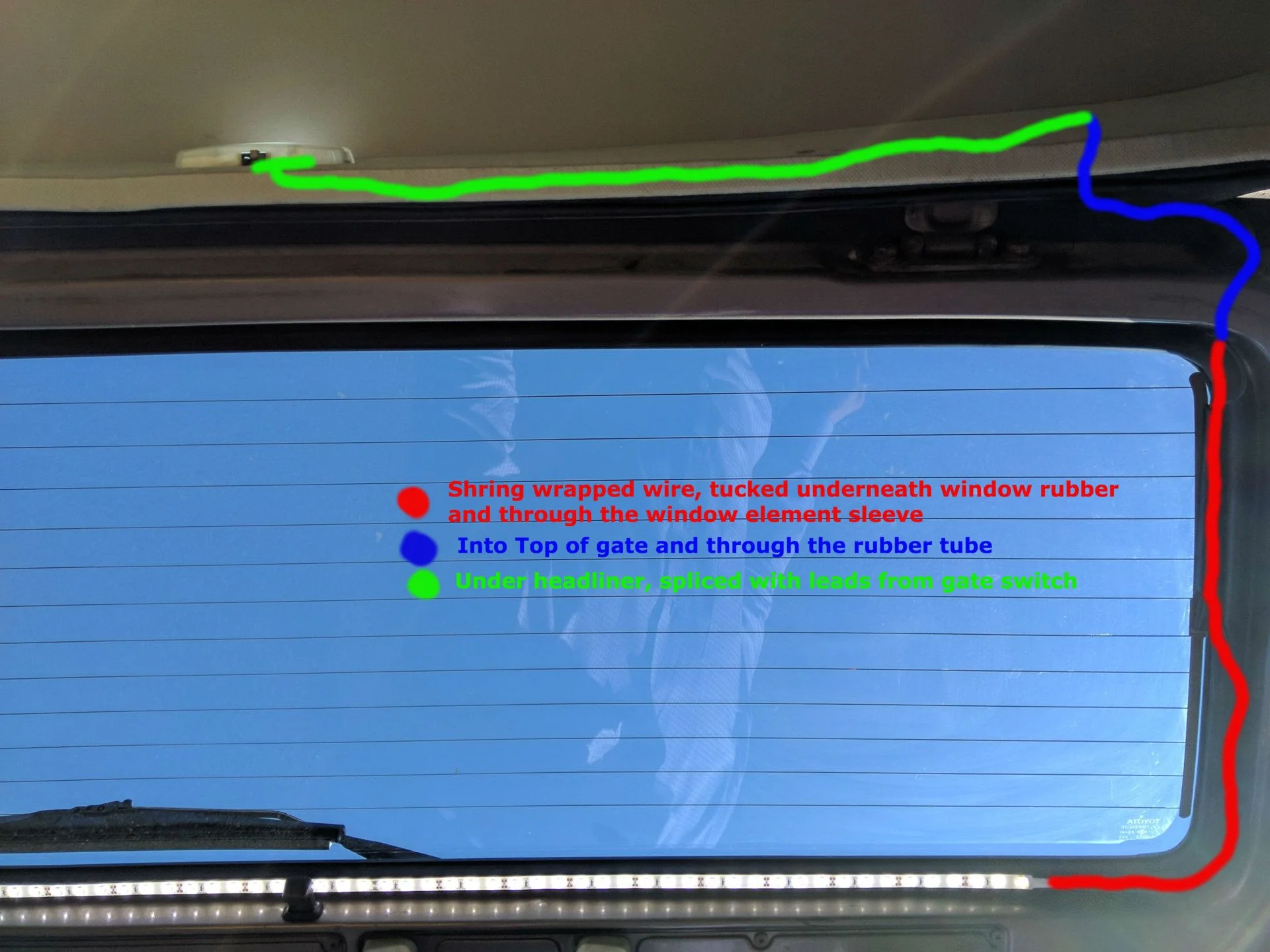

I'll take a pic today in the sunlight so it's easier to see. The flexible LED strip has a peel'n backing to it. Holds well enough, but could see it getting pulled off the rubber of something catches it enough

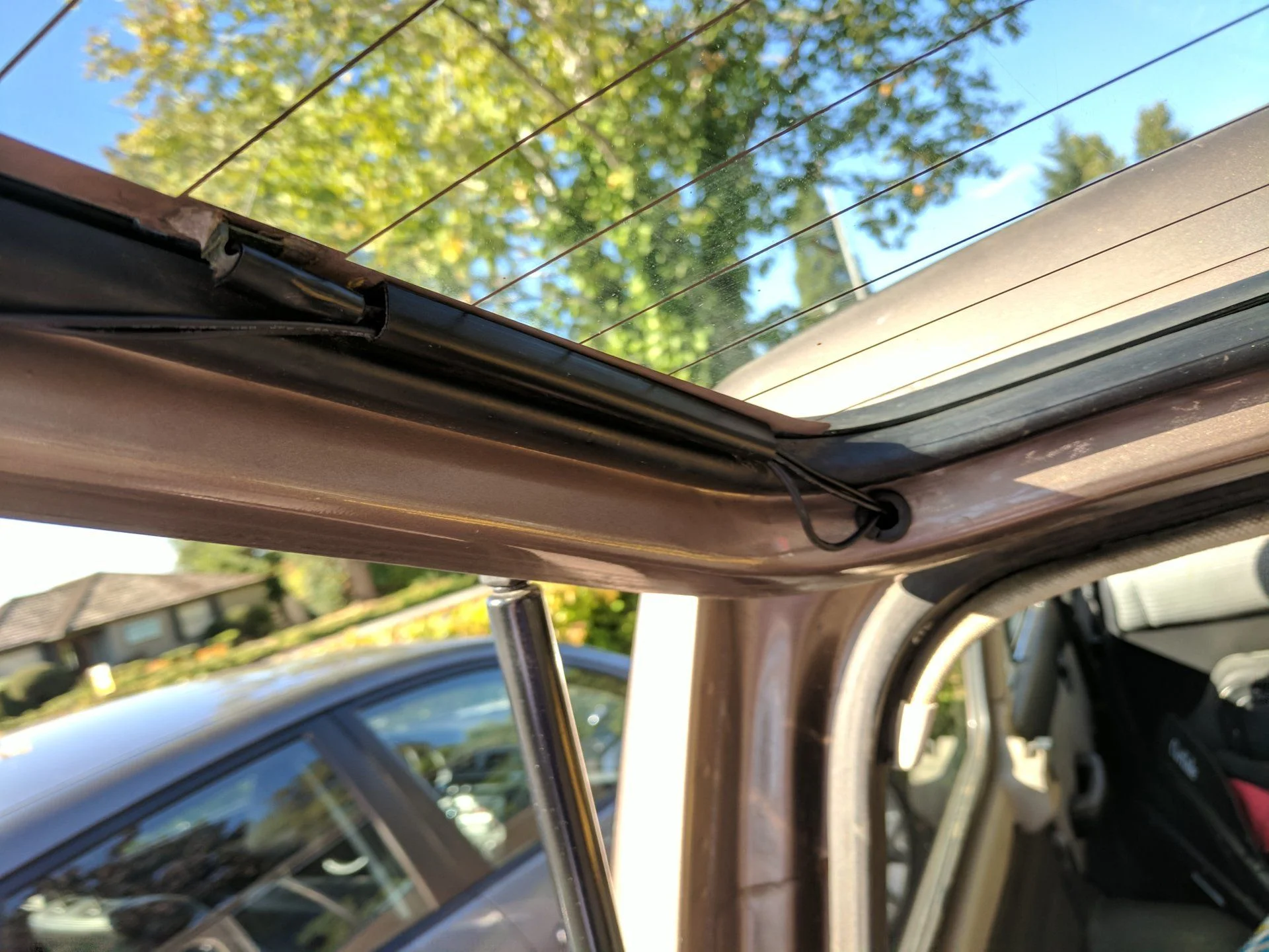

Like usual, I didn't take photos while I was doing it. Here are a couple photos that show how I routed the wires along with the connectors I used to splice it in. Pulling the rubber grommet out and using a solid copper wire to pull everything through was an absolute must. That and carefully pulling back the headliner from the corner.
The routing of the two wires. I used black wires for both the - and + so they would be less noticeable.

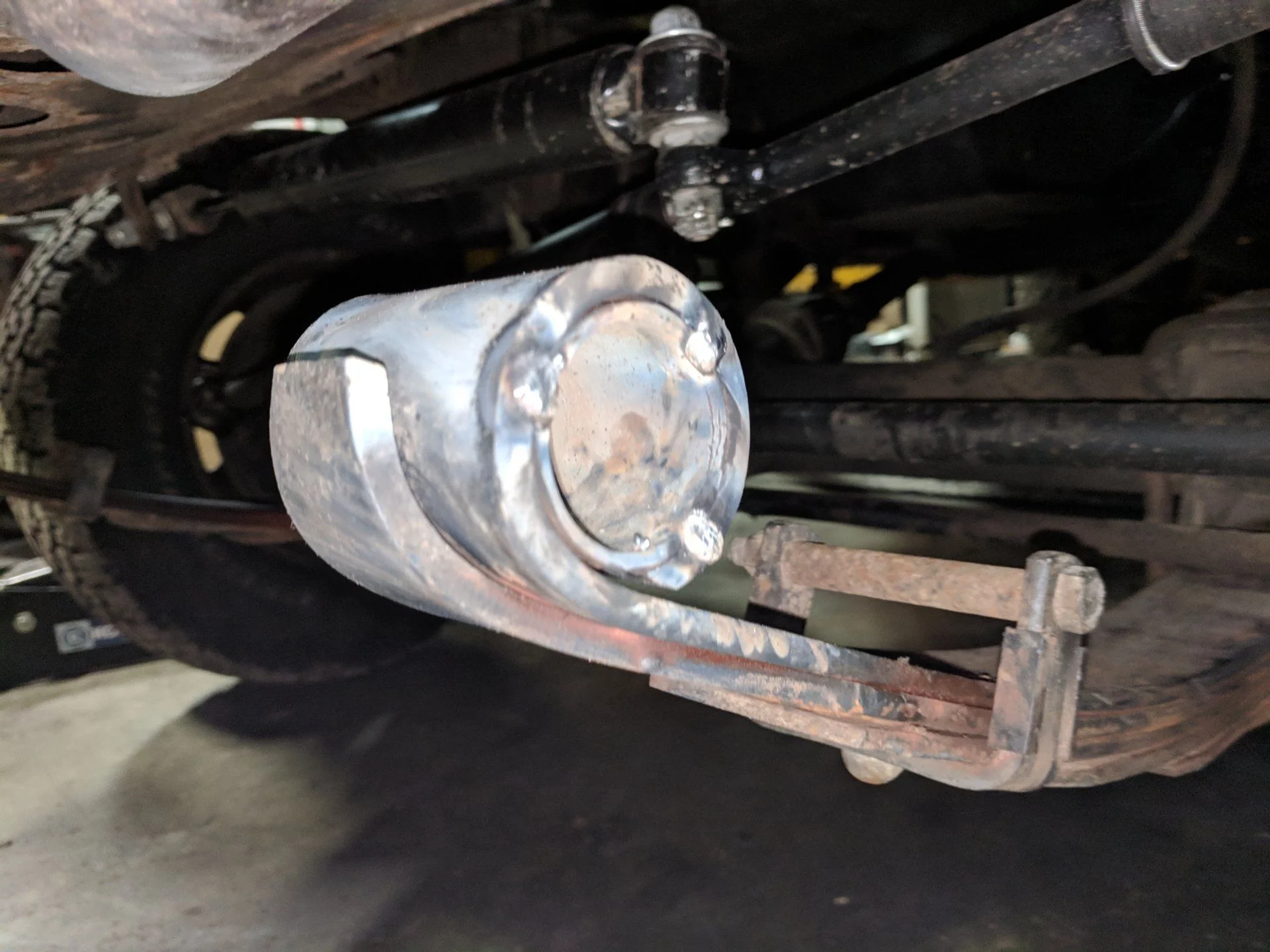

Finally picked up a new steering damper and adjusted my alignment. Motivation was driving on a grooved highway in a heavy wind, aka scary s***. There was 0" of toe in, so set that at about 1/8" after using a torch to try and loosen the rod ends.
Got a replacement steering damper and really needed to massage the original with a torch and a 5lb hammer to remove it.
Oh my word what a difference with the toe in and a working steering damper. Definitely in the top 3 of 'improvement of driving experience upgrades' that I've done so far.

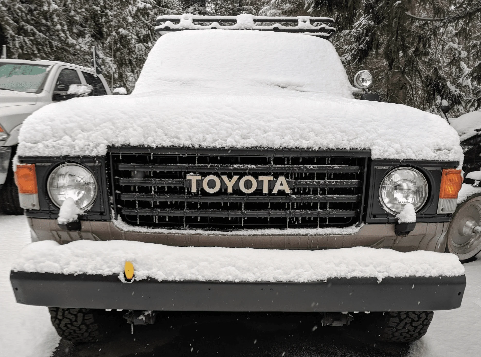

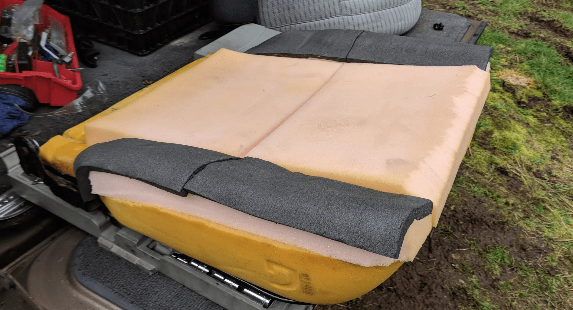

(Seats) The foam in the drivers seat was far from plush or supportive so i pulled the drivers seat. Used a big knife and a razor to cut away a decent amount of the stock foam then added some high density upholstery foam I had around from an old project. Haven't gotten around to installing it yet and I've been working on sealing a leak along the firewall that has been soaking my drivers footwell. Carpet should be dry next weekend so will be all ready to get the re-foamed seat a test ride. Sitting on it outside of the vehicle it feels like a massive upgrade.

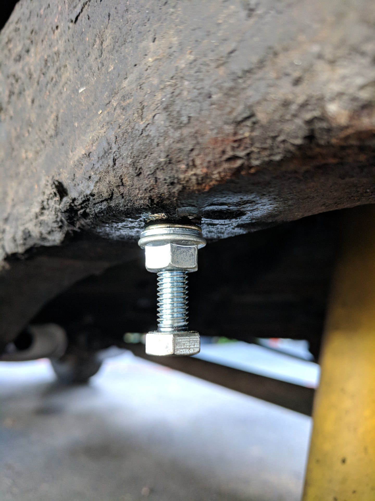

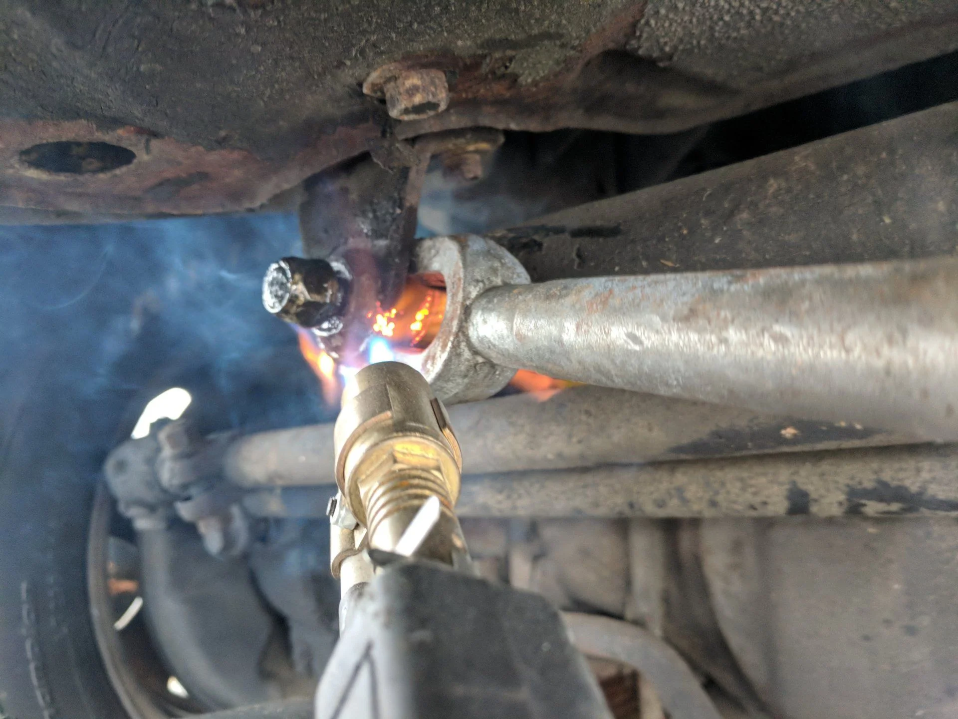

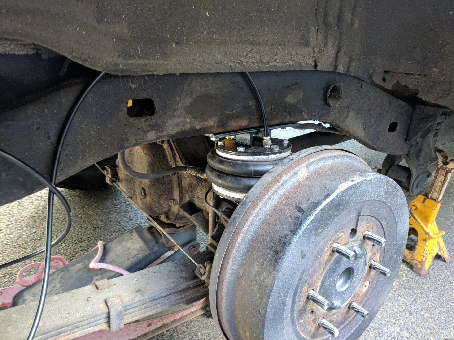

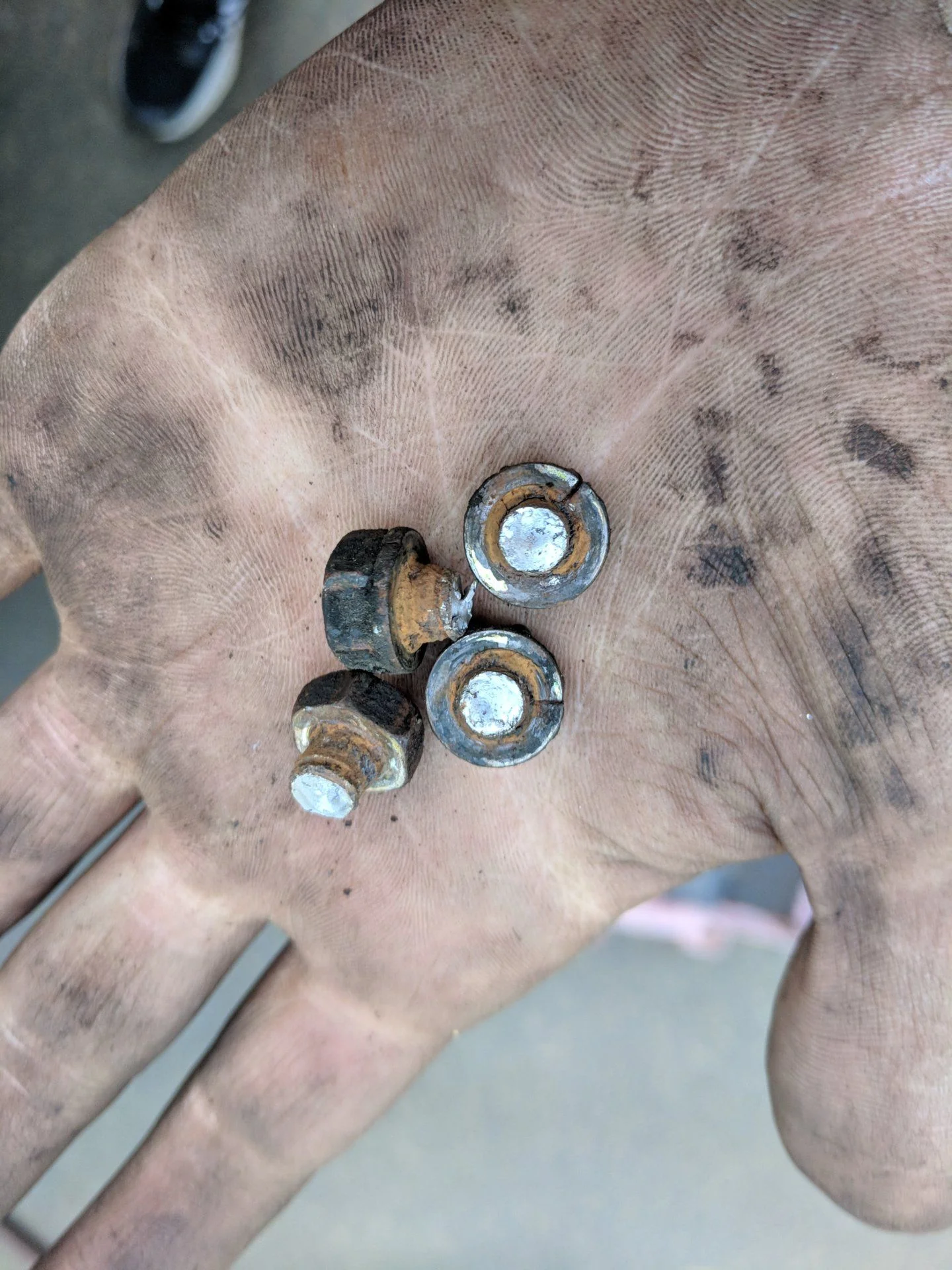

1) Finally got some sunny and warm weather here in the Pac NW so took advantage of that to install the BOSS airbag kit from @SLOCRUISER. Didn't get much seat time after the install but plan to test them out soon on some forest roads soon. The airbags bolt in where the bump stops are and get held to the axle under the U-bolts. As per tradition, all of my bump stop bolts broke off with about 1/4 to 1/2 turn. Thank Cthulhu that I had some nutzerts in my tool box that I have been waiting to use. So had to drill new holes and buy new bolts. Things went smoothly after that until I overheated the drill bit on the last hole and had to sharpen my new drill bit with an angle grinder... whoops! Couldn't have completed the install without a 90* drill attachment, nutzerts, a fresh drill bit and a breaker bar for the Ubolts.
Also forgot to take an after picture... Even without air in the bags, the top of the wheel well seems to sit about an 1" higher. Plan to always run some pressure though as the bags are mainly to help the old tired suspension.

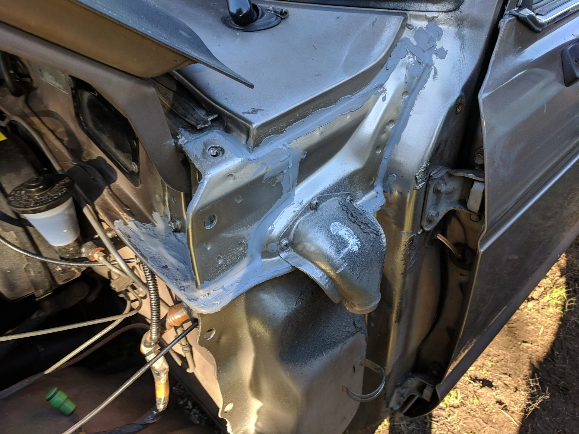

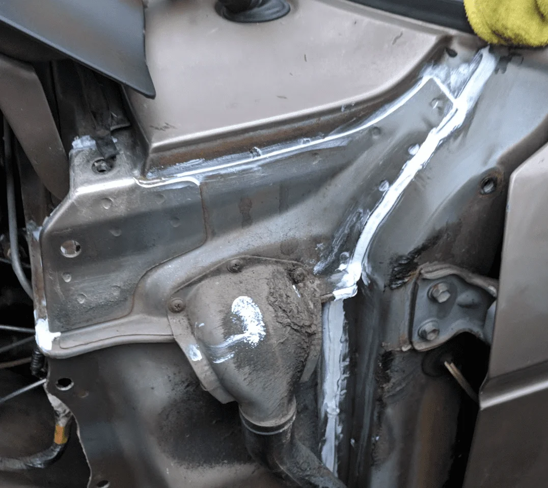

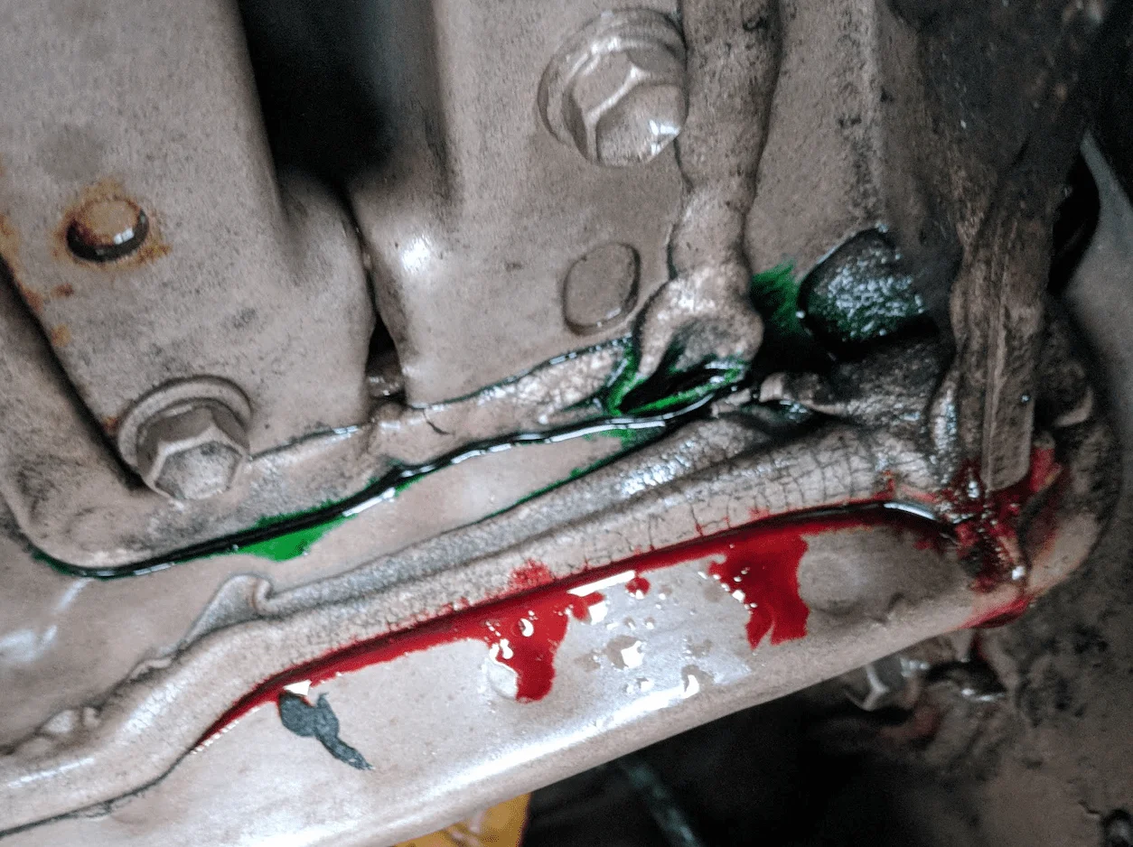

3) I had preciously sealed my fender and the lip inside the engine bay to stop the constantly wet floor in the drivers well. Turns out the sealant I used reacted with water or something else and never cured solid. After a week I found water on the floor again. I started prodding the sealant and found that it was soft and came apart like room temperature mild cheddar cheese. Very specific I know, but accurate. After 20 minutes with a wire wheel it was entirely out and I re-did the sealant with a tube of SEM sealant. It cured quickly and with waaay better results than the tube I found laying around. Another lesson of using the correct product the first time. Luckily nothing major was lost or damaged.

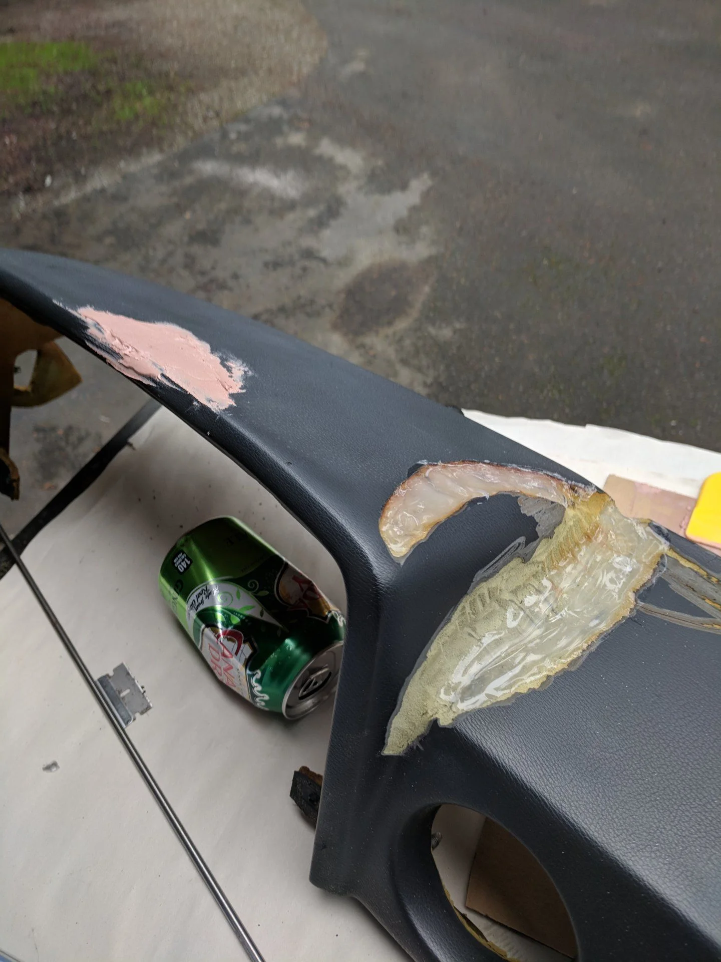

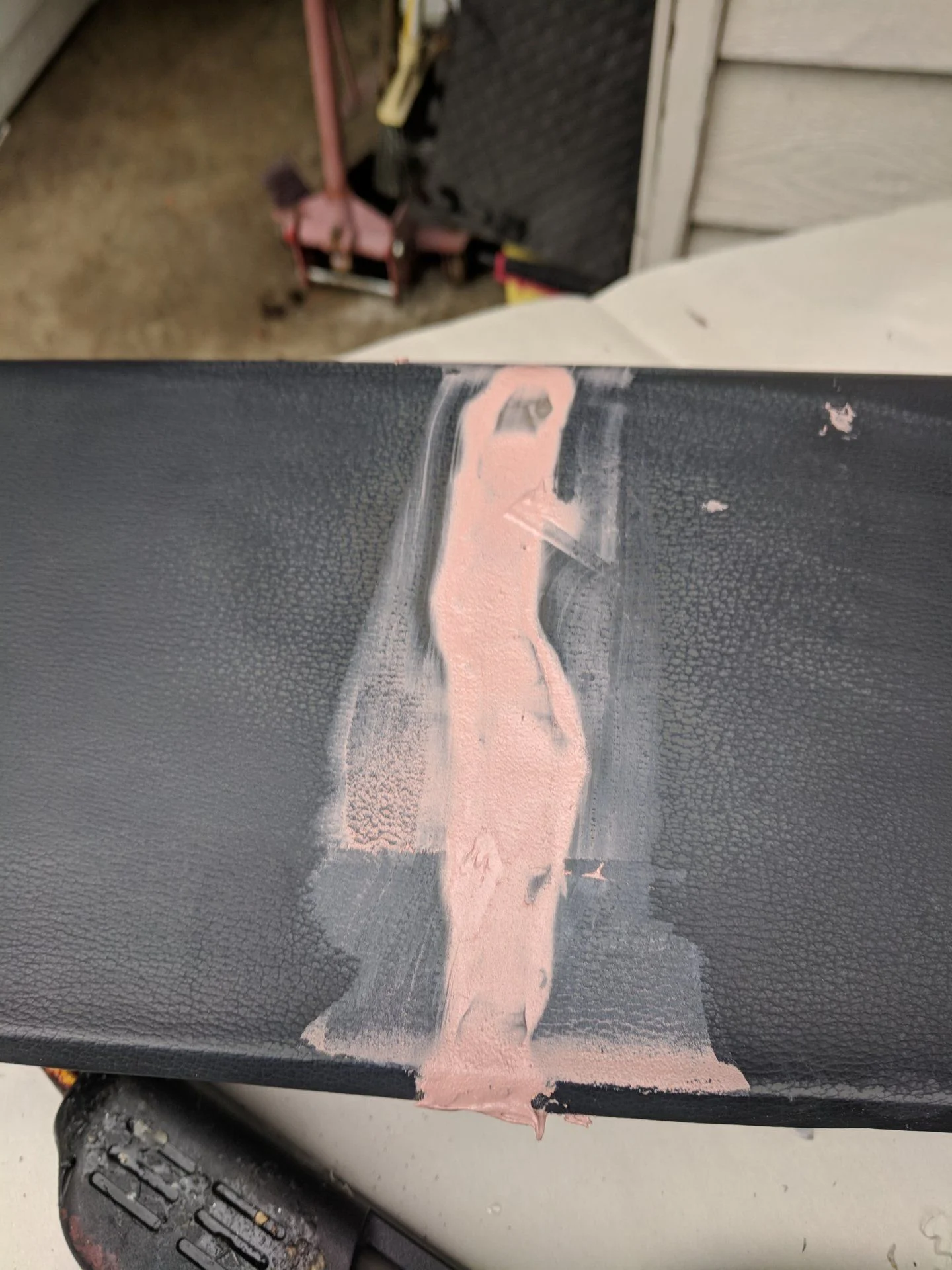

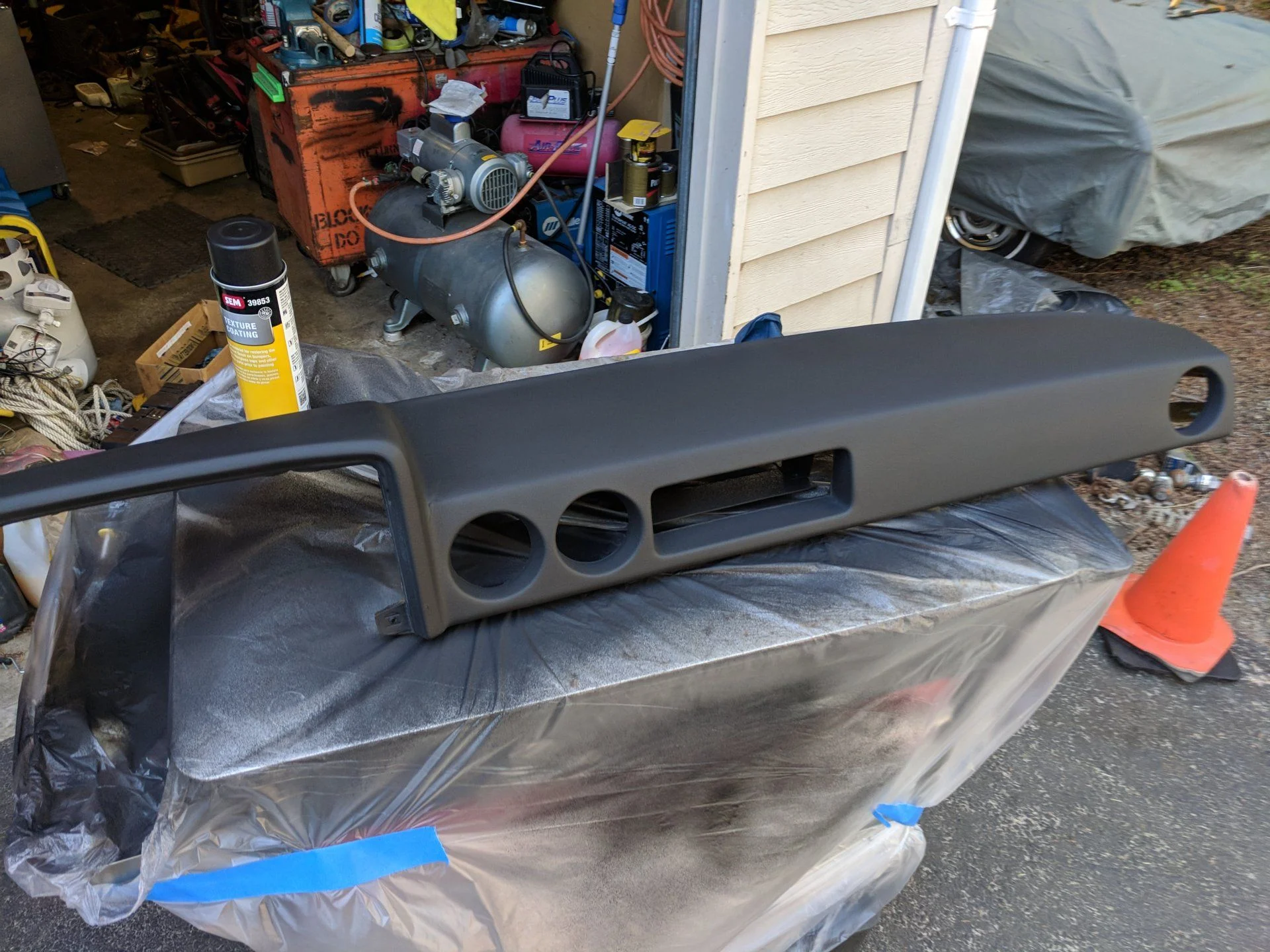

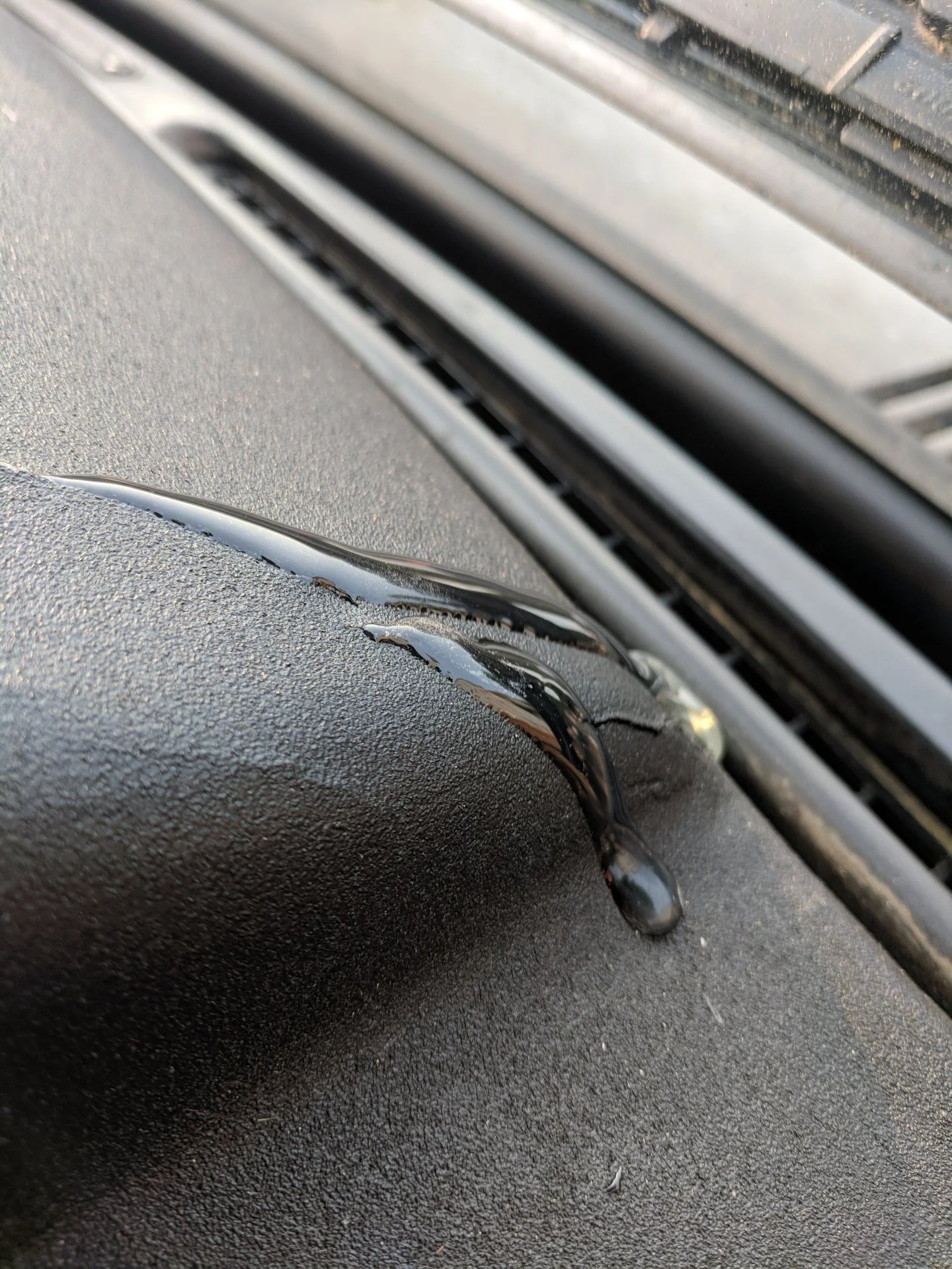

4) So now for the totally boogered... I started working on fixing my severally cracked dash. Used a dremel and various tools to carve out the cracked and get things flat or low. Filled the holes with hot glue and then bondo.
After getting everything smooth I coated it with some SEM texture spray which left it a very nice matte black. And here is where it started to go down hill. After reading the back of the can I realized it needed to be top-coated so i grabbed a can of gray spray paint and gave it a even coat. Then after a week or so of sitting in the car (not even installed) I came back to find the dash had cracked again. Some entirely new cracks, and some that were along some of the fixes.
My guess is that I used regular spray paint when I should have used the Classic Coat flexible spray that is specifically designed for this application. But it totally skipped my mind at the time and I was eager to get the dash finished.
I pondered for a while on what to do. Sand it, and retry or maybe wrap in vinyl? Unfortunately instead of giving it another go I decided to wrap my dash in vinyl... After a significant amount of spray adhesive and contact cement I was able to get the black vinyl stretched around the whole dash with minimal folds or creases. I came up with a cleaver idea for the vents that I could use a slight cone shape to help form the vinyl and glue it in place. I ended up using a hair dryer and some glasses from the kitchen that fit perfectly and seemed like they would leave a good end result. Unfortunately that did not happen and they did not stay.
the marine vinyl wrap actually looked really nice and felt great. But there is no way I could live with the vent holes looking the way they did. I tried installing the vents but it looked bad. If anyone has any master tips on getting the vents looking proper I may retry as I have just enough vinyl for 1 more attempt. If not I may try stripping everything off and going to texture route again. Or... I have been wanting to try flocking on the dash.

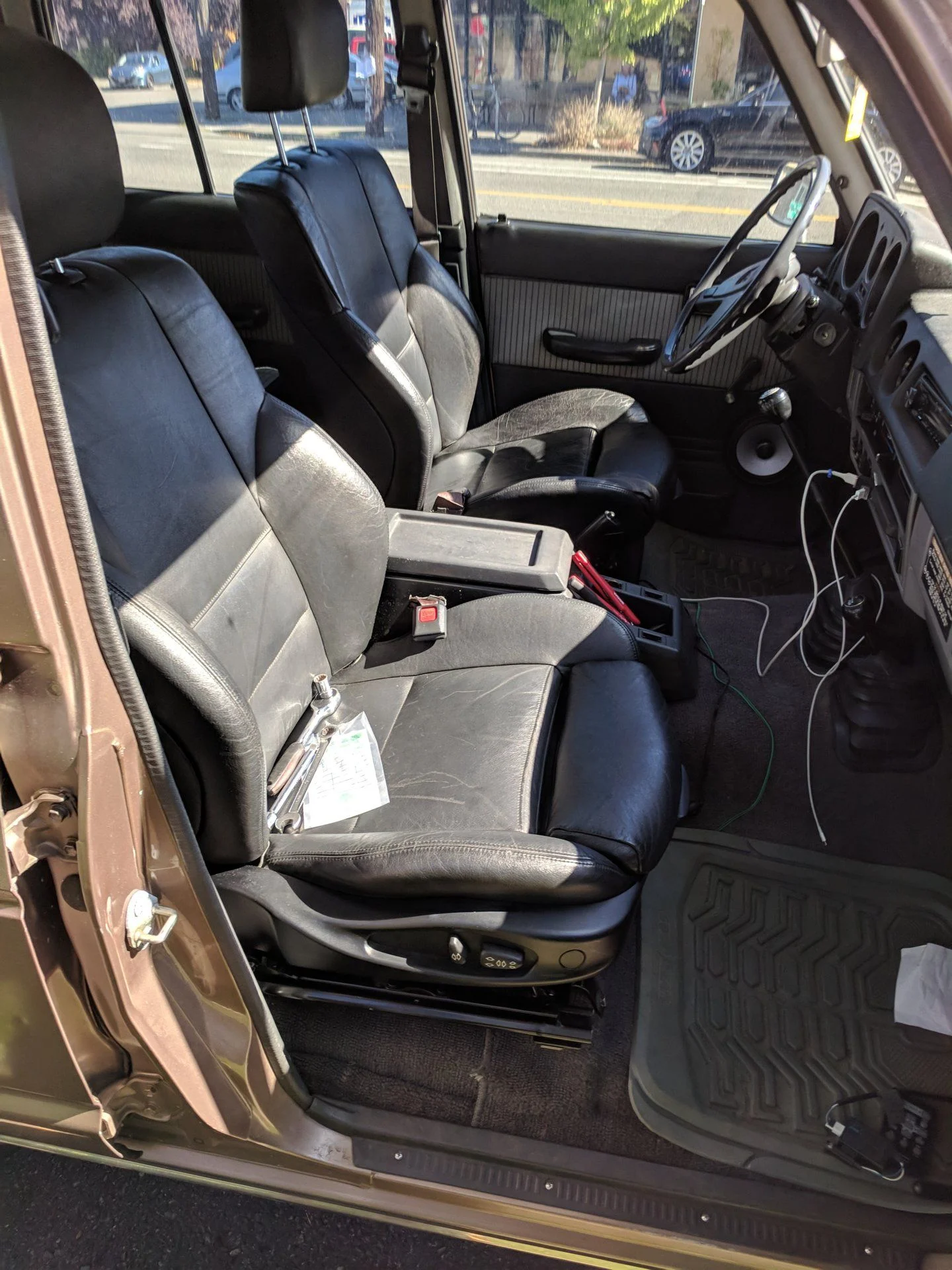

Was gifted a set of '01 BMW electric seats which have made their way into the cruiser with a set of homemade brackets. I also temporarily/permanently wired them to a cigarette plug so I have to plug them in whenever I want to adjust either one. Which has been about 3 times in the last 4 months. Will eventually wire them up proper, but not today. I will also be picking up a set of BMW brackets because even though I measured about a dozen times my seats do not sit centered or straight to the steering wheel.

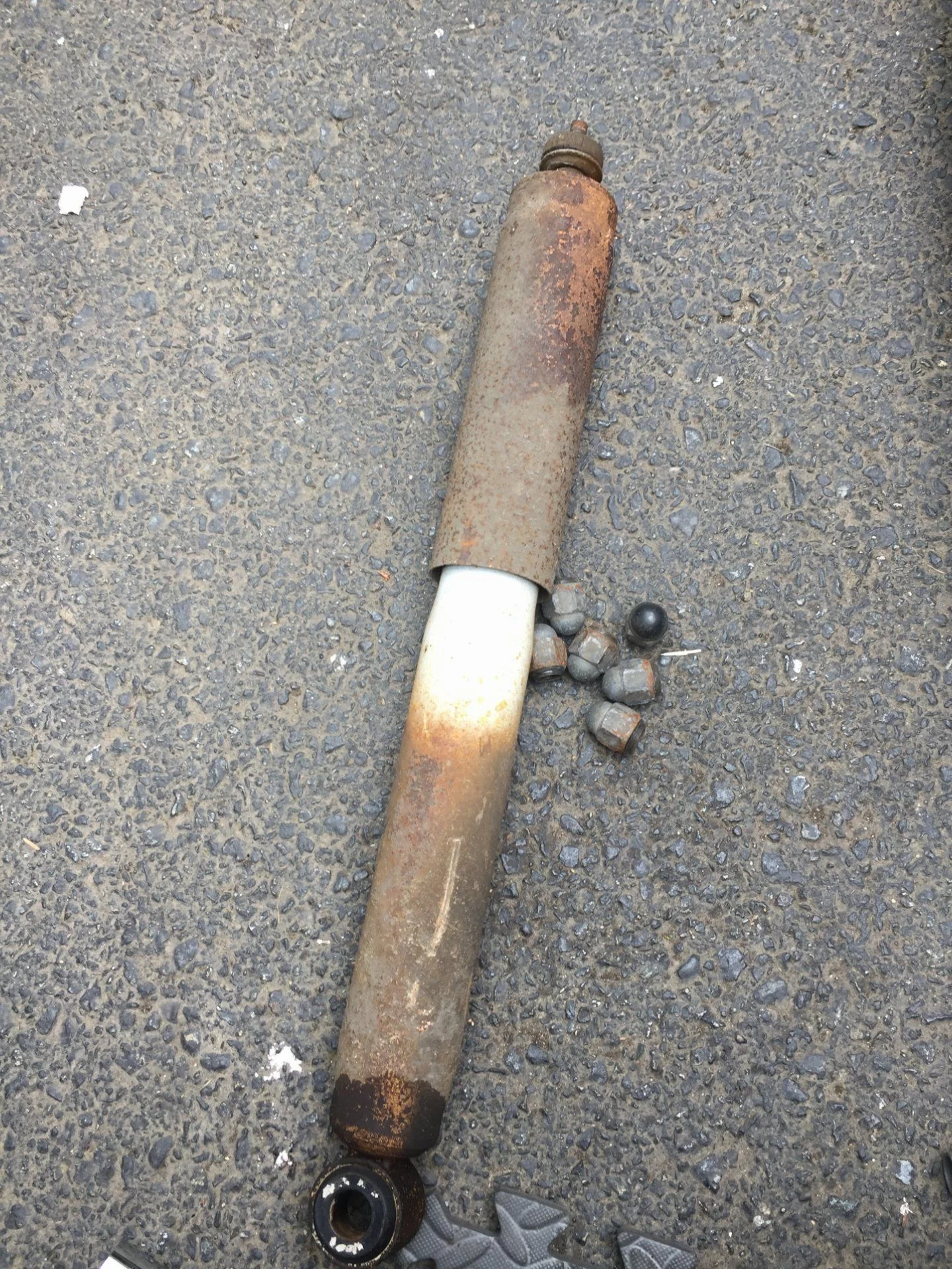

Picked up a used OME Medium 2" lift off of craigslist from a nice dude that had a fully built 60. Got that installed over the summer and didn't use the Boss airbags I have so I could try out just the OME kit. Oh man what a difference. No more jumping, bouncing, slamming... Discovered when taking off the 1 year old stock replacement shocks that 1 was already blown, O'reillys was nice enough to take it back on warranty too!

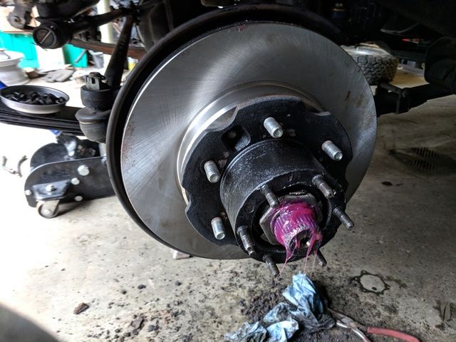

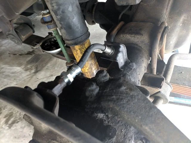

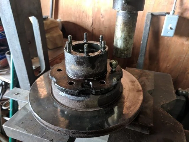

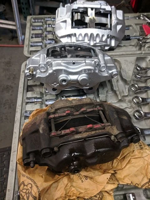

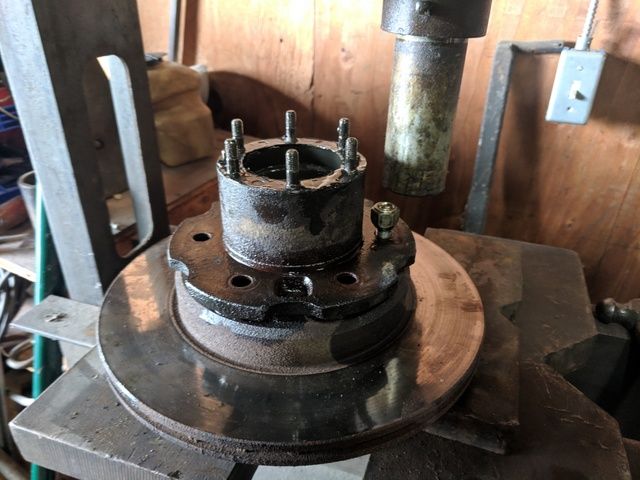

Another big fix/upgrade done on the dirty bird. Before I learned my brake master cylinder was toast I roasted my front brakes on a long downhill and warped the discs. More recently my cruiser has been pulling left, after a bleeding of the brakes it somehow got worse. Likely a dead piston in the passenger caliper so I picked up some new 1994 4Runner calipers, stock discs and new rubber lines. Got into last weekend and its really nice that my cruiser is no longer trying to pull me into oncoming traffic
New rubber lines, replacing the old cracked garbage
Hydraulic press makes quick work of getting the studs out,
New vs old calipers, big brake kit right!?
New disc installed, oh so nice
Forgot to take a take one with the wheel off, but can see the new calipers peeking through the wheel
Purchased all the parts from Oreilly's, I think it cost just under $200 including new rubber lines all around.
