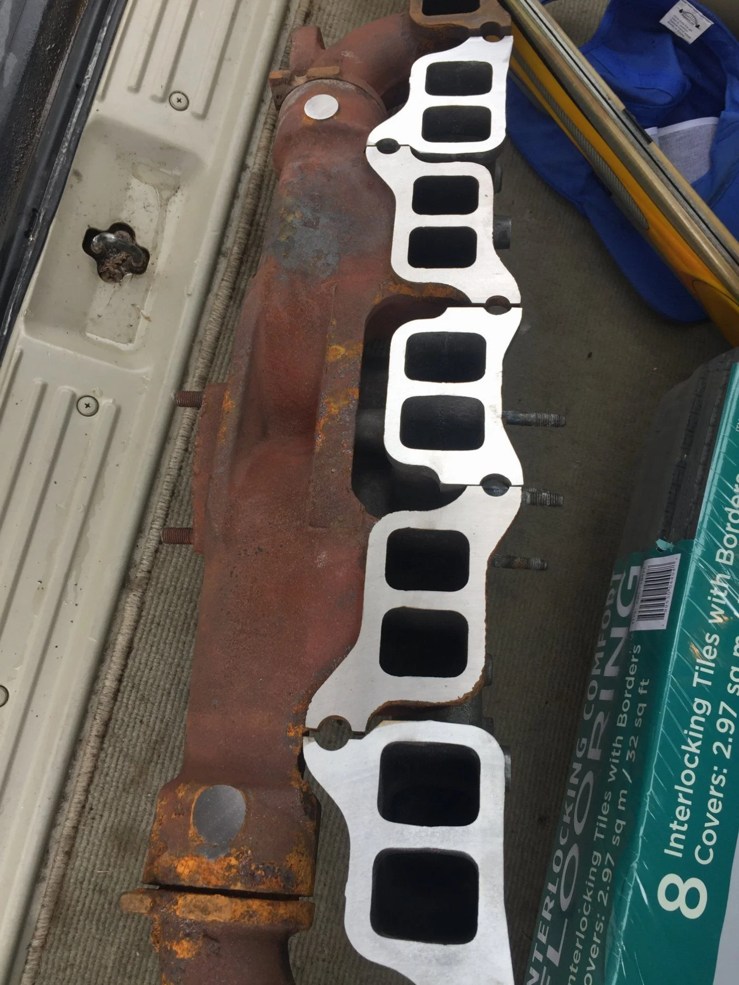

Figured since I pulled it off again I'd post a few pictures of the gasket and how the pressure is being applied to the manifolds and gasket. After taking a pair of calipers to the manifold flanges I found that the Exhaust flange was anywhere from .5 to 1.1mm thicker than the intake manifold depending on the bolt location. Sent the intake off to be machined flat again, after placing it on a real flat surface I realized it definitely has some warp to it.
1- this shows relatively even pressure on the manifolds around where they meet.
2- here the exhaust manifold is getting way more pressure than the intake
3- This was another spot where the intake side is leaking and the exhaust is taking all the pressure.

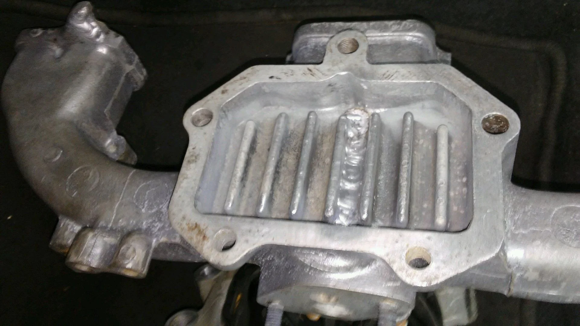

Had a buddy weld my crack along with the mounting points to add material. Just need to file down the mounting points now so they are similar in thickness to the exhaust manifold and flat.

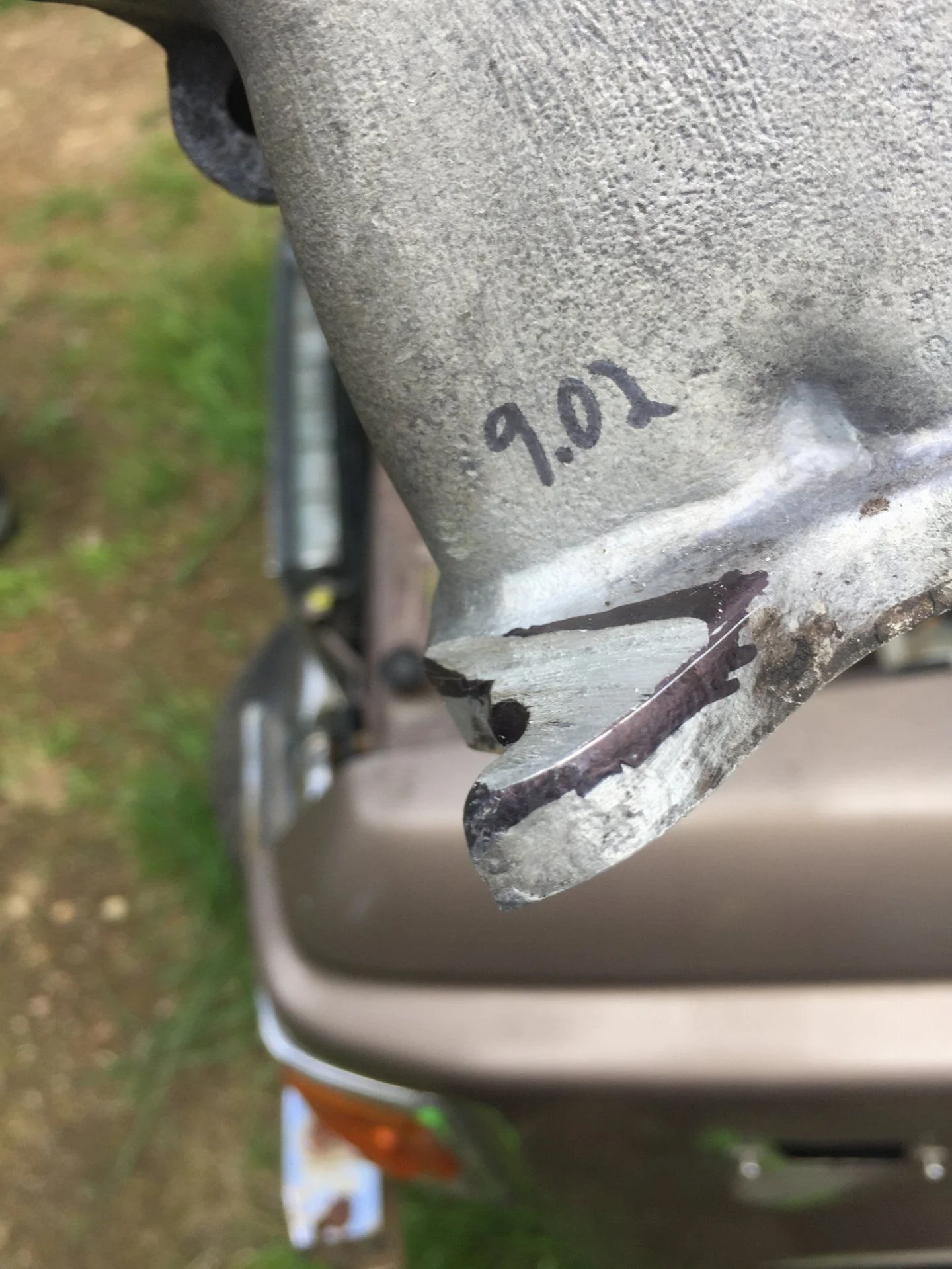

Progress is finally being made again! Got the manifolds machined and the intake manifold spot welded to add material to the mounting ears. Then spent about an hour filing them down to be slightly thicker than the exhaust manifold ears. Hence the numbers near the ears.
