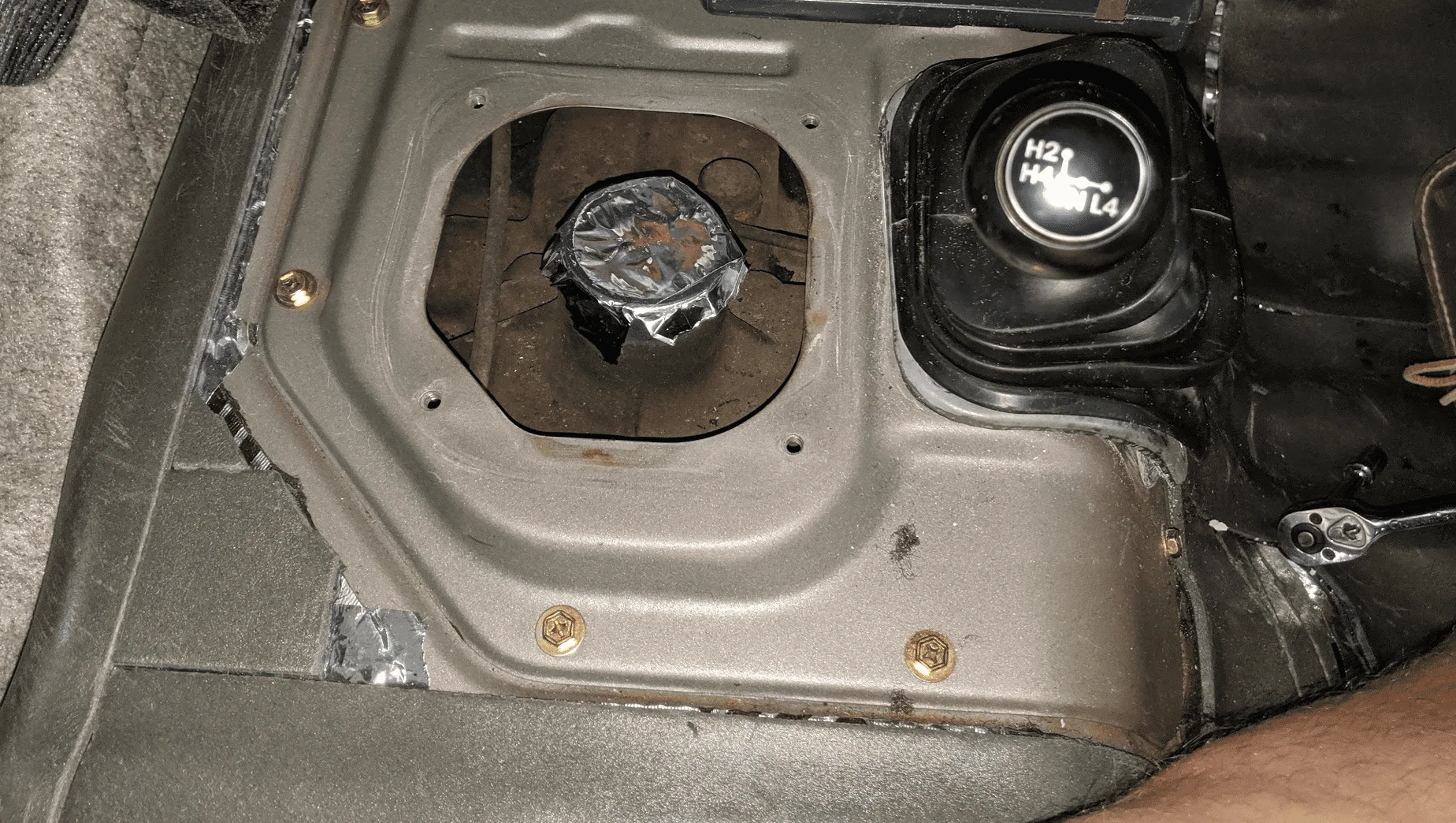

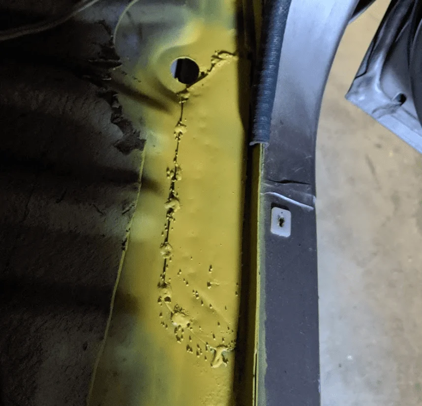

After letting my carpet kit from @dnp marinate in storage for a year I finally got around to installing it (mostly) this past weekend. After pulling the stock carpet I found a little cancer. Cut, patched and sealed which helped keep a lot of sound out of the cabin. Yellow paint is rust converter/sealer. Sealed the top with seam sealer, and sealed the underside with fiberglass after this photo was taken.

While doing that I also did some extensive sound deadener. Used Kilmat throughout the floor and then added some closed cell foam in the front section and on the wheel wells. Didn't take a great picture of it but I got this one

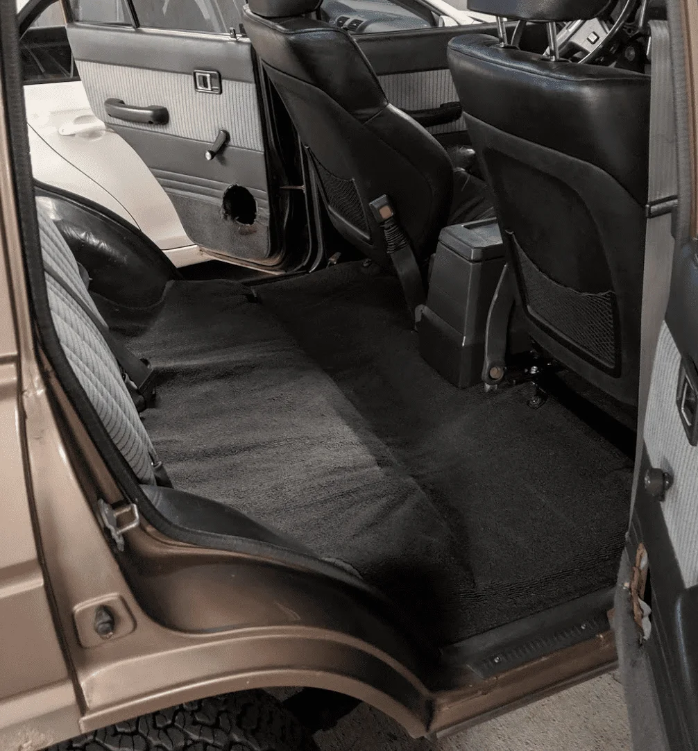

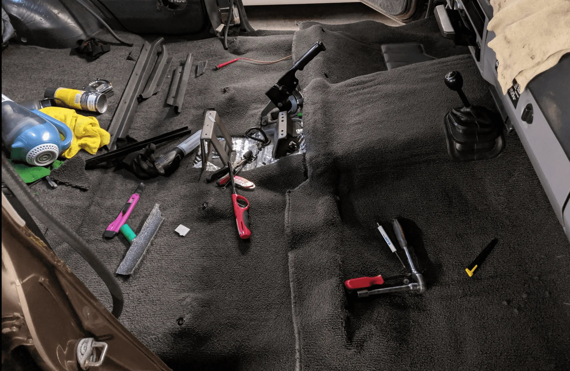

It's a tedious process putting the carpet in but it's worth it. Lots of aligning and then slowly making the commitment to make the cuts. Used a couple different blades and a small piece of copper pipe and a torch to cut bolt holes. Started on the rear bench area to gain the confidence to tackle the front section. Did the front second since it's what I'll see all the time and i wanted some practice. Haven't gotten to cargo area as I ran outta time and needed to put the interior back together for the week. Below is the front sections nearly complete, minus the final edging and shifter hole cut.
Final Images of the front
My only issue with the carpet was that the jute was misaligned a bit and some of the edge binding was loose/sloppy on the front section. The jute isn't noticeable when installed, just made cutting it a bit more difficult. The binding isn't too noticeable either since it mostly sits under the seats.

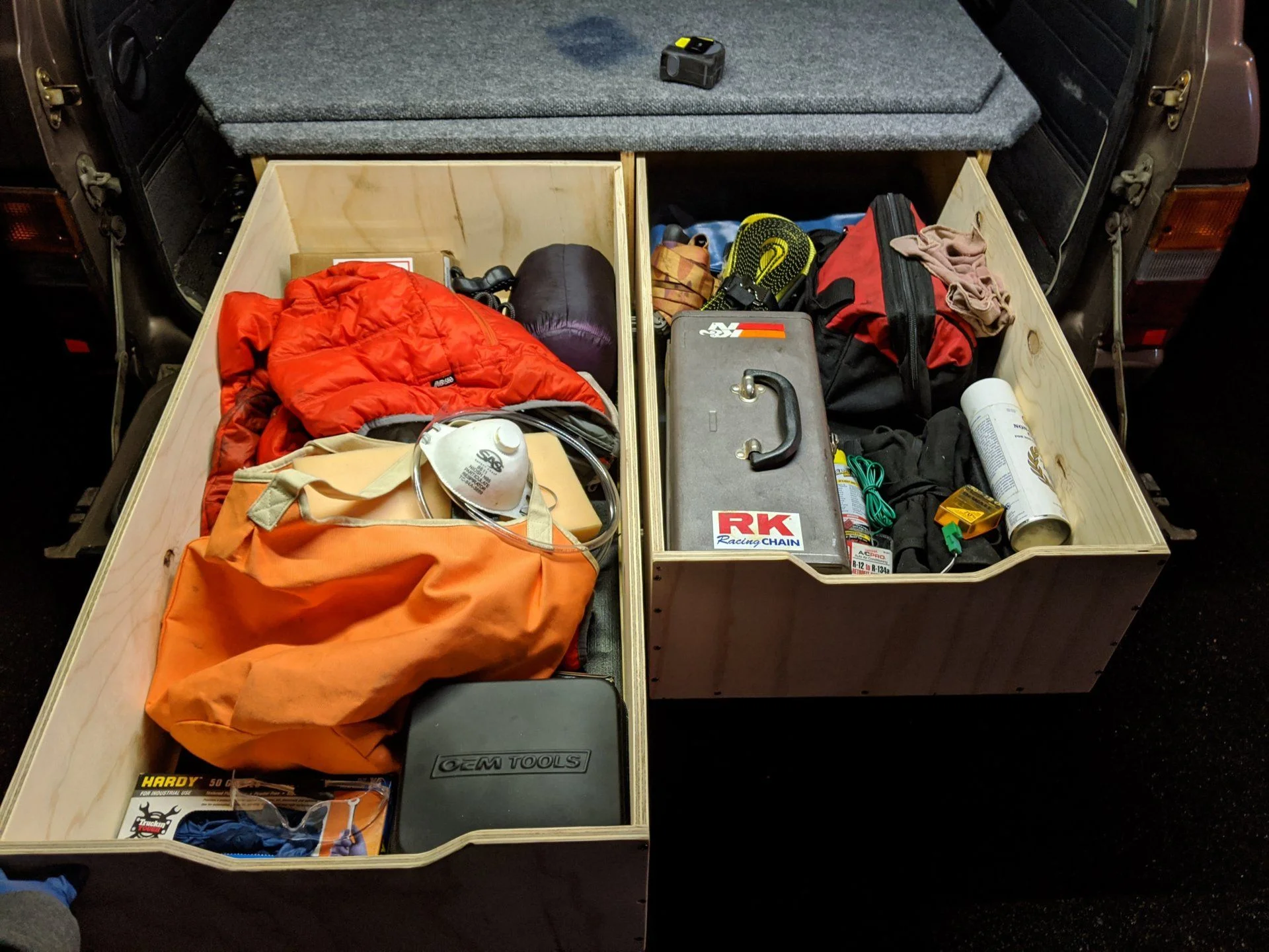

Well, time for a 6month update. I previously made a sleeping/storage platform in the back of the cruiser and this weekend i made some drawers to put in it. Slides are made from VHMW (very high molecular weight) plastic which is very durable and self lubricating. Similar to UHMW (Ultra high...) but more easily sourced for me locally. Put a couple 1" strips down before the drawers and they slide pretty easy even fully loaded. Internally, the drawers are about 18"wide, 38"long and 9"deep. Today I gave the drawers the first coat of Polyurethane and will do another coat tomorrow after a little sanding.

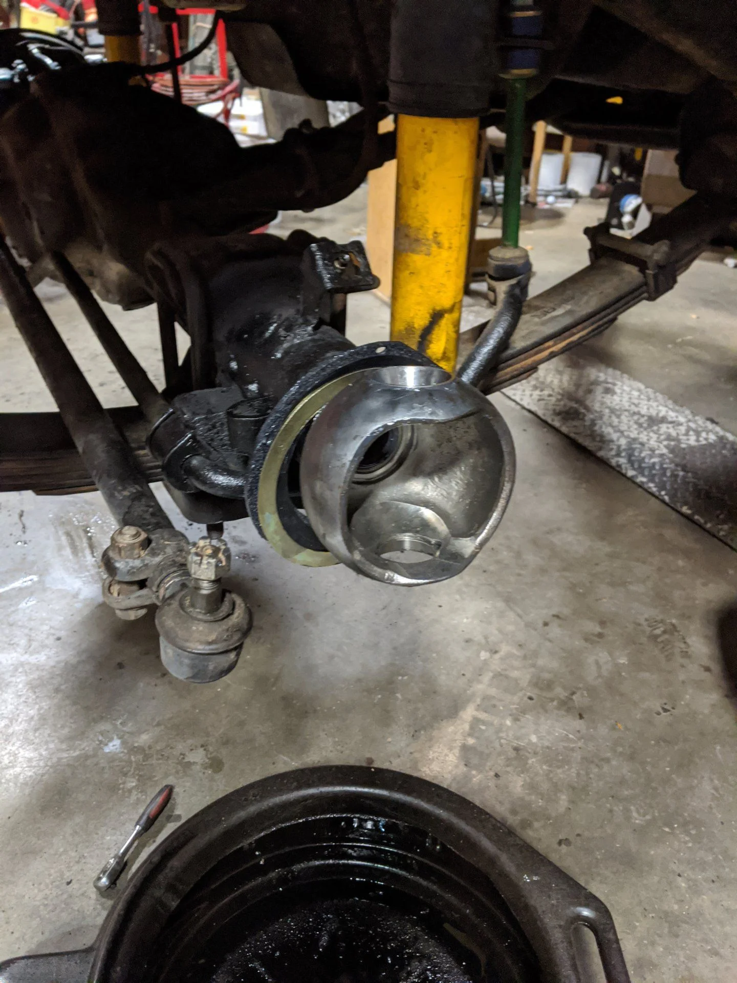

A few months back I had the pleasure of going through another cruiser right of passage, the knuckle rebuild. Luckily it was rather uneventful and glad to have it done. Green sway bar links add 2 horsepower.

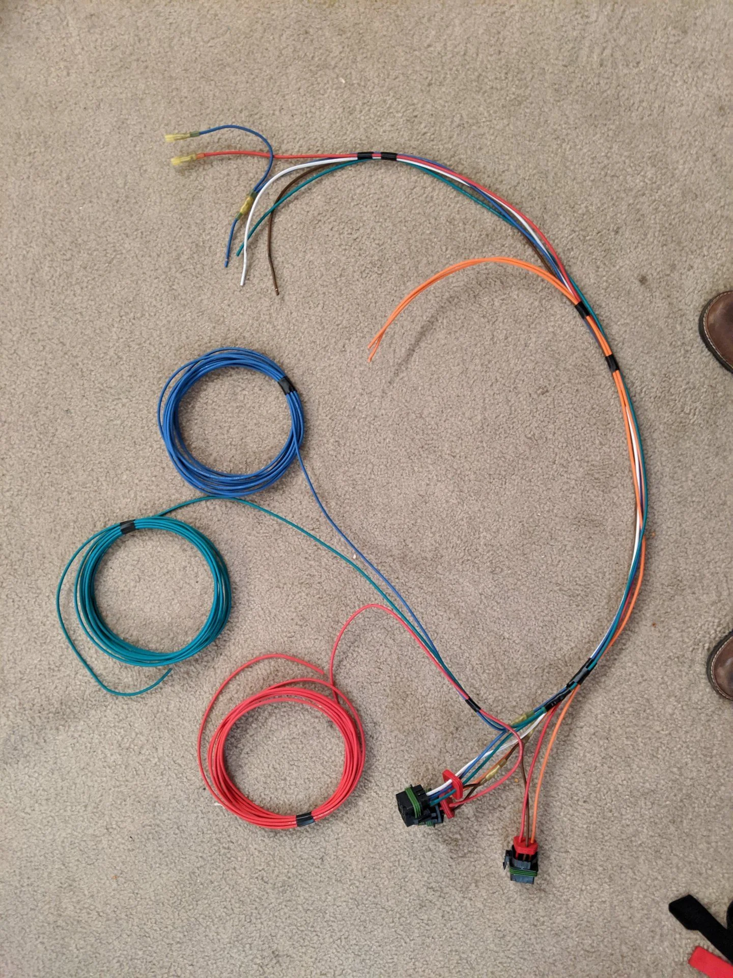

Following the wiring diagram from @slcfj62 I built an upgraded headlight wiring harness to be able to run some HOT bulbs. Ordered relays, weather pack connectors and heat shrink from Waytek, wire and H4 plugs from Ebay, Amazon,... It's definitely overly built, and ordering an aftermarket harness would have been easier and possibly cheaper but it was fun learning how to build a harness. Also the improvement in lighting is incredible. I already had the semi sealed Hella conversion lamps, but was able to throw in some 100/80W bulbs with the heavier wiring.
