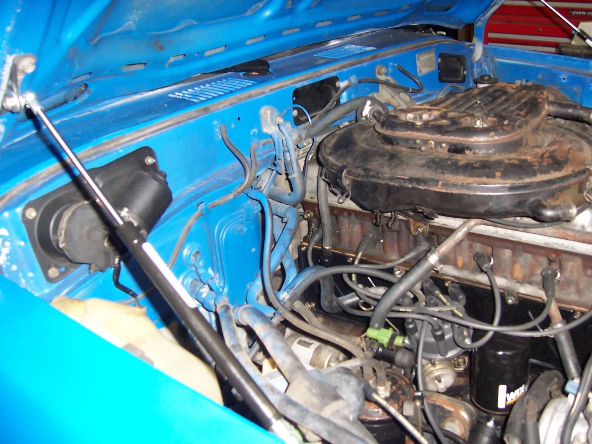

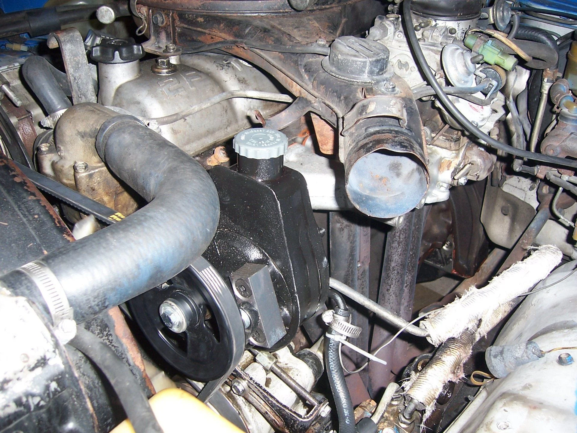

Finally got a few projects completed on the 60 to do list. Cleaned the engine bay. PO solution to leaking PS pump was to keep adding fluid. Many hours of pressure washing, steam cleaning and scrubbing things to get it to where I could work on it without getting covered in grime.
Desmog, remove PO wiring mess, replaced the leaking PS pump with a Saginaw conversion kit from Georg, hood strut mod, and a minor tune up with new plugs, wires, cap and rotor. I'll do the valves and check the timing when it's cooler in a few months. Runs great.
Before, engine bay covered in years of leaking power steering fluid.
After, hood strut mod, new plugs, wires, rotor and cap.
Saginaw conversion
Between this and replacing the clutch, rear main, oil pan gasket and side cover gasket I think I finally have it to where it no longer marks it's territory!

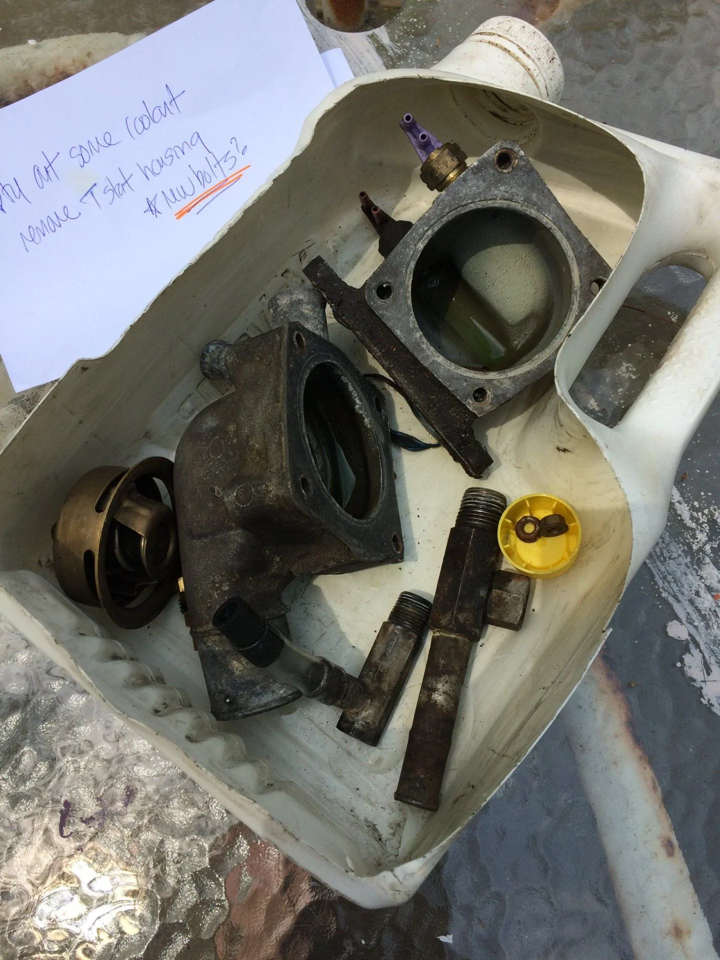

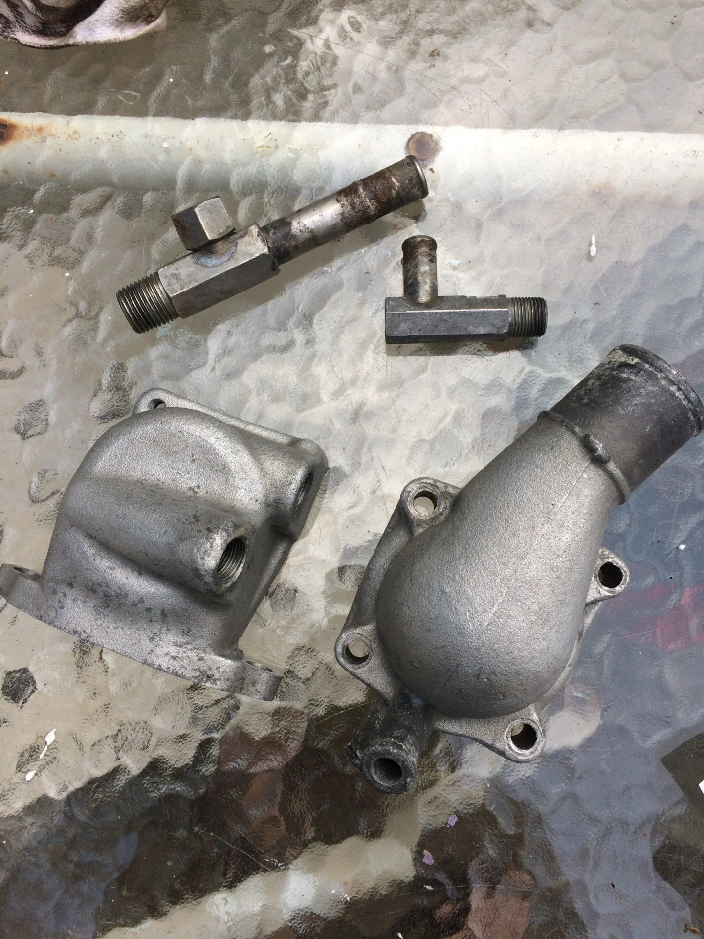

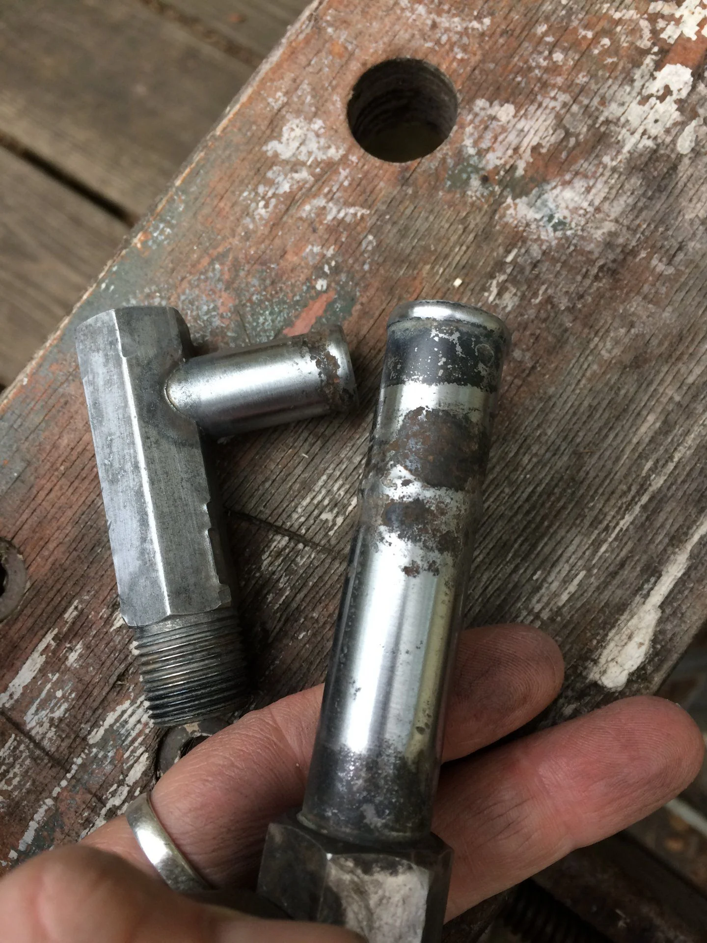

Getting things cleaned while the head is still off at the shop getting resurfaced.
Tstat housing upper and lower and rear heater pipes scrubbed and made shiny. Rust around the pipes scuffed off w/ fine sand paper and some elbow grease.
I opened up my block to check on its coating of oil on the cylinder and scraped my nail along the inside of the 4 middle ones and zero gouges were felt.
Things are looking good for the future of this old girl.

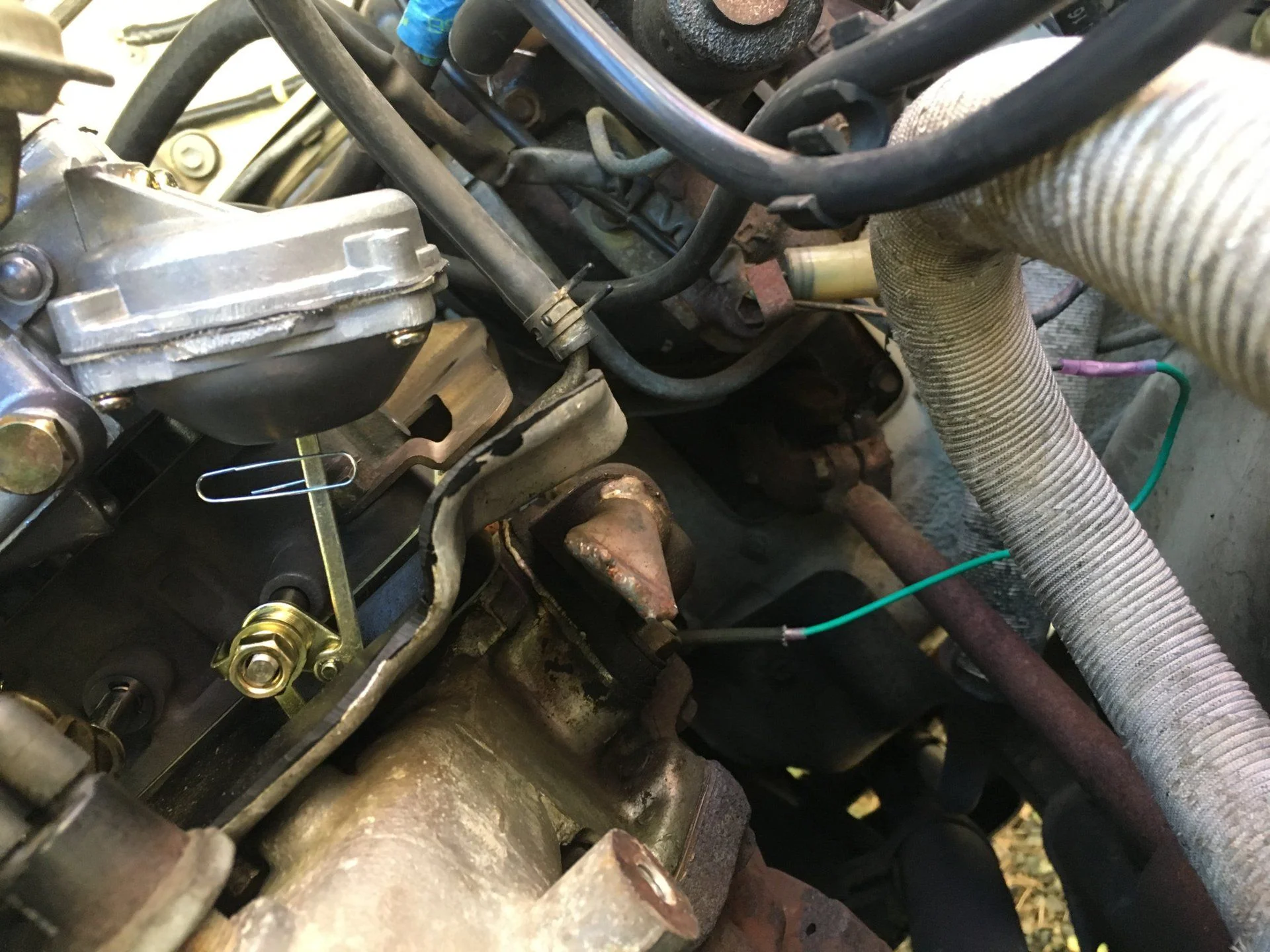

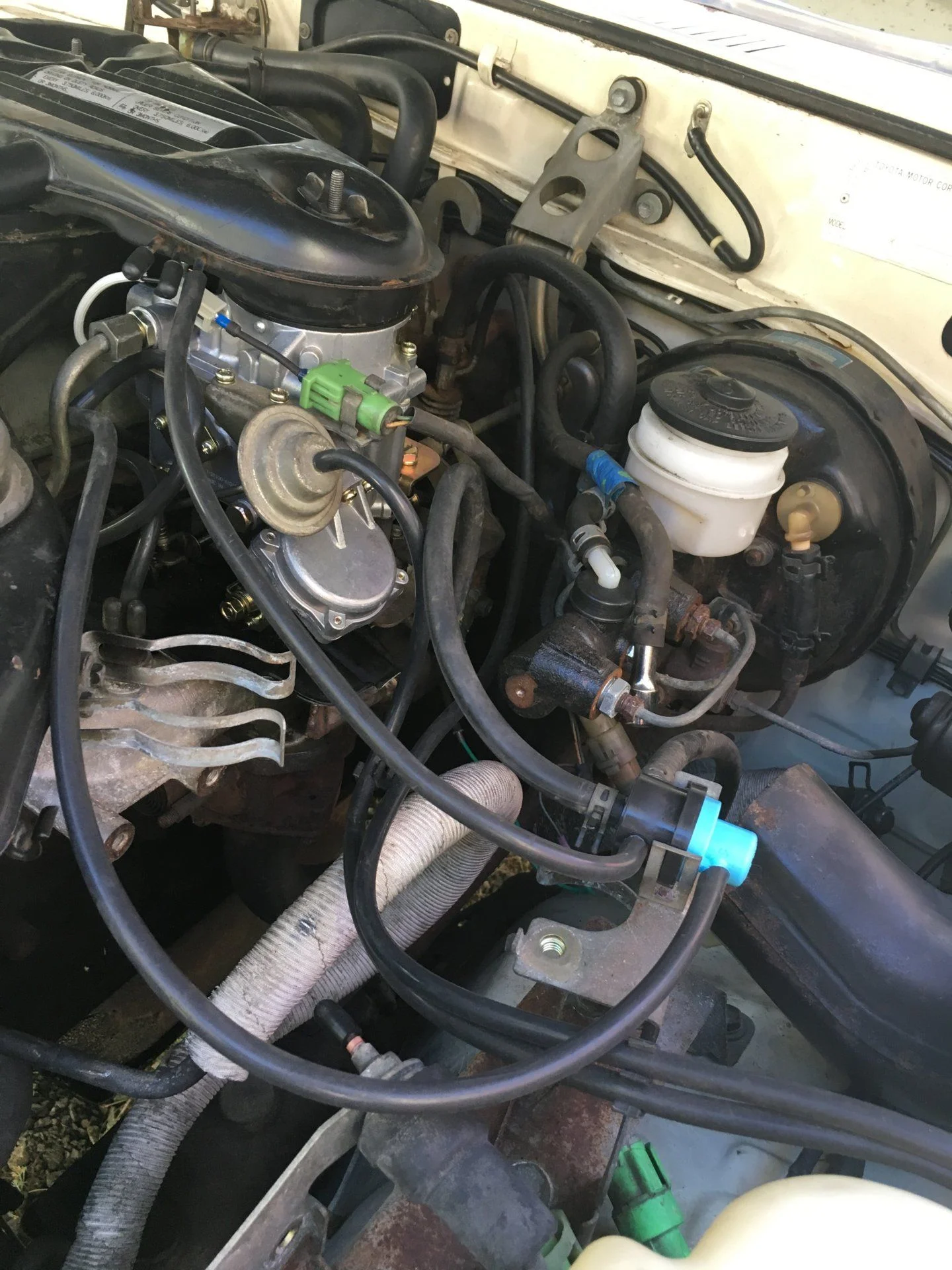

A few weekends ago I installed a city racer Fuji carb on my 60. I set the idle and chased a vac leak and It ran better than my dirty stock carb. My 2nd new VTV arrived Saturday, so today I connected the vac lines for dizzy, evap, and advance as shown in this thread:
My Desmog Keeping HAC Lots of Pics
And did the lean drop method for tuning outlined in this thread:
First-time lean idle drop...help!
I'm at the BB at 650 RPM, 3.5 turns out on mix, and idling at 650 RPM. My truck is driving much better than before.
I even passed the paper clip test.
The next step is to figure out how to get stock carb rebuilt and dizzy recurved by the whisperer. Then it is brakes, clutch, RMS, and chopping rockers and rear quarters.

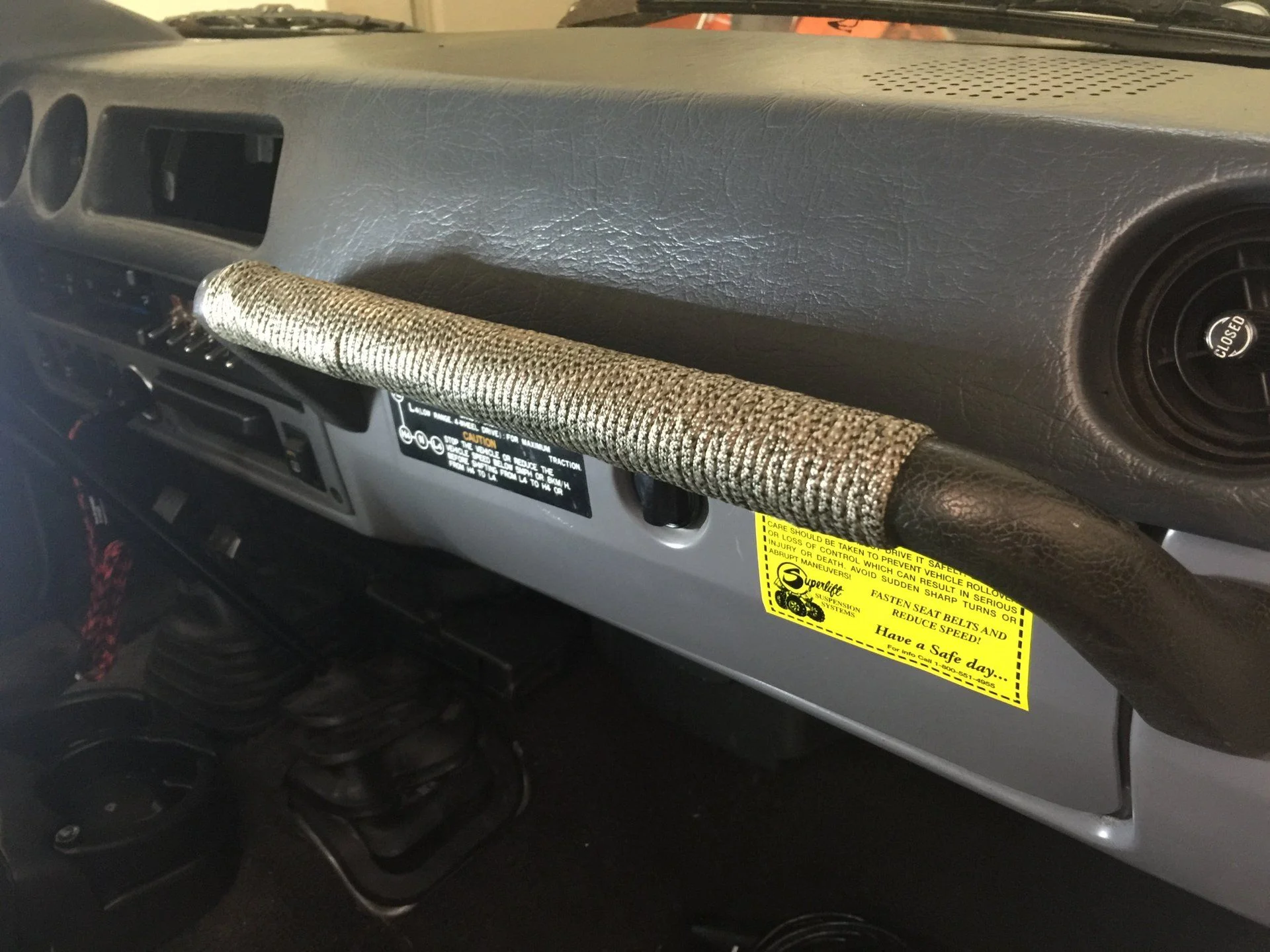

Bought a grab bar from a MUD member maybe 3 years ago and finally installed it. Bar was a little damaged so I wrapped it in paracord.
With a 5'0" wife she needs all the help she can get.
