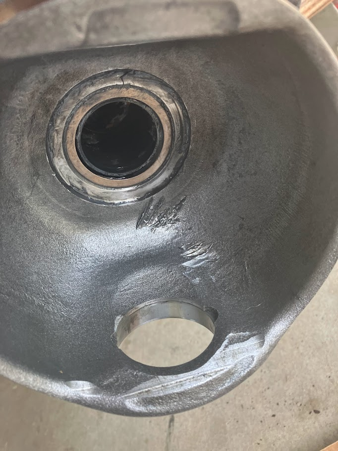

Small bit of damage to the inside of the ball.
I well probably take the dremel to that and smooth off the high spots.
I'd bet that's the short side. That extra piece dropped into the ball and "massaged" it until you pulled the DS and flange.
