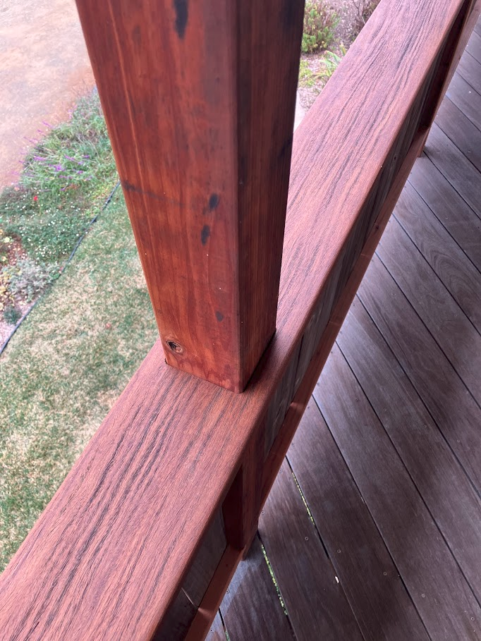

All the hardware is blind ( hidden ) on the hand rail.
Clean holes were cut into the top cap of the hand rail and then slid down over the posts.
We repurposed the original cap, that piece of wood is 23 years old sanded, holes cut, oiled and reinstalled. The wood is Ipa it from the rain forest, it's amazing wood that lasts forever.

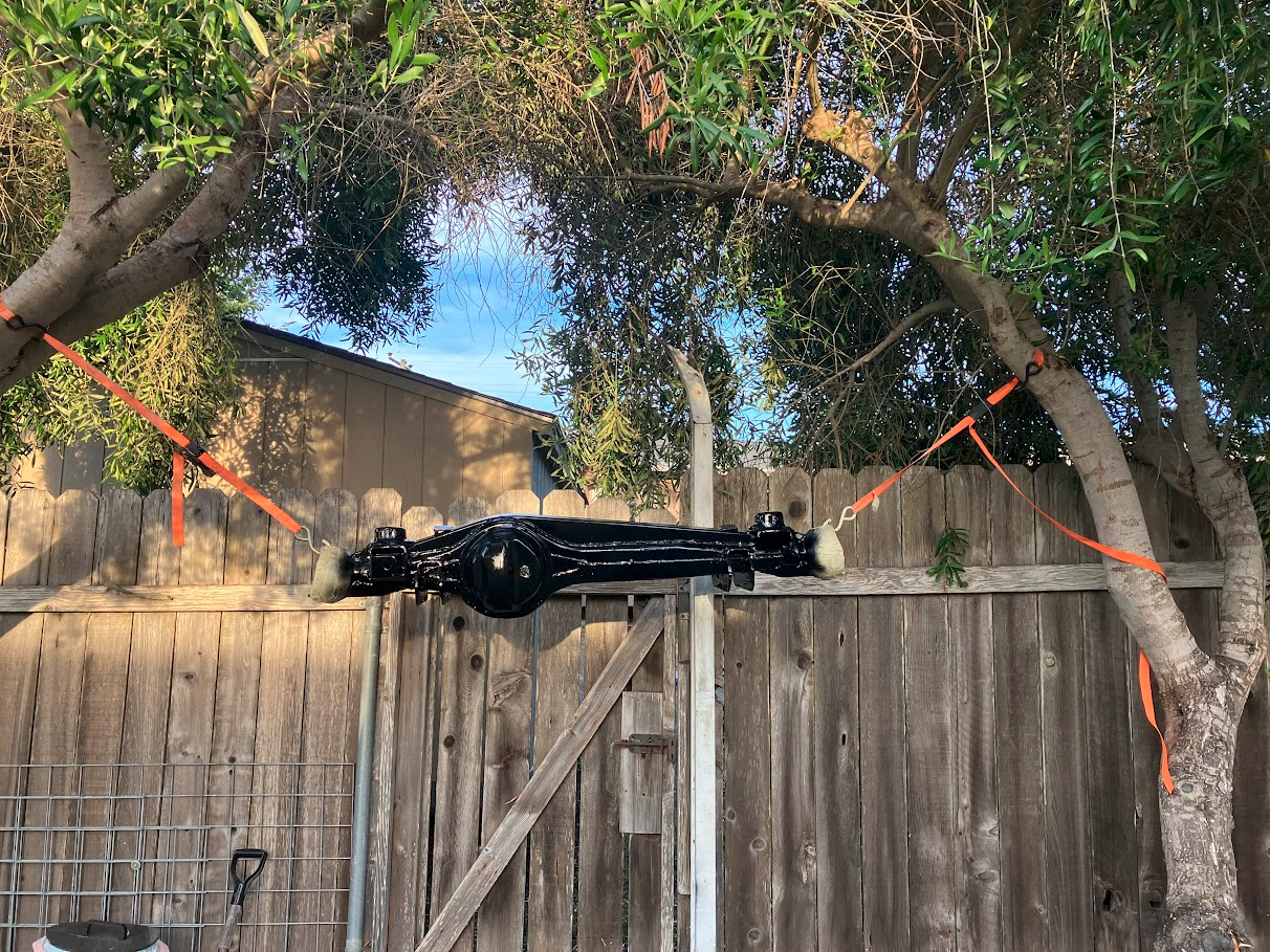

Will finally some progress, Axle housing and the diff made it to the paint both.
Now I well start on the funnest part of a front end service cleaning all the parts :rolleyes:
Two questions for you. What paint did you use, and what brand/where did you get your axle truss?
Rust-Oleum Gloss Black, If I wasn't such a cheap ass I would use semigloss but it only comes in the regular size can, the Gloss can be had in the extra large can for the same price.
The Axle truss was custom made by me :cool:

More cleaning and installed a LandTank diff stud kit ready to drop the diff in.
Then get that baby back under the truck.
My Son Thayer is visiting and we got the third dropped in and the Axle under the truck, slooooooooowly getting it back together.
Then we went to Christmas Light show /Fair
Baby steps knuckles cleaned and installed
