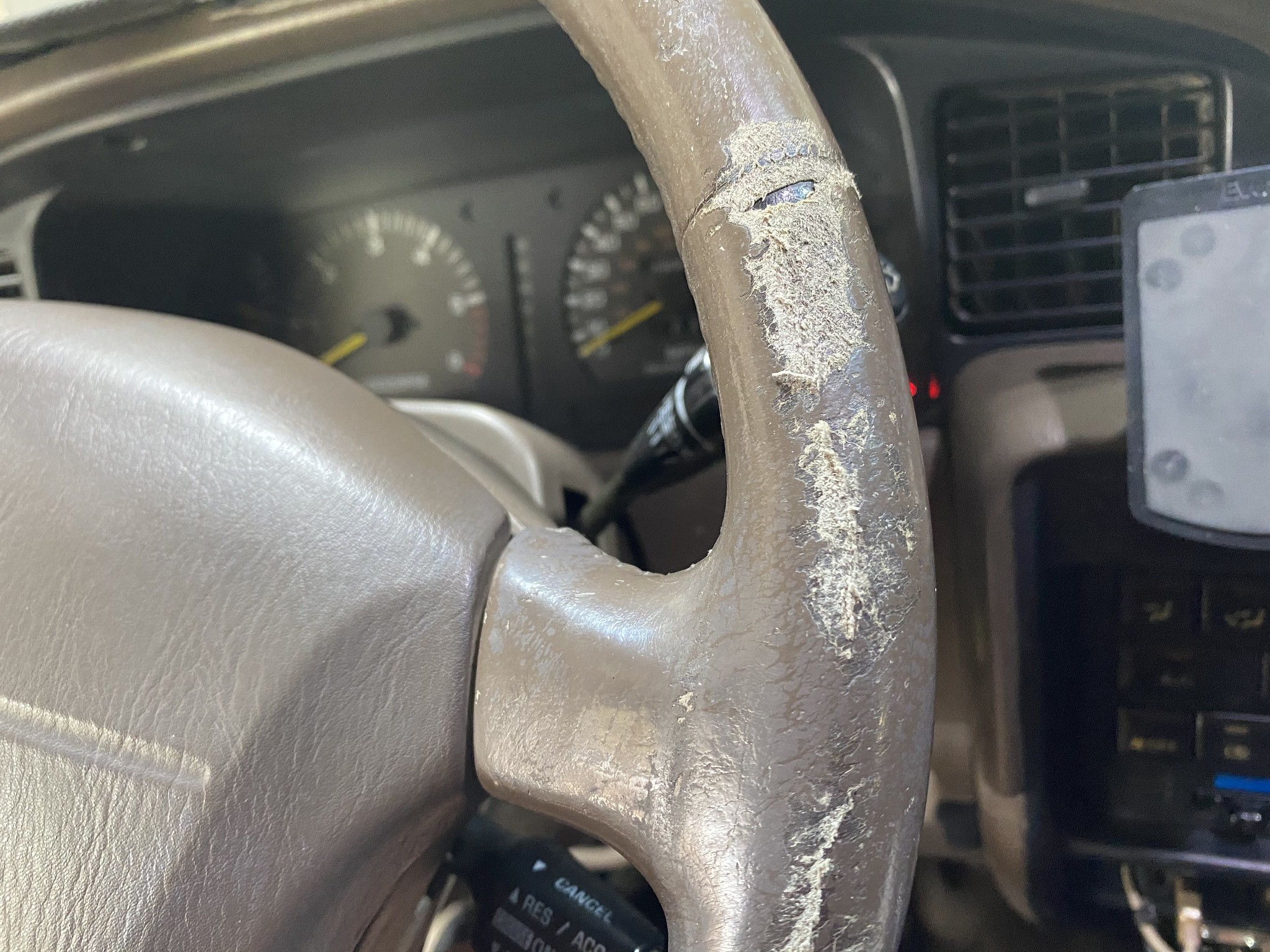

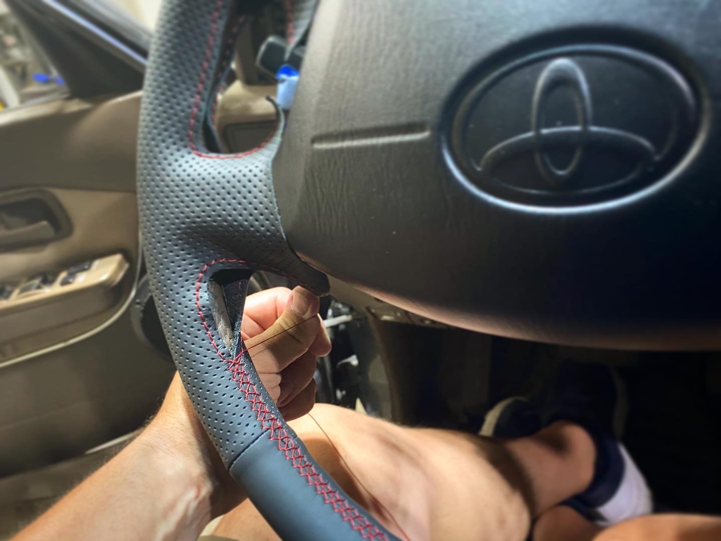

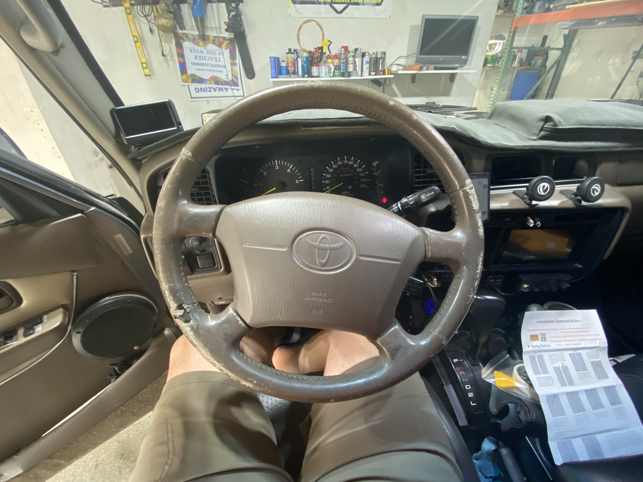

I got tired of the cheapo slip-on steering wheel covers but the original leather was trashed. So I got one of the leather covers from Loncky and recovered the wheel last night. One more piece to the transition to black interior. Black perforated leather with red stitching. Painted the airbag and column covers too.

Wow, that turned out great. I hear stories about how difficult it can be to install those leather steering wheel covers. Yours came out wrinkle free and even. Looks awesome.
If you do it right it takes time and can mess up your hands. I agree it looks great with the red stitching! well done!

How long did it take to stitch the wheel. I think mine comes tomorrow.
