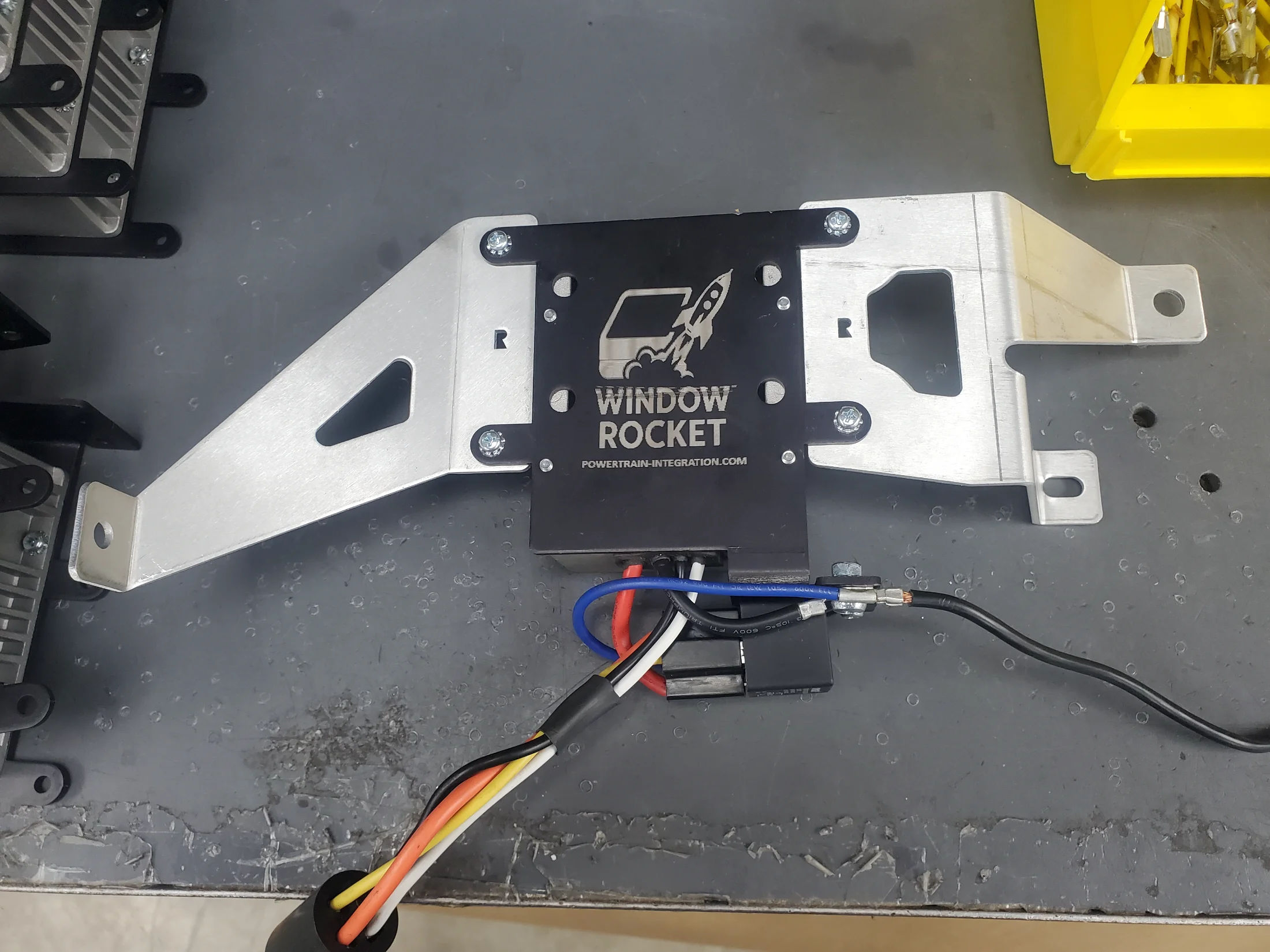

The latest revision of LHD non-ABS Window Rockets have been tested, they fit great. FJ80 Window Rockets will be ready to ship when the kit hardware shows up and instructions are finished.
FJ80's use one existing hole and two self tapping screws to mount exactly like the ABS computer mounted in later years. A 93+ 80 series without ABS will have threaded mounting holes and a stud, the Window Rocket will bolt right in.
The RHD non-ABS Window Rocket mounts are ready and will be test fit later this week.

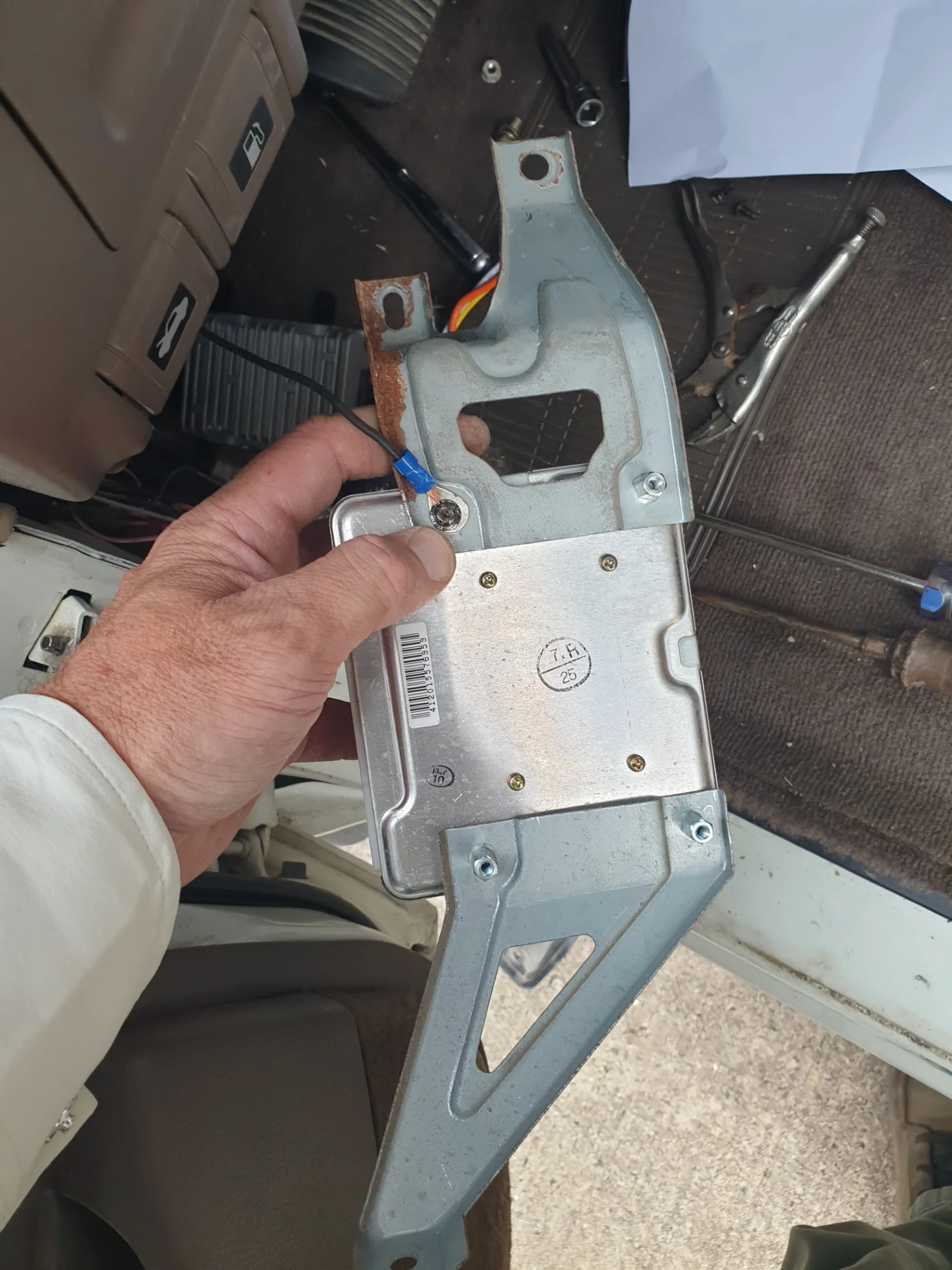

This has nothing to do with the Window Rocket and everything to do with the PO stripping a screw. I had to remove the whole ABS computer/bracket assembly due to a stripped screw at an add on ground loop. The take away here is that is is not that difficult to just remove the entire ABS computer and brackets. Two 10 mm bolts and one 10mm nut and you can snake it out of there.
