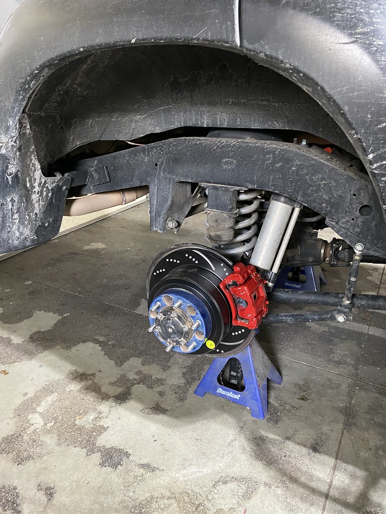

First off, after having the EBC/Hawk brakes for a couple months now I can say that I like the setup. I do think it's an nice upgrade from stock, but it isn't a massive change. I don't have any hard data that show braking distance has improved but the seat of the pants feel is that the brakes bite a bit harder than stock, but don't expect these to feel like sports car brakes.

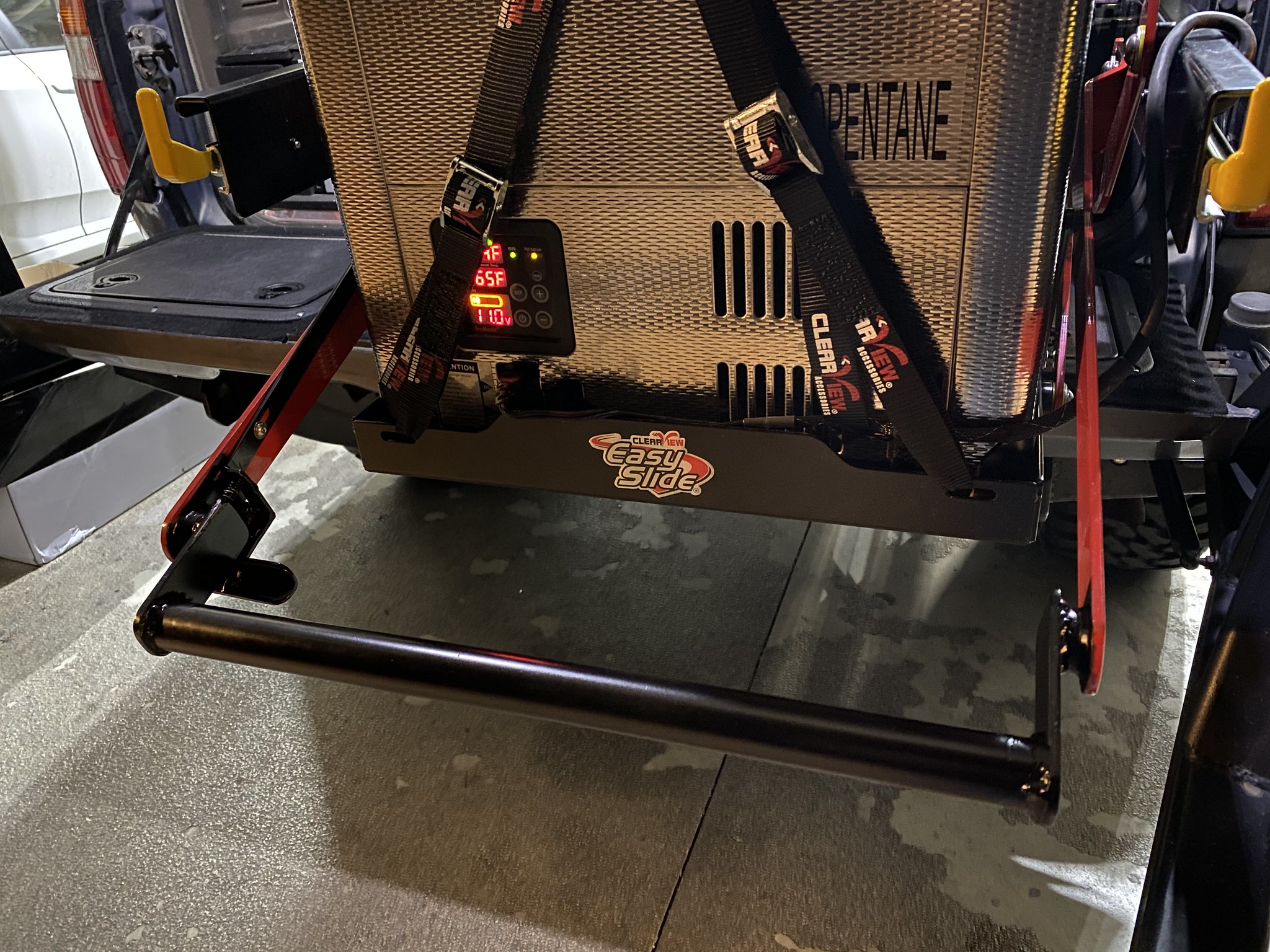

I posted this upgrade in the "what did you do to your 80 this weekend" thread but didn't add it here. If you look back a couple pages you'll see the MSA fridge drop slide I added this past summer. It's a really nice slide and very heavy duty. The one thing I didn't like was that the handle arm rotates up and over the top of the fridge. The fridge needs to be able to drop at least 10" for the arm to fully rotate past the top of the fridge. Since my drawers are only 8" tall the handle couldn't fully rotate out of the way so the handle was partially in the way of opening the fridge. It wasn't a huge issue, but an annoyance all the same.
So I sold the MSA slide and instead purchased a Clearview Easy Slide. This slide is also extremely heavy duty but the handle rotates down instead of up so it would not be in the way of opening the fridge. The vendor I ordered from told me which model was the correct one to fit my fridge. They were correct that it was the right model based on the footprint of the fridge but did not take into account the height of the fridge. So....the handle could not close all the way because it would contact the side of the fridge. This meant modifying the handle along with the handle release lever. They both needed to be extended about 2.5". Fortunately I have a welder and was able to make the modifications without too much trouble. For someone that didn't have the tools needed this would render the slide useless until they could get it to someone who could modify it or exchange it for a larger model slide. The Slide model is the ES150-PLUS. My fridge is a Snomaster CL52D. If you have this fridge you'll want to order the slide model larger than the 150-PLUS to avoid needing to modify anything.

This is after making the modifications to the handle. The end of the red arm is where the original handle was. You can see the part I added painted black.

I really like this slide despite needing to modify it. It works great and is very solid. One thing it has that the MSA did not is a secondard lock (yellow handle under the center of the slide that can be seen when it's closed). This lock when engaged holds it all very solid and still so there is no movement or rattling. The slide and drop mechanism is smooth and easy to use.

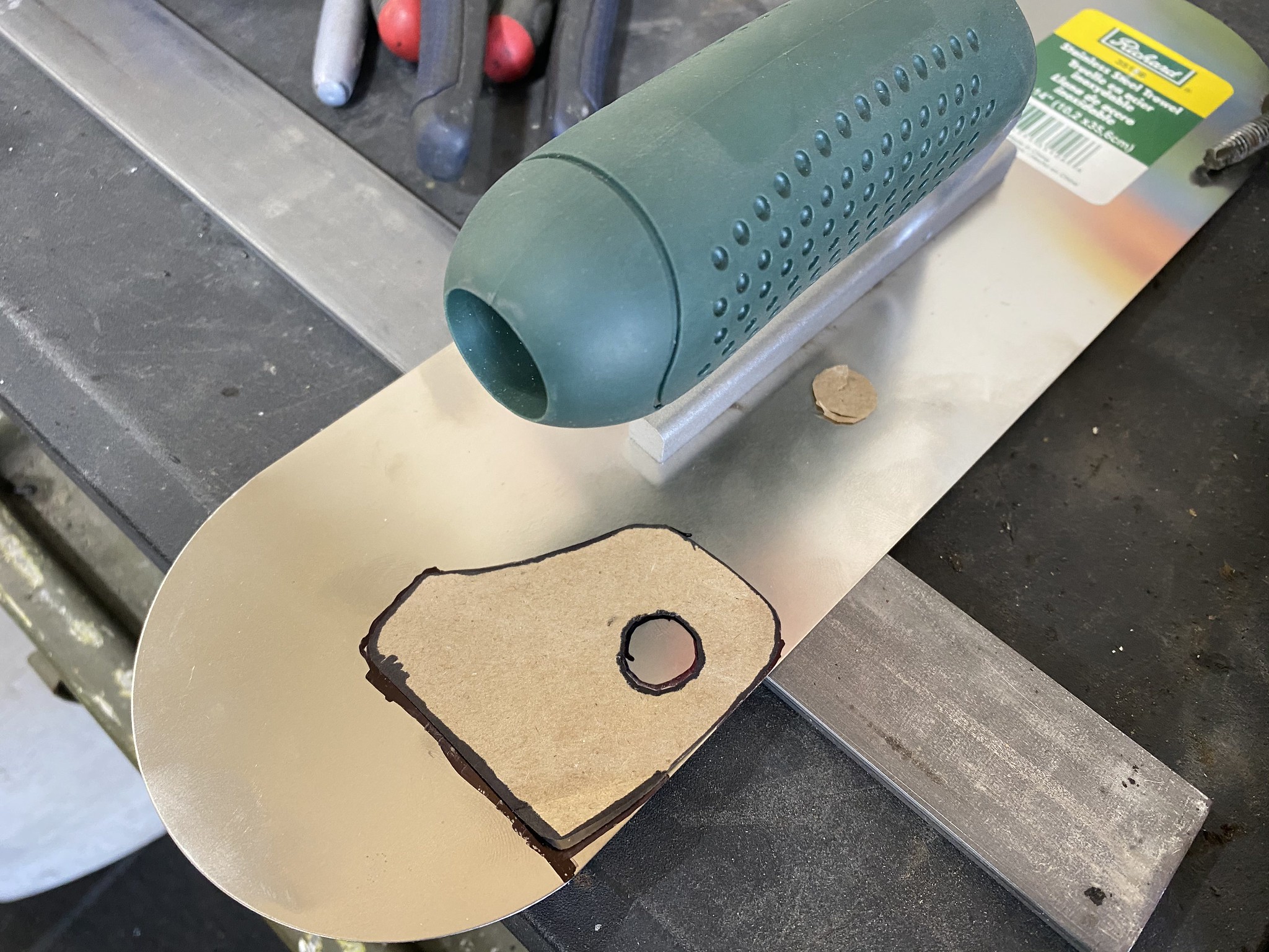

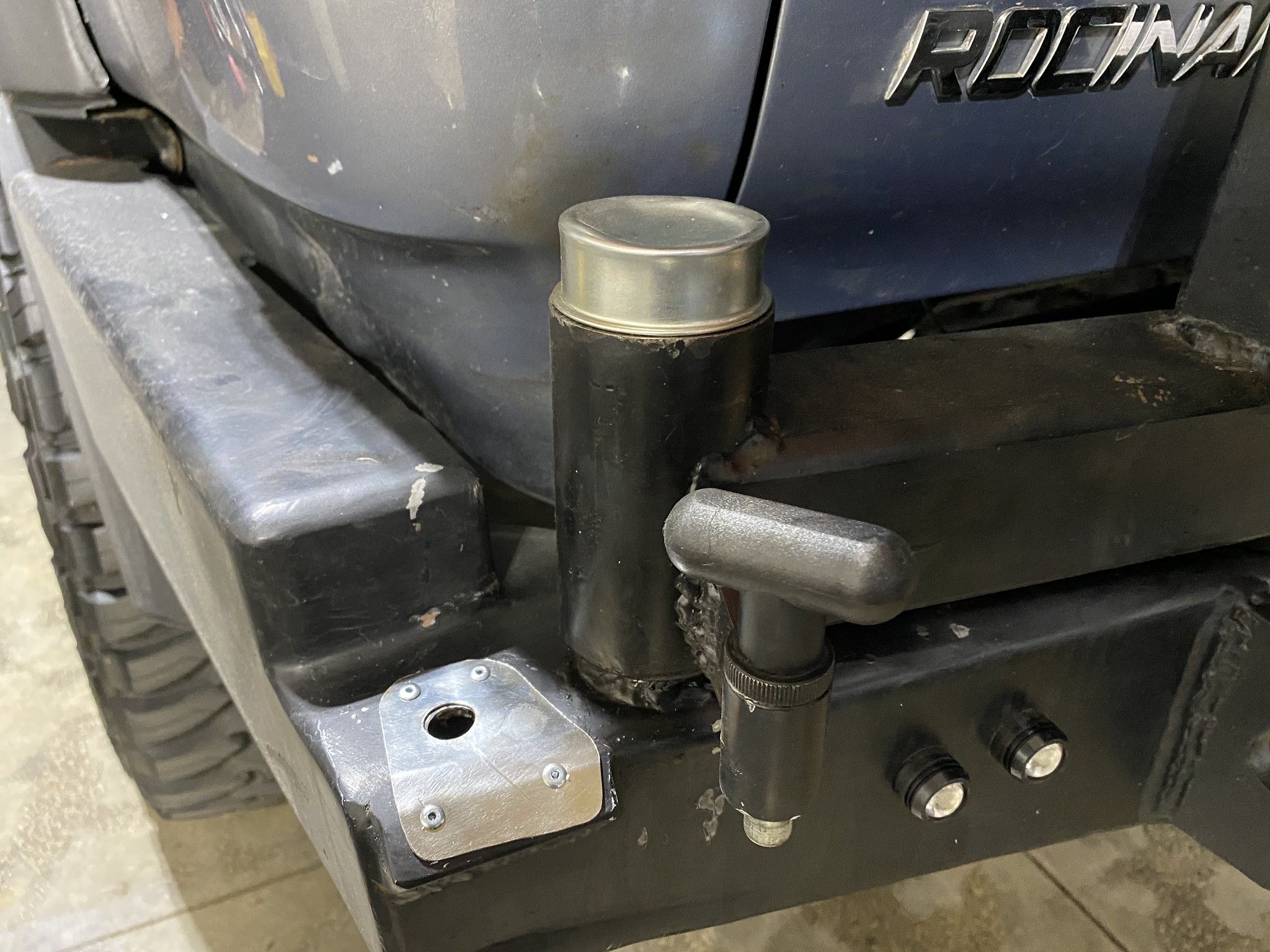

The most recent update is a minor mod I did last night to add some stainless guide plates for the lock pins on my rear swingouts. I couldn't find any stainless plate locally so I had to get creative and I purchased a stainless trowel and cut out what I needed from the trowel. Doing this by hand (freehand) with simple tools isn't necessarily the cleanest result but it works.
