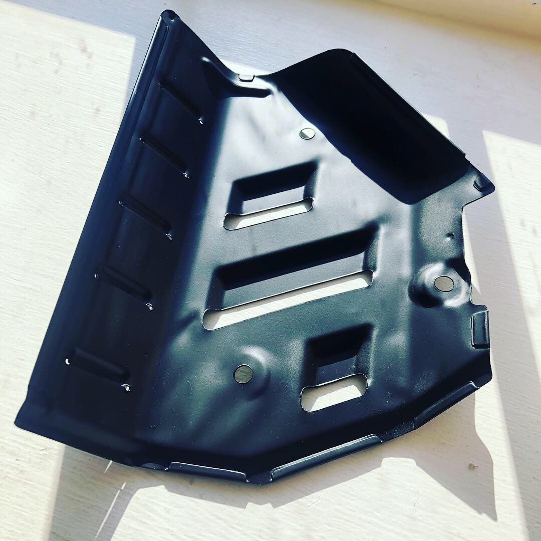

Does anyone know what the exhaust heat shields are made of? Mine cracked and wont stay on anymore. Would be easy to weld up some washers to repair, but it kinda looks like it might be galvanized or maybe Al?
I don't know what the factory finish is. They do attract a magnet.
